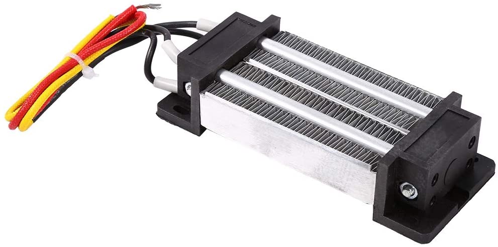

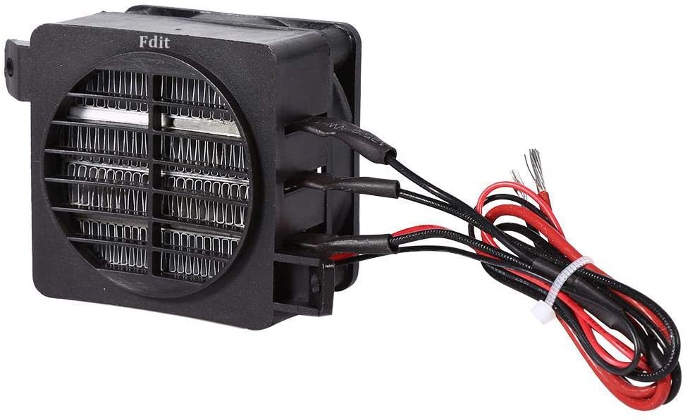

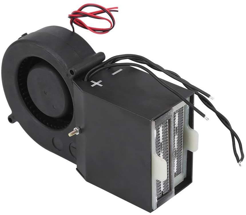

Positive Temperature Coefficient (PTC) heaters are everywhere, and cheap. They have the unique property of getting just so hot, and no hotter. Initially, I was looking at the usual offerings on eBay, Amazon, etc.
I even ordered a couple. But, they are all so cheaply constructed that I began looking for something more robust. Toyota has been installing small PTC heaters in many of their vehicles since at least 2009; they're set up to provide a bit of heat when the ICE's coolant temp is low, particularly in cold climates or in versions of vehicles with diesel engines, which generate little heat when not loaded.

eBay has loads of used Toyota PTC heaters for cheap. I'm thinking of hanging one above my feet with a fan and some switchgear, for use when I'm trying to make a bit extra range in cold weather. Note that modern BEVs generally don't have to sweat range like my old rig; they're both more energy efficient (my old RAV4 EV is a bit more aerodynamic than a brick), have more efficient drivetrains, and have heat pumps that provide heat at moderate temps at a much lower energy usage.

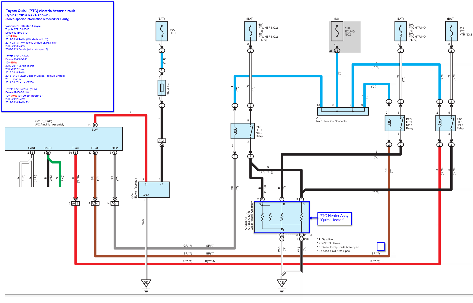

Below, I document some info and circuit diagrams I've pulled from various sources. Some is redundant, esp. the multiple circuit diagrams, which all show pretty much the same circuit but in differing detail.

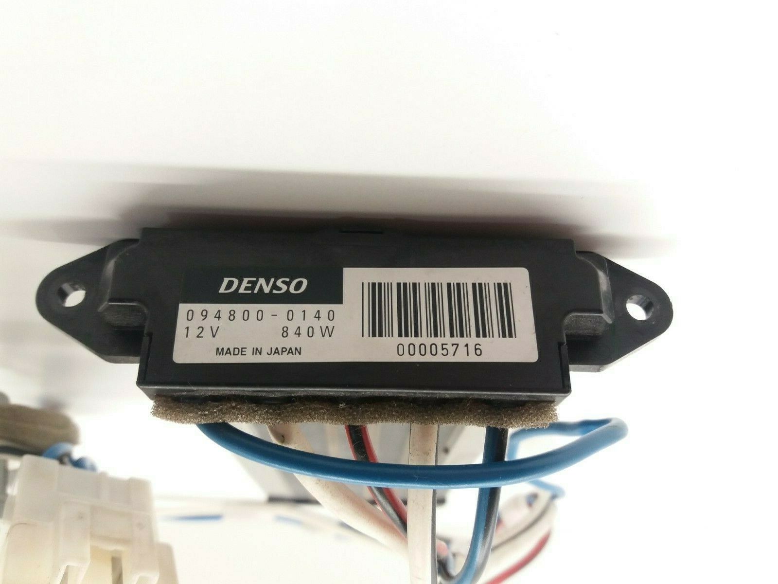

Toyota 87710-42040 (NLA)
Denso 094800-0140
12v 840W (three connectors)

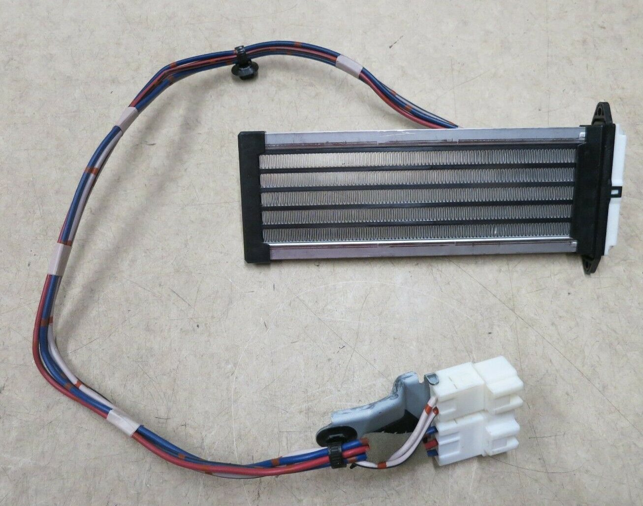

Toyota 840W PTC Quick Heater
Toyota 840W PTC Quick Heater, connectors view

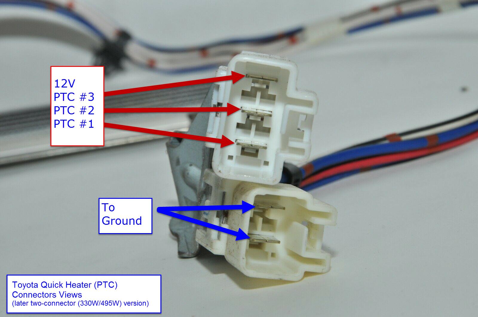

Toyota 495W PTC Quick Heater: connectors view

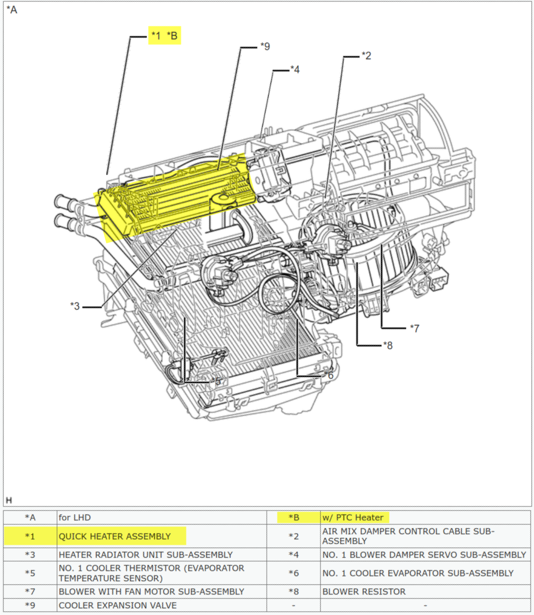

Toyota 840W PTC Quick Heater: installation location in 2012 RAV4
Toyota 840W PTC Quick Heater: Denso part No.

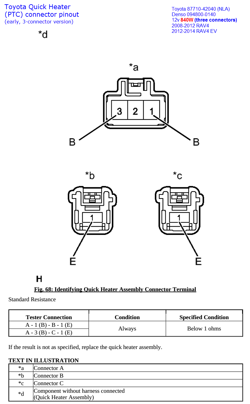

Toyota 840W PTC Quick Heater: Connector terminals diagram (early w/(3) connectors)
Toyota 495W PTC Quick Heater: Connector terminals diagram (late w/(2) connectors)

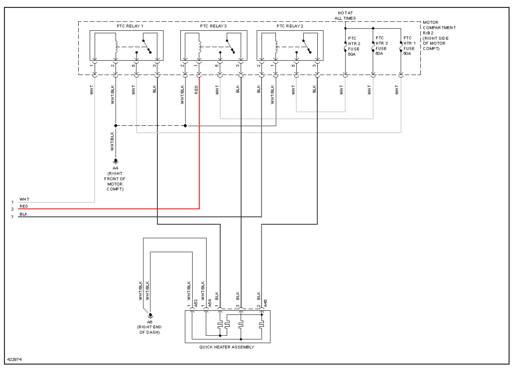

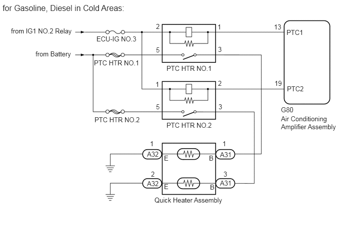

Typical Toyota PTC circuit, including both 2- and 3-stage PTC installations

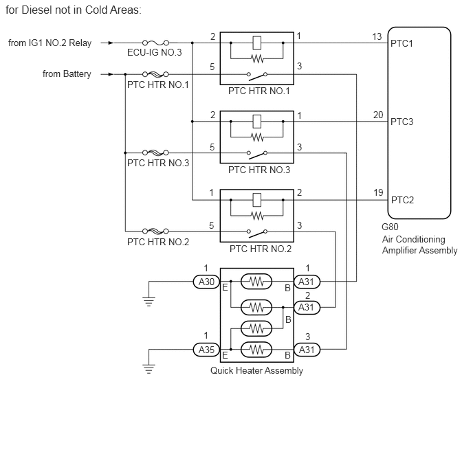

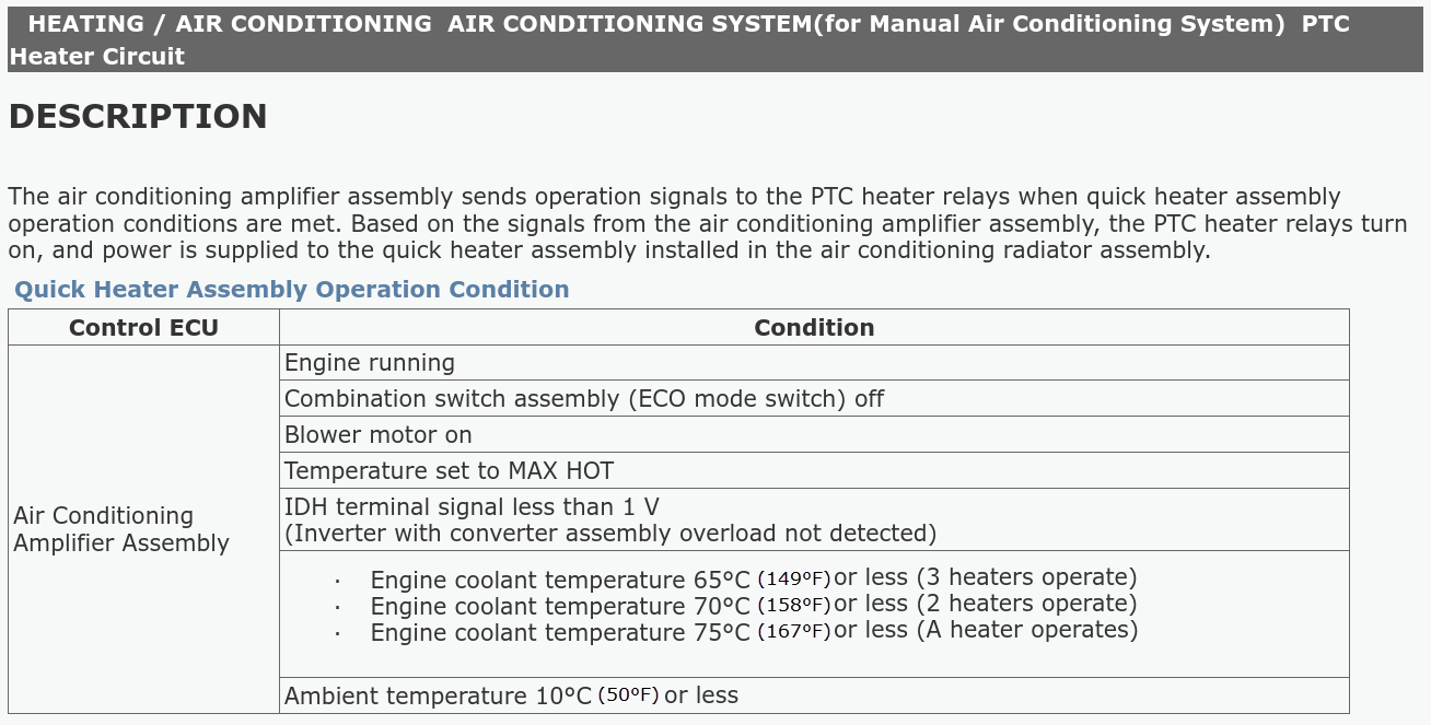

PTC system description

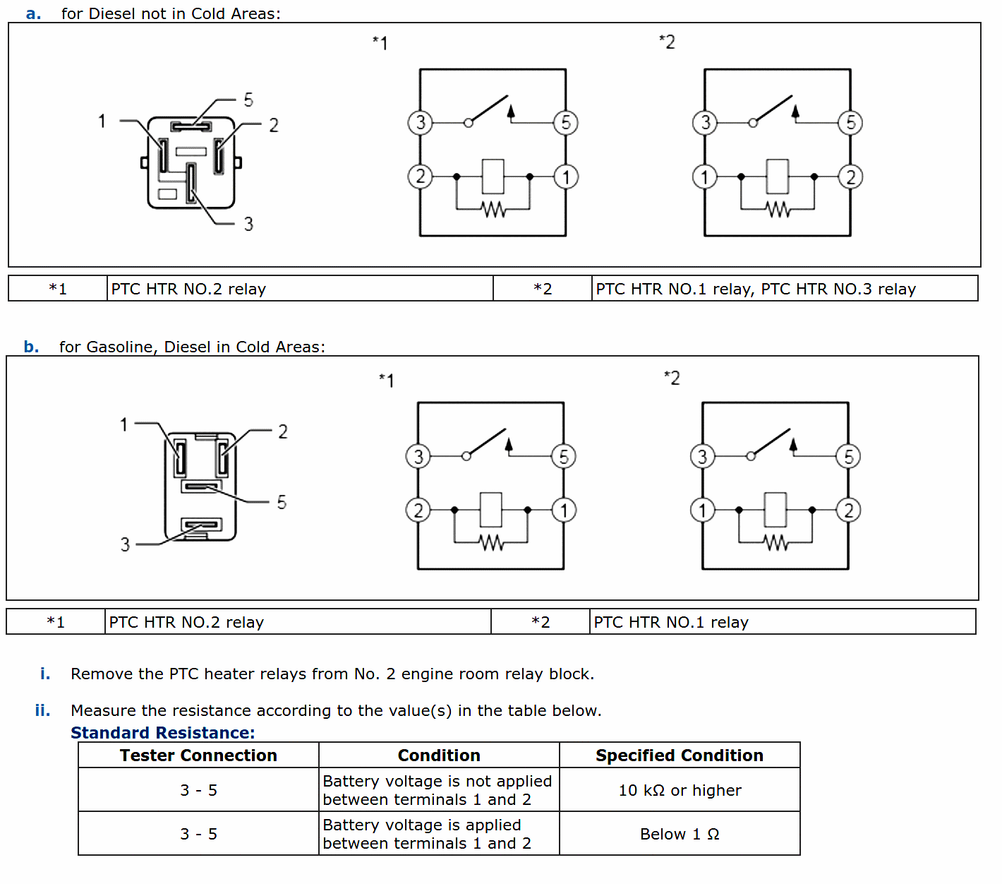

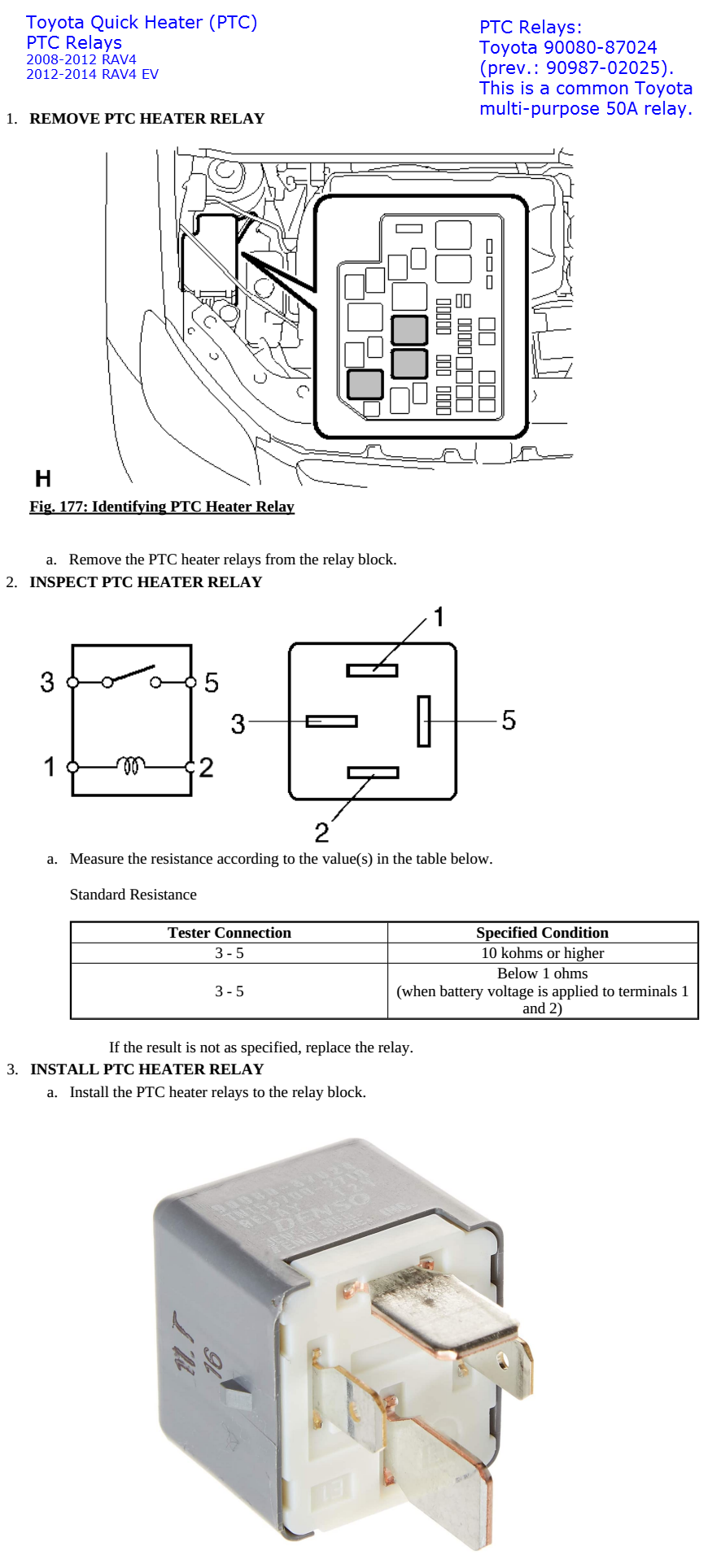

PTC Relays testing info

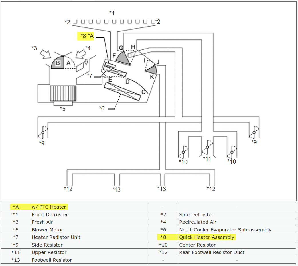

PTC Quick Heater location in A/C Assy.
PTC Quick Heater location in A/C Assy., left side view

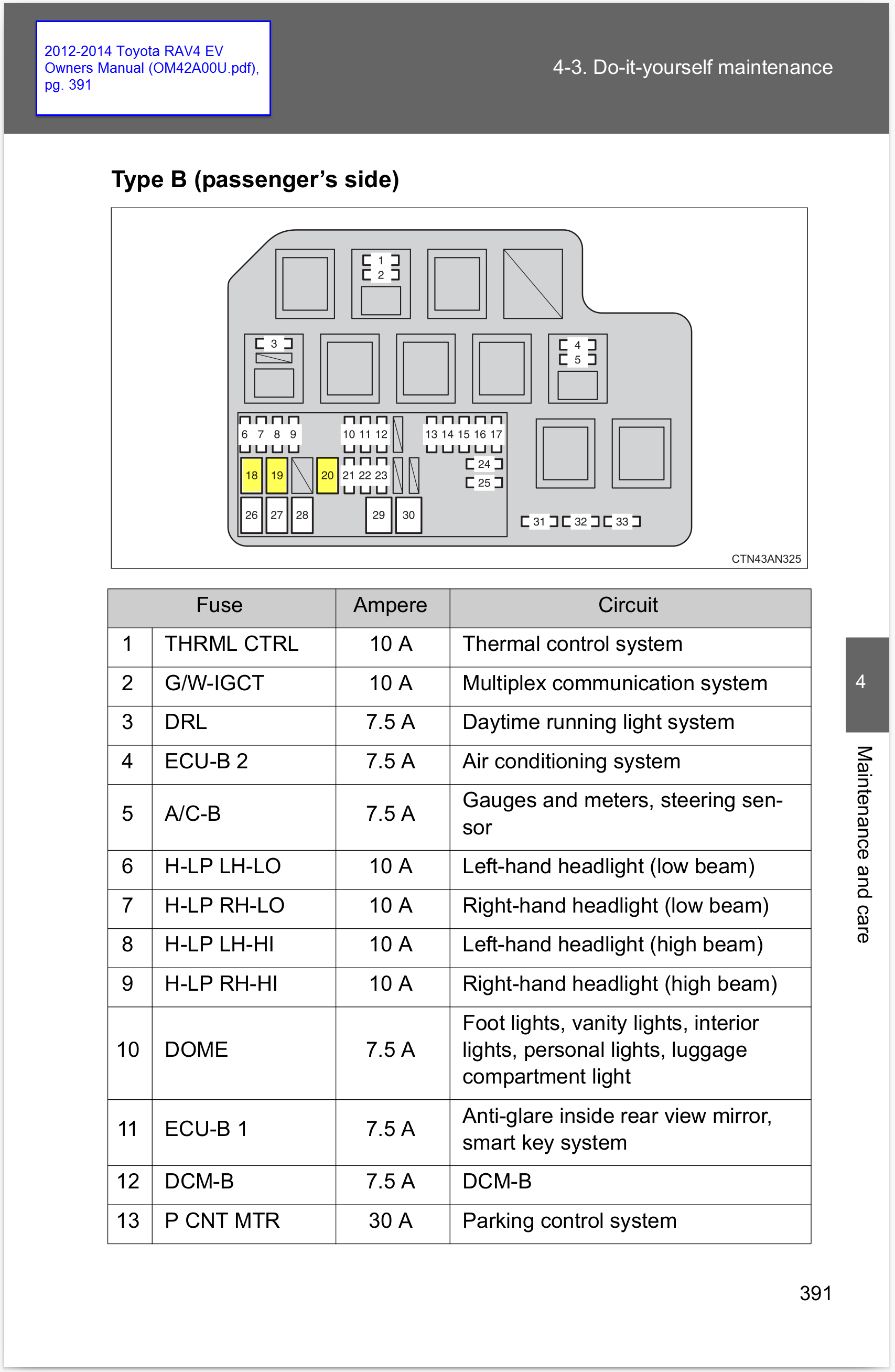

Toyota RAV4EV PTC heater fuses:
Toyota PTC Heater fuses locations (2012-2014 RAV4 EV)
