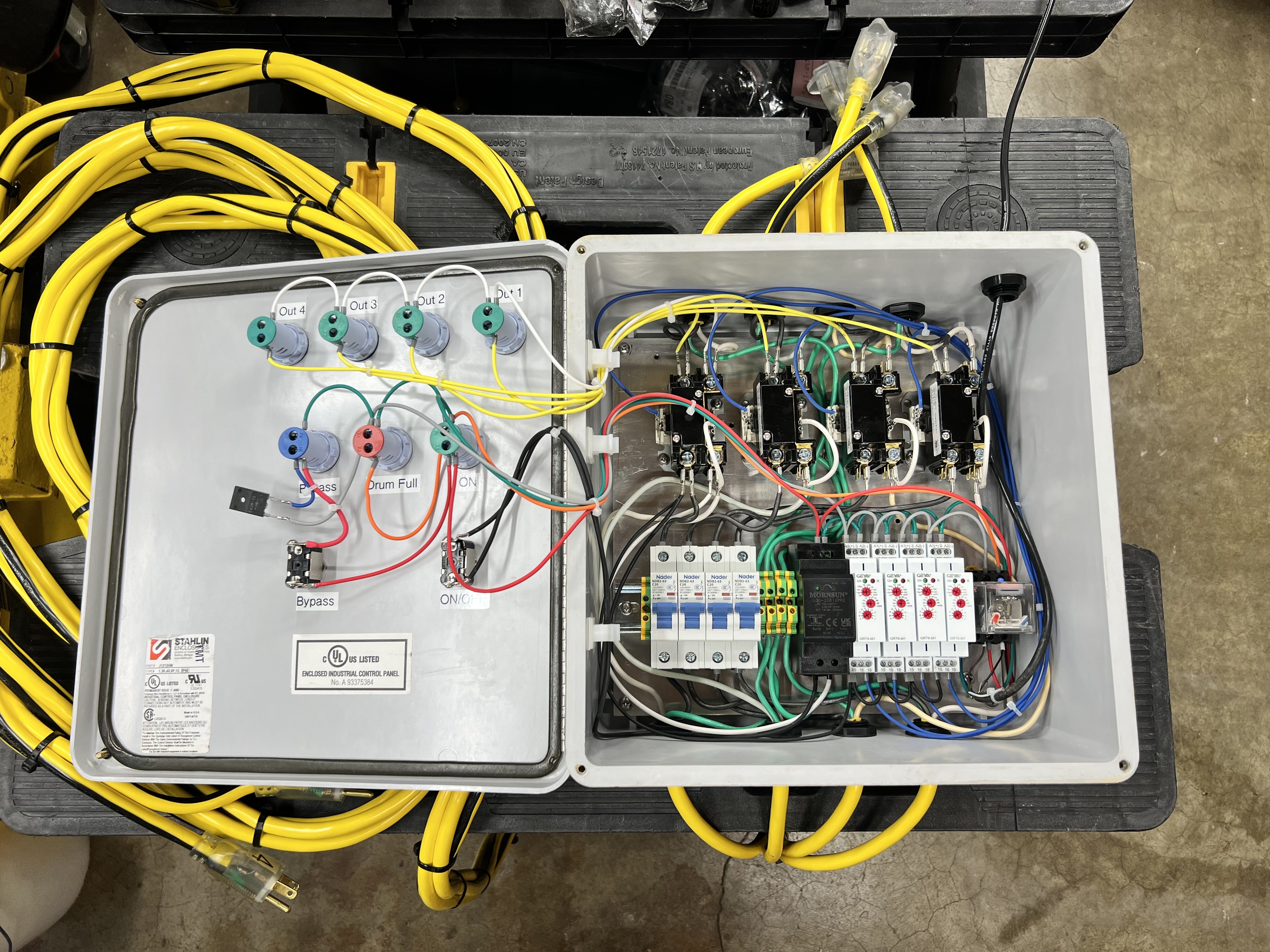

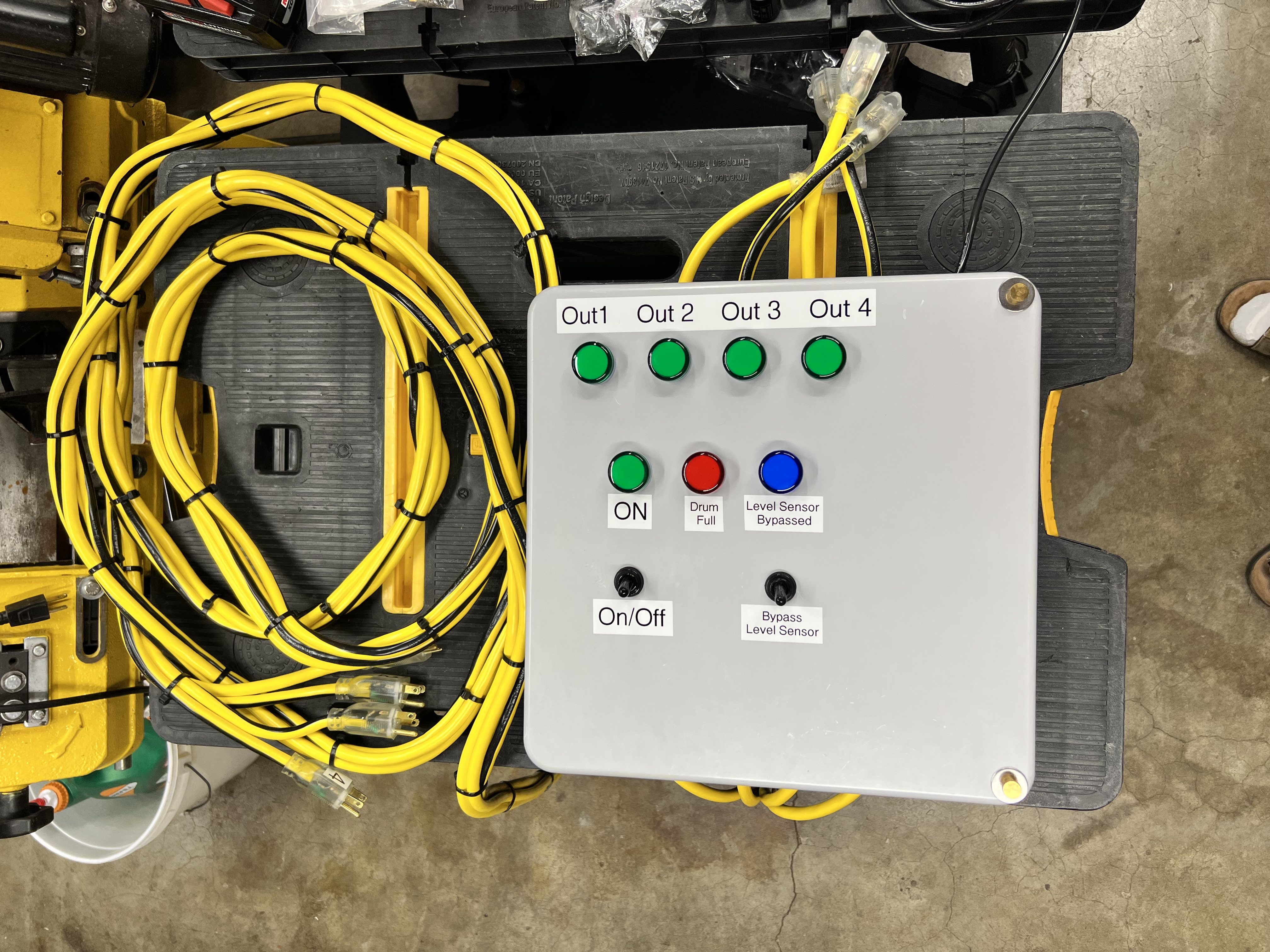

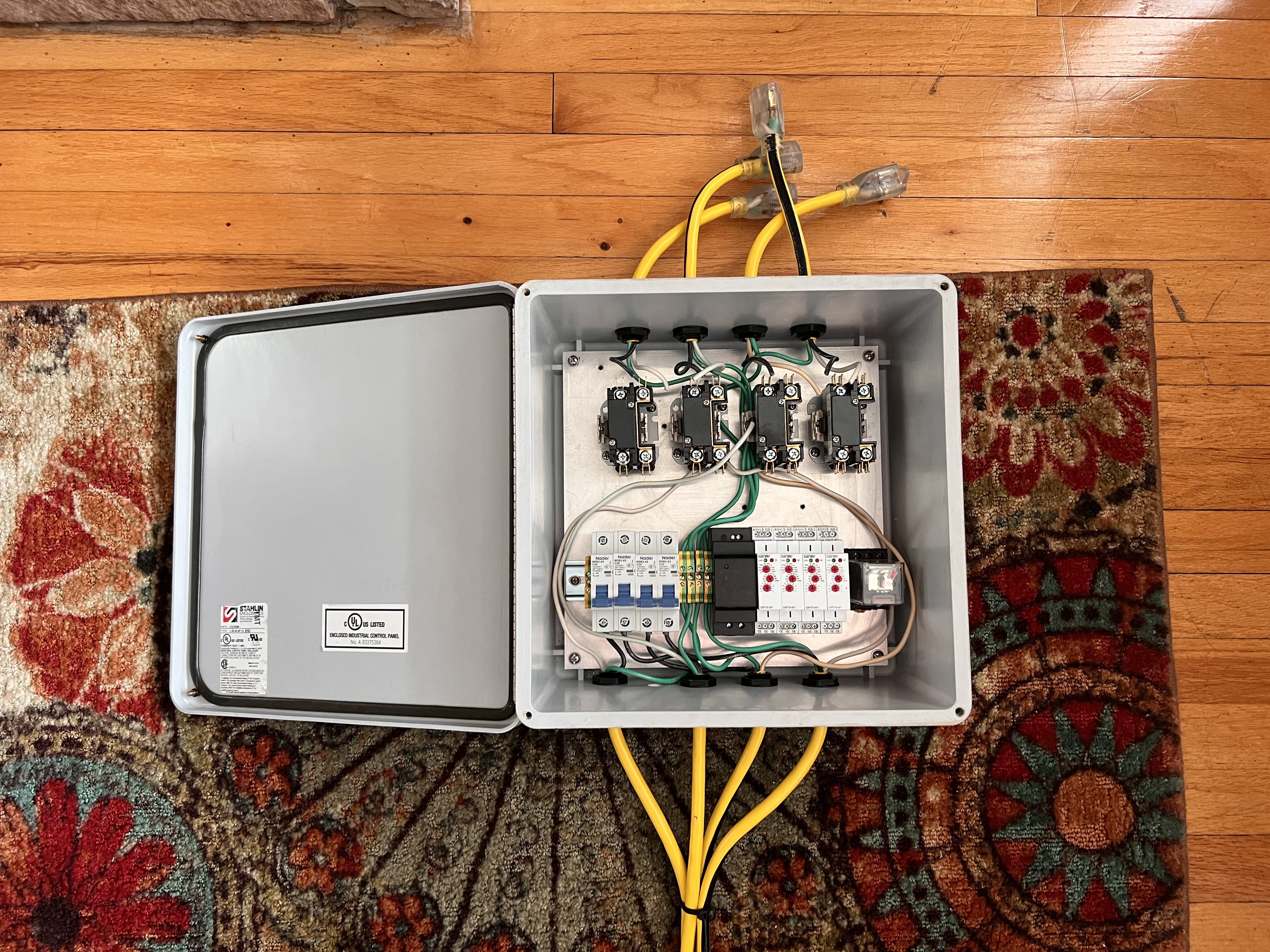

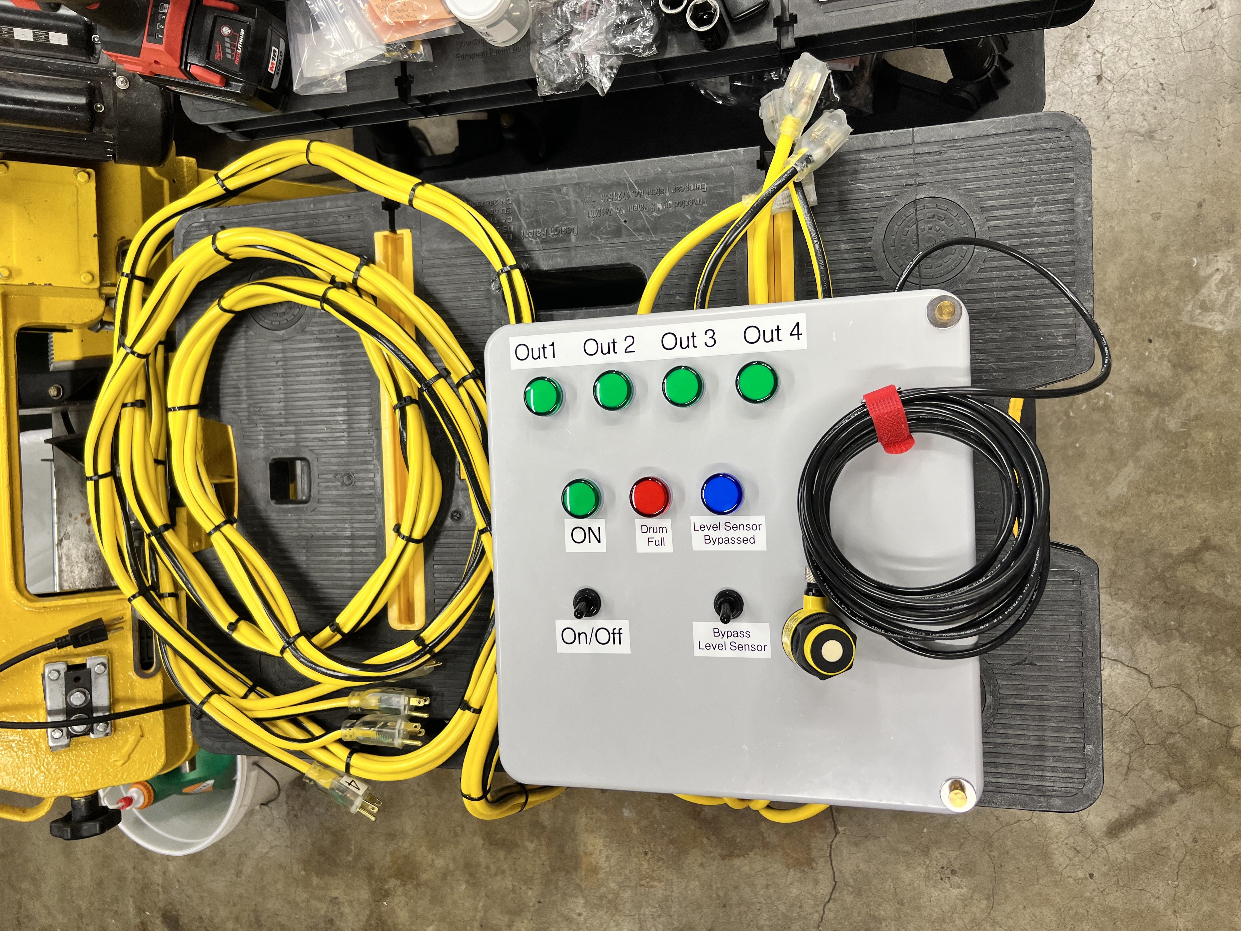

Vacuums Sequencer
As a fun side-project, I'm assembling a box that controls the four shop-vacs a bit. It'll turn them on sequentially with a second or two pause between each, and when the primary drum becomes full, an ultrasonic sensor that monitors drum fill will trigger turning them all off.
This is just slightly more complex than I like to build without some kind of line drawing, but I haven't found a good tool to do this sort of thing. Kicad will auto-adjust lines but is lousy for working with images, and Inkscape is easy to work with images but every time you have to move something, each and every line must be manually adjusted (AFAICT), so just drawing something like this took about as long as it'll take to actually assemble it.
The image below is ~13Mb, so you'll probably have to wait for it to load. Also, for full detail you'll have to select it, RMB and "Open image in new tab" or something, as the image viewer here is kind of limited in how it can display large images.
My power supply for the vacuums is a 240v 50A 14-50R extension cord from an EV charge station on-site, and a 14-50R->6-20R 4-way splitter: I have four 120v 20A 6-20R receptacles available.
This box has four 25' 12 AWG extension cords, which I cut and use for both in and out.
AC INs come in on the four cords.
That's all there is for the 120v side.
On the controls side, there's a 120v->12vdc power supply feeding four time delay relays (TDRs). Upon power-up, unless the drum is full, they will turn on their outputs at staged times, and the drum level sensor can turn them off via that relay on the right. The TDRs' outputs are the triggers for the contactors; I used separate, discrete power contactors because I do not trust these Chinese TDRs' 16A output rating for inductive loads like brushed motors.
[Update Dec2025: I've added 5th TDR on the output of the drum full sensor, so that momentary readings of "full" aren't turning the whole system off and back on all the time. Now, a "full" signal needs to be active for a solid ten seconds before the system shuts down. I haven't tested with dirt yet, but thinking it over this is the kind of problem I've had to design around in the past, and I had a spare $19 TDR anyway . . . it took two hours to update the drawing, and two hours to install the extra TDR and modify the wiring, lol.]
The above is the meat and potatoes of the box. The rest is decoration/feedback, an ON/OFF switch, and a way to run the vacuums even if the drum level sensor thinks the drum is full: a way to bypass the drum level sensor, in case it doesn't work out, or for testing or whatever.
I'm up to around $625 $761 [Dec2025] on this box alone ATM. The big-ticket parts are the four extension cords, the (used) project box, and the ultrasonic level sensor.

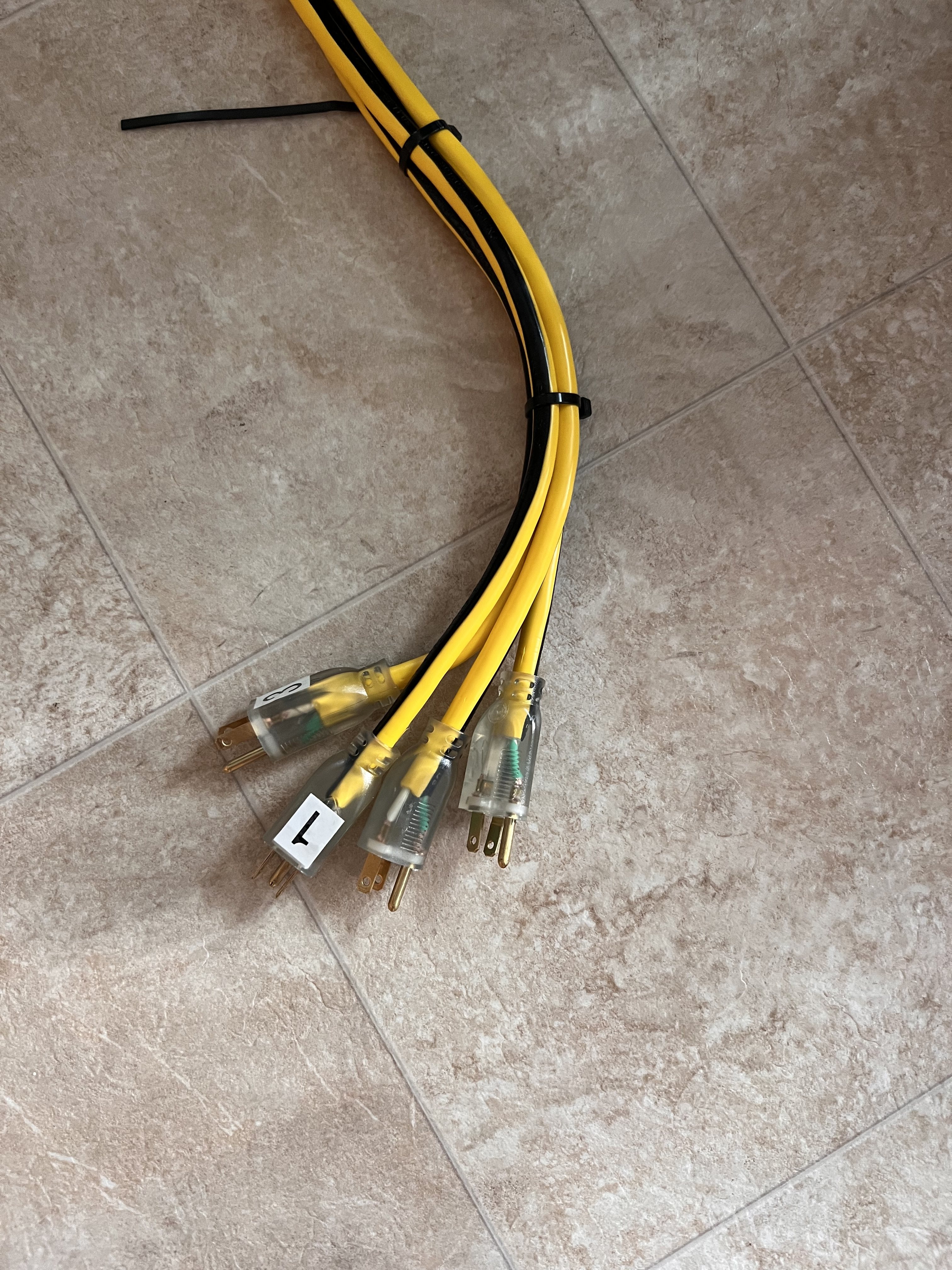

- The Neutrals route up to four 30A contactors, where they're passed through to the OUTs
The Grounds meet at a ganged feed-through terminal block, and are passed through to the OUTs

The vacuums sequencer box seems finished. I have the ultrasonic level sensor set to turn off the outputs when the drum is filled to 12" from the top. I sure hope it works with dirt.
I started with a used enclosure from eBay
I gutted it, cut the extension cords into INs and OUTs, installed the DIN mounting rail, breakers, etc. and began wiring the 120v stuff.
I was going to sleeve the IN lines, but got around 15 minutes into that and gave up. I went with nylon wire ties instead. Not quite as nice, but I couldn't shove that braided stuff over those cords by myself.
After testing the 120v side and the TDRs, I installed the controls (switches) and indicators.
It's "working as designed" on the bench
I've got some SS flatbar coming to make some straps with hooks at the top, so I can hang this on the side of the dump bed when at the jobsite. And lift it off when moving the truck. The cable to the level sensor is only around 15' and I don't want to extend it, so this box stays close to the primary drum.
