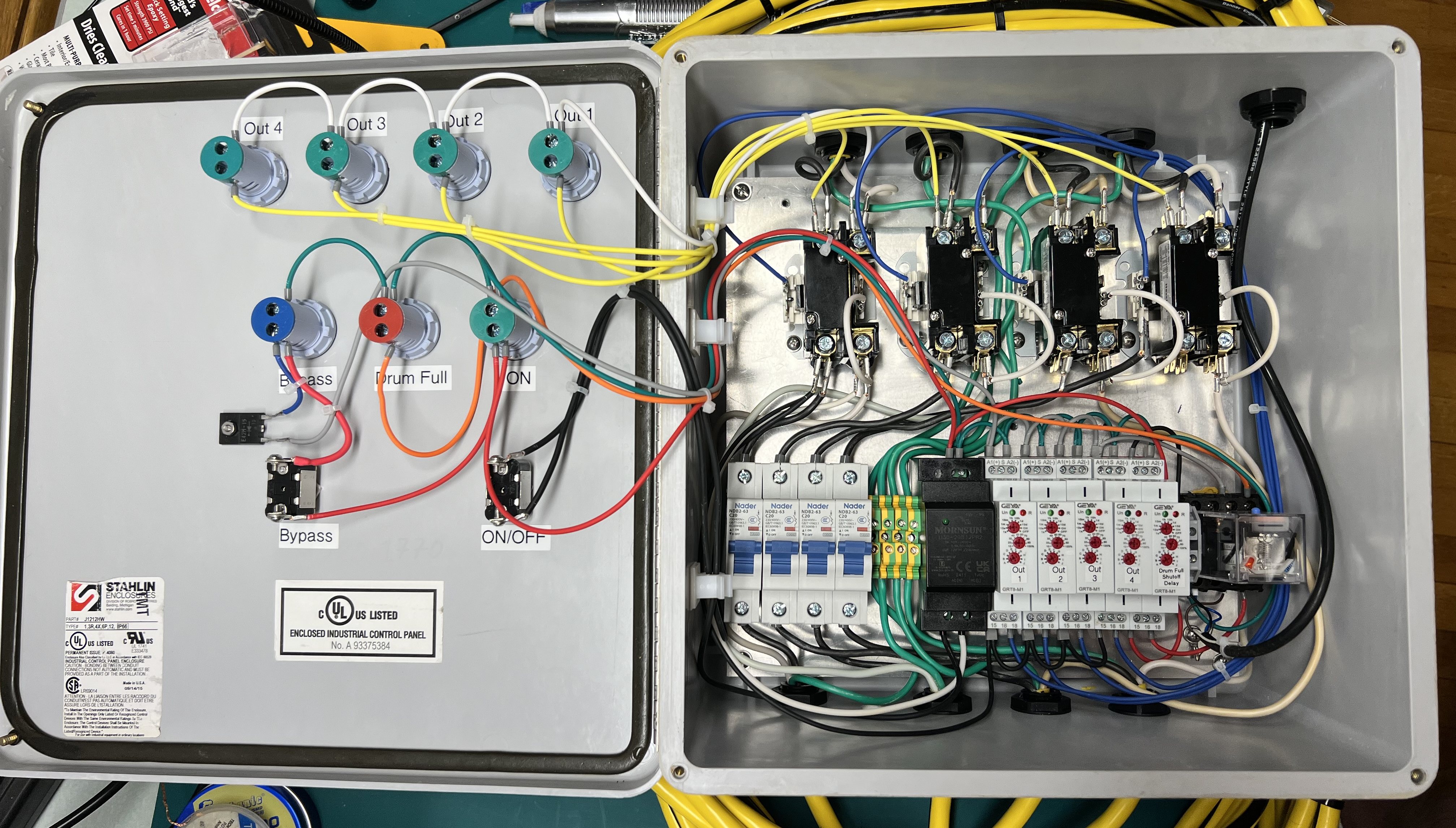

I got to thinking about the vacuums sequencer, and decided that I need to design for the situation where the ultrasonic sensor decides a burst of heavy dust or whatever is "full" and sends a one-second "turn off" blast, shutting the system down and then immediately restarting it. Today, I installed a 5th TDR on the sensor's output that delays turning off the system until the sensor outputs "full" continuously for 10 seconds.
Two hours to figure out how to use Inkscape again and update the drawing, two hours to add the relay, change some of the internal wiring, including adding a couple of segments, and bolting down that diode. The outside looks the same, but five time delay relays instead of four, and some cute labels on them:
It's getting kind of crowded in there, and my lack of controls (building) experience shows, but then nobody will see this, so who cares?

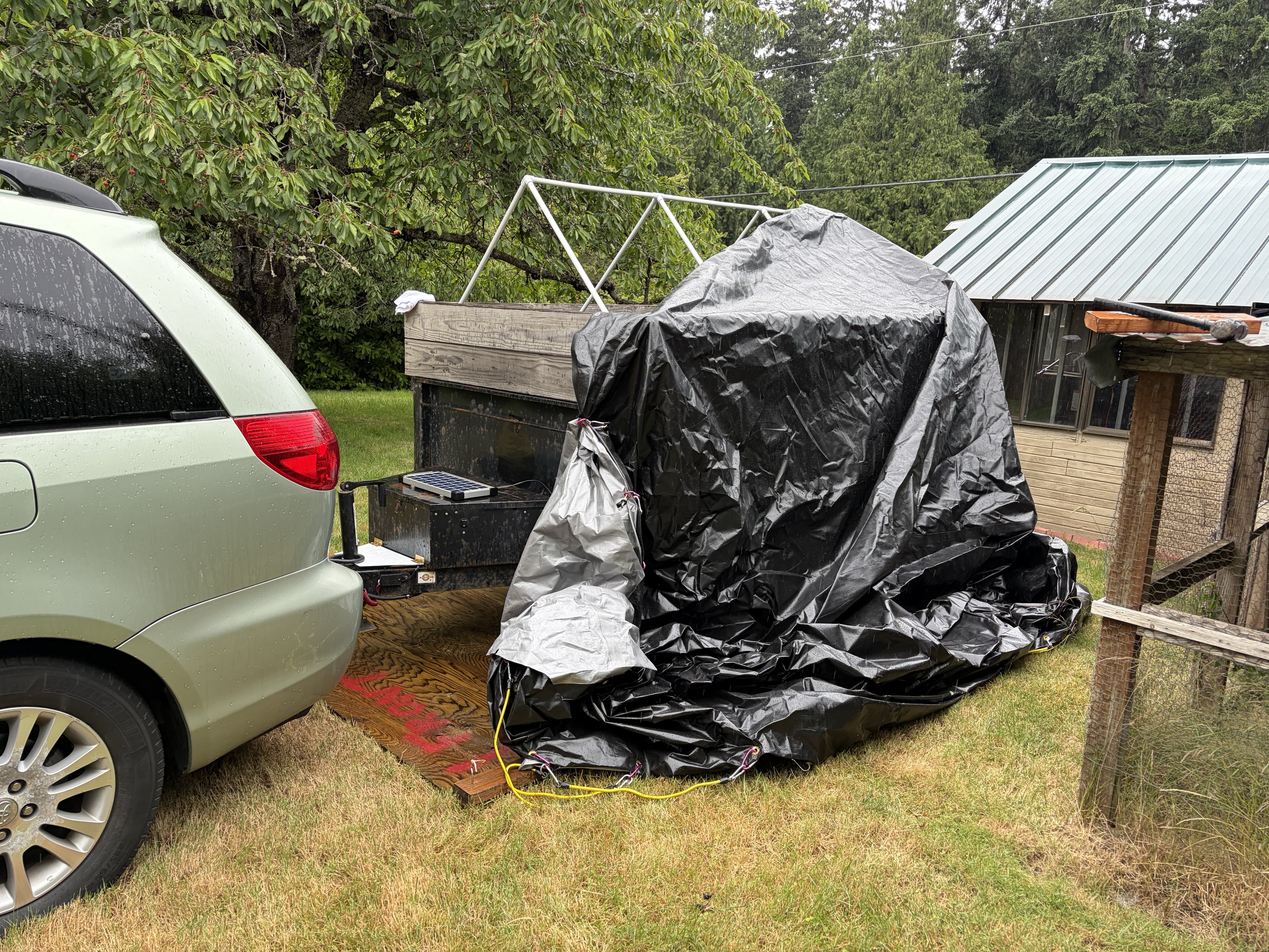

This is what it looked like tarped: There shortly developed fish pond in that large ceiling: A "tent pole" fixed the ponding: But the sides still flapped about a lot, even with twenty bungees and ropes and tying arrangements. The four top corners ripped eventually.
The framing and ceiling prop, shown during the "rebuild" when the first tarp failed: So I had to throw another couple hundred at plywood: Re-tarped with a new tarp, this has made it six months without ponding or the corners quite failing again. It's about time to get to plumbing it again.

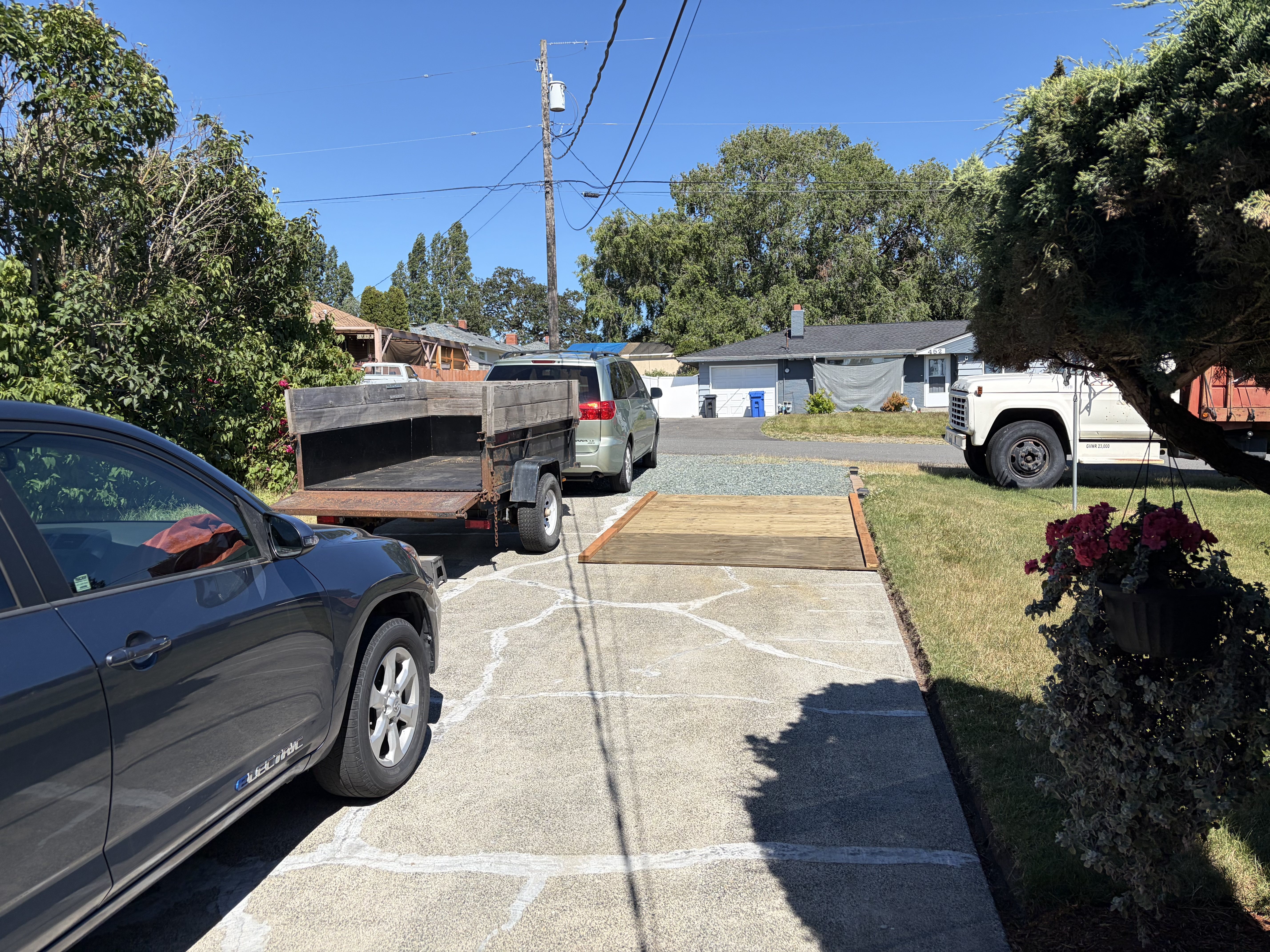

Dump Trailer
Technically, this is not part of this project . . . yet. But I've wanted one for years, so . . .
Late last year I was finally able to locate a baby dump trailer of sufficient capacity to serve as an alternate dirt mover, should the four shop vacs be unable to lift dirt 12' to the top of the primary cyclonic separator. The dump truck's bed is at about 4' from ground, whereas the dump trailer's is closer to 2'. A downside to the trailer is that it probably can only hold a fraction of the drums that the dump truck can, but in case lift is an issue, I will use the trailer and live with more-frequent drives to dump.
This is a 5'x8' Nov2017 Carry On trailer with a 5k lbs GVWR, 3,625 lb capacity, making this weigh around 1,400 lbs empty. It has electric brakes. As-purchased:

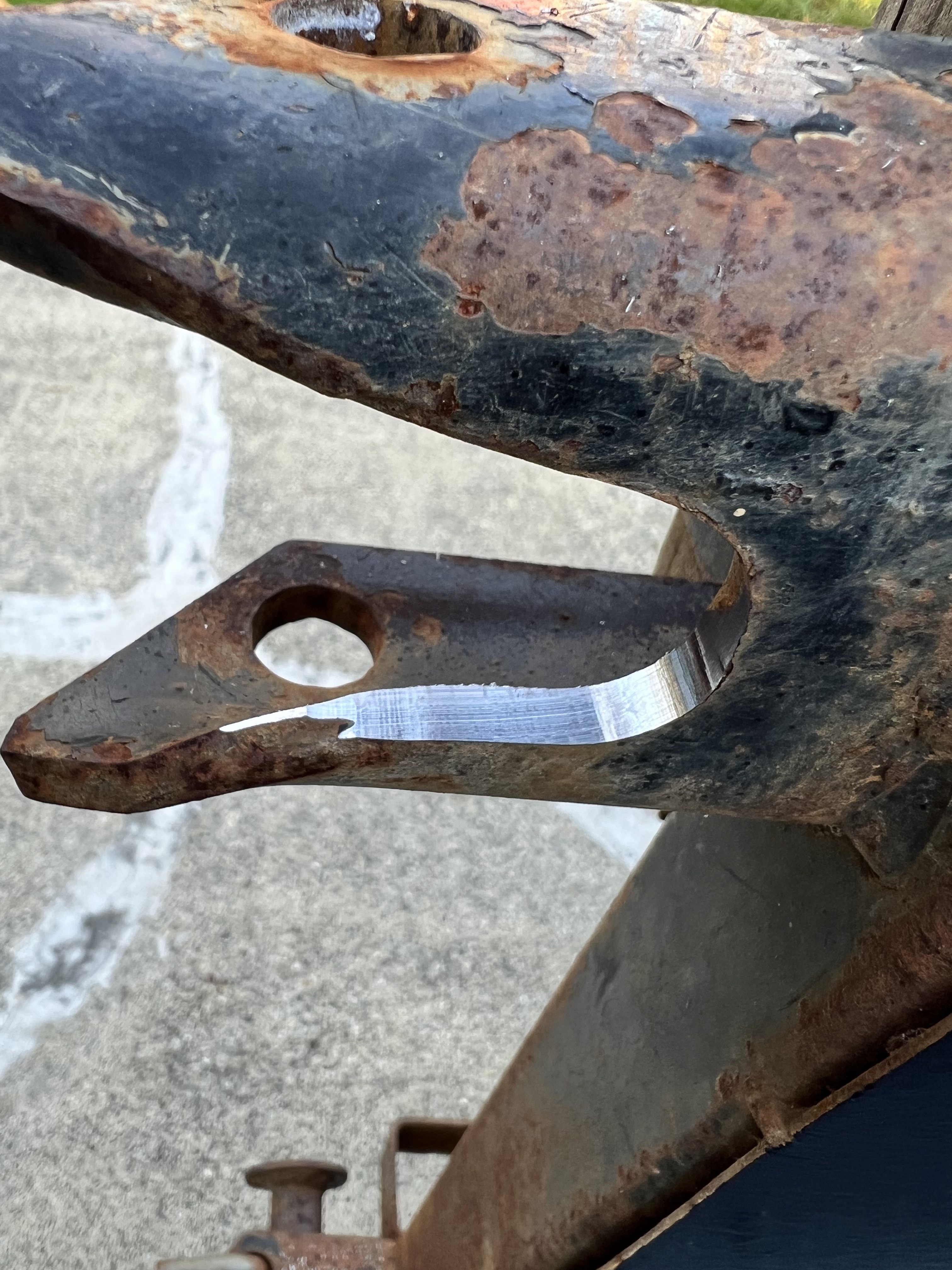

This trailer has led a hard, short life. Lots of rust showing in its nine years, and some tweaked metal, but it will serve.
The plastic shackle bushings (why do they always use plastic?) were shot, of course.
I got those sorted with some proper bronze bushings and new pins with cross-drilling and grease zerks.
I pulled a drum, and the brakes looks good enough to continue running. The Chinese trailer tires are OK, too.
The bed had what appeared to be rusted-on sand. Some serious pressure washing and three coats of brush-on Rustoleum should slow down further damage. I bought (2) animal stall mats 4'x8' and cut them to 5', layed cross-ways in the bed, to prevent impacts from going through my new paint
I want to keep this trailer, so I bought a PacLock coupler cover. These aren't cheap but you aren't going to take them off with an angle grinder in 10 minutes, either. Made in USA, SS lock body. Then, a matching, keyed-alike, coupler lock (pin type). It can be cut off quickly, but it's an added layer of security anyway. I bought two of those, one to lock the coupler, one to lock the battery/pump box.
Yes, you can drill the lock core, but you'll lay on your back to do it, chips flying in your face. I'm going to make you work for it.
The battery box also houses the electrohydraulic pump. The magnetic solar panel was wired directly to the battery and has a nominal output of 16v, so there's a problem.
No "before" picture that captures the internals of that arrangement, but the hydraulic pump wasn't bolted down, nothing was fused and wires were running through the box without grommets, it was all a fire waiting to happen.
I eliminated the emergency break-way brake battery and wired that to the main battery, which I replaced with an Enersys/Hawker/Odyssey ODX-AGM34R (to match all my other vehicles). Added an external voltmeter (I do not recommend this voltmeter for outdoor use, the lens glare is bad), a circuit breaker, a Victron Solar Charge Controller so the solar panel won't fry my battery, a battery hold-down, and panel-mount bulkhead quick-disconnect for the solar panel.
When this trailer is tarped, the solar panel will need to be outside the tarp, so I build an extension cord to plug in an extra 10' of run, to allow that. But without the tarp, only 2' of wire is needed, so the extension cord can be plugged in-line for tarp duty. I used Deutsch connectors.
And I bolted-down the pump. That revealed a sort-of reason why it may have been un-bolted: the hydraulic hose routing led to chafing on the box, due to the design the builder chose.
I made a hard-wearing sleeve for that area:
That led me to the lights. Oh, the lights. Short story: the right taillight was wired backward, not a big deal, but cleaning up the lighting/brake/charge wiring at the front end turned into installing a junction box. I installed a Bargman 787535 and a new 7-blade pigtail, mounted horizontally where the old emergency break-away brake battery/controller used to reside.
Well, that pigtail had to move below the frame . . .
. . . because I didn't like that horizontal junction box layout for weather. It's not a gasketed box and water would run down the pigtail into the box. So I fashioned a cover, hinged and with magnets. The cover is aluminum, the hinges brass (not plated), the fasteners SS.
I epoxied some magnet stacks on to the leading edges. This isn't expected to catch a lot of wind, and it's survived a test run: The very heavy tailgate is tweaked a bit and needed some work on the press and welded up a crack, and a bit of die-grinder work to make it possible to get the pins in:
And I had to install a trailer brake controller in the Sienna, as this thing is definitely too heavy (loaded) to be muscling around via minivan without its own brakes helping out.

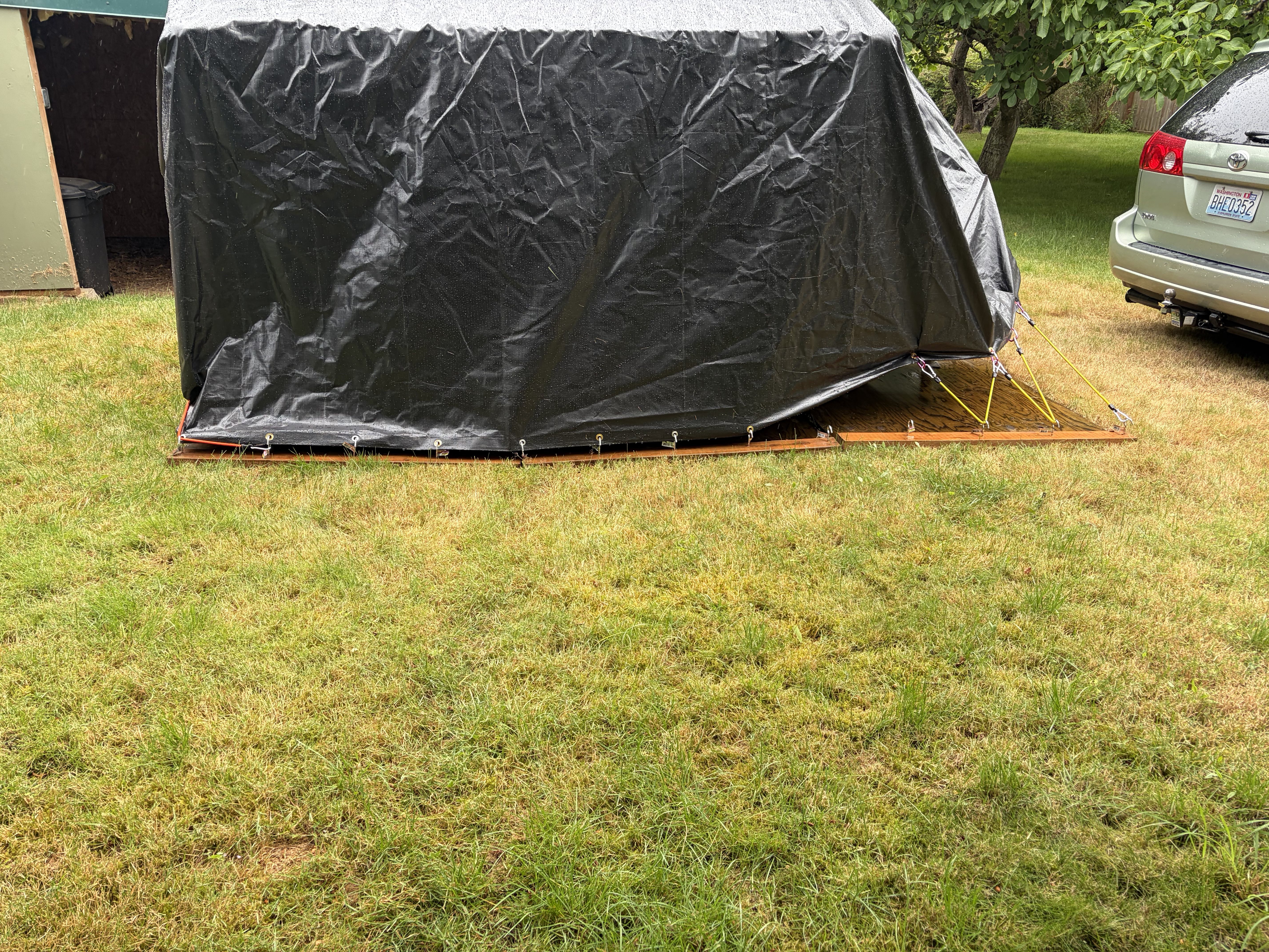

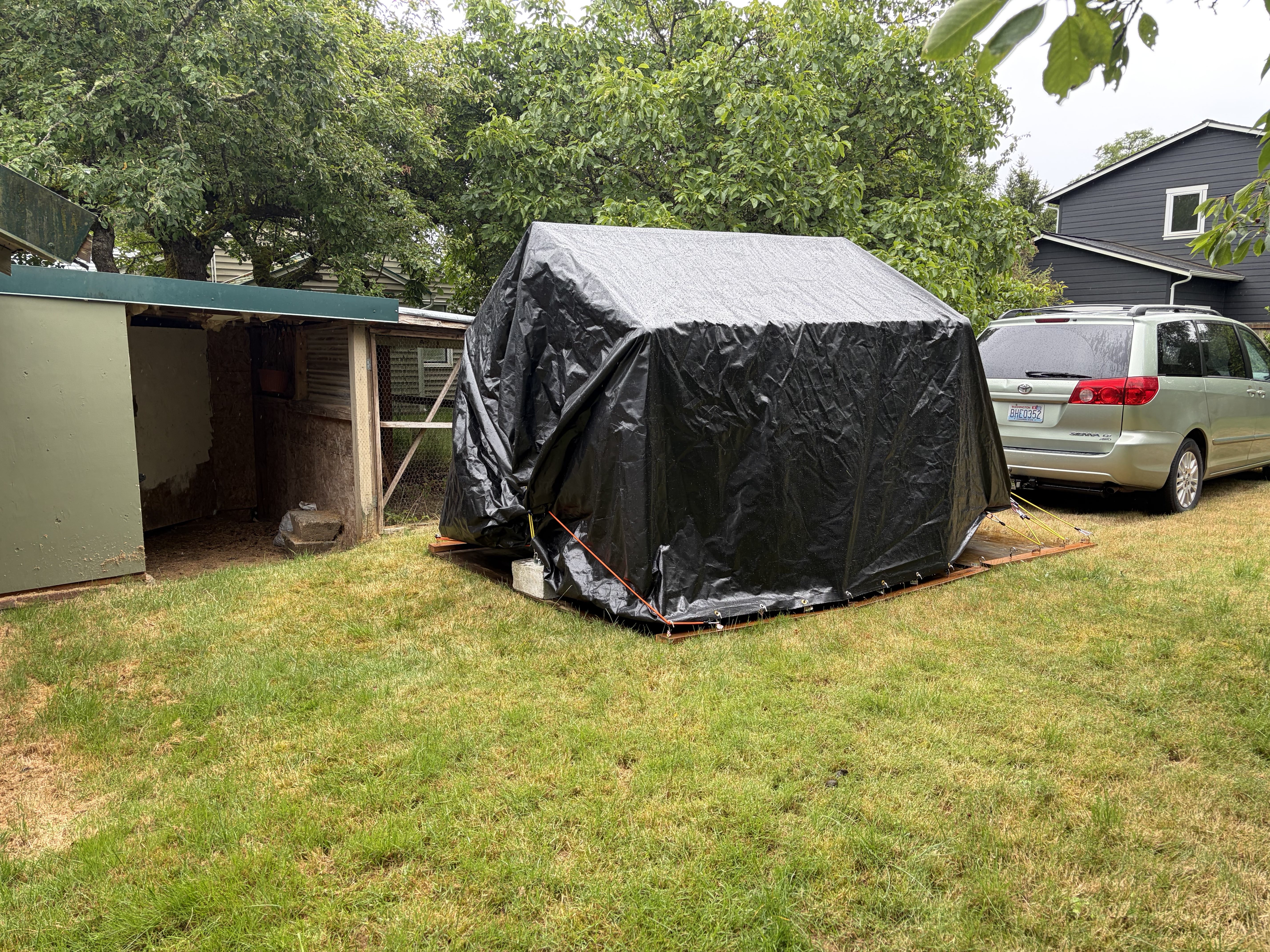

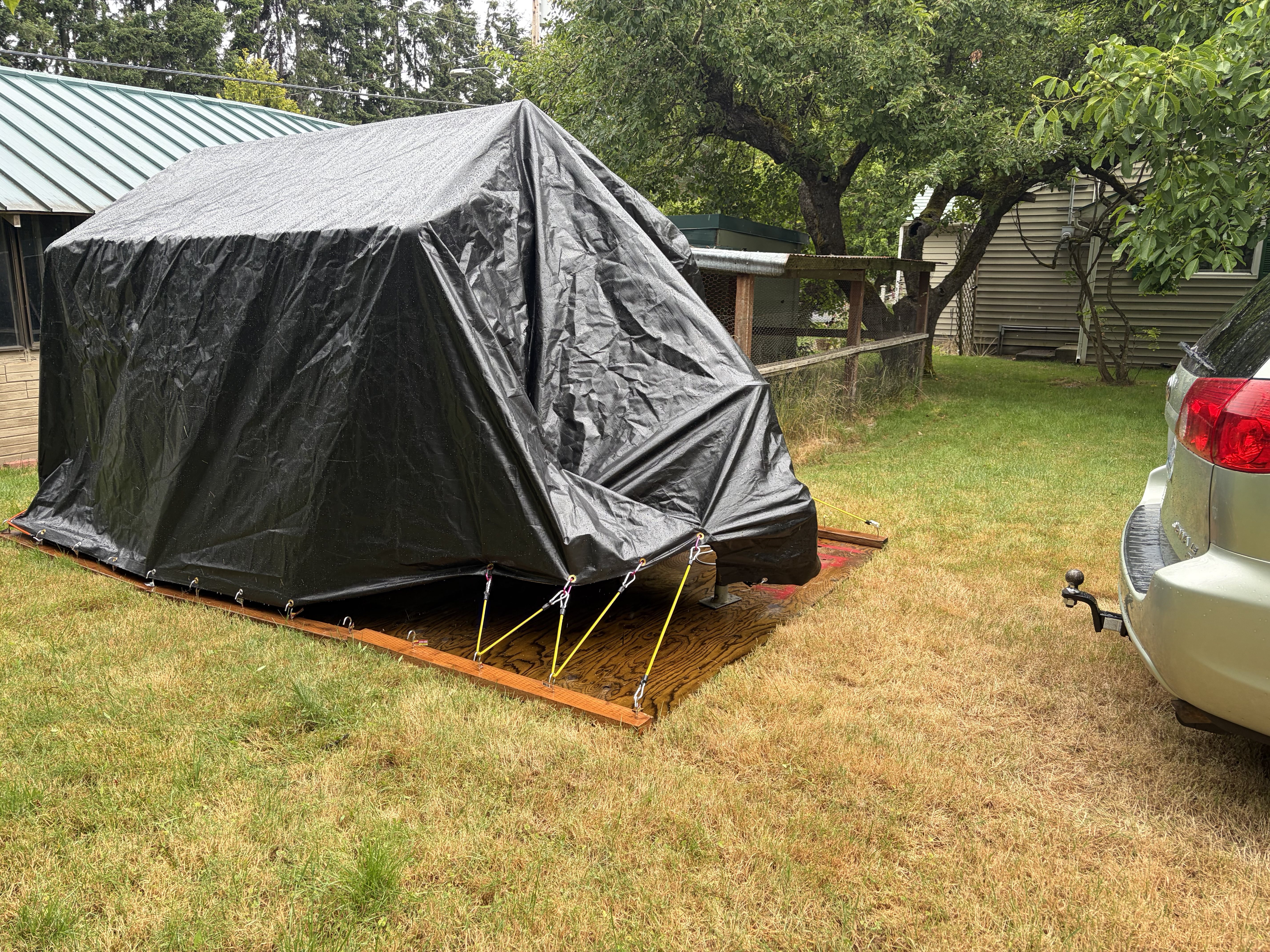

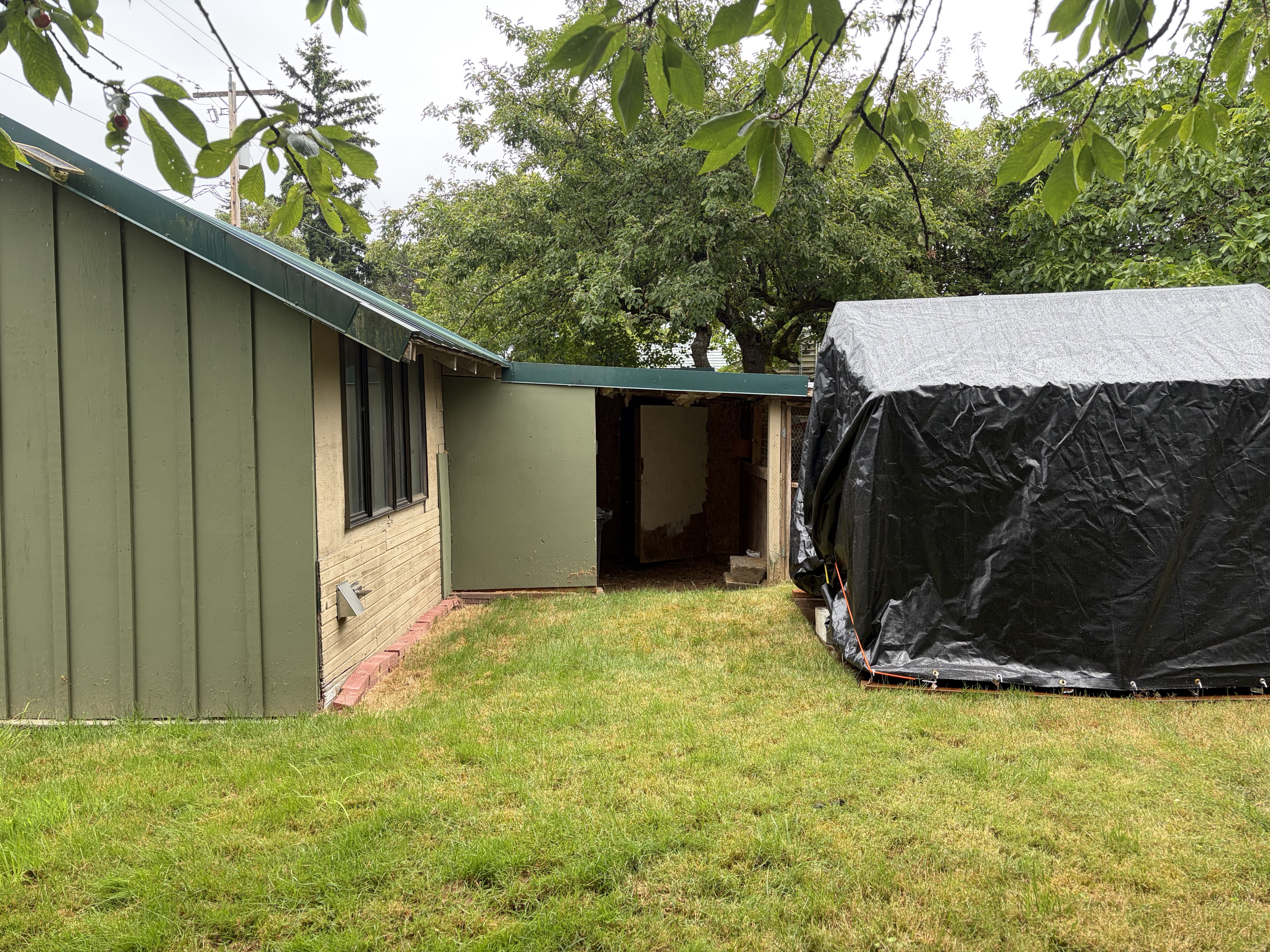

Dump Trailer shelter

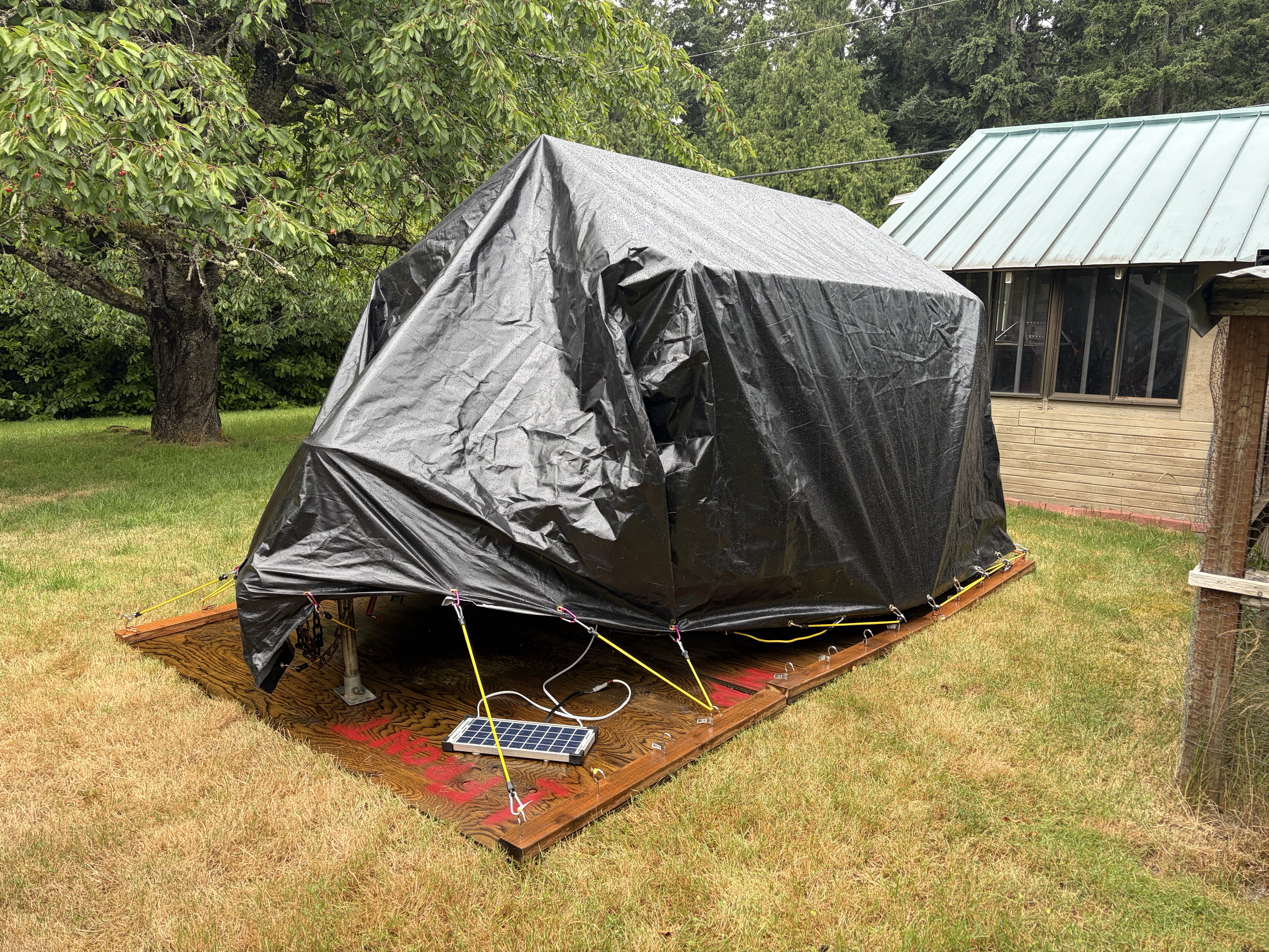

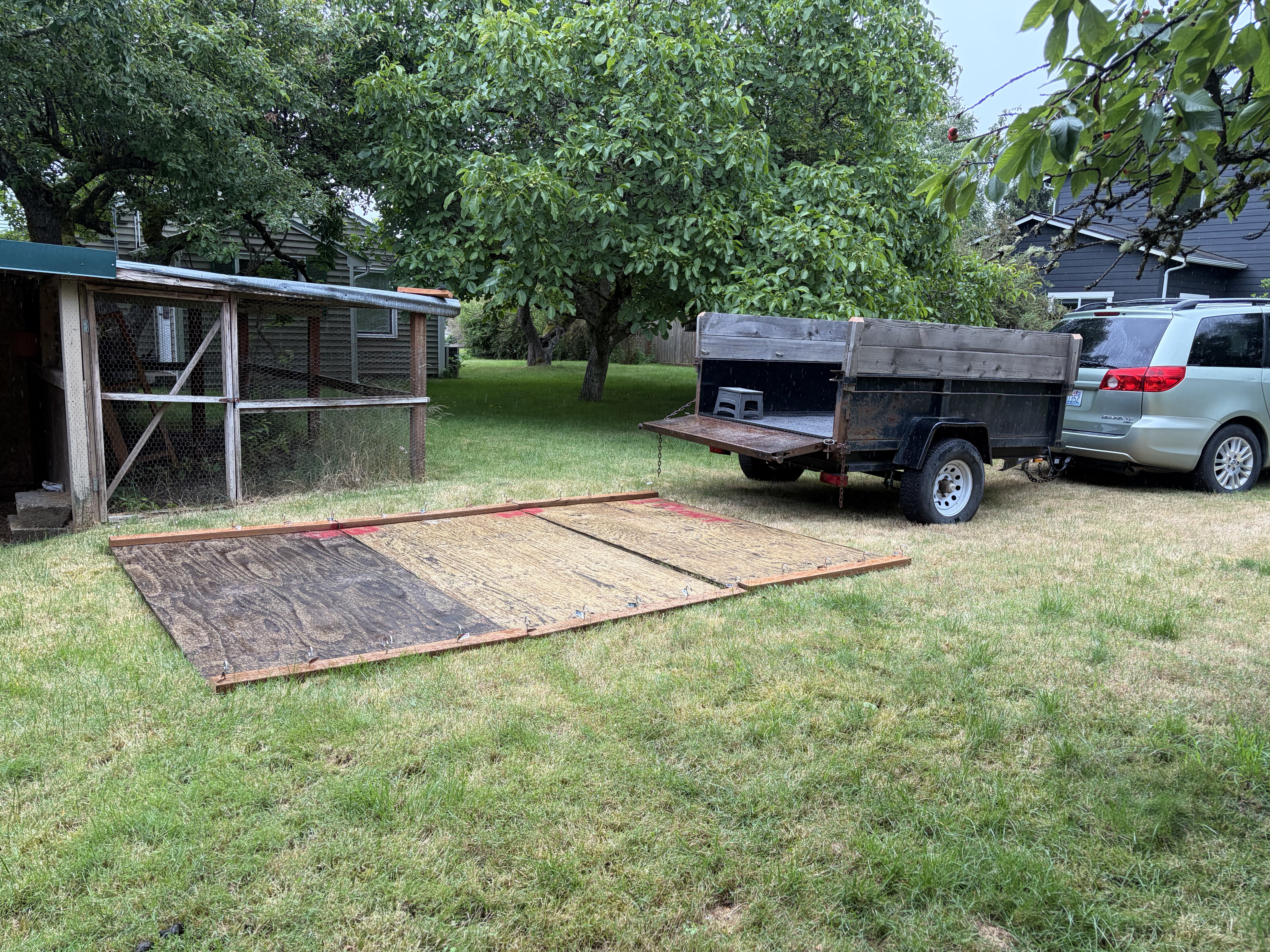

I do not have an out-of-the-weather place to park implements like this, and around here things degrade badly if left out in the weather. I am parking this in mom's backyard next to the empty chicken coop/chicken run, as there's been no live chickens there for over a decade.
Tarps are generally a one-season consumable, but wind is also an issue around here. I assembled a platform of 3/4" PT plywood, lined with SS hook screws, as a tarp anchor platform. I added grommets (kit, refill)along the sides of the tarp so the original 23"-spacing grommets weren't given a chance to allow the edge to catch wind.
There used to be a product, EZ Grabbit, that allows you to add a tie-down at any point on a tarp, but it appears they are out of business and the only examples to be found are on eBay for sky-high prices, so I pounded in a bunch of extra grommets the old-fashioned way.
I calculated the tarp size to not reach the "ground" to allow air movement and reduce condensation under the tarp, which is a big issue around here: you have to allow moisture to dissipate, or mold & rust. I first used a 12' x 16', with the 16' dimension sited "across", from side-to-side, but while the trailer is pretty much 12' long, I wanted some tarp down the back too, so I wound up buying a 16' x 20', with the 20' running fore-aft.
I roughly cut the forward tarp edges so the tarp in front would not be just gathered on the ground, and to install useful grommets and reduce excess tarp from flapping around. Hobby aluminum HF carabiners made attaching elastic cords a lot easier. Looking at my pics below today, I'll need to install more caribiners, as my experience with elastic cords on the truck's tarp last winter informs that elastic cords do not like rubbing on hooks; perhaps more carbiners where I've got the bare cords hooked to change direction will allow a bit of movement and reduce wear.
The center of the rear of the tarp is anchored by a block of concrete to which I fastened an ell bracket and carabiner; the rear elastic cords can gather to it.

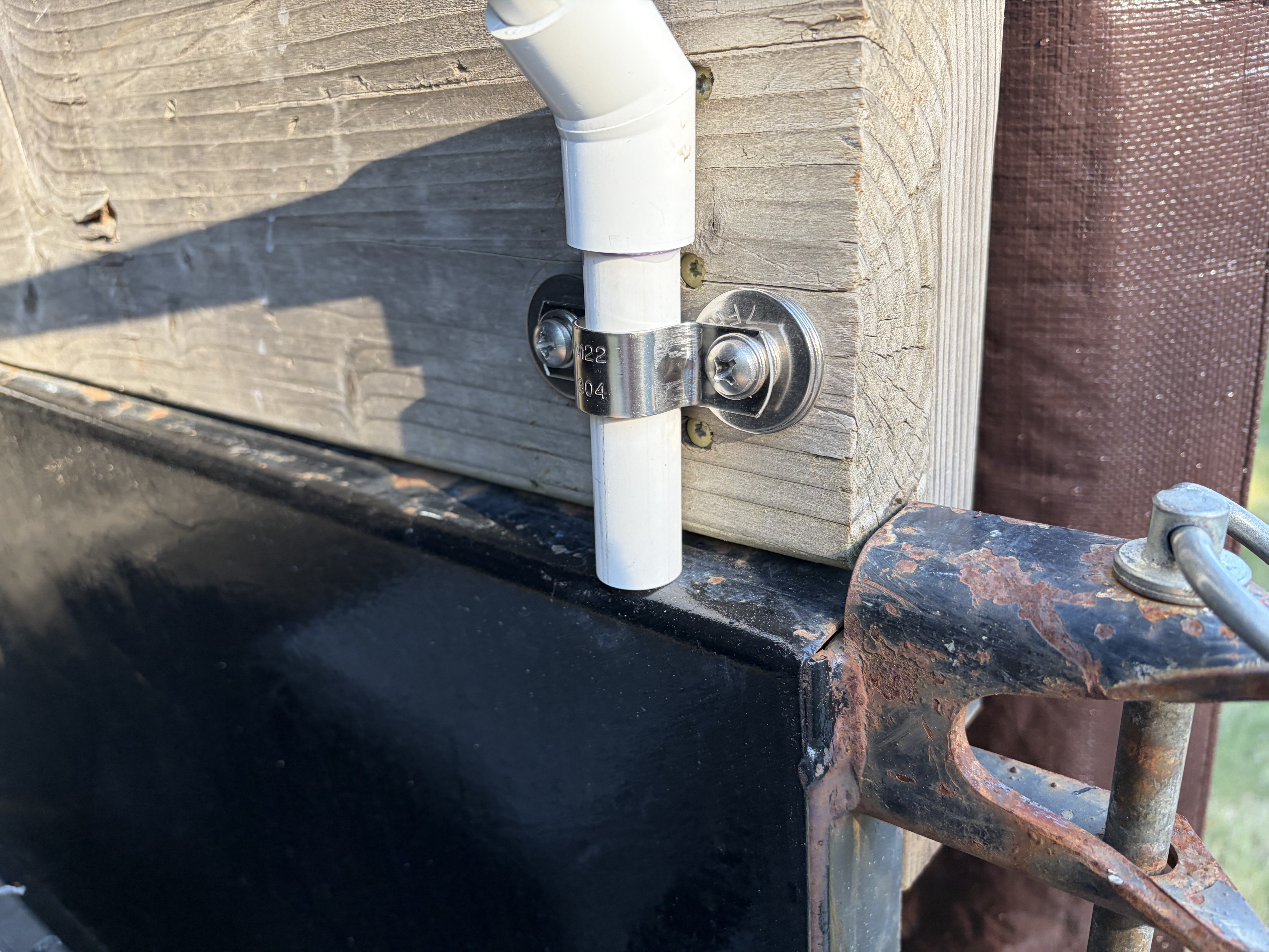

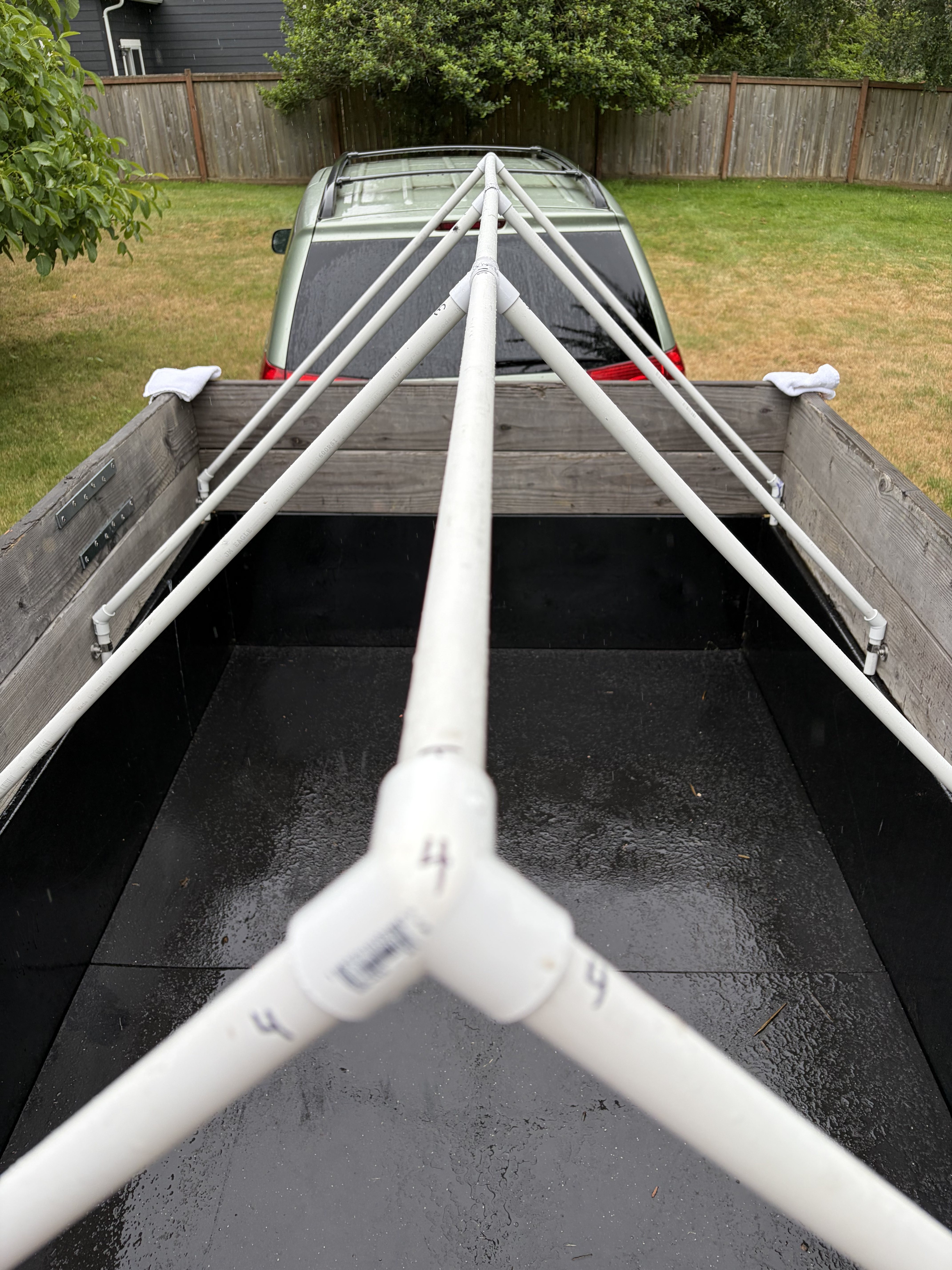

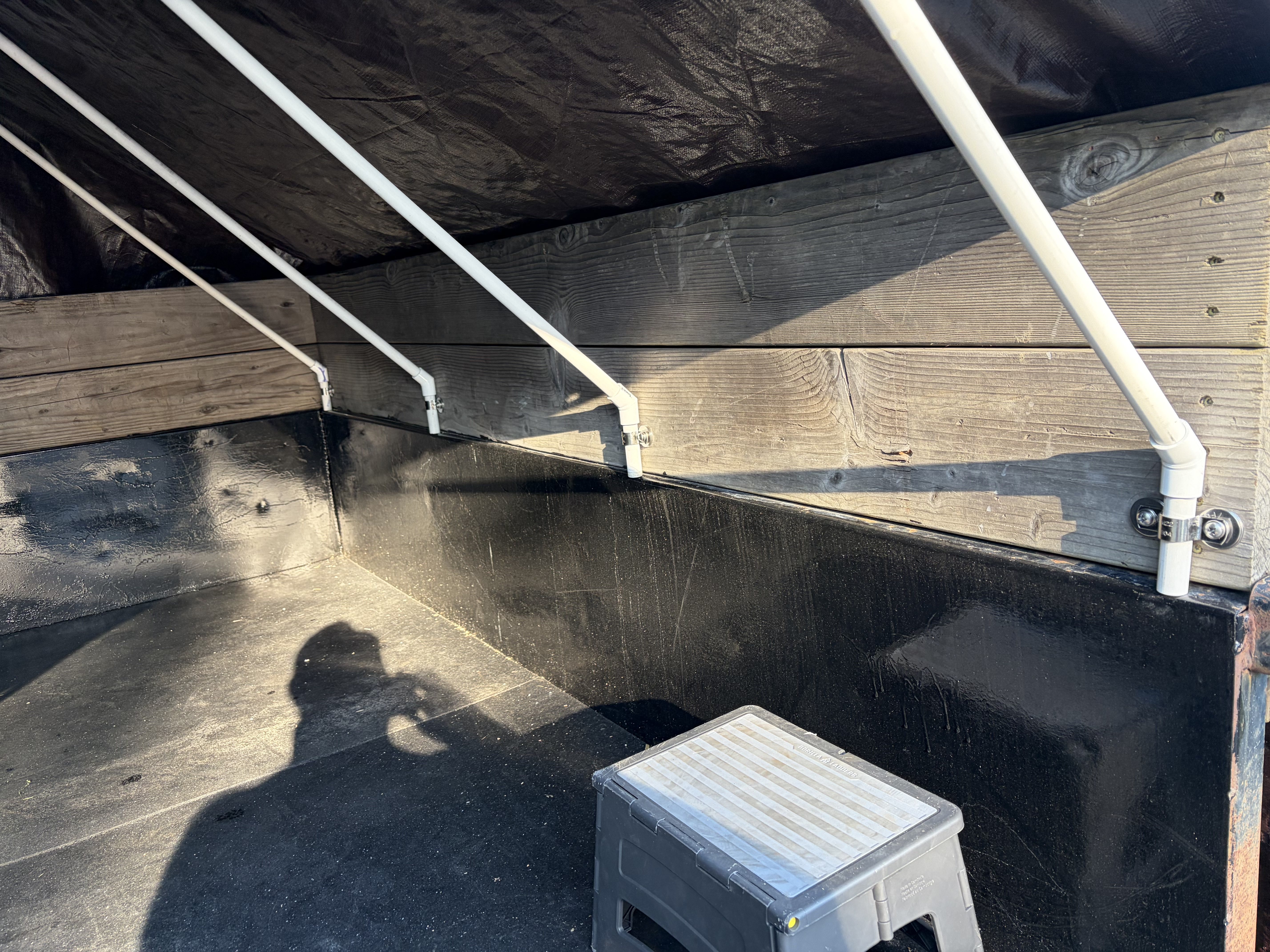

The "roof" is 1/2" SCH40 PVC, standard stuff, but the two center junctions (#2 & #3) are not stocked anywhere, they're a furniture-grade 4-way side outlet tee and I had to buy (10) to get (2). The rest of the fittings are just standard plumbing stuff: side outlet 90° and 45°fittings.

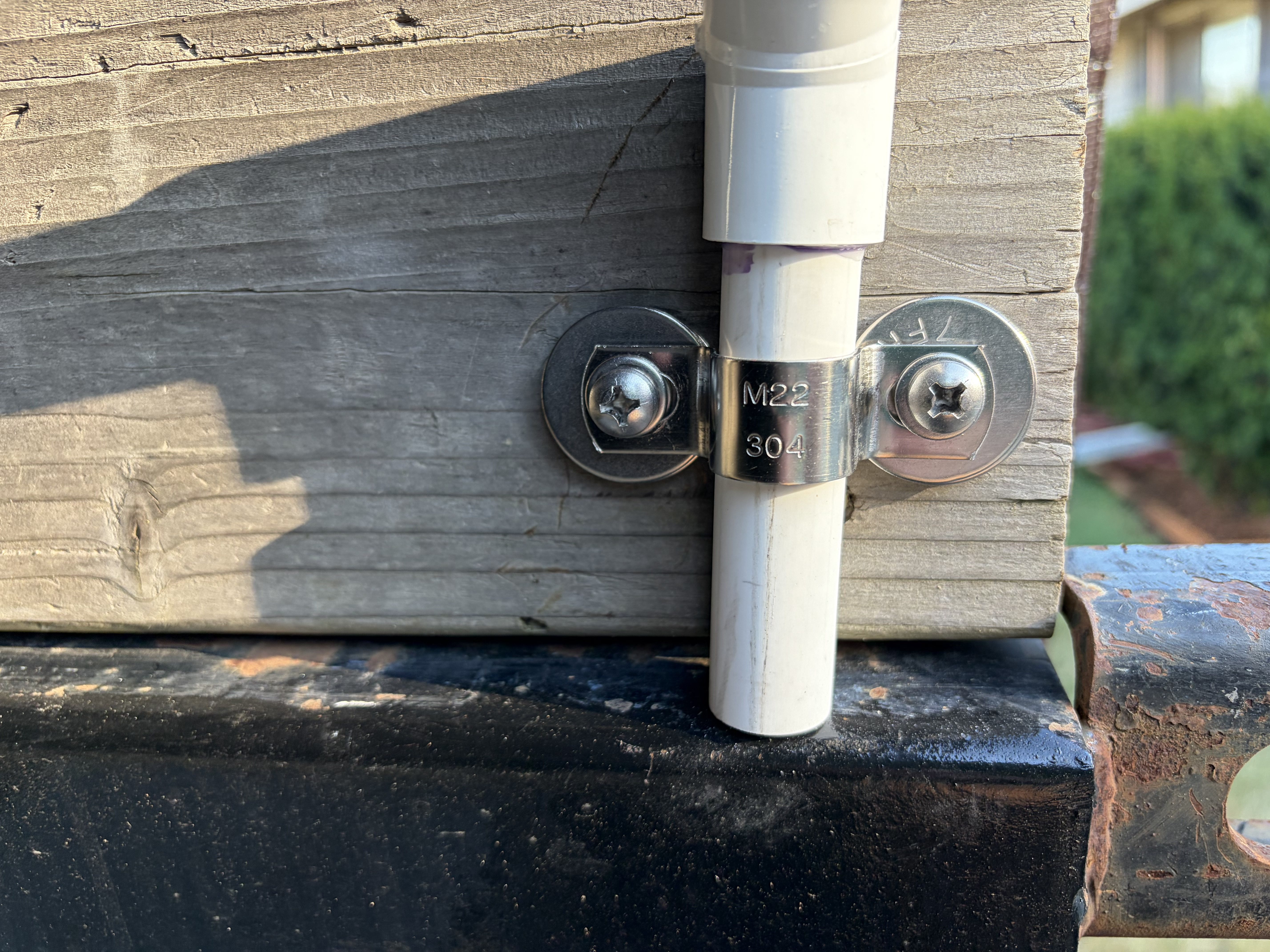

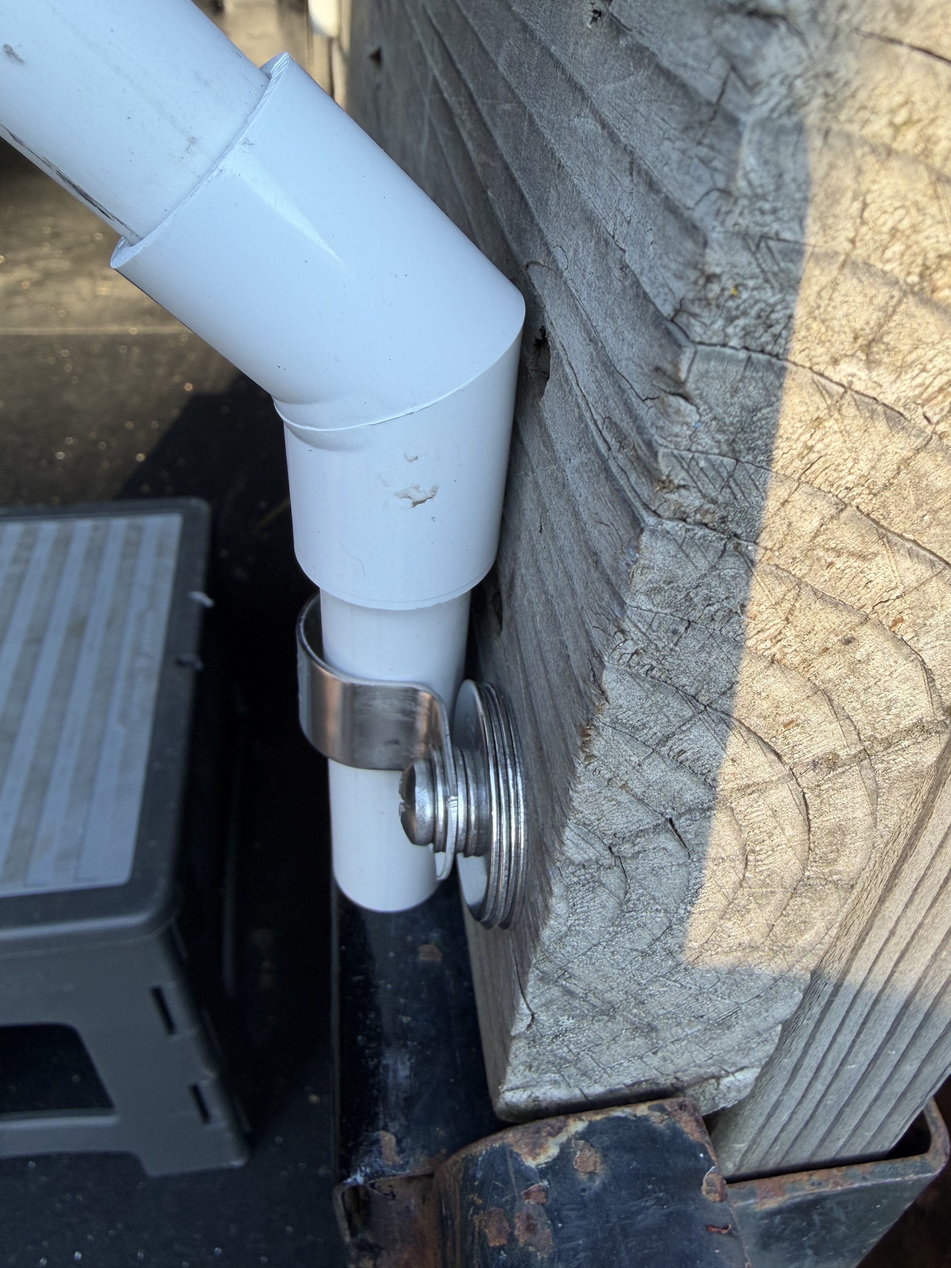

The bit trickier part was when I wanted it that roof frame easily removable, which I accomplished using some Peromi SS 7/8" U-tube strap clamps (my review) mounted on a lot of SS fender washers; I'd tried using wood spacers but they were generally unsatisfactory, so I went back to SS, my favorite. I like the Peromi Chinese brand for SS doo-dads, so far everything I've bought from them has been of reasonable quality.
(I'd tried these clamps first, but I didn't even take them out of the package, they were that bad, and I returned them.)
No parts are glued, and the soft-of truss sections just slide into those sides' SS U-clamps, so the "roof" breaks down into four sort-of trusses and three short ridge beam parts.

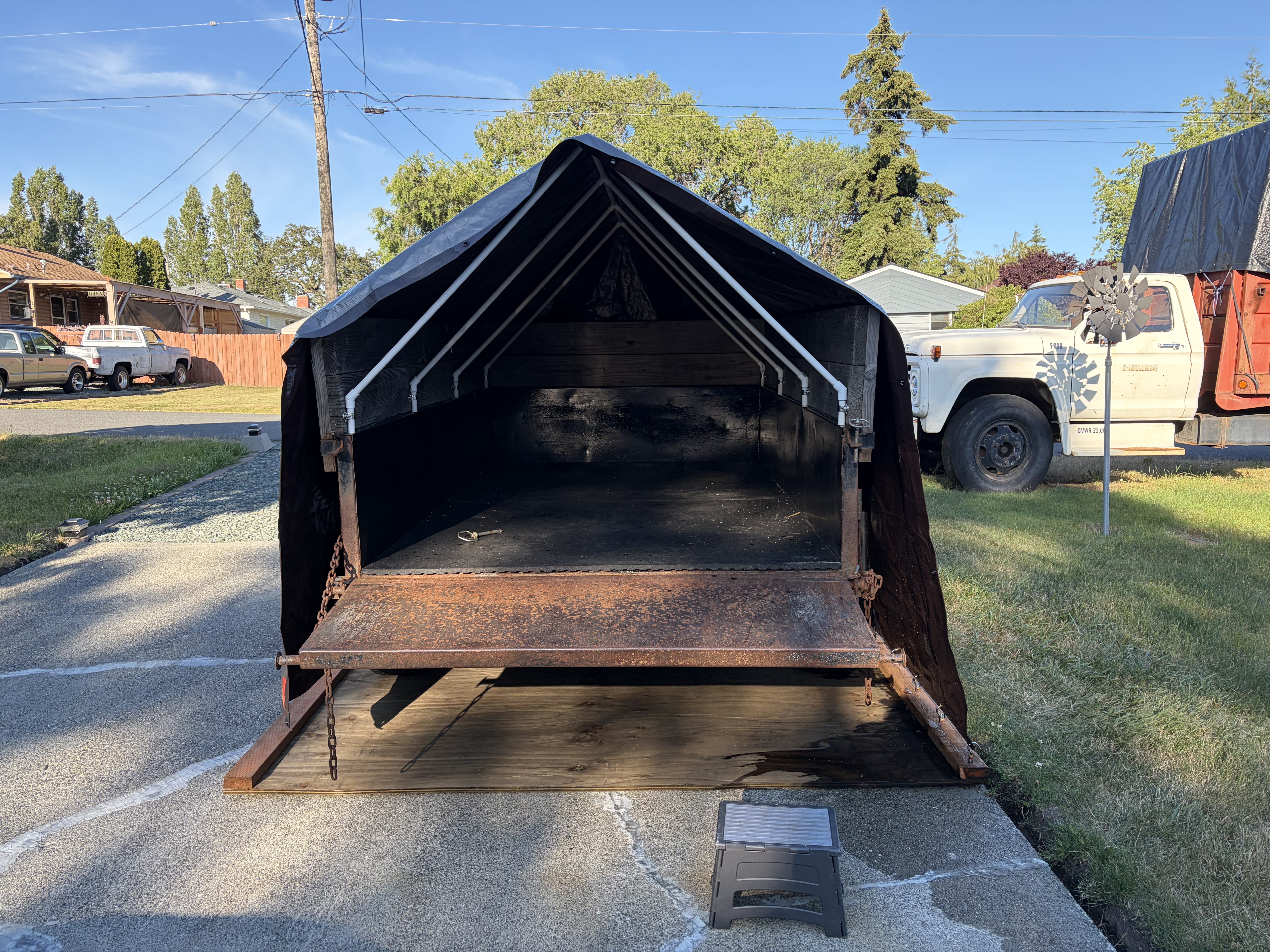

Mocking it up in my driveway pics, for my future ref.:
