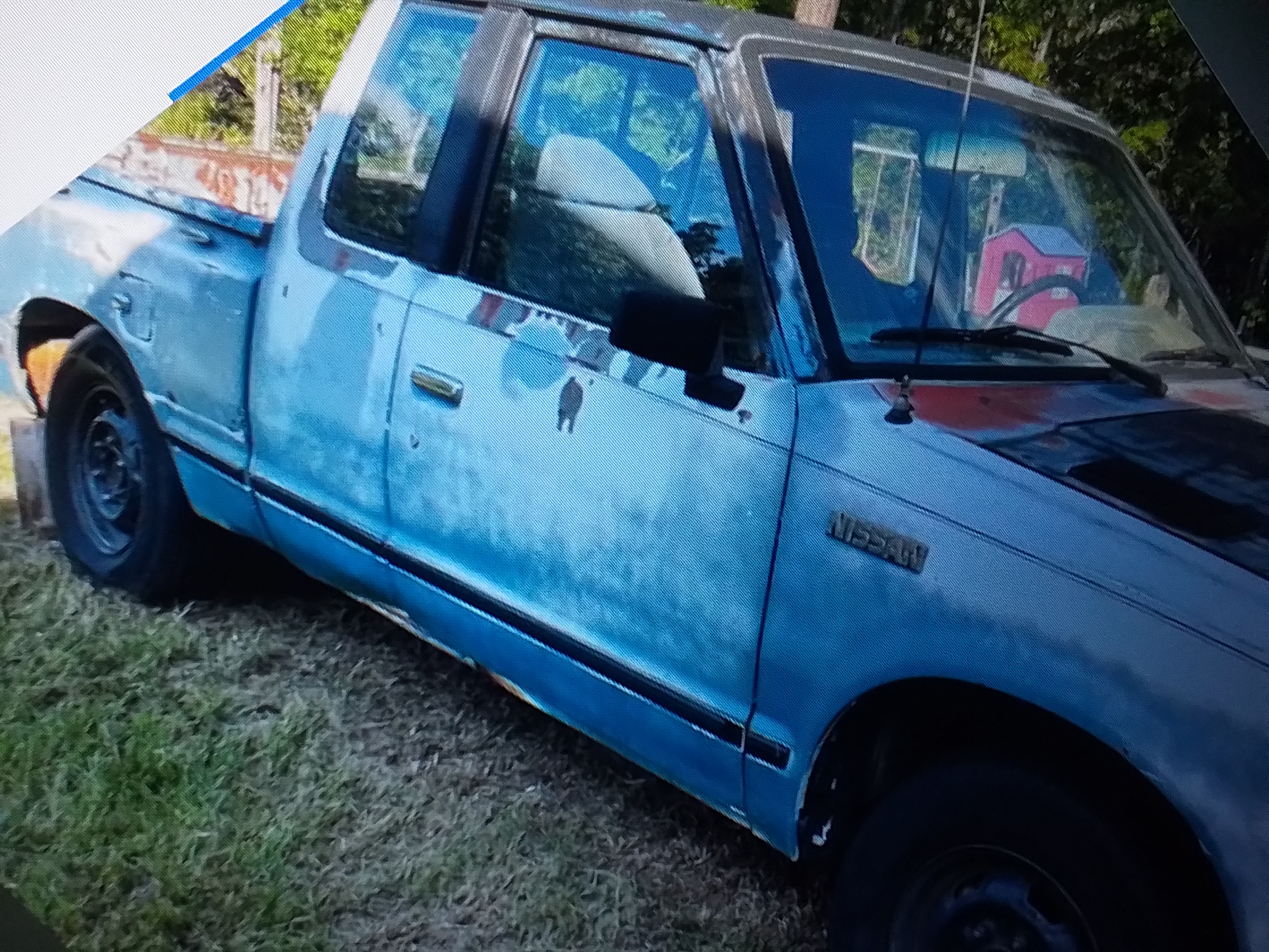

So it turns out it is a North American made truck with the sd22, which I thought didn't exist. 1983.5
I bought it for $900, and here in the southeast, these things are unobtainable with the diesel. Most of them have been scrapped, and I got it cheap. (I live in South Carolina, and the closest one is in Virginia for $7000, and it is not in the shape it should be for the price.) I obviously jumped at the opportunity to own it. The owner said it had rod knock. (It also doesn't have title currently but we can resolve that.) He was a young guy, and it was so loud to him he thought it had rod knock lol. I got it running, it had sat for about a year, runs good no knock. It has a good clutch and brakes.
The issue is it is not charging, does this have an external regulator? I would assume just to replace the alternator, would this be correct? I can't think of anything else. It sits at 12.7 v while running and the battery light is on.

I believe that it was mid 83 they changed the name to Nissan from Datsun.
The alternator will have an internal regulator.
If you have a local rebuilder then that might be an option to look at.
There are replacements out there (ebay etc) but it seems that some folks on here ( IIRC) had some issues with their longevity/compatibility etc. Plug fitment for one.
Yours will have vacuum pump on the back of it so bear that in mind if you go shopping. I think there are some out there that have the pump affixed to them, or cheaper without.
Perhaps open your vacuum pump up and check its condition before you buy one.
I believe that Al ( forum manager ) or perhaps it was some other forum member replaced the alternator with a standard type and mounted an external electric (12V) vacuum pump. This allowed for a more robust alternator to be used. The internal regulator on these is their weak spot.
I had mine rebuilt 2 times for this very thing.
A good battery is essential as these are really meant to maintain the charge after start up and not really to charge a dead battery after needing a boost. Boost jumping another vehicle is another thing to be careful with.
I think there is a post on this forum someplace ( I think by Al actually) that had some answers or experimentation with regulators, or diodes, or solutions that he came up with. Search alternators on the general forum.
I cant recall now what regulator the last rebuilder put into mine, but said that he used something different that "fit". ( a different Hitachi application I think)
That said I believe that alternator for the D21 was slightly different. ( but it's been a minute )

The best mileage I ever got was 35mpg with my SD22 powered 720 diesel truck without a turbocharger, that was going around 55mph to 60mph on the freeway, it dropped to 27mpg when I drove 70mph, the worst mileage I ever got was 22mpg towing another 720 diesel home behind my 720 diesel, I never checked what kind of mileage I got towing a 720 diesel with my SD25 powered 720 dually, this dually was never meant to haul weight, the dually was for looks, it towed fine as long as I kept in mind that the dually rims are held on with an adapter I had made, one time the inside lugnut's got loose that held the adapter onto the H190 axle, I did this because the C200 dually axle's best freeway gearing is 4.11, I turn 3.3 gears in my diesel trucks using H190 axles, this keeps my rpms down below 2500rpms which gets me around 30mpg at 70mph, I just cannot drive 55mph.
My biggest issue with charging is the fusible links connectors to the battery post, the connectors get loose/wore out and do not make good connections, all 4 of them connections have to have power, you can see in this photo the connector to the battery post is melted slightly, my 720 connector is worse.
