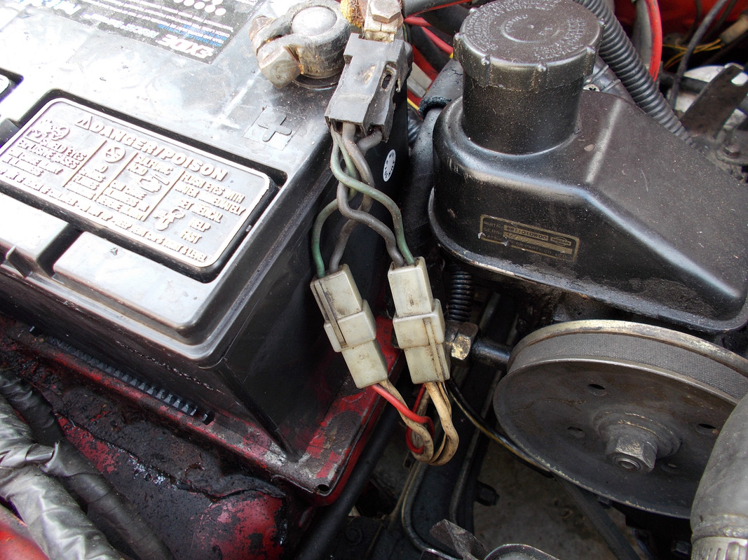

The issue is it is not charging, does this have an external regulator? I would assume just to replace the alternator, would this be correct? I can't think of anything else. It sits at 12.7 v while running and the battery light is on.

The alternator will have an internal regulator.
If you have a local rebuilder then that might be an option to look at.
There are replacements out there (ebay etc) but it seems that some folks on here ( IIRC) had some issues with their longevity/compatibility etc. Plug fitment for one.
Yours will have vacuum pump on the back of it so bear that in mind if you go shopping. I think there are some out there that have the pump affixed to them, or cheaper without.
Perhaps open your vacuum pump up and check its condition before you buy one.
I believe that Al ( forum manager ) or perhaps it was some other forum member replaced the alternator with a standard type and mounted an external electric (12V) vacuum pump. This allowed for a more robust alternator to be used. The internal regulator on these is their weak spot.
I had mine rebuilt 2 times for this very thing.
A good battery is essential as these are really meant to maintain the charge after start up and not really to charge a dead battery after needing a boost. Boost jumping another vehicle is another thing to be careful with.
I think there is a post on this forum someplace ( I think by Al actually) that had some answers or experimentation with regulators, or diodes, or solutions that he came up with. Search alternators on the general forum.
I cant recall now what regulator the last rebuilder put into mine, but said that he used something different that "fit". ( a different Hitachi application I think)
That said I believe that alternator for the D21 was slightly different. ( but it's been a minute )

My biggest issue with charging is the fusible links connectors to the battery post, the connectors get loose/wore out and do not make good connections, all 4 of them connections have to have power, you can see in this photo the connector to the battery post is melted slightly, my 720 connector is worse.

My glow plugs warm up for around a minute when cold or even warmed up driving to the store, if already warm I wait maybe 10 seconds and start the engine, it easily starts when warmed up, and I am talking about showing coolant temps near normal driving(needle in the middle on the gauge).
It does make me think there is a leak in the fuel system if it takes a lot of time to start after sitting all night, the only time it takes my engine time to start is when it is below 40 degrees, and when it does try to run it is rough until all cylinders are firing, if it is still blowing white puffs of smoke it is either cold or a glow plug/plugs are not working properly for some reason, I have an air heater installed on the intake manifold for when going somewhere where it is going to be cold and I have nowhere to plug in the block heater.
I have an engine that blows light gray/white smoke until it warms up, yet still smokes after warmed up just not as bad, this engine was over heated, I tore it down and found a compressed rod and other stuff that turned it into a parts engine to me as I could not find a replacement rod other than to use SD22 rods which are lighter duty, I did not chase the SD22 rods because it is a parts engine for my SD25 engines now.
I test the glow plugs one at a time, they turn bright orange to yellow, I just want to see them work, I have lots of extras, I never throw glow plugs away if they work, when checking for power to the glow plugs I test them with a test light, I test them using the threaded end/nut, that wire going to the plugs can go bad.
I caution everyone to not use the starter for extended periods of time, do not let the starter get hot, it is very hard on them, they do not last long when abused like that.
