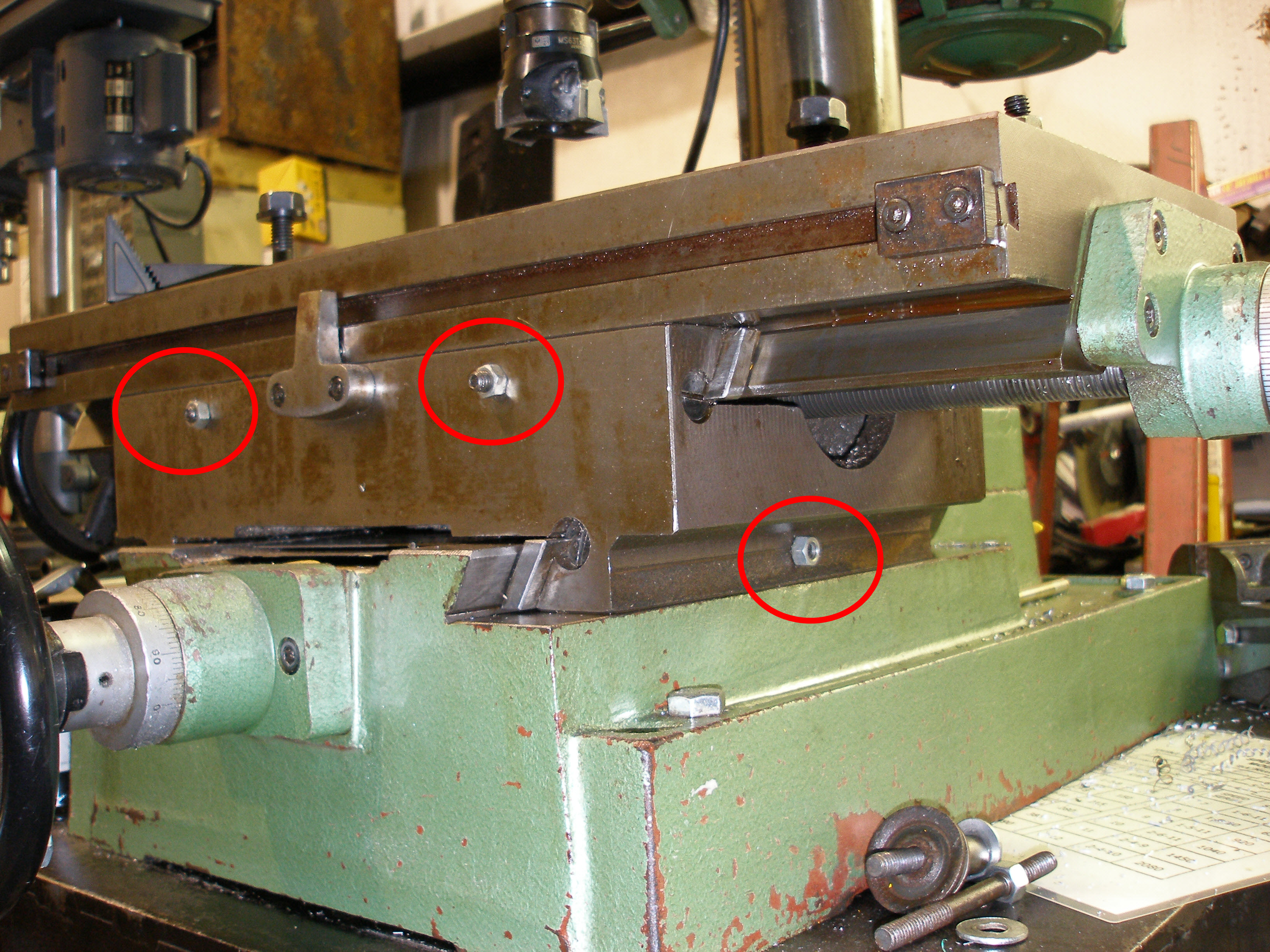

He says yup. Good guess.TooManyIdeas wrote:. . . if I had to guess the 2 bolts marked in yellow MAY be your stops.
After talking with Peter a bit, I realized that I was mis-visualizing how the gib adjustment actually worked. Now that I realize that the adjustment bar is tapered longitudinally, and that the slotted screw head moves that bar in and out, it makes sense (finally).Or (marked in green) you could tighten the ways allot. I'd recommend swapping out the flat screws for some allen head caps. That may also work

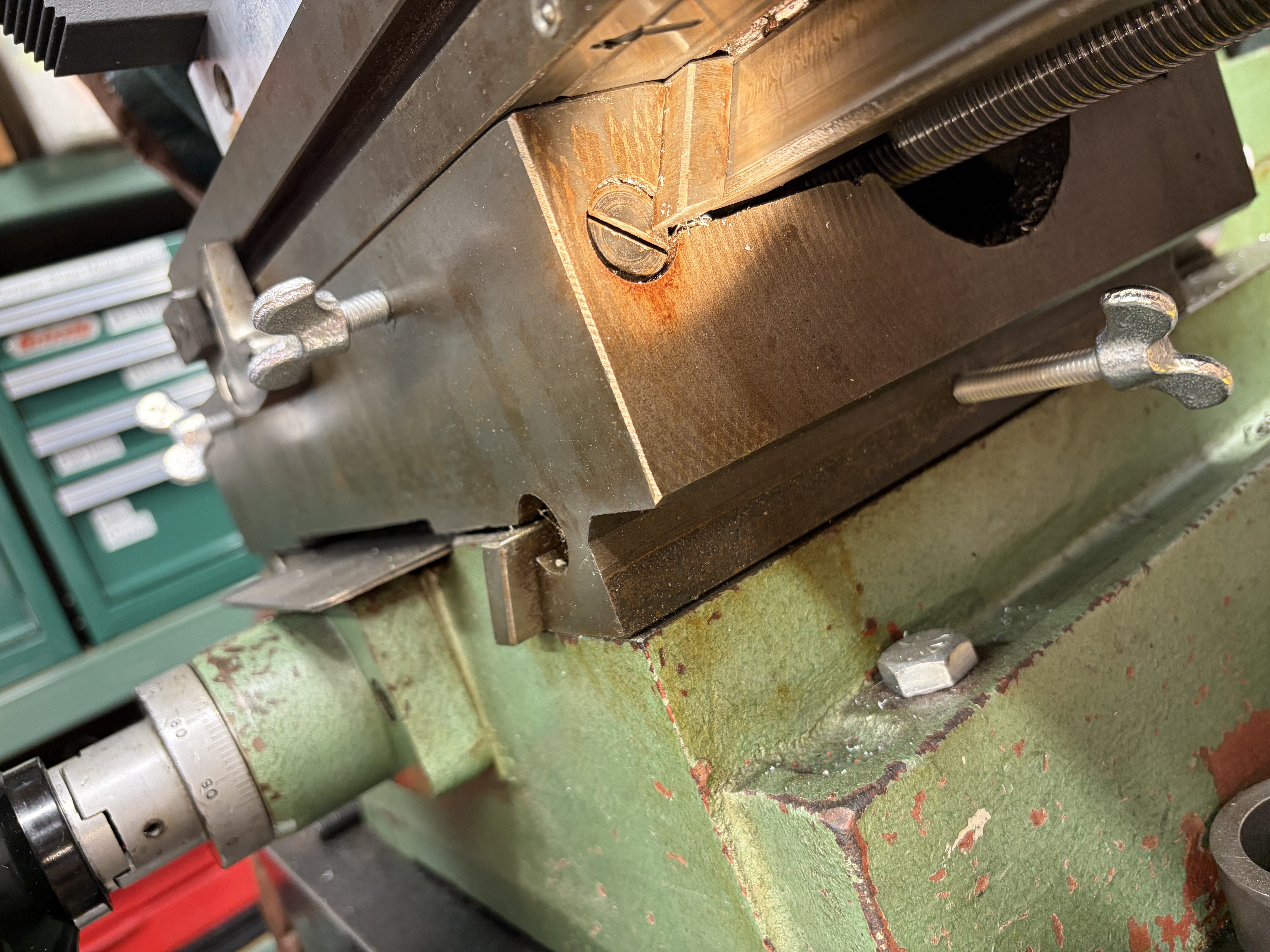

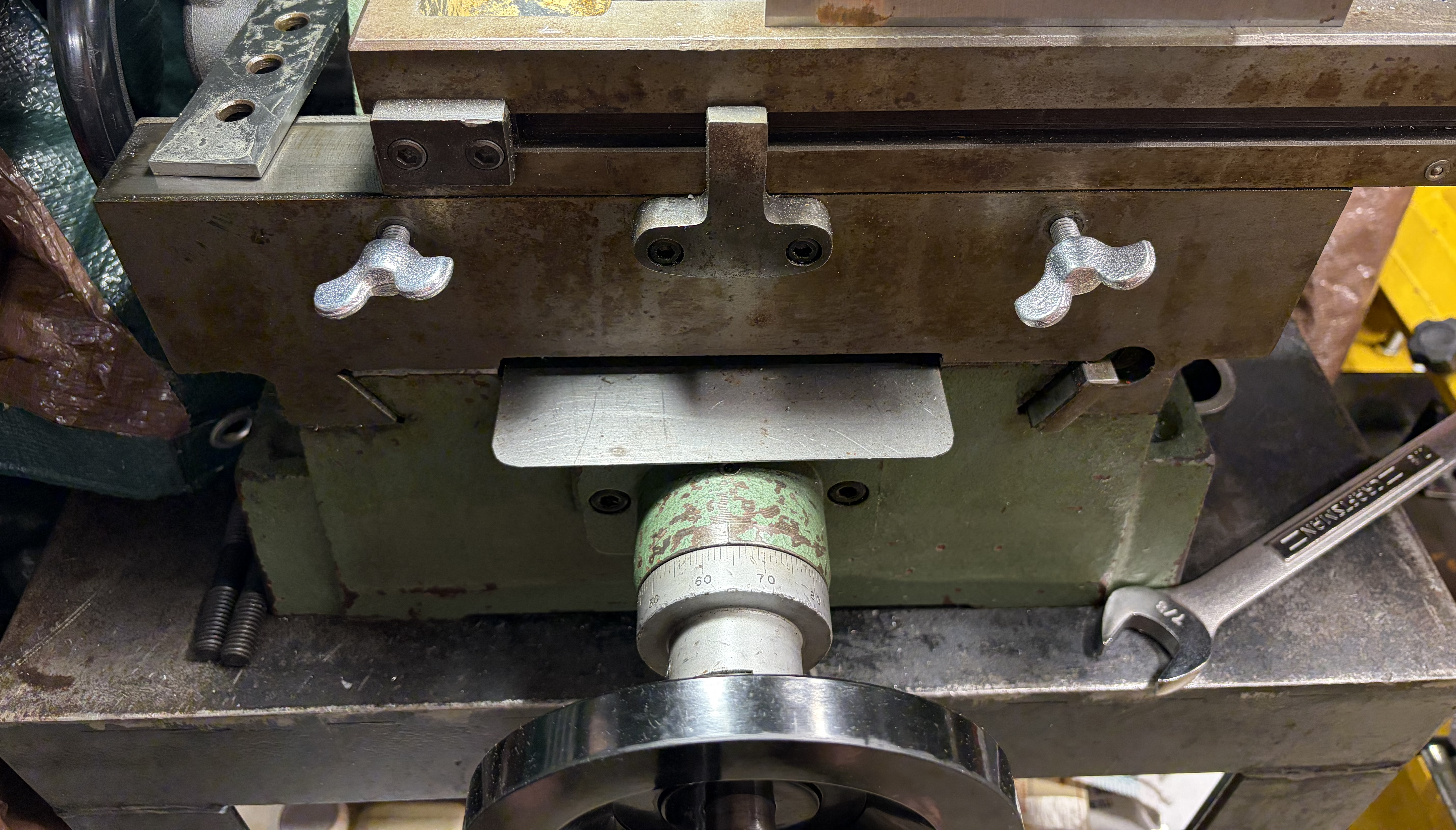

The gib locks are kind of non-standard on the Jet-16. Here's what the manual says about gib adjustment:
The big slotted screw (one per axis) shoves on the end of a longitudinally-tapered gib to adjust dovetail slop.
So, these are not really gib adjusters in the usual sense:
As there's no separate gib lock for either axis, I removed those set screws and installed wing-bolts, 1/4-20 IIRC:

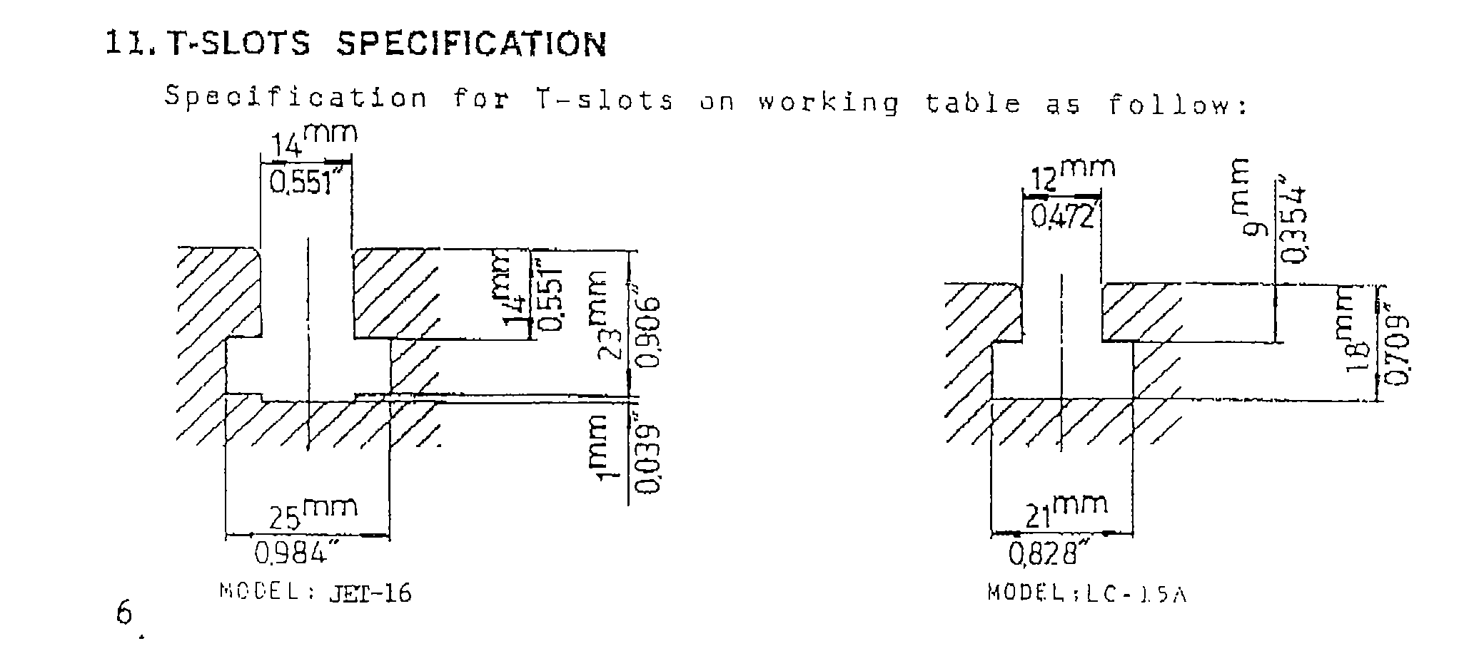

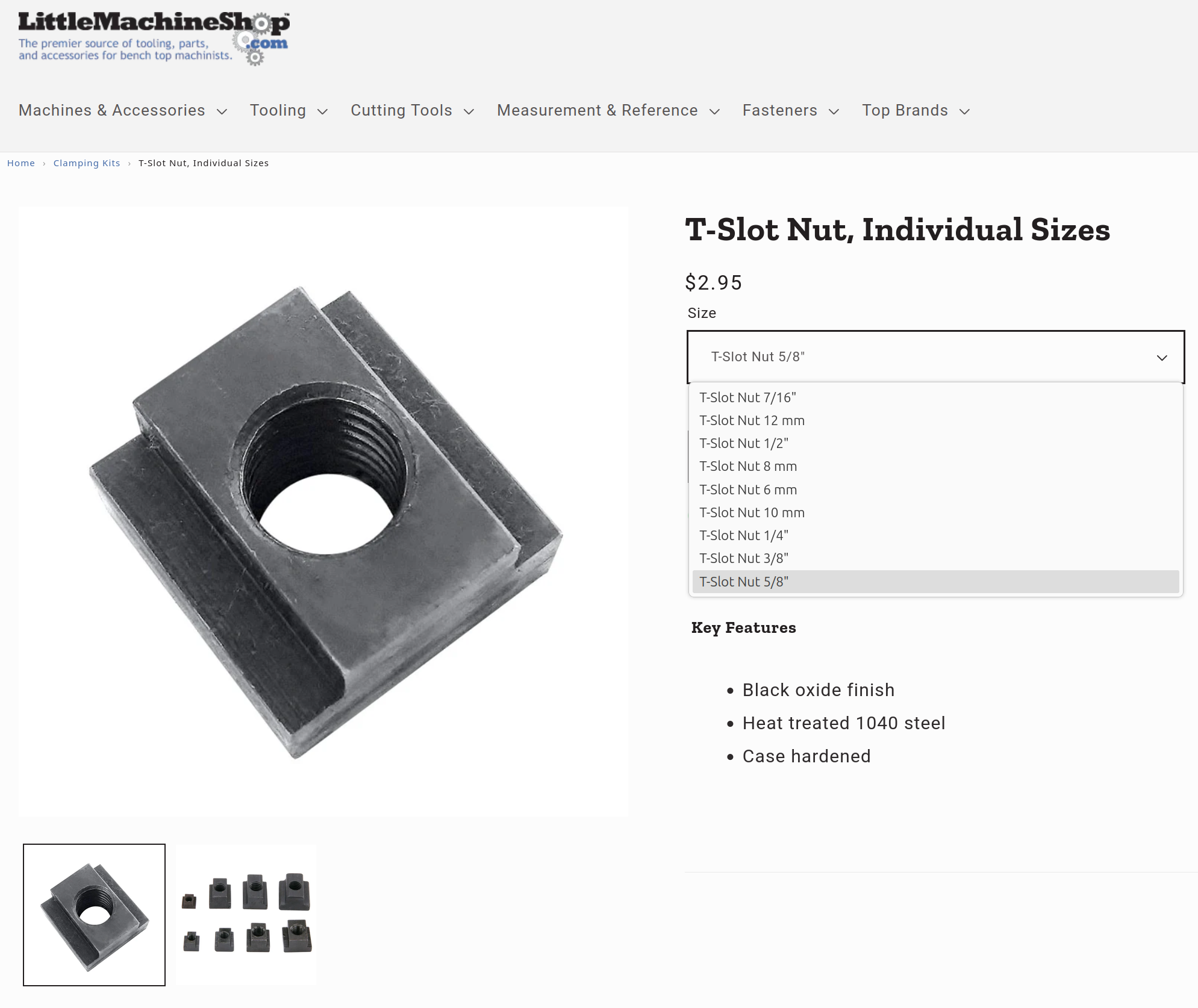

In hobby mill tables, common t-slot widths include 1/2" and 5/8" in the US. The two t-nuts that I inherited with this Jet-16 in 2007 fit well and are threaded 1/2-13, a common stud size, though not so much for hobby mills, but the width is in-between those common sizes.

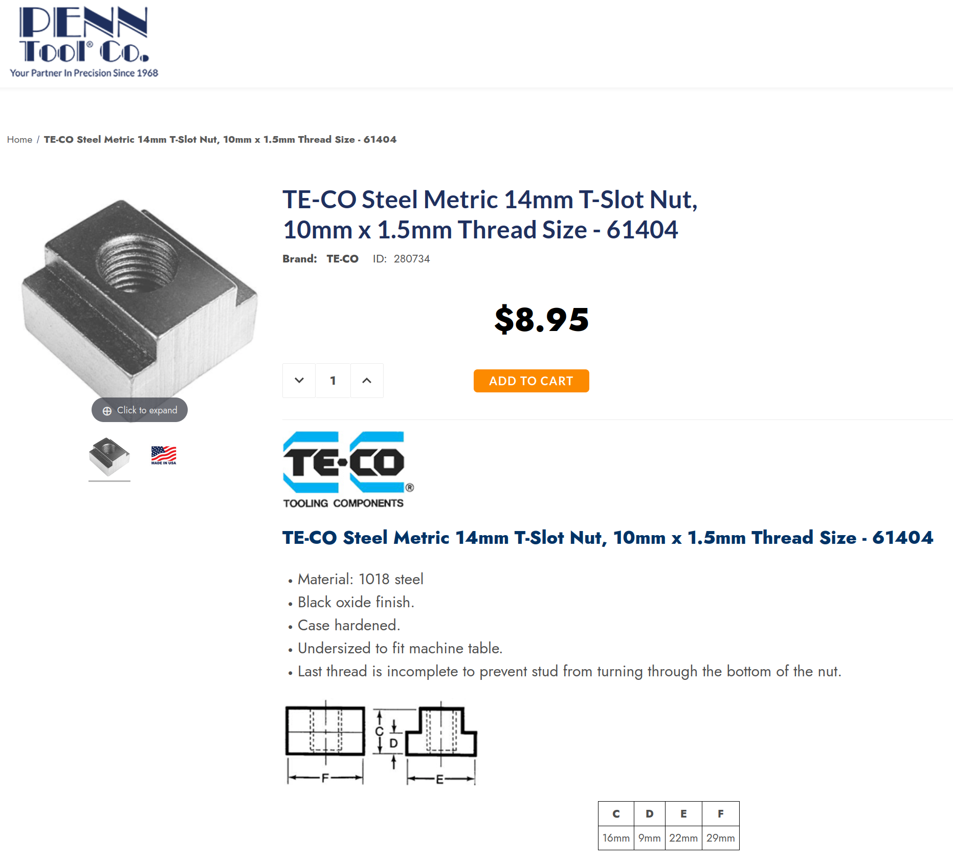

Over the years I've been shaving down 5/8" t-nuts to suit, and I just recently read the manual and found this: 14mm. Now that's an odd slot width. No wonder I've not found off-the-shelf t-nuts that fit this table.
Te-Co can supply 14mm t-nuts, 61404, though with M10 holes, and all my strap clamp stuff is currently 1/2-13, so I'll probably keep shaving 5/8" t-nuts.
