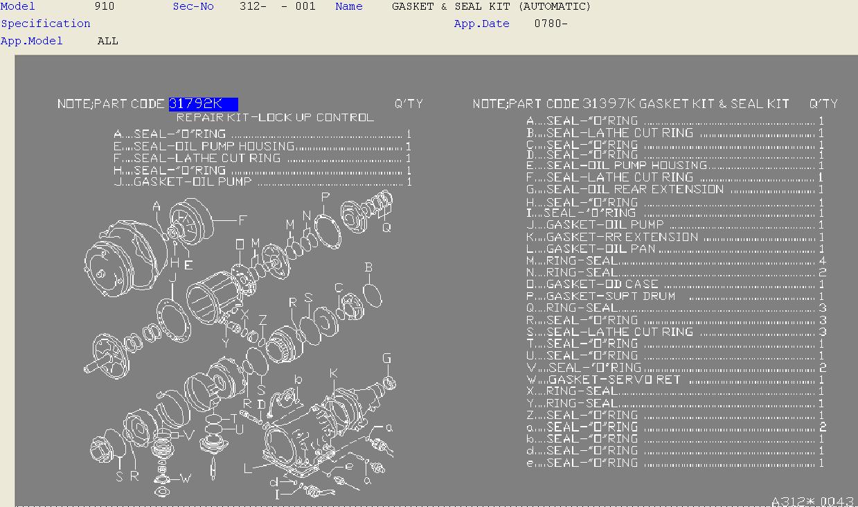

I removed the o-ring and it appears that it may originally have been round, though it's a flatter cross-section now, more like rectangular with rounded corners.
Shaft groove minor ID is .768" (19.5mm). Major dia. is .850" (21.6mm), width is .085" (2.16mm). All dimensions +-.002" .
This o-ring seals in a static application (no moving wear after installation).
It appears to be Ref "H" in the FAST illustration. No applicable part No. out of FAST though.

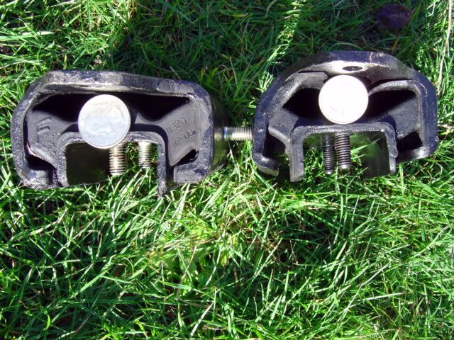

Swapped Back Old Trans Mount
Had some free time this afternoon and some agreeable weather so was able to put the car on ramps and swapped in the old trans mount for the new one. E.T. about 1.5 hr., not including time spent degreasing the old mount or chasing to the HW store for ball bearings to replace those lost from one of the (mysteriously loosened) swivel casters on the jack.
Cursory examination showed the exhaust system to be intact.
Quite a different profile between the old & new mounts. Old one is on the left, w/ "F" cast into the rubber:
The old one is much more flexible; inner portion can easily be moved using hand strength. The new one is almost unmoveable.
This photo better shows the difference in resting height, the newer is 1/4" - 1/2" higher at rest:
Mounted in the car the difference is even greater but I had not thought to measure it.
The old mount seems to have relieved the heavy vibration off idle, more road testing will show if it helps at cruise.
Wonder if I can return the new one? It might be OK for a gasser but a diesel vibrates too much.

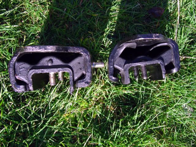

Max rear tranny mount
When I was under my wagon last week I did notice the rear mount was _very_ flexible - easily moved around by hand as you said. This looks like a critical part of the system for "domesticating" the diesel, along w/the various exhaust hangers etc.
Be nice to find some original types. When you looked for a replacement (and got the new one you tried) how and where did you look? Think more time spent could source a few? Seems like it'd have to be OEM, although I haven't ever tried to find mounts and maybe there are after market or jobbers who can make these things. Are there "rubber" parts that one could assemble (w/some metal fabrication) to create something that compliant? How about mounts from other diesel vehicles with similar flexibility that could be made to work? Again, I'm not very familiar with this area but there _are_ a number of diesel vehicles out there and some of them must have pretty good damping; MBZ jumps to mind.
The old one you showed (great photos) besides being somewhat "deflated" looks like one side is settled more than the other. Wonder if it was made that way; if it was not wonder if its new resting place shifts the tranny tail a little to one side. Might try "straightening" that by moving the mount toward the other side a little or shimming under it if there is still noise. Hmm.. maybe regain some height with a spacer block? That might straighten the drive train also, make it quieter; good for another 75K.

FLAPS. I could try the Nissan dlr. where I sourced the rear main and torque converter seals. Had no problems w/ those items yet.rlaggren wrote:When you looked for a replacement (and got the new one you tried) how and where did you look?
The photos are actually showing the side view, as mounted on car. Top of photo is up, left side is front of car. Bottom surface of Tranny extension mounts to large top surface, the inverted u-shape channel sits on top of the crossmember.rlaggren wrote:The old one you showed (great photos) besides being somewhat "deflated" looks like one side is settled more than the other. Wonder if it was made that way; if it was not wonder if its new resting place shifts the tranny tail a little to one side.
It is twisted, but not sideways. It is the angle of the tranny-- front is higher than rear relative to the crossmember. Parallax error in the photo doesn't allow us to see that the new mount actually has even more twist.
The old mount is not wasted; I had wanted to replace it during the RMS R/R because I figured it would be destroyed after the several months long continual oil bath it was subject to. As it is, it is way more preferable than the new one. Car is relatively quiet and posh now, relaxing to drive even.
