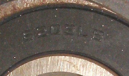

The vee-belt idler bearings (both PS and A/C) are fairly easy to replace.
The bearing industry number is 6203, and you want it with seals both sides. The "seals both sides" suffix nomenclature varies from mfgr to mfgr, so it's best just to ask for "seals both sides" and let the salesperson figure out how to turn that into their part number suffix.
If you have an internal retaining ring plier, you can remove the ring fairly easily. Tap out the center bushing. To remove the bearing from the sheave, support the sheave on a couple of blocks of wood spaced just wider than the brg's outer race, then beat on the bearing's inner race. Since it's a bad brg, you don't care that this removal technique damages the brg's races.
You may want to dress the brg seating area in the bore of the sheave with some sandpaper to clean it up, then lightly lubricate it, and tap the new brg in place using 2x4 or any chunk of wood to get it to the flush point, then tap it the remainder (below flush) using a suitable chunk of pipe, a brg driver, a large socket, or a punch if you're very careful, working around the edge and not slipping and damaging the seal.
Put the retaining ring back in, clean, lube and tap into place the inner bushing, etc. If it requires more than a "tap" to install the bushing, support the brg's inner race on a socket so the impact is not going through the balls.

thanks for all the pictures... that really helps. I just went outside and looked at it again and listened. It's definitely that pulley that's grinding.
I don't plan on replacing the belt. it looks like its in good shape and that sounds a lot more chances of me screwing things up. that retaining ring might be a pain to get out without the right pliers, but i'll give it a shot.
Where you go to buy a bearing? I looked it up on napa and there are two different ones... before and after 7/83. do you know how to figure out if the car was before or after 7/83? I guess i'll just have to pull it out and look at it.

I finally received the bearing in the mail and this morning I replaced the bearing in the idler pulley. The bearing ended up being a russian one with a bunch of russian alphabet gibberish which i didn't understand. If I had though about it sooner I would have taken a picture of it. I am pleased to say that its running like a gazelle. I want to sincerely thank asavage kassam503 and carimbo. without your help I would have never been able to pull it off. Especially giving me the bearing number. When i pulled the old bearing out it was completely wrecked. I would have never been able to tell what type of bearing it was. here's a picture of what it looked like when i pulled it out.
You guys really bailed me out on this one. I definitely don't have the cash for a new ride. Below this i'll just describe what I did in case someone else has a similar problem.
I didn't replace the PS belt but I will have to do this very soon as it looked like it was in pretty bad shape. I was able to pull the pulley out without removing or adjusting anything but the tension screws on the pulley housing pt# 11395. By making the pulley as loose as possible i was able to slide it under the belt and remove it.
I removed the retaining ring with a pair of needle nose pliers to pinch the ring through the eyelets and a couple of small flathead screwdrivers to work it out. I would recommend that anyone who attempts this in the future should purchase a set of retaining ring pliers, as it took close to an hour and was full of cursing and pinching fingers.
The sheave tapped out of the pulley pretty easily with a few light hits of a hammer. I used a socket and hammer to tap the sheave from the busted bearing.
I i needed to use the hammer again to sit the sheave into the new bearing and them a socket and hammer to tab the bearing and sheave into the pulley. The retaining ring snapped back in pretty easily with a couple of flathead screwdrivers.
I tried to push the the pulley back onto the tension housing but was unable to generate enough pressure to push it all the way down the shaft. I eventually decided to remove the housing(pt# 11395) from the engine block and then push the pulley onto it while outside the car and then reattaching the pulley and housing to the engine block as one unit.
