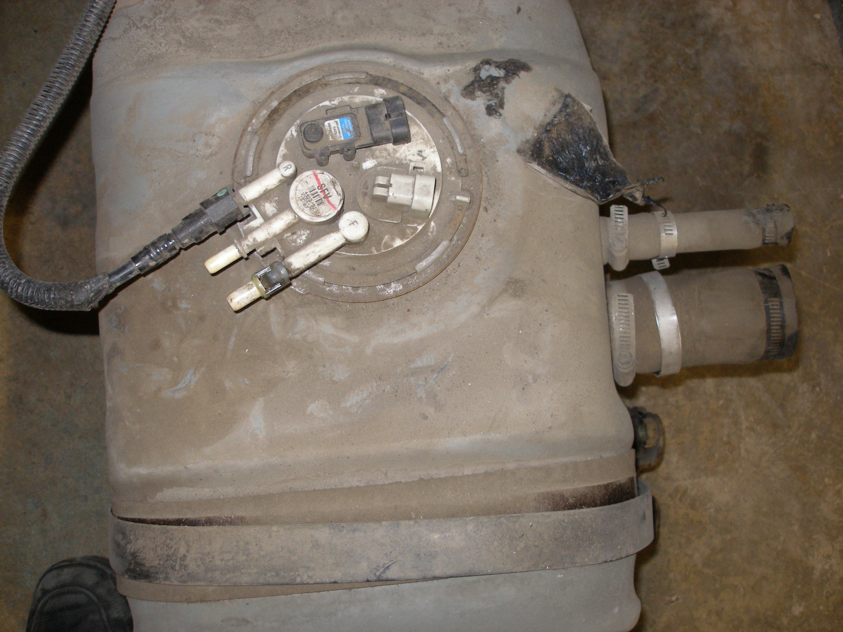

1/4" nylon tubing and an electric fuel pump got about 10 gallons of fuel out of the tank, but no more. There was about 15 gallons in there, so I dropped the tank with five gallons still inside, which is trickier than it sounds -- fuel sloshes while you are balancing the tank on a floor jack. The red pail? The electric pump was last used to pump ATF, so a bit of ATF was in its lines.
First challenge is that this model has the optional engine/transmission skid plates, and this heavy steel cage around the fuel tank. The driveshaft must be disconnected to get this cage out, and it's held to the frame by no fewer than eight bolts (mostly different sizes, of course). It weighs around 35 lbs.
Lots of gravel & dirt have collected in the cage and on top of the tank.
