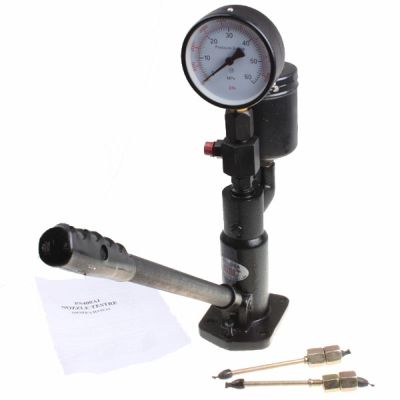

This procedure is basically in line with the cleaning procedure shown in the Maxima Service Manual except the special tools are not used. It
requires an Injector Pressure Tester and a Drill Press. If you do not have these tools, let the injectors be serviced at a Diesel Service shop. Be
prepared to de-assemble and re-assemble the injectors several times. . I have bought my pop tester on Ebay for $85.00
Diesel tester.jpg (28.34 KiB) Viewed 59169 times

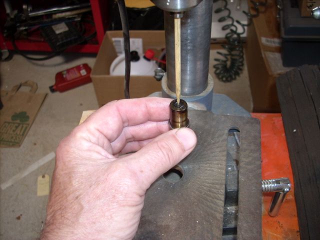

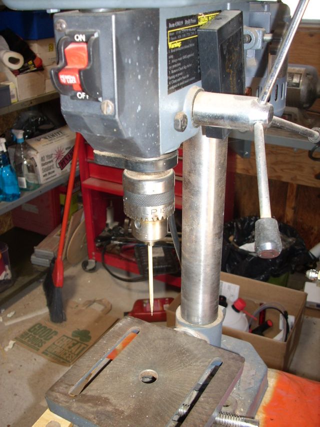

5) install the bamboo skewer into the drill press, shorten if to long ( 4"- 5")
6) carefully remove the needle from injector nozzle and set aside
7) Brush off the outside carbon build-up from the nozzles bottom with a brass brush.

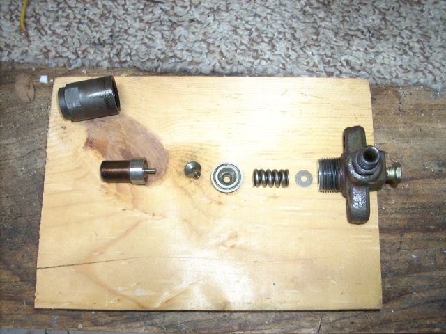

Start the drill press and press the tip of the skewer into the nozzle hole. Clean both sides, 2-3min as shown in pictures.
Injector inner parts
Injector Rebuild1.jpg (94.14 KiB) Viewed 59169 times
Skewer installed in drill press
Injector Rebuild2.jpg (127.38 KiB) Viewed 59169 times
Cleaning the injector nozzle
Injector Rebuild3.jpg (82.77 KiB) Viewed 59169 times
Cleaning the injector nozzle, other side.
Injector Rebuild5.jpg (78.96 KiB) Viewed 59169 times
This cleans the carbon buildup from the nozzle hole.

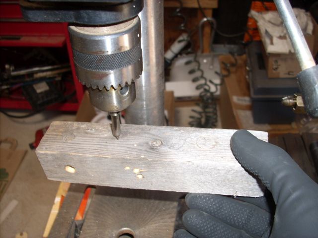

8) Remove the skewer from the drill press and install the injector needle, grabbing only the smaller part of the needles end with the chuck
9) Start the drill and press the wooden block against the needle tip. If the wood is to hard drill a couple of small holes (1/32", 1/16") into it. Make sure you clean the whole tip.

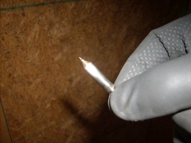

Injector nozzle needle
Injector Rebuild4.jpg (65.19 KiB) Viewed 59169 times
Cleaning the injector needle
Injector Rebuild6.jpg (81.82 KiB) Viewed 59169 times
10) clean the injector nozzle body and needle with compressed air. Important: spray both parts with penetrating oil or dip in ATF before reassembly. Carefully insert the
needle into the nozzle. Do not force it. Needle should sink into the nozzle body from its own weight. It the needle fails to sink smoothly from any
position, replace the whole injector nozzle assy. Blow off all other parts with compressed air. If the opening pressure and spray pattern was within
spec. you can reassemble the injector body (58-72 ft/lb) and test the injector again. It should start discharging with a sharp crackling/snapping noise at set pressure.
Otherwise continue to "Adjusting The Injection Pressure".

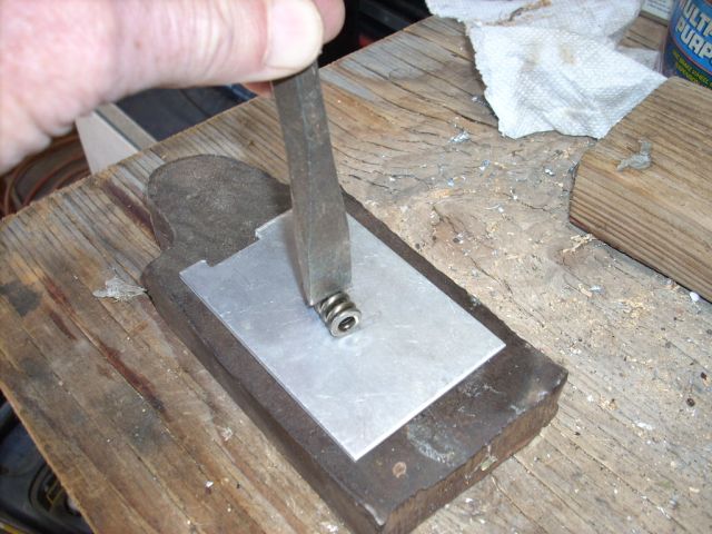

1) place the injector spring flat onto a piece of aluminum or copper sheet metal and lay it on a steel block or anvil.
2) place the chisel tip between the spring coil and hit it with the hammer. Just a light blow, not to hard. By spreading the spring, a higher opening pressure is achieved.
Spreading the spring
Injector Rebuild7.jpg (96.92 KiB) Viewed 59169 times
3) I had to give 3 to 4 blows to arrive at the correct pressure, so each blow was about 200 PSI worth. That is a ballpark figure. Turn the spring after
each blow and use different spot (coil) on the spring. Start with 2 hammer blows to get the hang out of it. Clean off the parts with compressed air,
reassemble the injector and test it with the pop tester. Always include the distance washer when reassembling the injector. It comes handy when
you have to decrease the opening pressure. I was able to adjust the opening pressure with this method to within 100 PSI ( 7 bar) of the specified
value.

I recommend not letting any of the injector internal parts get near a rug. Even an almost microscopic fiber from a rug can be enough to foul the inner working of the injector. Especially the needle drop test (which should even drop at an angle less than vertical).
Also, instead of spreading the coils of the spring with a chisel, hopefully a reasonably priced shim kit is still available from Peachparts? I don't like the idea of stressing that spring, possible setting up a future scenario for breakage. I HAVE seen a broken spring in an injector body before.
