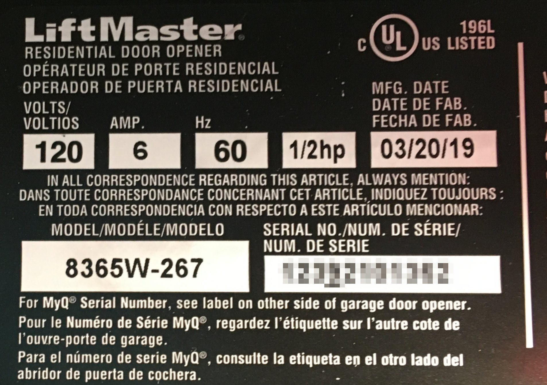

First thing: LiftMaster puts a lot of info on the ass end, along with four buttons (which all can change color) and a standalone indicator. One of the buttons is the typical yellow Learn button, and the standalone indicator is for it only. However, while the S/N, MAC address, FCC ID, Date, and Part No. are all listed on this end, the Model No. is cleverly hidden on the other end. With a different serial number.
That's not confusing at all.
LiftMaster (Chamberlain) does have to answer the question, "Where is the model number," frequently, so they have an easily-Googleable page for the answer.
LiftMaster "ass end" with Learn button: no Model No. info.
LiftMaster "front end" with Model No. and different serial No.

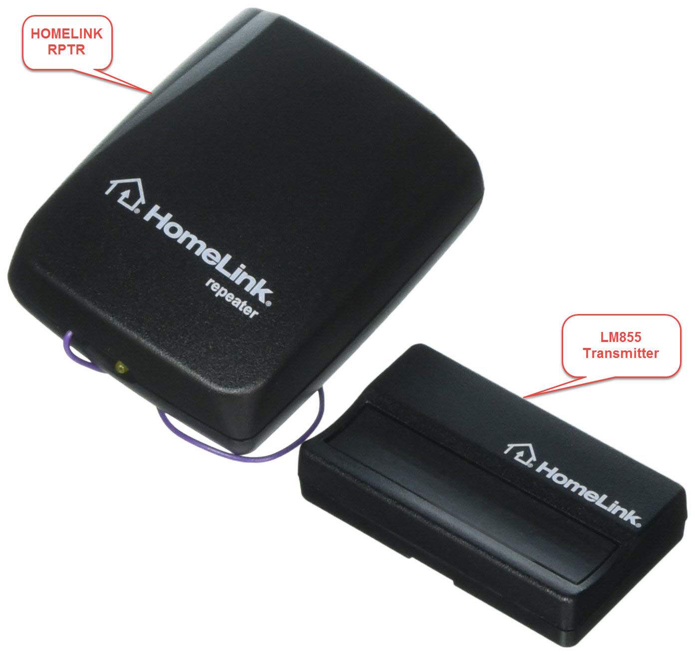

Homelink Compatibility Bridge kit, LM855 Transmitter + HOMELINK RPTR repeater.
HCB wrote:
  • The Compatibility Bridge® accepts and converts a non-compatible HomeLink® signal into a Security+ 2.0® compatible signal.
  • Can be programmed to work with more than one Security+ 2.0® garage door opener
This HCB kit consists of the LM855 programming transmitter and the HOMELINK RPTR repeater module, which listens to old Homelink transmissions and then retransmits via newer Homelink frequency/protocol.
I ordered one on Friday from Amazon, picked it up Sunday after work (we have an Amazon Locker at work: handy!), tried it out Sunday night.
First off, the HCB kit's install/programming instructions leave out all manner of important information.
  • The LM855 Transmitter will only program a vehicle's HL transmitter; I cannot (apparently) act as a remote itself. You can't use it to test that the RPTR is trained to the lift.
  • The RPTR has an LED. It blinks. You have no idea what that LED is trying to communicate.
  • While the HCB sales page says a single HCB kit can operate two lifts, there's no mention anywhere (on the three-language instruction page that comes with it, or on the web) of how to accomplish this.
Based on what I was reading, I made the assumption I could use the 855LM as a test remote, so I started at Step 2 (ie skipped training the Sienna's HL to it) and tried to test the HCB by plugging in the RPTR and attempting to train a lift to the RPTR. That didn't work. The RPTR's LED blinky-blinked, but there's no explanation of what it's for. I assumed I got a bad one from Amazon, because Amazon resells customer-returned equipment these days. I returned it to Amazon and got a replacement. As it turns out, the RPTR's LED's behaviour was distinctly different between the two RPTRs, but I'll never know if the first unit was working or not, because I condemned it based on the faulty assumption that I could use the LM855 directly, instead as the programming-only tool that it apparently is.
Later in the week, I received the replacement kit. Same results (except the RPTR's LED flashed quite differently).
Between the lack of Model No. where I could find it, the LED RF interference, the antenna issue, the white lamp diffuser covers refusing to stay closed, having to guess what the RPTR's LED was attempting to relay to me, I was ready to throw things so I decided to walk away.

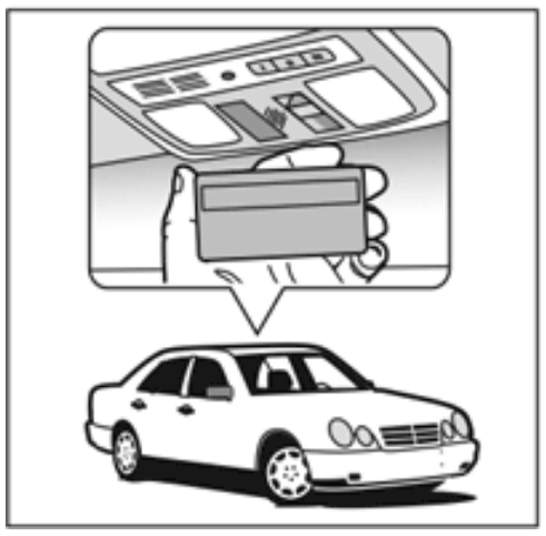

[Sidebar] The instructions for training HL in vehicles to new transmitters all state:
LiftMaster wrote:Position the hand-held transmitter 1-3 inches away from the HomeLink surface, keeping the HomeLink indicator light in view.
And the Compatibility Bridge shows this graphic:
Homelink Compatibility Bridge kit, Step 1.
[/Sidebar]
The Sienna's HL would not train to the HCB's LM955 Transmitter.
The HL CSR asked if there was a sunglasses compartment in the overhead console; I don't have one. He then suggested placing the transmitter directly under the Sienna's HL button 3, right on the LCD, and trying again. Success!
TIP ONE: Training Sienna's HL to new transmitter Wow, 1-3" away did not cut it. The Transmitter had to be literally touching the plastic of the LED, under button 3.

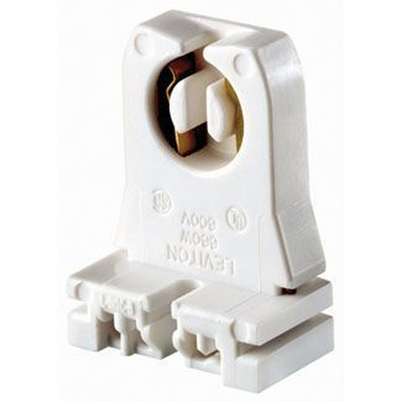

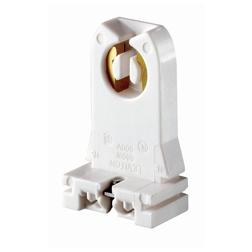

For us, the lampholders ("tombstones") rarely fail electrically, but fail constantly physically, as they approach 60 years old: the insulating material breaks and falls off. In a "ballast delete" scenario (Type B, the chart above), that leaves mains voltage exposed. A lot of our fixtures are 277v, not 120v, and most of them date from 1964-onward (everything fluorescent older seems to have been replaced by the time I arrived in 2013). A presentation by GE four years ago implied this was not safe, but reading on GE's website today implies (but does not state) that Type B installs are now UL-approved. If true, this is news to me.
The above discussion is relevant to bi-pin G13 lampholders. Typical for our hospital:
Leviton G13 lampholder, 13351
Leviton G13 lampholder, 13357

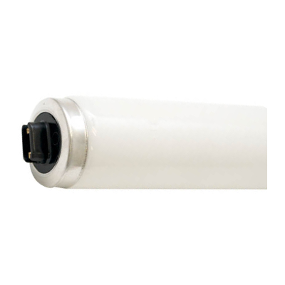

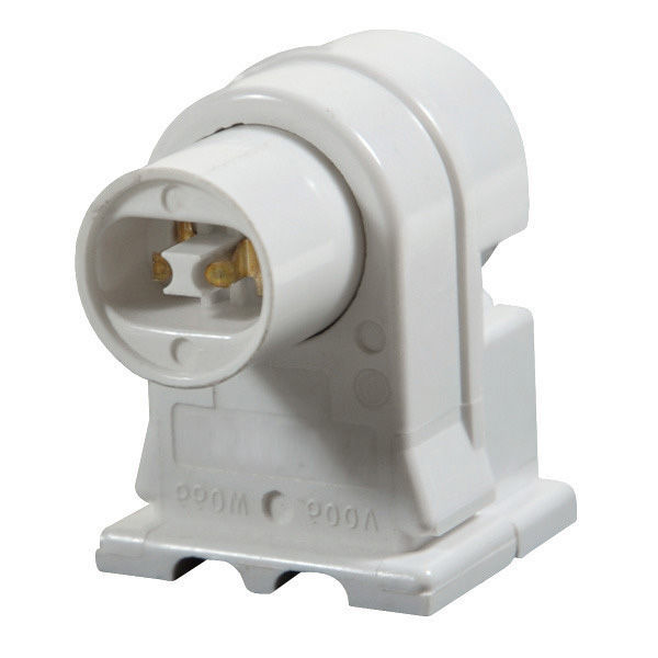

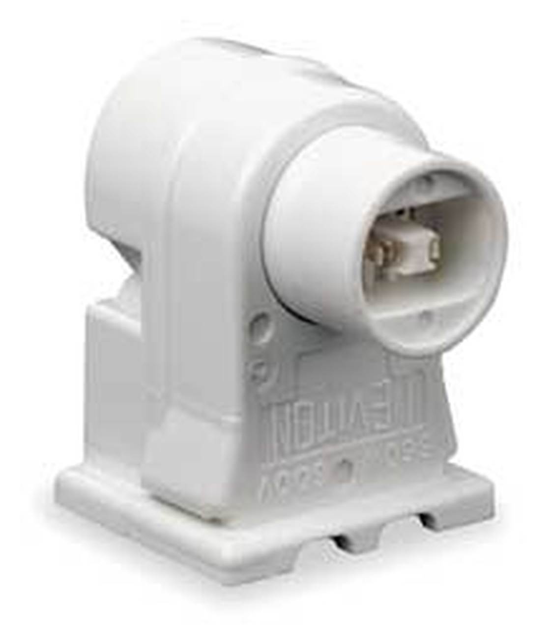

However, another much rarer T8/T12 lamp we have in a few places is the HO (High Output) style R17D. We have these in T12 usage in several 1980-vintage mechanical rooms, and quite a few monuments (exterior standalone signs). I feel a whole lot more comfortable wiring mains voltage to these recessed sockets, than G13 bi-pin, mostly because I've never run into an R17D that had physically deteriorated like the G13 tombstones have.
Example of HO-style R17D dual-recessed lamp
Sylvania-22207-FO96841HOECO-9622-T8-Tube-High-Output-86W-R17D-Recessed-Double-Contact-Base-4100K.jpeg (29.15 KiB) Viewed 136162 times
Leviton 13550 R17D dual-recessed socket

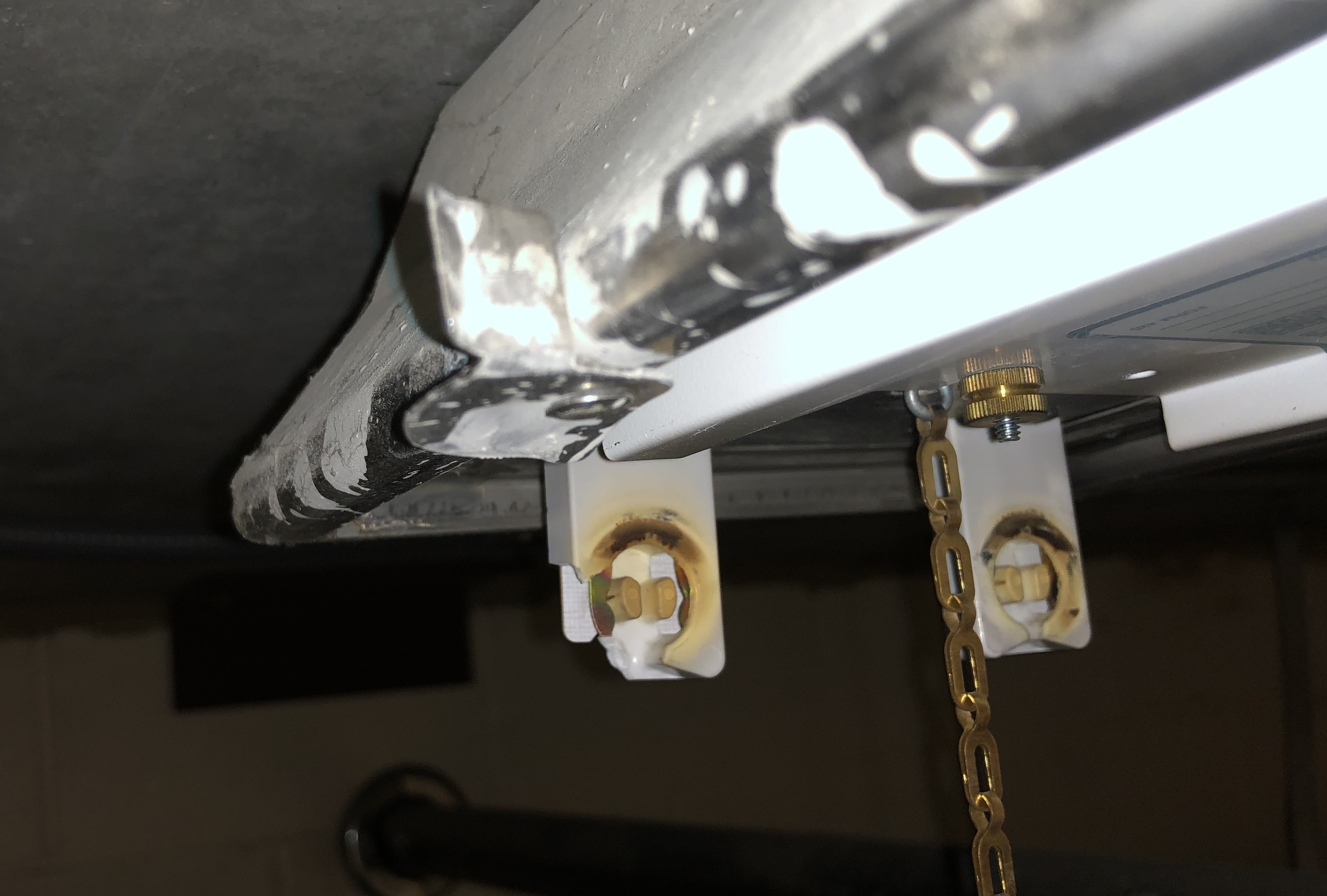

asavage wrote: 6 years agoFor us, the lampholders ("tombstones") rarely fail electrically, but fail constantly physically, as they approach 60 years old: the insulating material breaks and falls off.

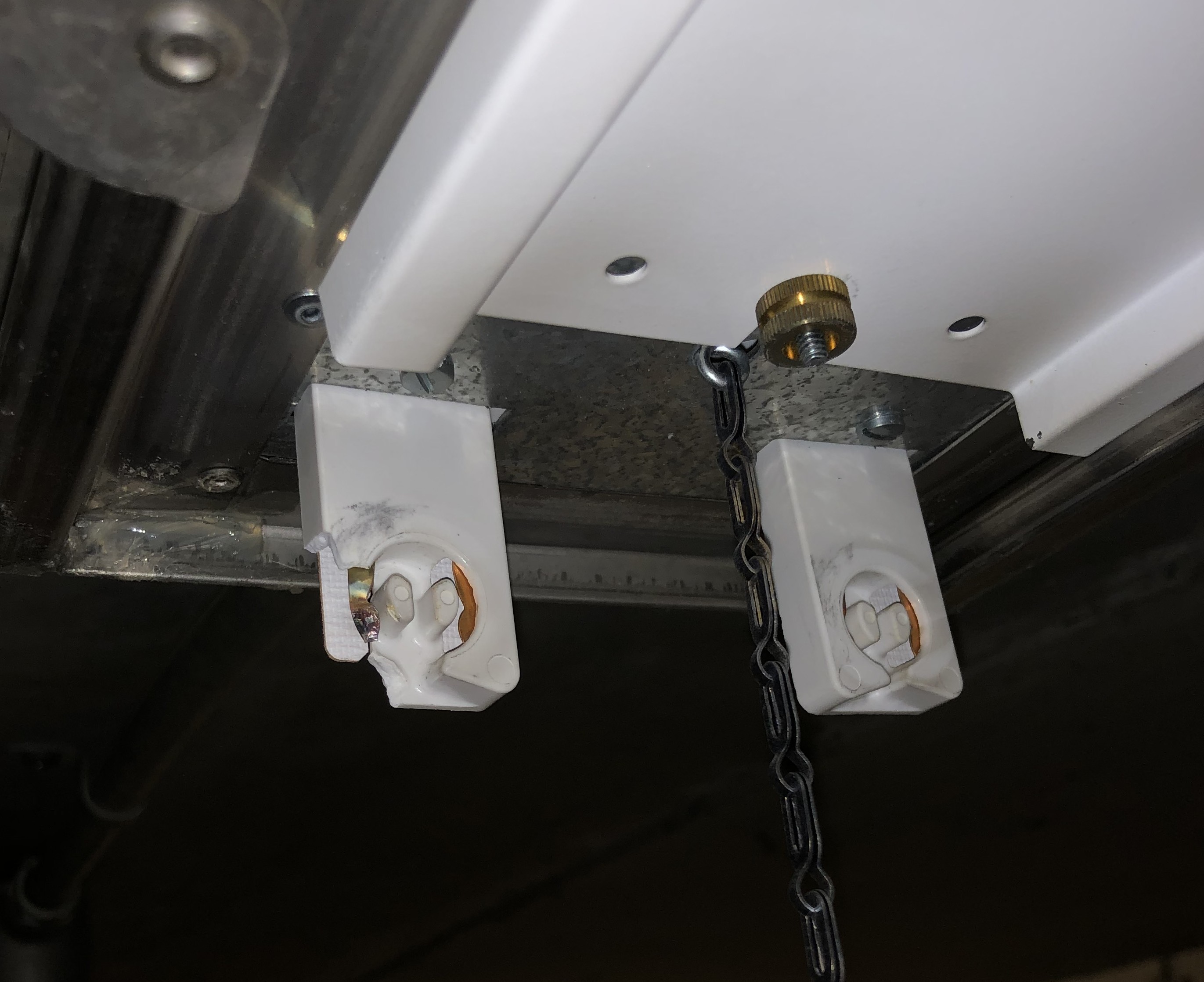

Here's a couple I ran into today whilst relamping. They are not even original to the building, this fixture is probably only 30 years old.
I am not comfortable doing a ballast bypass on lampholders that are in this condition, and I would say around 25% of ours are like that.
Of course, they can be replaced, but I'm only one man and none of my co-workers are interested in rebuilding the thousands of old fixtures, so we use the drop-in replacement retrofit lamps and call it "good enough".

Holy smokes none of mine are any where's close to looking like those.
That being said... these are "mine" and perhaps a bit more care was taken when doing maintaince and changing etc. I'm never "rushed" to get to the next job..... maybe that plays a factor? Kind of like how some people drive rented cars ?
Some of them looked like they got pretty hot.
Re: LiftMaster (Chaimberlain) 8365W-267, & Homelink Compatibility Bridge
I think the difference between ours and yours is that ours are almost all on 24/7. Few of the lights in a hospital are ever turned off. I've installed a lot of exterior lighting standalone astronomical timers (I like the WattStopper RT-200) and a lot of motion-detecting switches, but the majority are just ON and stay that way.
After decades, the plastic becomes friable, and no matter how careful you are, rotating the tube to align the bi-pins for removal inevitably ends up breaking the lampholder. Electrically, they continue to work, so as long as they're in an enclosed fixture, we run them.
