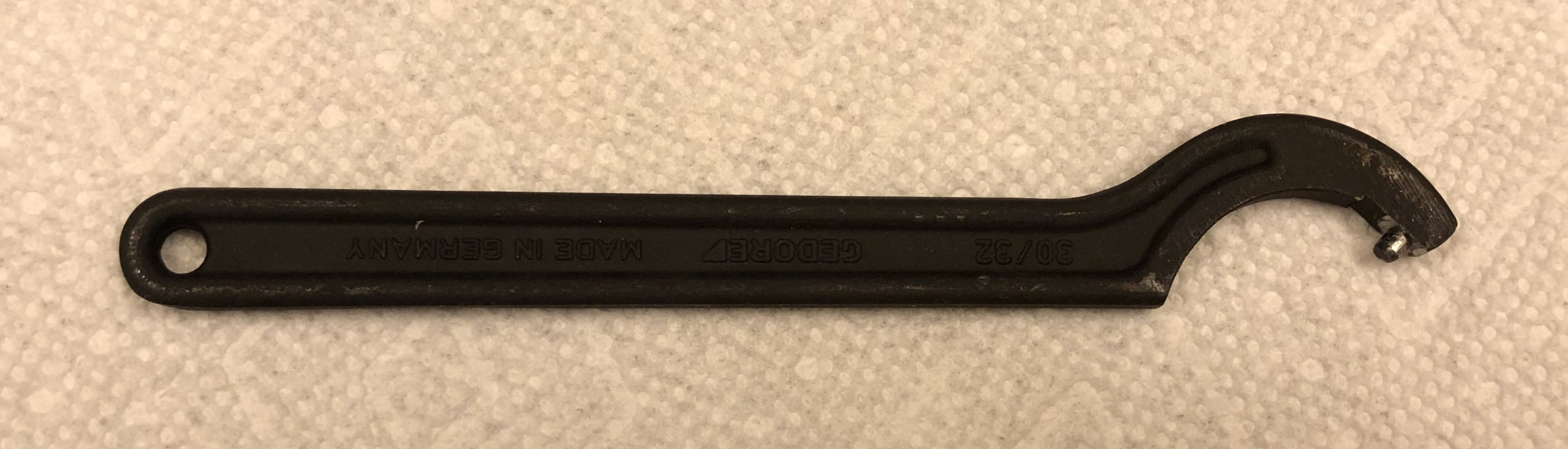

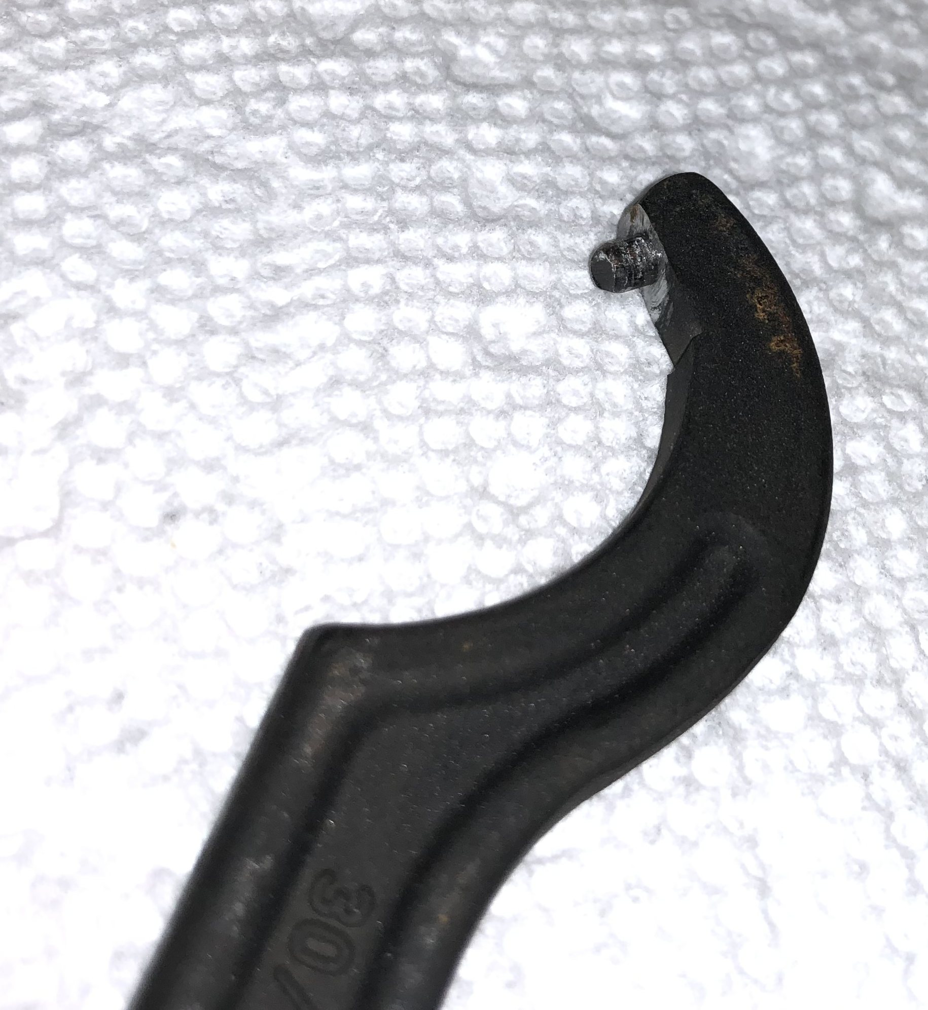

I settled on a Gedore 40 Z 30-32 fixed pin spanner via Zoro (for the price), $26 with tax & shipping. It's got a 4mm pin, still too large, but I had a plan. When I got it, I ground off the pin, then set it up in the mill (drill press, really) and punched a 7/64" hole through the head where the pin was. Then, from a 7/64" transfer punch, I cut off about a 7/16" long piece, and pushed it into that hole. Voila! This wrench fit the robe hook perfectly.

Gedore 40 Z 30-32 with 7/64" rod installed
