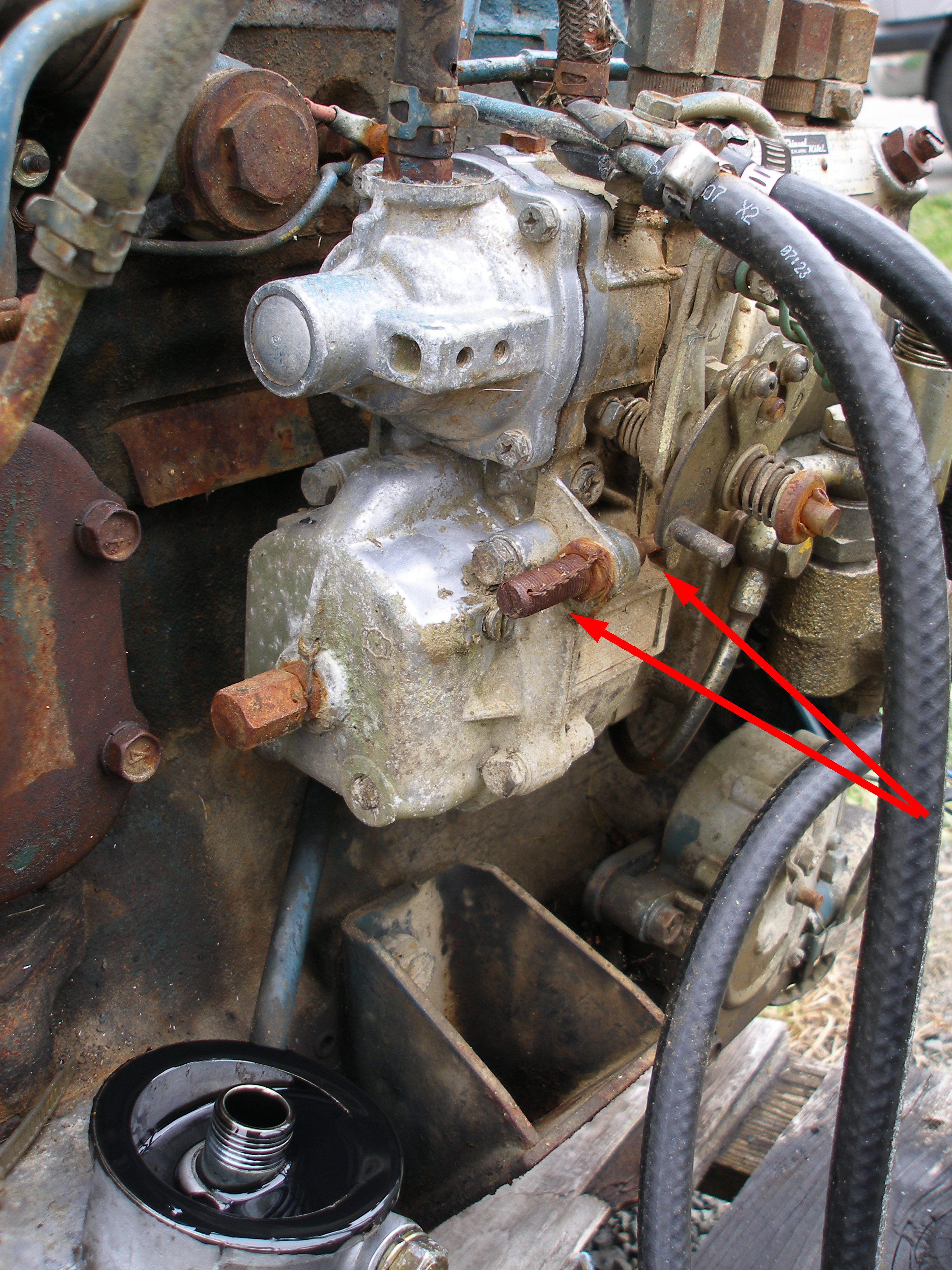

Is this what you are looking for, if it is PM me if you want a reasonable response time wise, I live across the river from you in Vancouver.

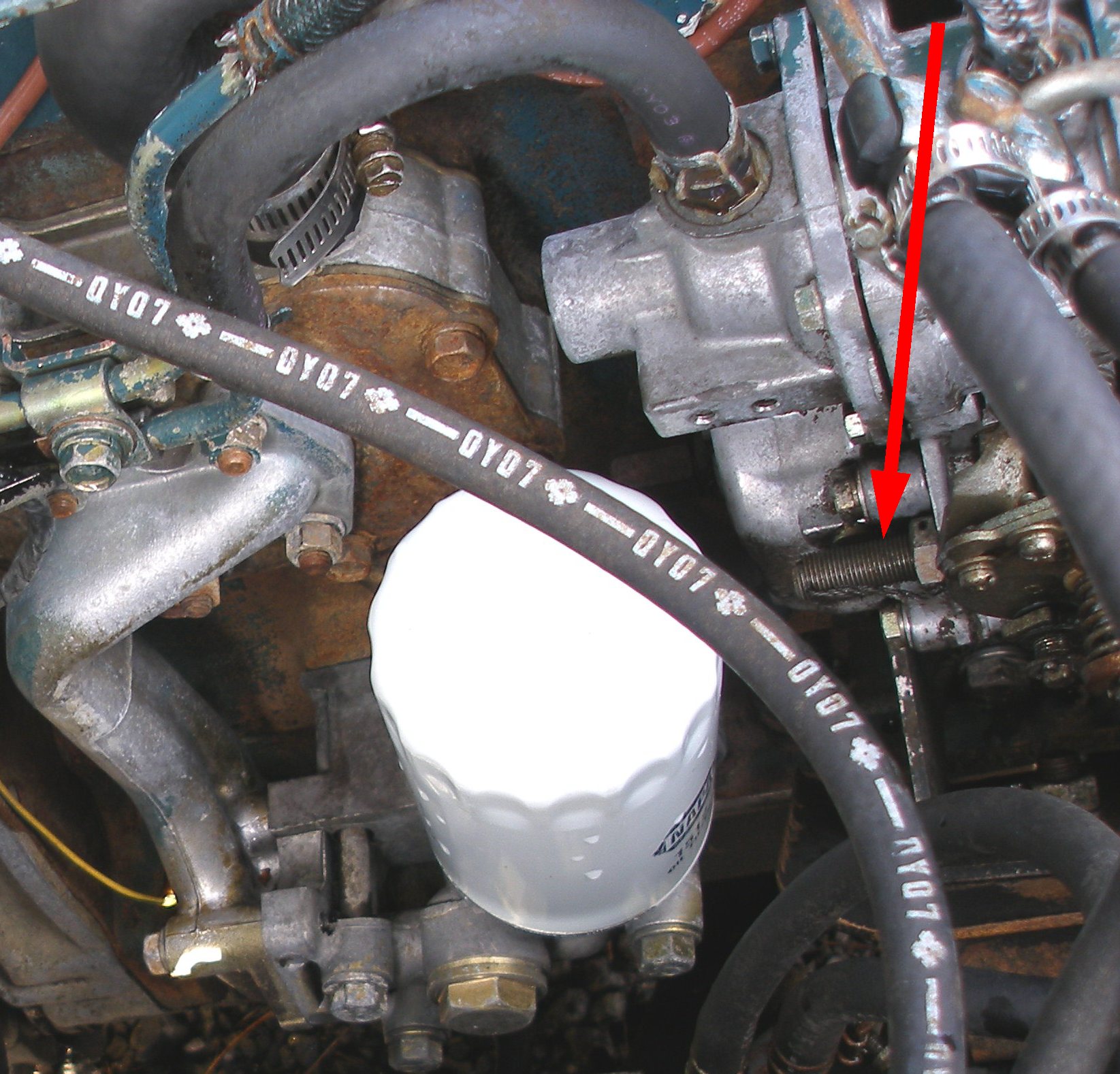

Does that screw go here:

Yes, that's the screw. Ended up obtaining one from Wayno in Vancouver.
Thanks Al,
Driftwood
