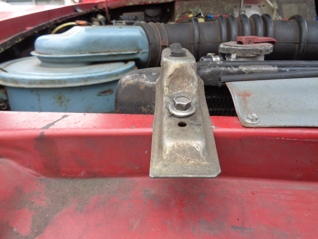

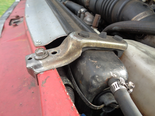

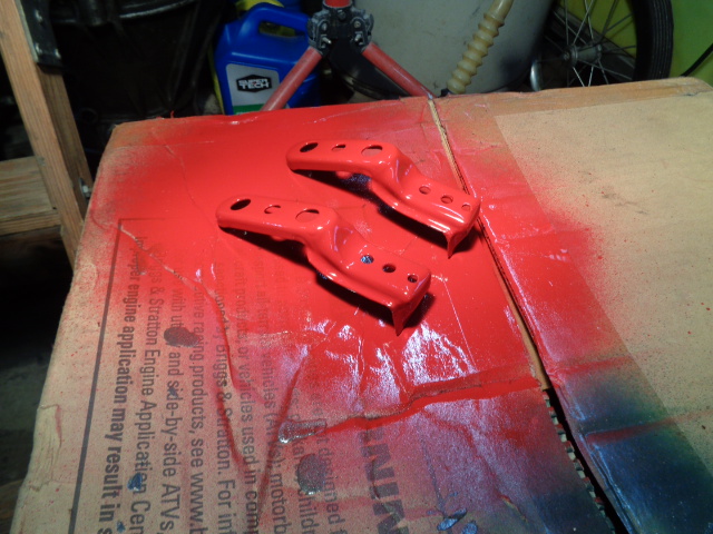

I also cleaned up the radiator upper supports, I shaped them to my truck, they came from a Volvo.
I took photos of the way they were on passenger side. The driver side finished I painted them and I am going to let them dry overnight, I will install them tomorrow between rain storms.

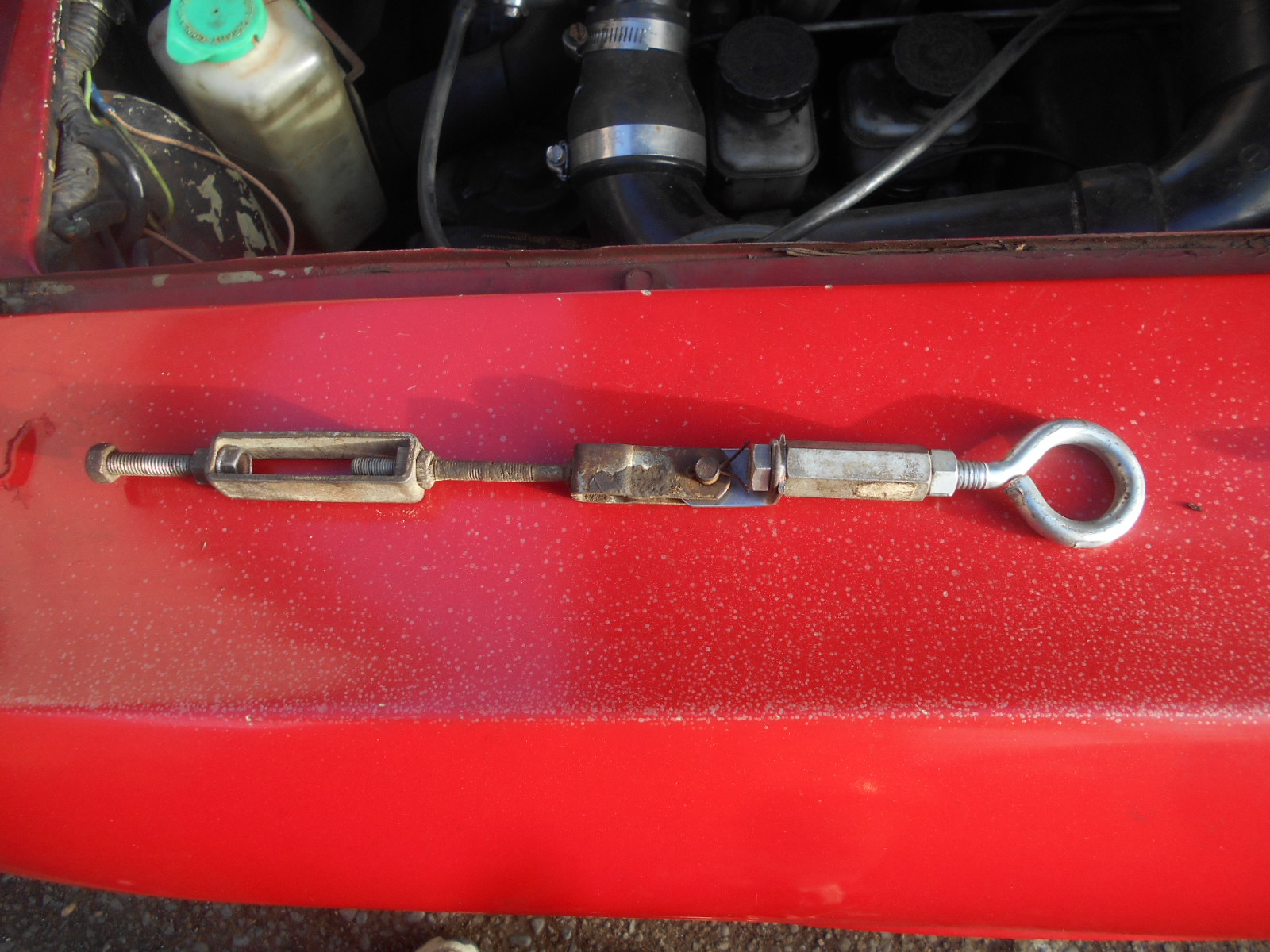

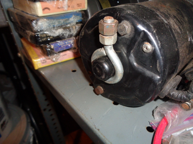

This eye bolt goes over the nipple on the end of the starter. This is what I made. And this is where I made the top connection. This is why I don't want to mess with my starter in any way, I have it held in place and the turnbuckle is tightened just right(there is no way to measure this), and if I were to mess it up somehow to replace it would likely take more than a day as I would have to either remove the transmission or remove absolutely everything on that side of the engine to get the starter out and fix the issue with another jury rig, the only way to properly fix it is to remove the transmission and either fix that hole in the case or replace the front case, I am just not interested in doing that unless I have to, it starts pretty good and runs really good right now, I will leave it alone until I have some other issue that necessitates pulling it apart.
