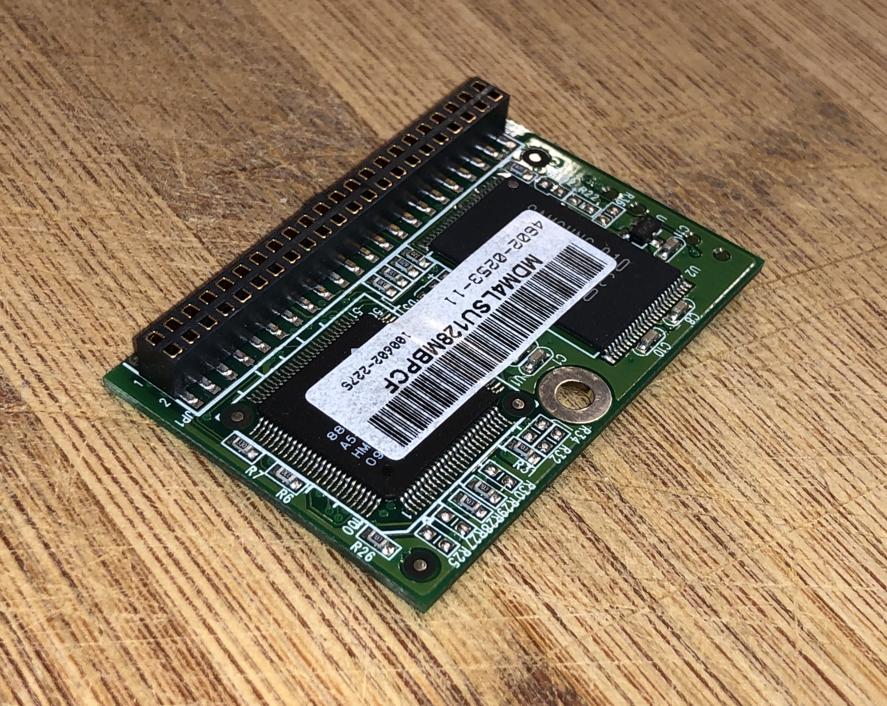

These units store their OS on a DOM: Disk on Module. It's a type of flash storage or SSD, which uses the 44-pin IDE connector, as do most 2.5" laptop hard disks. I ended up cloning the DOM from my "old" N4100Pro to my new one, side-stepping the problem with the OS itself rejecting the firmware upgrade.
This wasn't easy enough for me to make good guesses, and there's surprisingly little good info available on this via Google. Most information assume you'll be plugging the DOM into a suitable mainboard and reading/writing to it from there.

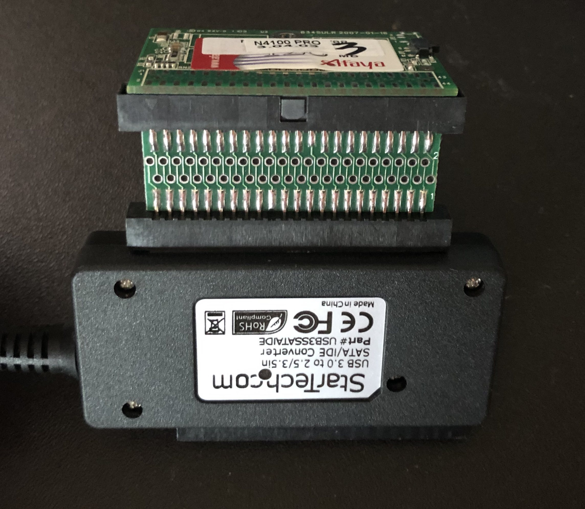

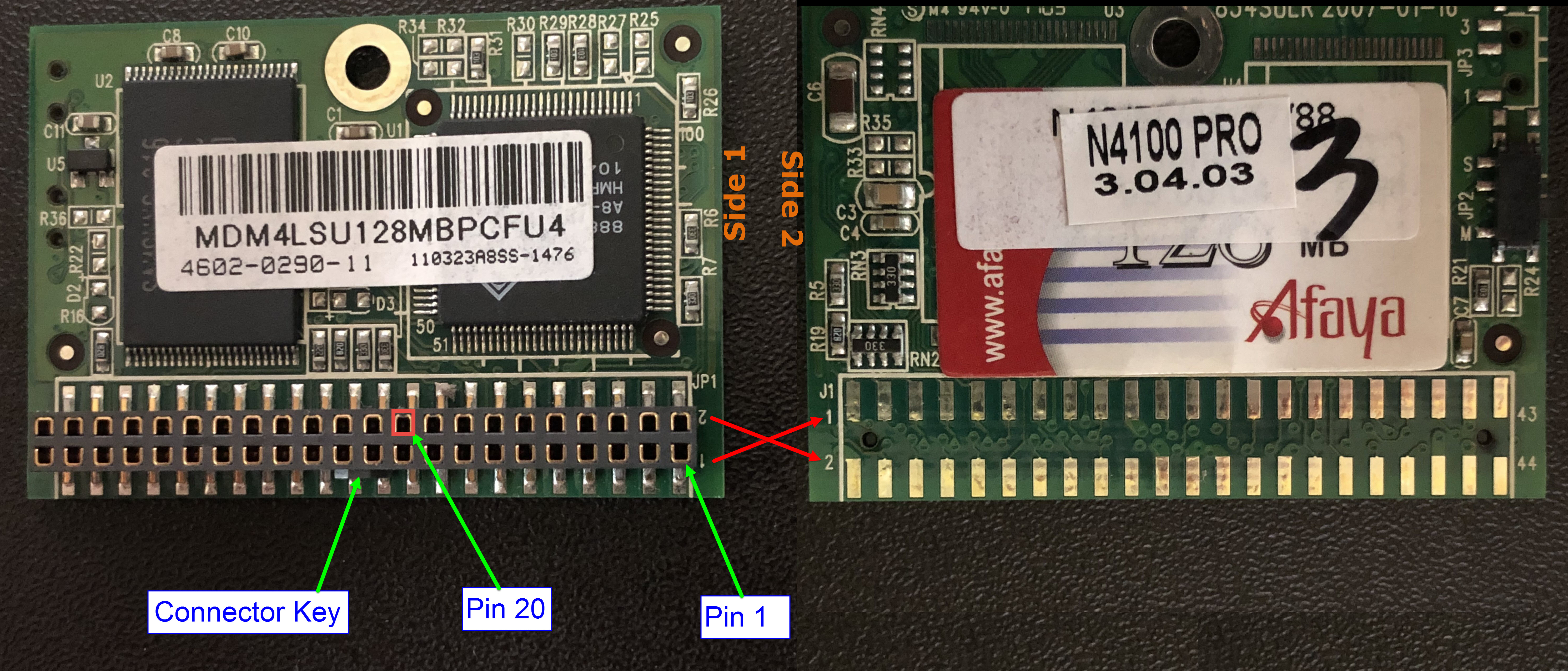

"Gender changer", you say? Not so fast. You cannot just use, say, a header row of straight-through pins (I tried: smoke!). Here's the N4100Pro DOM:

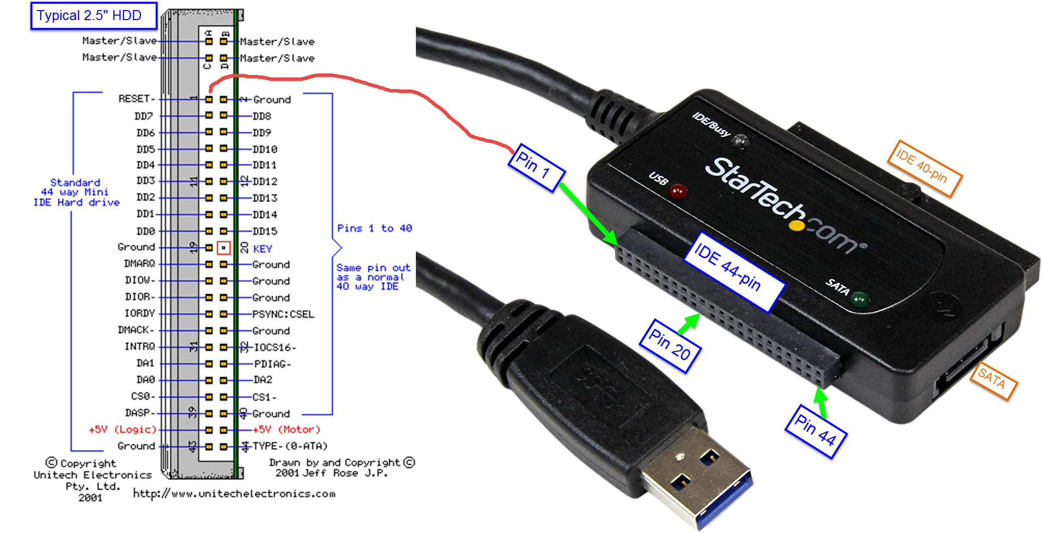

Look at a typical 2.5" 44-pin HDD's pinout, and how it mates to the StarTech Converter:
But Pin 1 on the DOM is on the wrong row. On this DOM, the top & bottom rows are reversed from a standard 2.5" HDD, AND the solder pads on the back of the DOM are also reversed. Tricky.

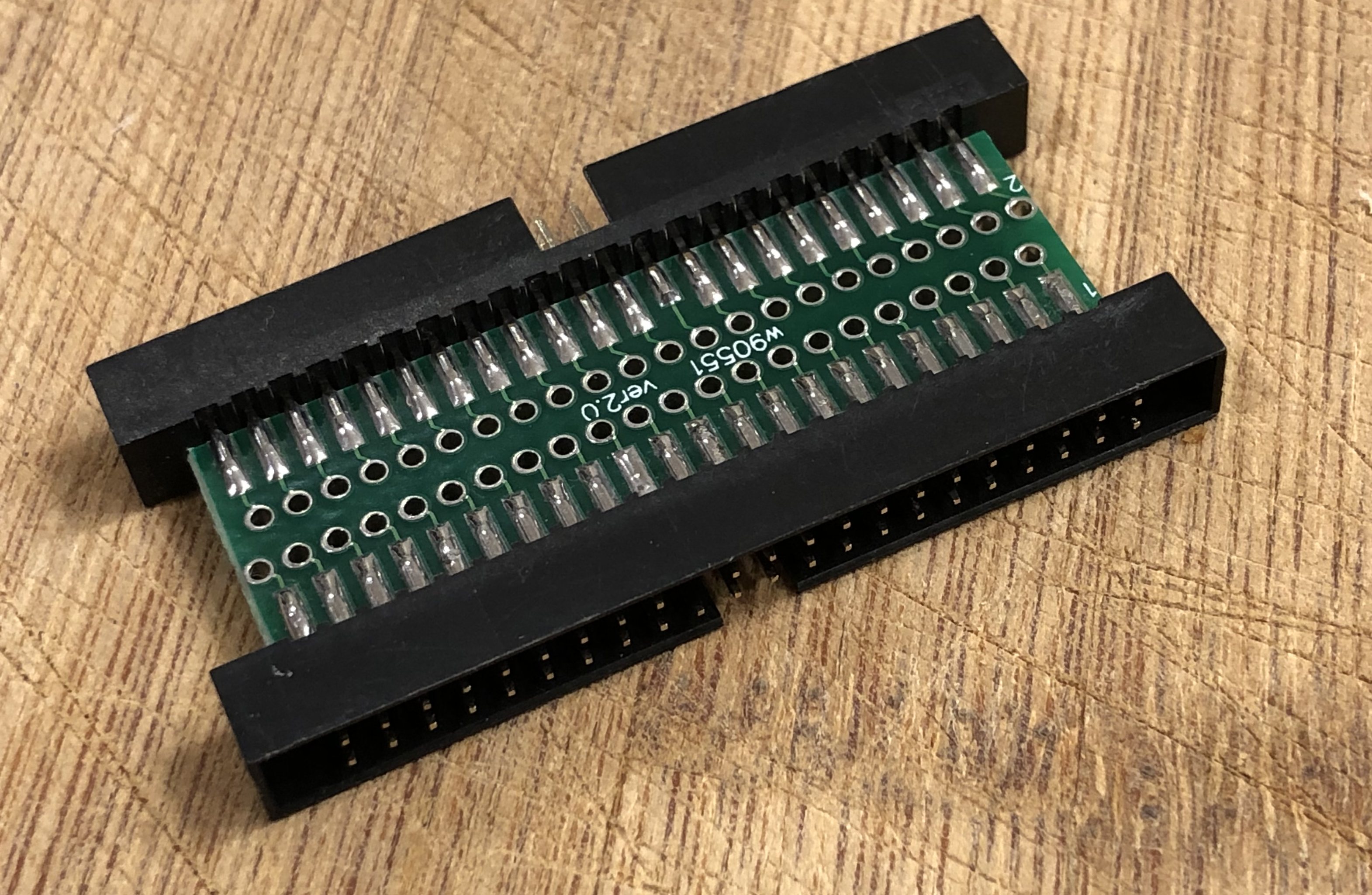

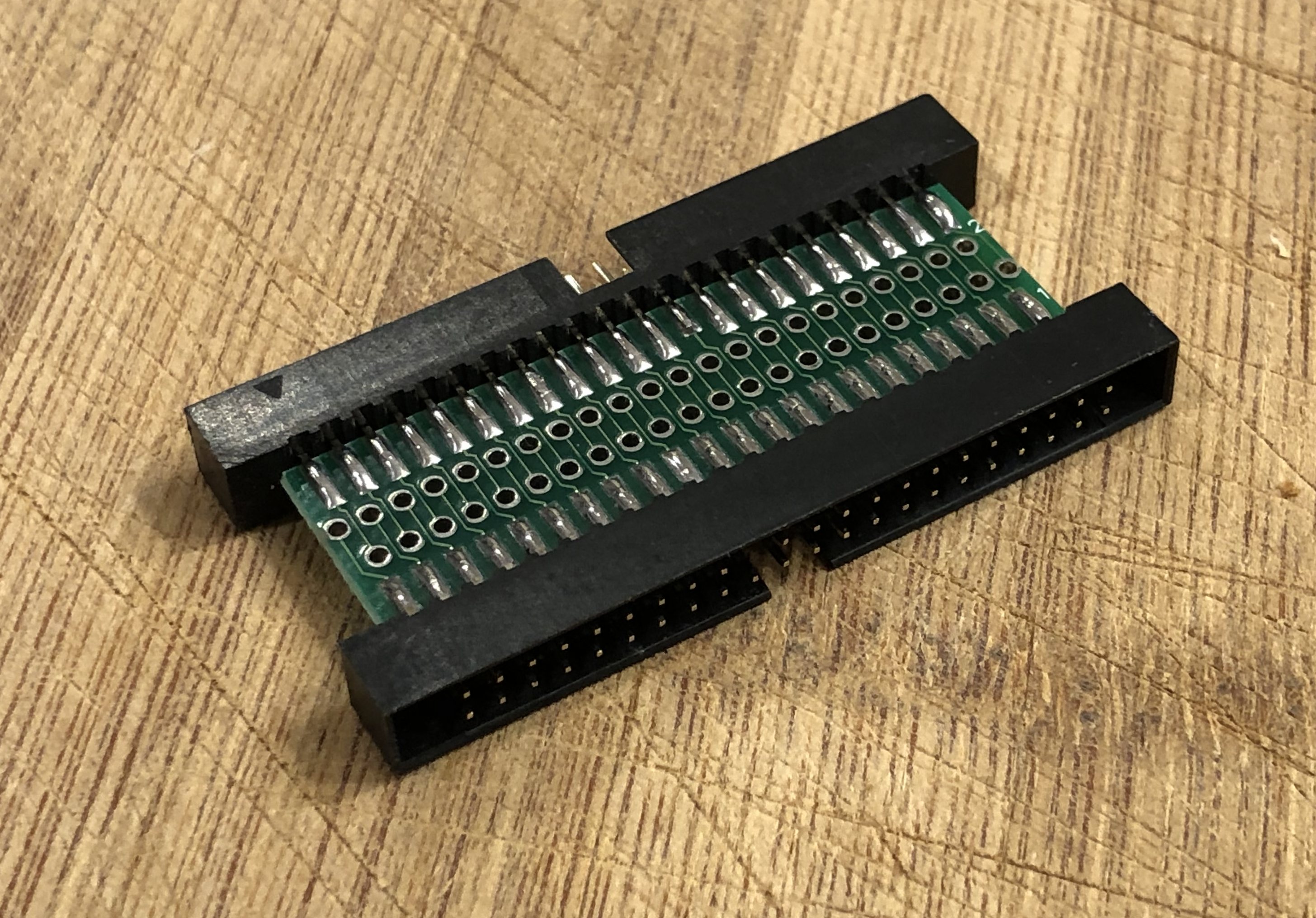

The way to connect this DOM to the StarTech Converter (or anything other than a mainboard that's wired for a DOM, I guess) is this adapter: Amazon JXSZ 2.5" IDE PATA DOM 44-Pin(43pin) Male to 44-Pin(43pin) Male IDE 44pin M-M Adapter
That JXSZ W90551 adapter flips the rows of the header as it changes the gender. Try to find that adapter anywhere in a hurry . . . at this time, it's almost unobtainium if you are in a hurry. I waited three weeks to get one via Amazon, and it is the perfect tool for this job.

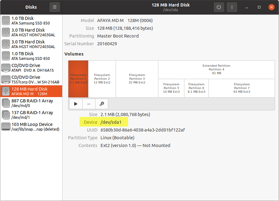

To read from the source DOM, I first used the Ubuntu GUI utility Disks to find which disk name Ubuntu gave it when I plugged the converter into a USB port. These days, Linux enumerates disks sort of alphabetically, eg /dev/sda, /dev/sdb, etc. There are many, many ways of determining what identifier Linux assigns to storage media, with the lsblk command being one of the easier ones. However, with Ubuntu's adoption of snap packaging and runtime environment the system now adds "loops" to /dev ; my system has around 29 of them, this makes reading lsblk output difficult and error-prone. Give me a GUI and a nice picture instead. This screenshot shows the Afaya/Thecus DOM selected in Disks, with the "/dev/sda" highlighted:
Using that, I know how Linux labelled the Avaya/Thecus N4100Pro DOM in the StarTech converter that's feeding the PC via USB. Below is how I read the contents of the DOM and write it to a file:

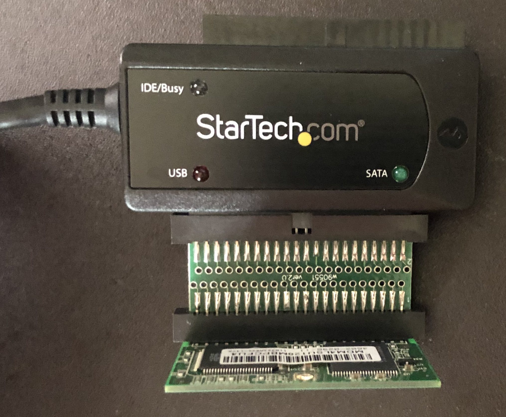

I then swapped out the Thecus DOM from the StarTech converter, for a spare DOM I'd picked up from eBay for $6 for this purpose. Then reverse the if and of of the dd command, and it writes from the file to the new DOM:
