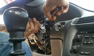

Covering the Nissan '80s style ignition and providing pics was extremely helpful. I found this after researching for this exact thing, but was having a hard time finding pictures of the outer housing and spring - and this post did not disappoint! Thanks guys! -Chris

You can sometimes use a pointed chisel and catch one side of the head and walk it out that way. If you have room, you can also use a Dremel with a fine wheel and cut a slot into it -- you do end up cutting a slot in the screw's well walls, but that's OK.
I use both methods. The pin chisel method is slightly easier and less messy, but is not 100% effective.[/quote]
I have used an automatic center punch for years to remove ignitions that need to be repaired. Some grind the end to a chisel but I prefer to keep a sharp point so it digs in to the head of the bolt and is less likely to skip off. To re-install I use the dremel method to slot the head and a ratcheting 90 degree flat head to get the ignition mounted tight.
