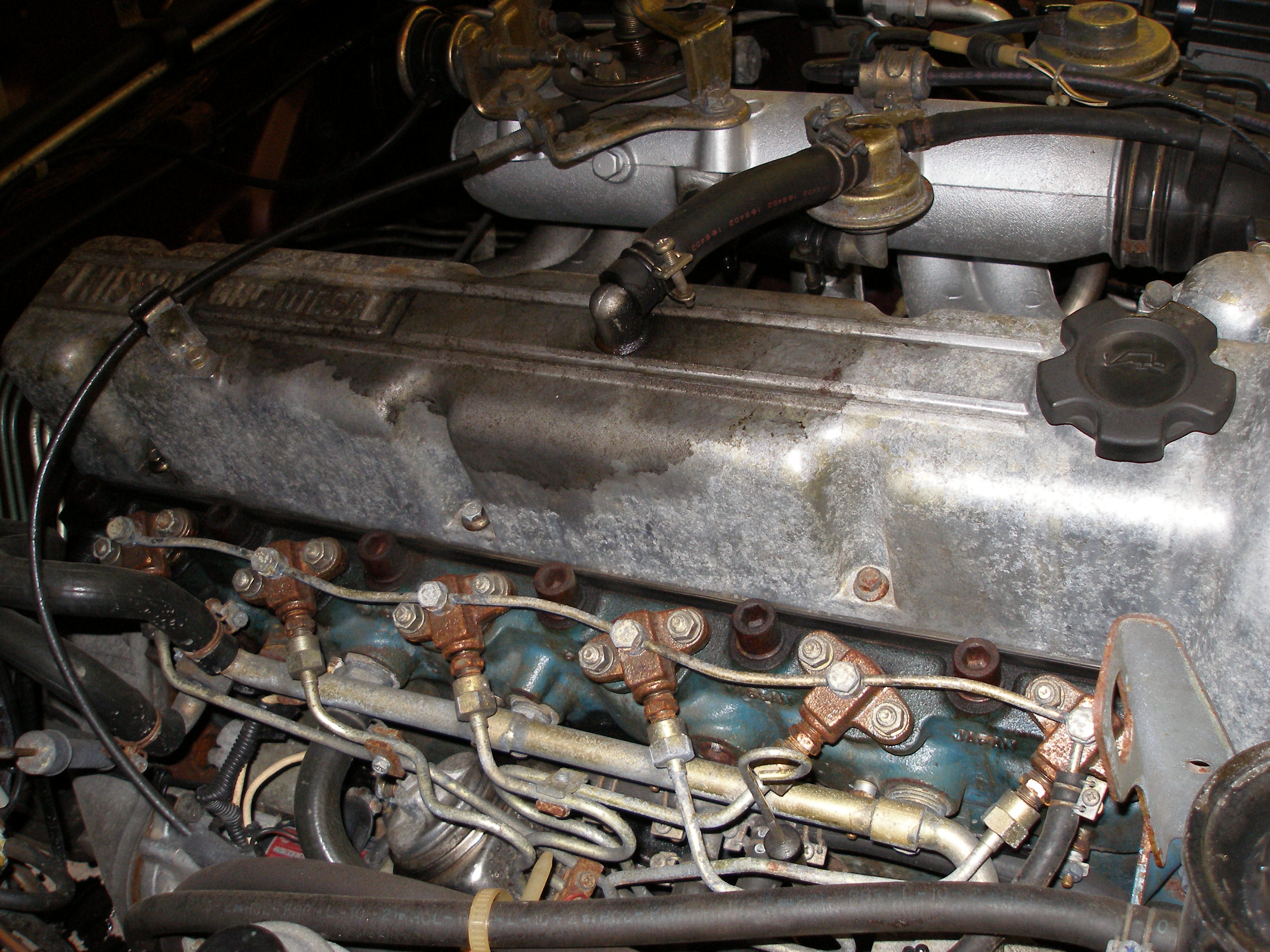

A few months after I clean it, I keep getting this oily mess on the valve cover:

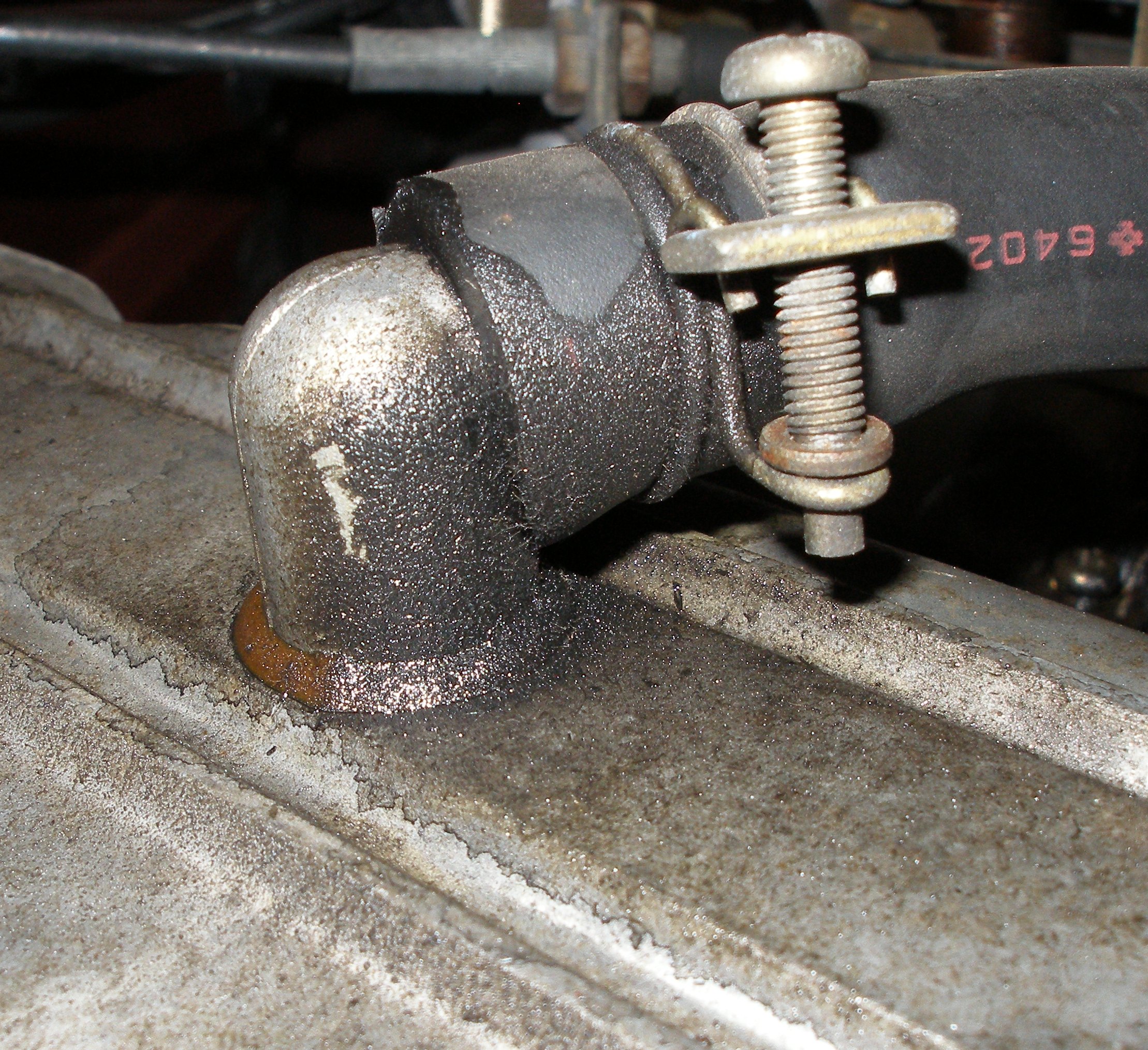

I have replaced the hose (OEM part, years ago) but it didn't help. I suspect the nipple itself is leaking where it connects to the valve cover.
Any thoughts?

I think the plastic grommet yellows and hardens over time, causing it to not seal well. Can't think of where to start looking for a fresh replacement, sorry.

check first but i think its threaded and the brown stuff is sealer.
long time since i purchased an elbo from nissan,these get smashed off easily.

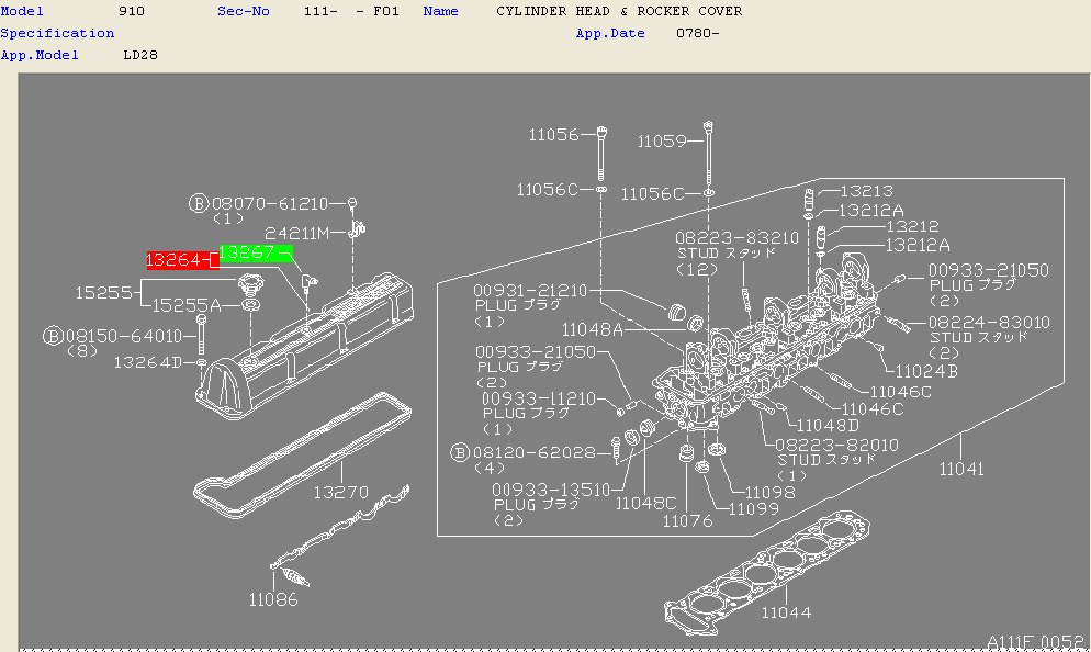

13267-23000 breather conector 610 L18-L20B

Nissan No. 13267-23000, $9
So you think it's threaded into the cover?

oh, you know what i did to fix that. I took a little bit of threadlocker red, applied a large glob to the threads and threaded it in. Holds tight as all can be, but its only been a year or two. I would reccomend doing it with the VC off the motor, in case you screw up and drop some inside the crankcase. I dont think it would be that bad if some got in, but I did it with it off the motor and i didnt notice any threadlocker spilling out the other side, but it sucks having a simple fix turn into a major mess.

the fitting is has a die cast tappered thread.
some times they snap off.
ive often had to strip out the oil seporator.some are no serviceable.

That brown sealer is already cracked and liquid does get through it.

Did you ever resolve this leakage? Will the elbow unscrew from the top and allow re-seating w/ (some kind of) new goo? That sounds like what Kassim did. Or is it just glued into a hole in the cover? Kinda annoying. Also, the PVC valve thingy at the other end of that hose looks like it seeps pretty good too. Anybody know which end or seam on that thing is the major culprit? I'll get onto this one of these days and post what I do.
It sure looks like it.
