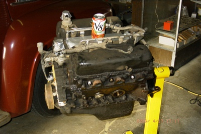

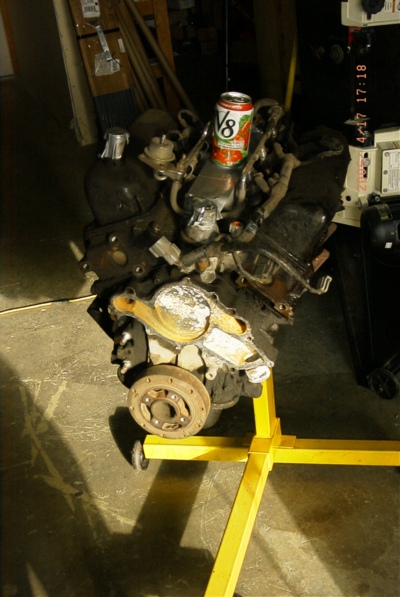

Pulled the right head off last night . . .
Image Image Image Image Image Image Image Image Image Image Image Image Image
And the culprit: blown head gasket.
Somebody "repaired" the outboard starter mount by welding in a stud of some unsuitable material:
This engine stand has a label that states "HEAVY DUTY 1000CAPACITY ENGINE STAND" (just like that). Evidently, they don't mean 1000 lbs! I don't know what the 6.2l fully-dressed weighs, but it's certainly under a half-ton. I kept the overhead chain on and bearing weight until I could pull off the front and manifolds.

That does not look good. Who were these people? I can go down there with you as backup when you go talk to them.
Both David & Patrick seemed very personable and I really had no reason to suspect anything. But this engine has not been run in a long time, and with the blown head gasket, it was just full of water. It took more than two hours for most of the "oil" to drain from the sump. The heads are shot, the rockers are shot.

That motor has spent at least a few years outdoors with water getting inside it. It had so much water inside of it I wouldnt even bother to salvage the block, because of the corrosion from the head gasket, and the cooling passages seem to be completely filled with gunk. The torque converter definitely was a clue, but if that was me I would thinking nothing of it so dont feel bad, personally, I wouldnt even bother to unbolt the converter if I pulled the motor (condensing the eyesore). At least you have a spare imanifolds, covers and a/c compressor.
Guess every deal cant go good, every once in a while you get "that deal" that just ruins the winning streak.
And dont trust the engine stand, mine broke after I put a chrysler slant six on there. It snapped the back plate off the tube that goes thru the hole. Resulting in a crushed 5 gallon bucket, bent crank pulley and damged pan. Also there was a gouge in the floor of my garage. the 6.2 should be pretty darned heavy, its really is a big block, with alot of extra iron for to make it a good diesel motor. If i had to run a v8 diesel id go with a 6.2, they are time tested, and the military uses them.
I think it sat for a long time in the truck it was run in, with water in it. It may have run reasonably well before it was parked, but with the oil the grey it was, and all the rust on the valvetrain, it was run with the leak before it was shut down.

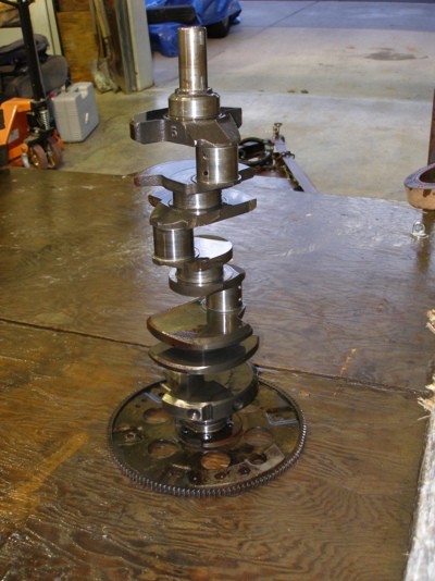

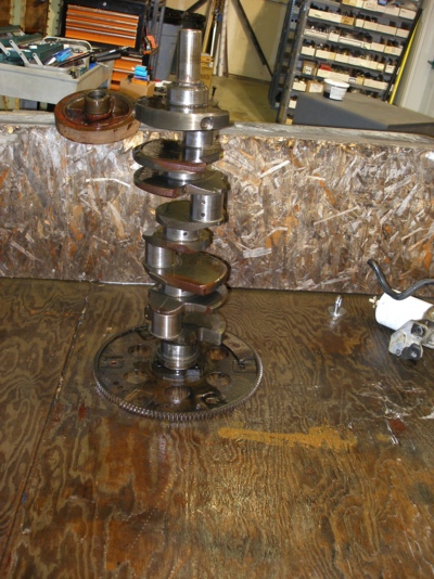

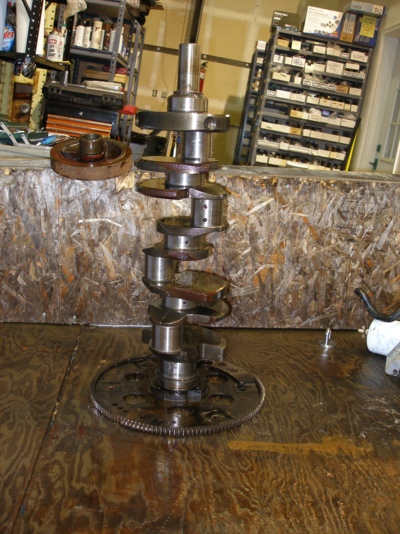

Pulled the pan and the crank today, the last bits that could be salvaged. The crank will have to be reground, there's rust pitting and some light scoring that could be polished out, but I don't know as I'd do that: regrinding is safer, if more expensive. Some obvious heavier rust on the counterweights that sat in the oil/water bath, but no serious rust where it counts. It could be re-used.
