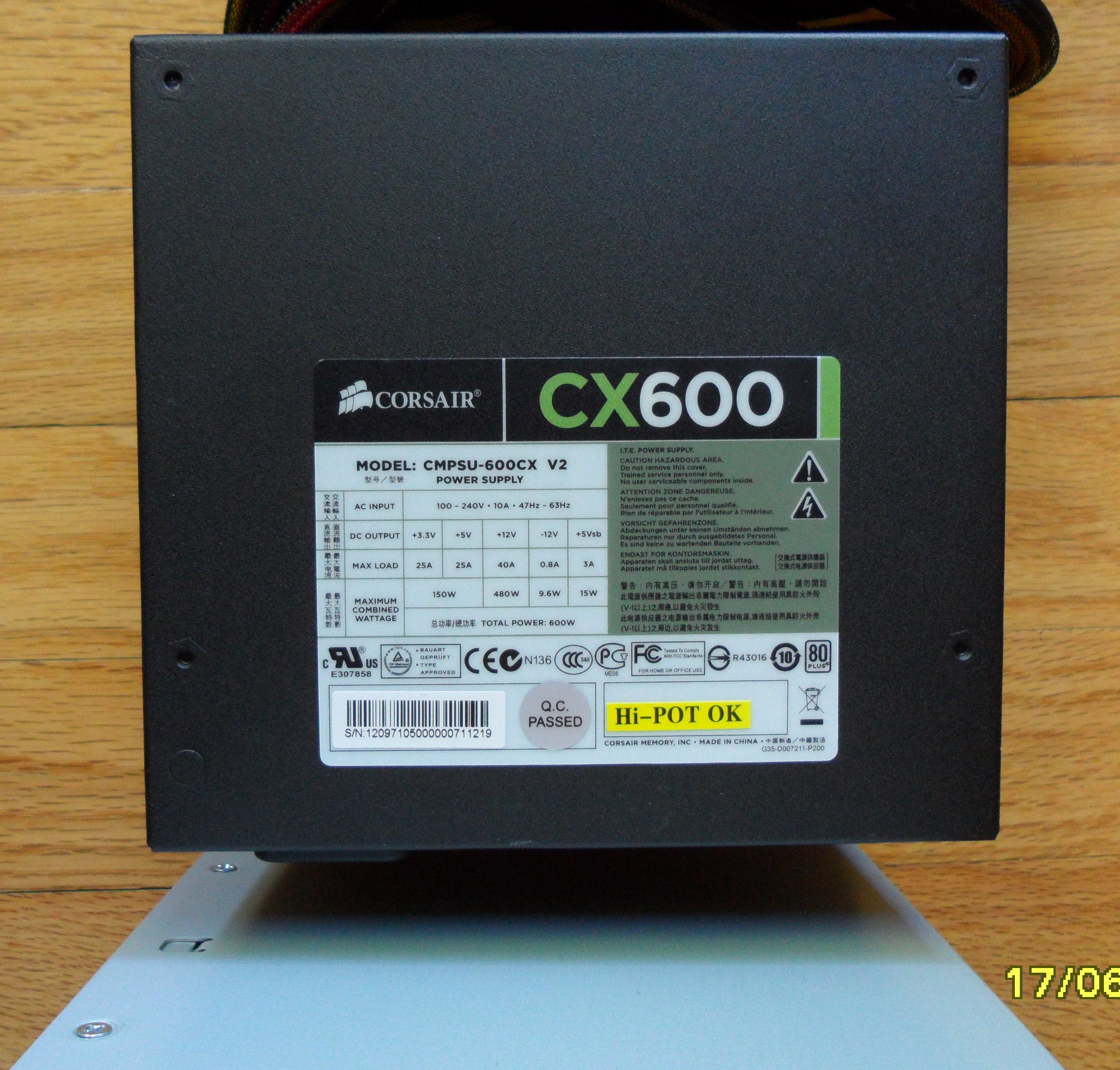

The PS I chose is a Corsair CX600v2. After a modest rebate, it was about $60.
The CX600v2 is a tad shorter than the HP's:
But, it's a bit wider:
There's plenty of room in the case:

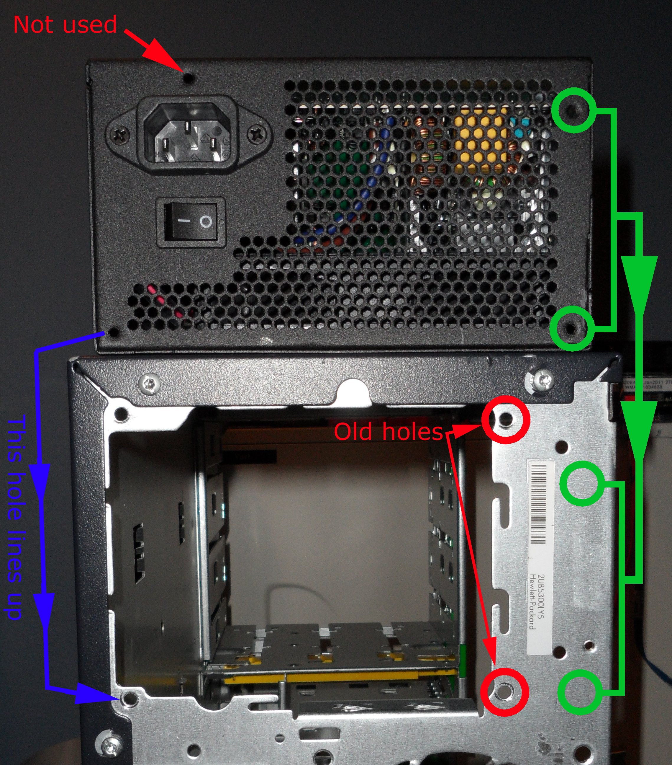

However, at least two mounting holes have to be drilled, and a small ledge in the case must be removed. The lower left hole can be re-used, the upper left hole in the PS is not used, and the two right holes have to be created in the case.

The dimensions to drill the new holes. I drilled 5/32" holes, which worked well.
Finished:
With the bits reinstalled:
