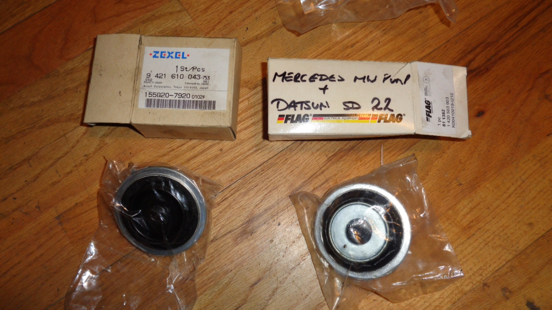

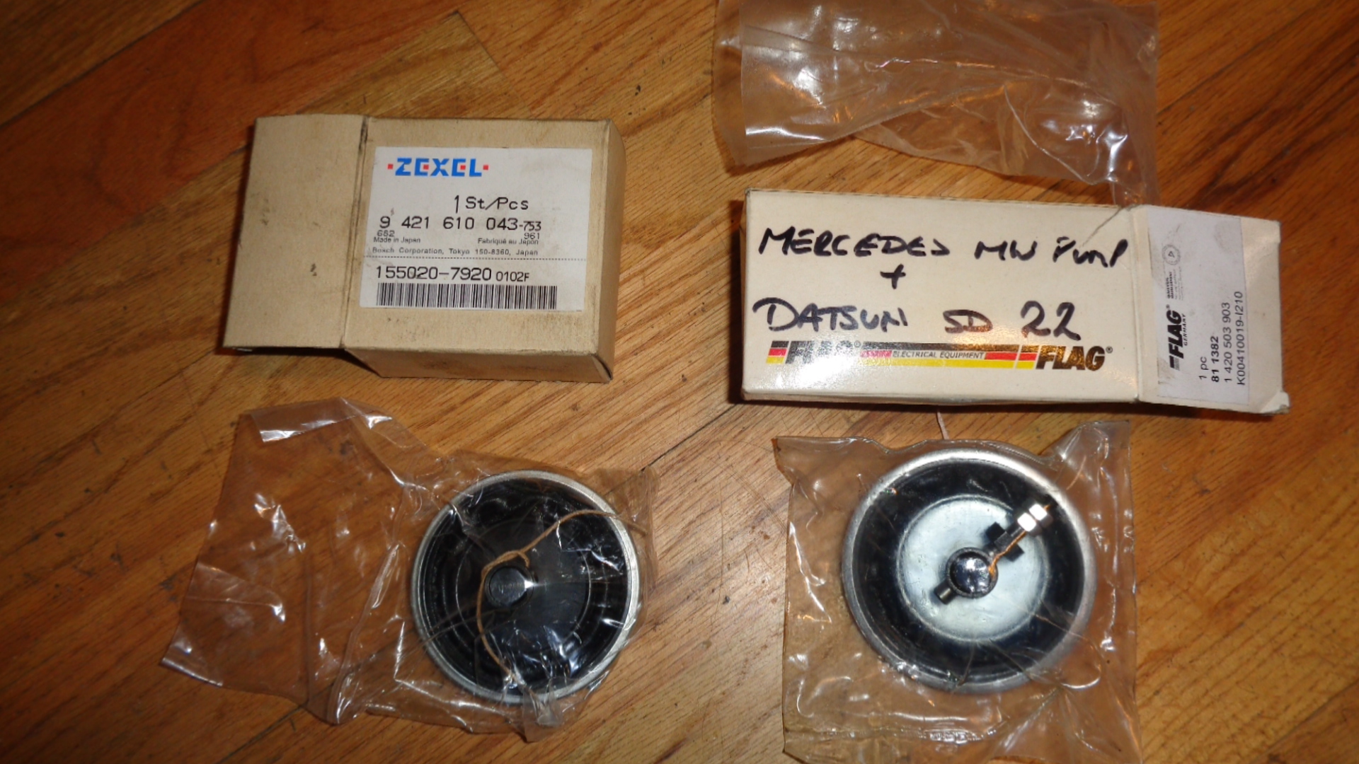

I have 2 boxes with numbers on them, here they are
Zexel 9 421 610 043-753
_____682___________961______The 682 is under the 9 and the 961 is under the 753, both in smaller print, the -753 is also in small print.
1 55020-7920 0102f
The other one is for a Mercedes MW pump which fits a SD22
Flag 81 1382
1 420 503 903
K00410019-1210
This is all I have, I am not sure which numbers are the part numbers, neither box says what the part is on the box.

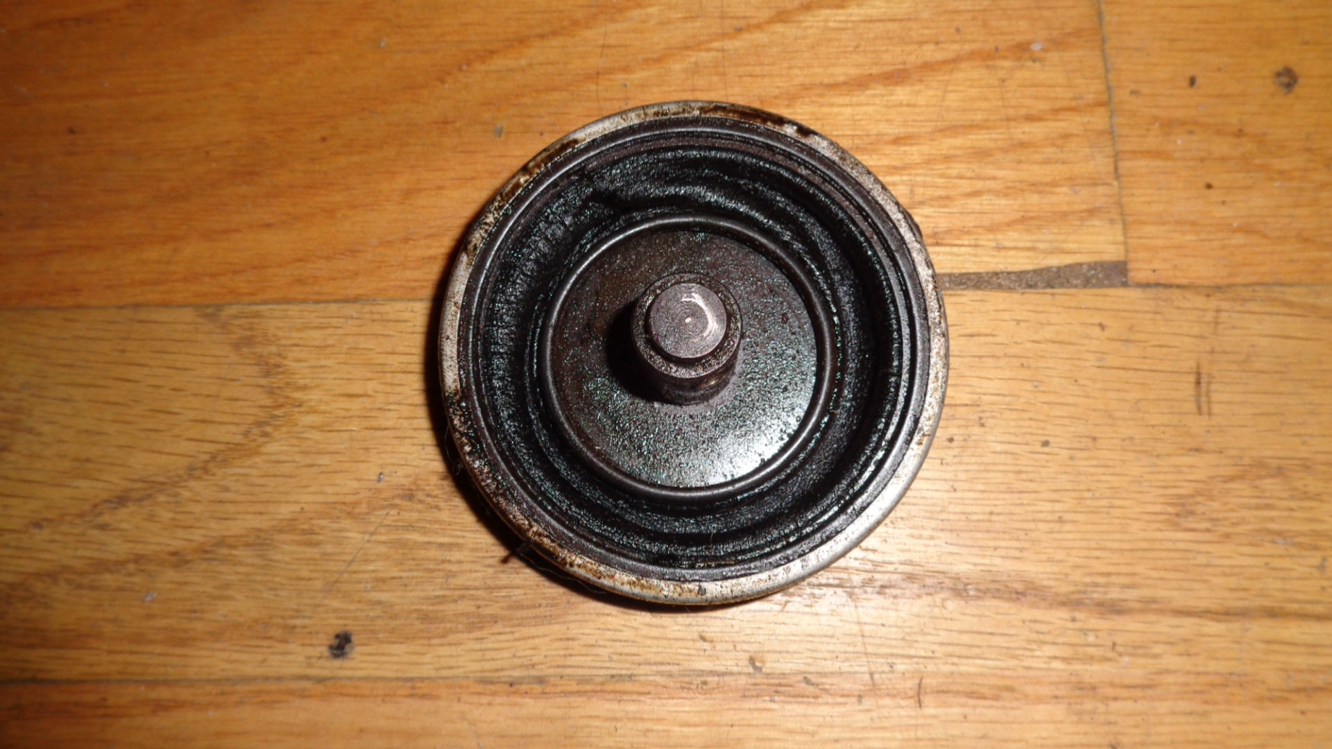

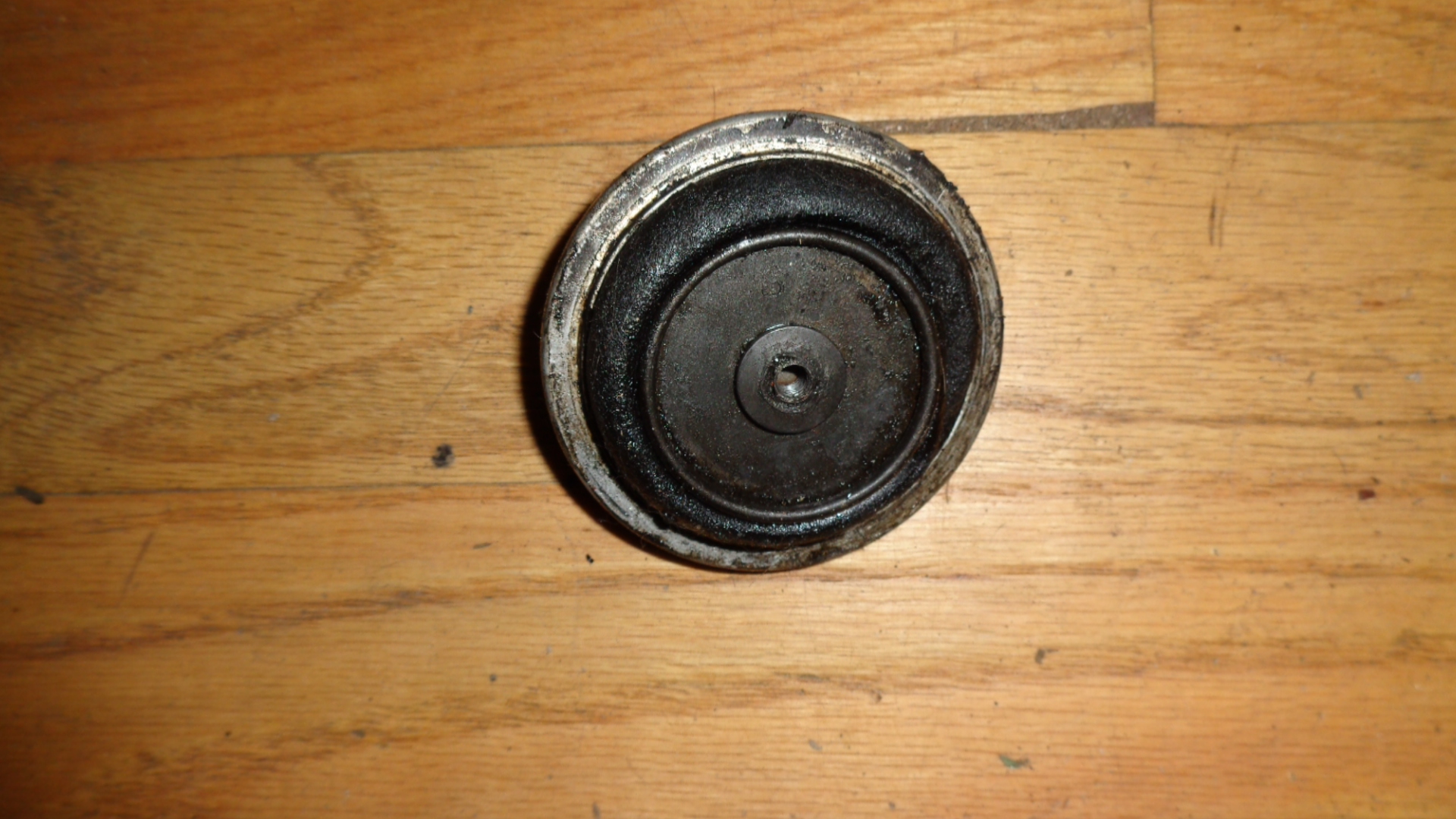

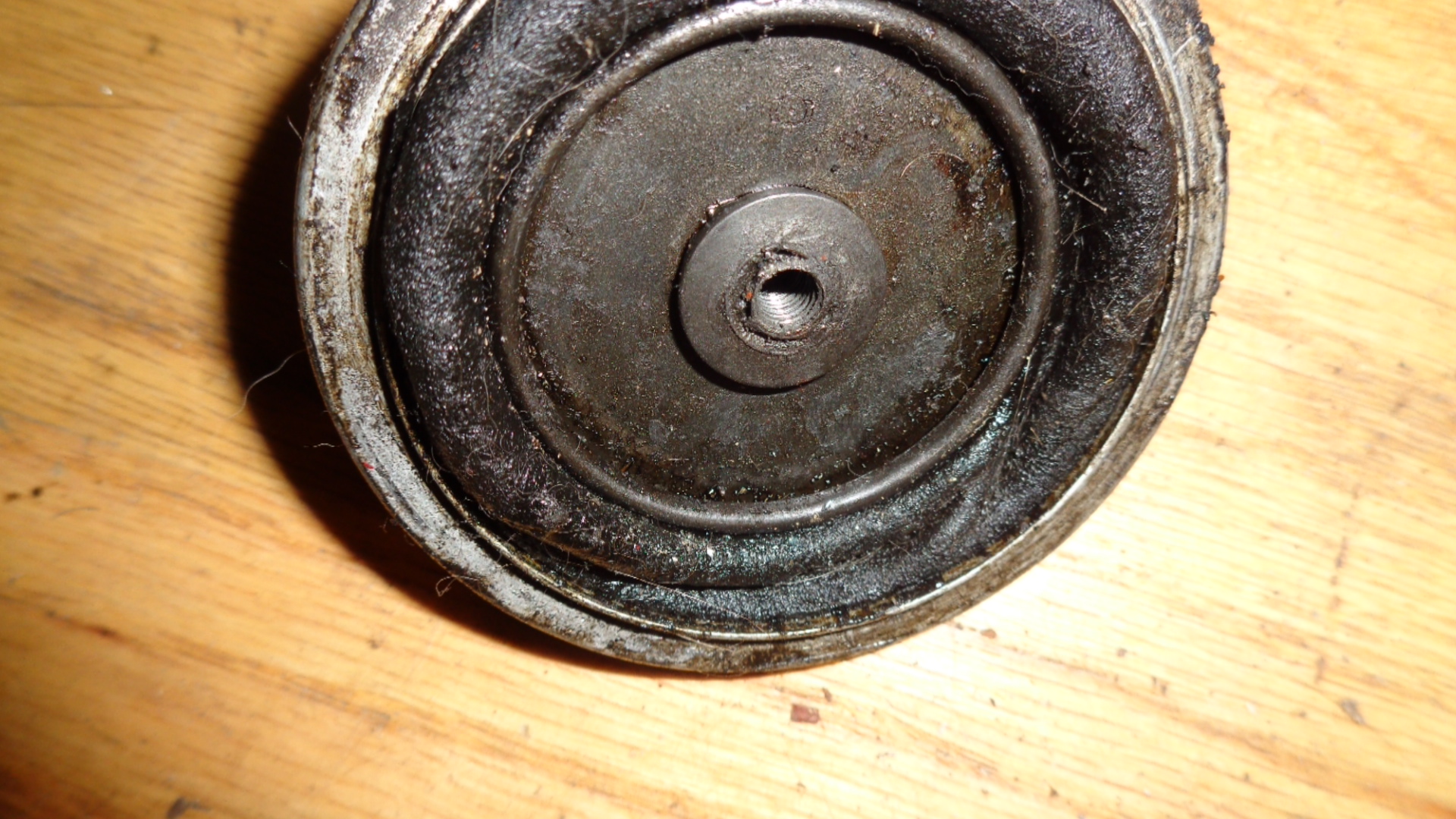

I have 2 brand new diaphragms, but I will not sell them, the boxes are what I got the numbers off of, I have several SD series engines so I collect parts when they are available.
All you need is the diaphragm, every one of these parts I have ever seen just came with what is in my photos below. I have an old used one in an old injection pump I have, I have no idea if it is good or not, below are photos of it. You can see in the photo below that I threaded the hole in the center, I did not drill the hole, I just threaded what was there, I had planned on trying to make the injection pump manually controlled so I could turbocharge it, but I figured out how to turbocharge it without changing anything on the injection pump. I cannot see any holes in this diaphragm, and it is soft(not dry) and appears to move fine, I suppose I would take $30.00 shipped USPS flat rate box to the lower 48 states, I cannot guarantee this part as it is an old used part, all I can say is it is soft and pliable.

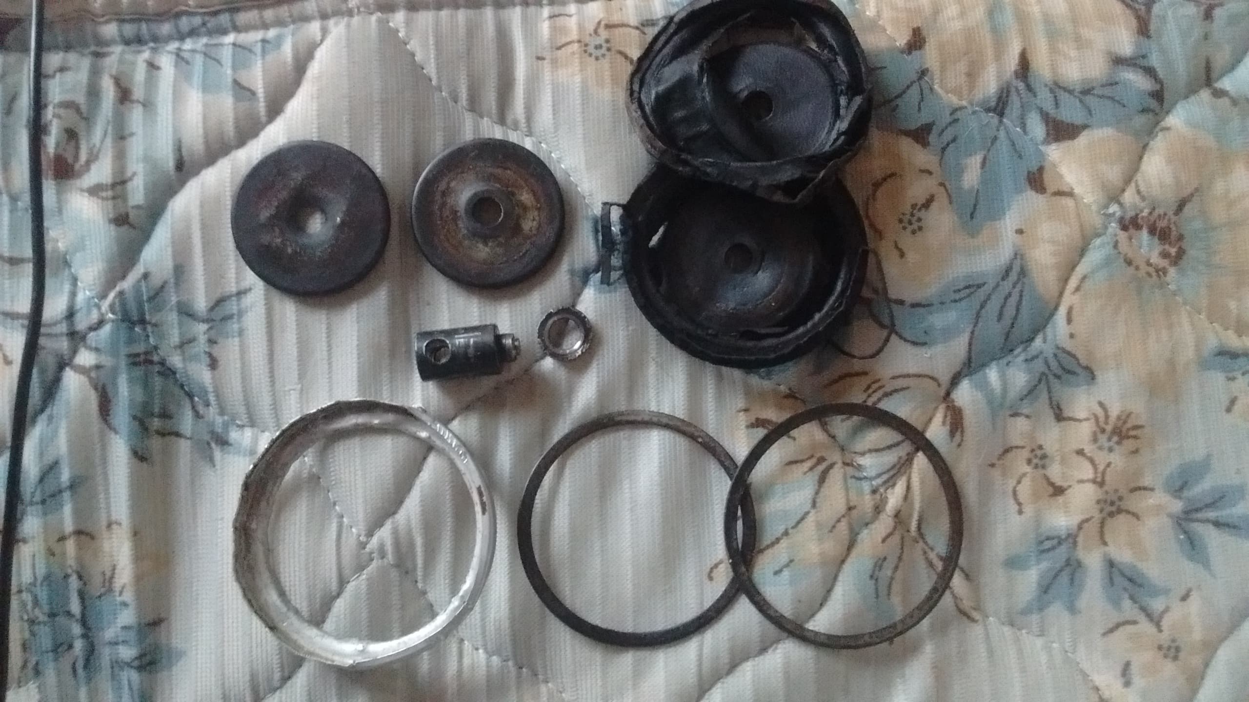

the used one would be too risky. since I plan to daily this truck if I can get it fixed. we tried local shops with no good answer and that's why I went to see if I can form my own. if I succeed it might be a good way to make a little extra cash by repairing broken ones. I managed to get the whole diaphram apart without destroying anything to bad and im going to machine a press form to make a new diaphram out of neoprene or likewise rubber. and see if I can reassemble it well enough to work well.

i had fair luck taking the whole assembly apart and if i can get a system for forming a diaphram rubber I should be set for making one. the aluminum ring on the outside was slightly mangled getting it uncrimped so i may have issues using it but if I can get the orientation of the diaphram right i should be able to make a seal without the ring on the outside. possibly using an o ring as a sealing spacer in the recess for the ring.
