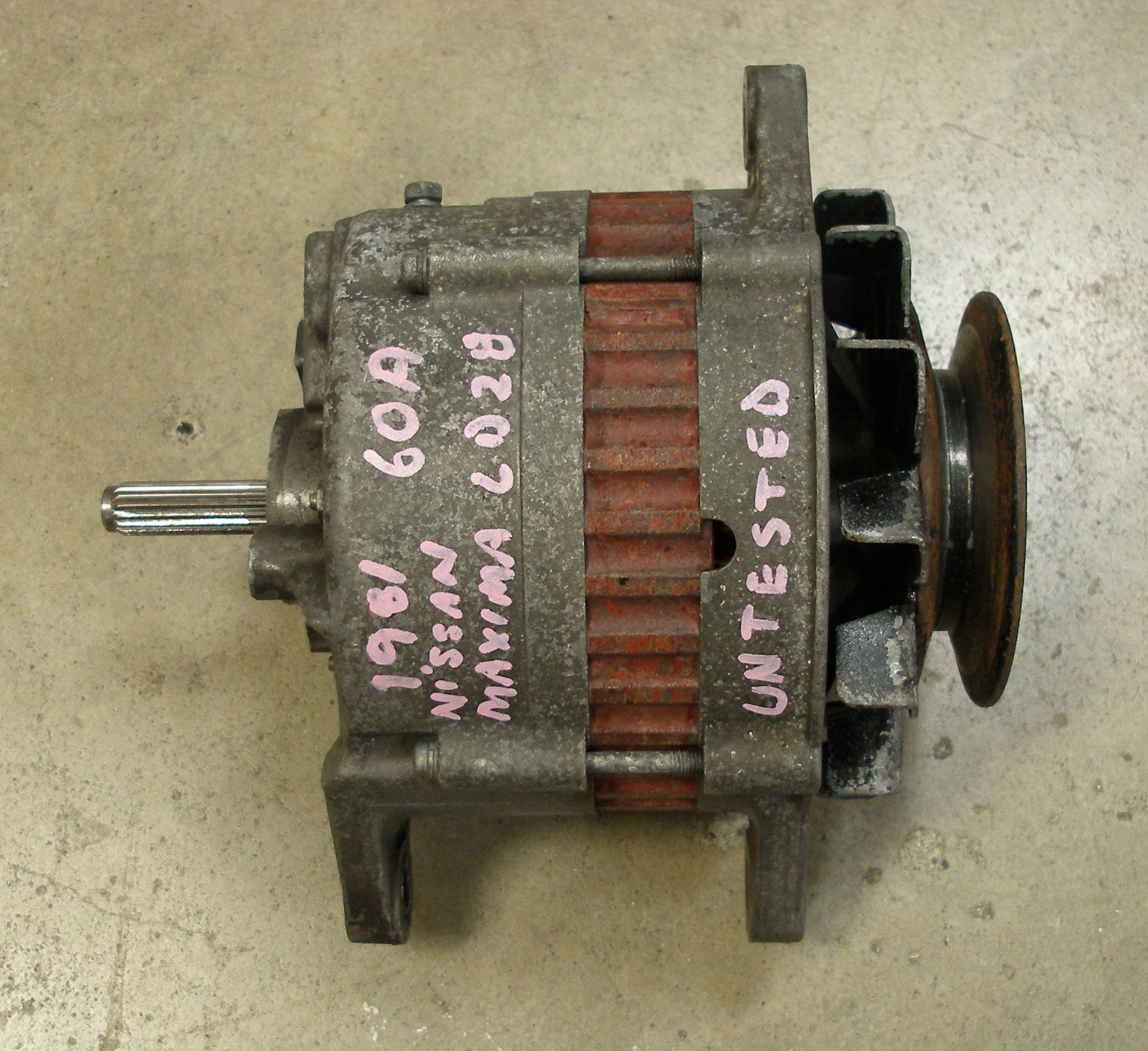

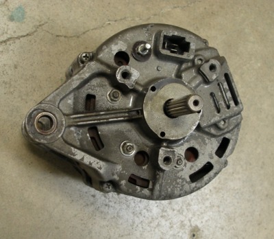

The vacuum pump can be useful for power brakes, and if you have A/C, to run the various mode doors. If you don't run a brake booster, the pump comes off the alternator with three screws (typically No. 2 Philips head). However, the rotor's shaft will be hanging out in the breeze. Keep your hands away!
This last pic is of the 720 PU version of the alternator, which has a smaller vacuum pump and thus a shorter rotor, but it gives you some scale.
Oh, and member zoomsplatt cut down his LR160 rotor, to fit the longer rotor to the shorter 720 vacuum pump, so you could cut yours flush. His pics are in this post. Don't throw away the pump; while they don't seem to wear out, a couple folks have broken theirs, or otherwise needed one recently.

I just found a couple pics of an LR160 (Maxima/LD28) without the pump attached.
