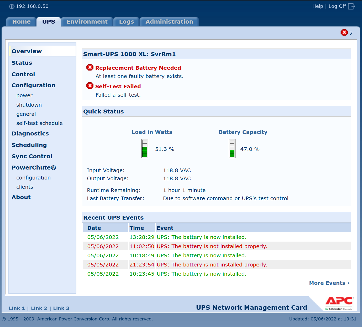

APC SUA1000XL &quot;The battery is not installed properly&quot;
APC SUA1000XL "The battery is not installed properly"
Sure enough, when I used my Schumacher BT-175 battery tester, they showed really quite bad, both of them but one quite a bit worse than the other, and they would not charge. Off to Costco, installed two new batteries, let it charge for 30 minutes, then triggered a Self-Test, and fifteen seconds later, the red LED went out and all is well.

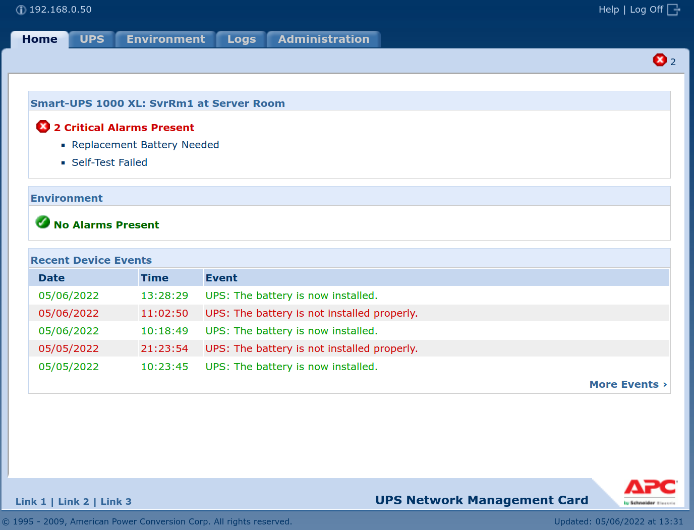

APC SUA1000XL: &quot;No alarms present&quot; after batteries replaced and Self-Test run (tests under load).
APC SUA1000XL: "No alarms present" after batteries replaced and Self-Test run (tests under load).

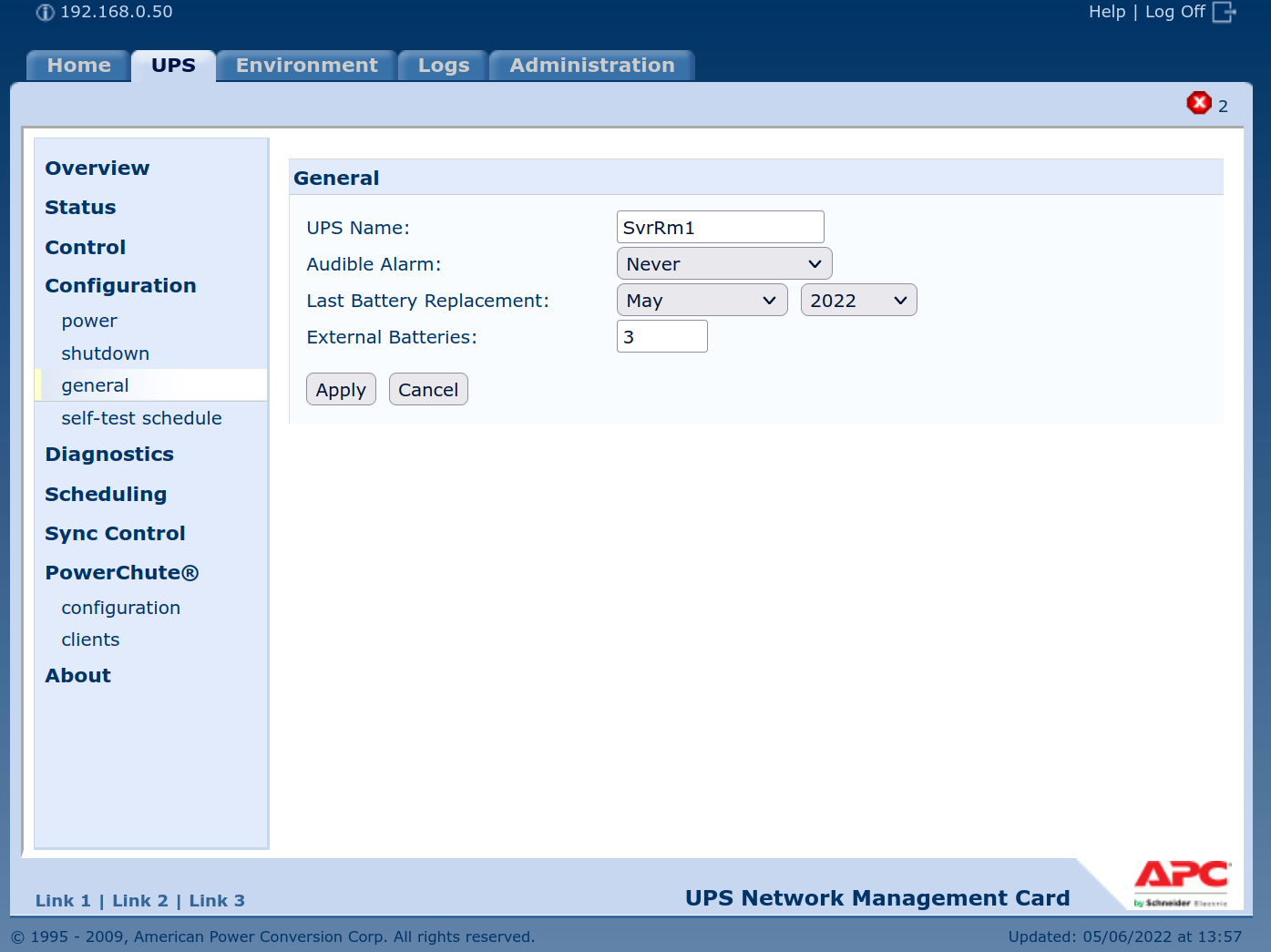

Don't forget to reset the "Last Battery Replacement" date, or you may find the UPS alarming unexpectedly when it thinks the batter(ies) are EOL.
APC SUA1000XL: Reset the &quot;last battery replacement&quot; date.
APC SUA1000XL: Reset the "last battery replacement" date.

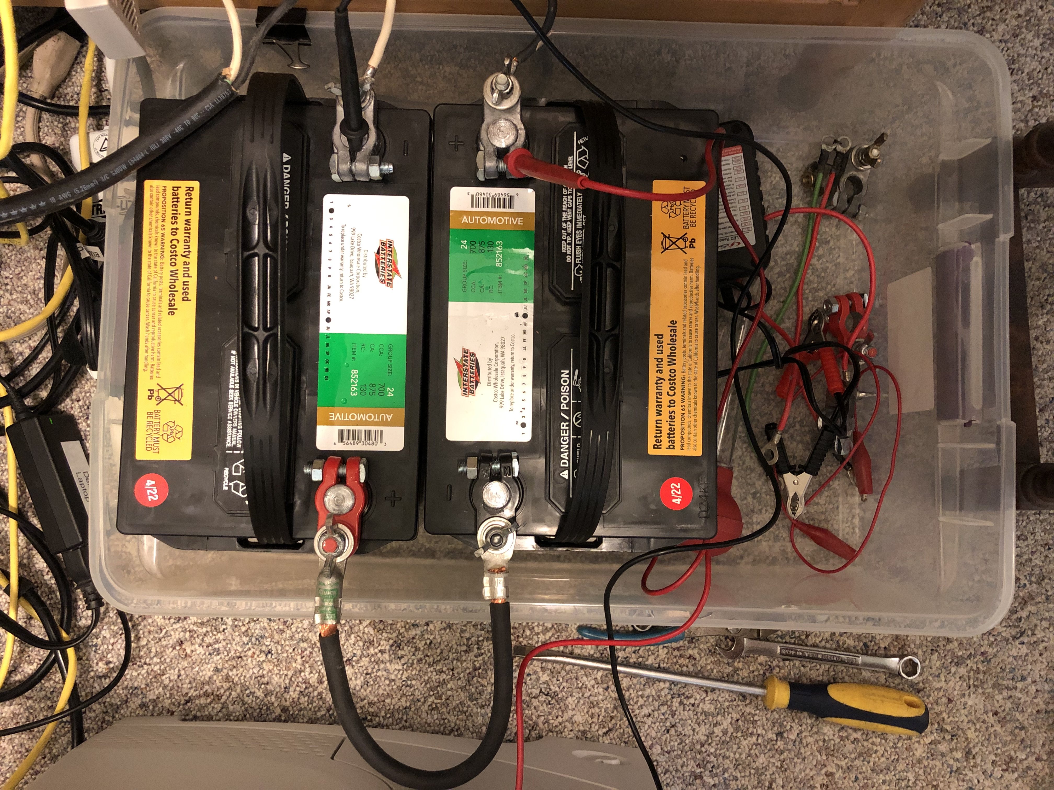

Current setup. At some point, I scrapped another huge UPS project and salvaged this nice jumper cable and terminals, so although 10 AWG wire would be more than sufficient for this UPS' load, I put this jumper here anyway.
APC SUA1000XL external batteries, May2022.

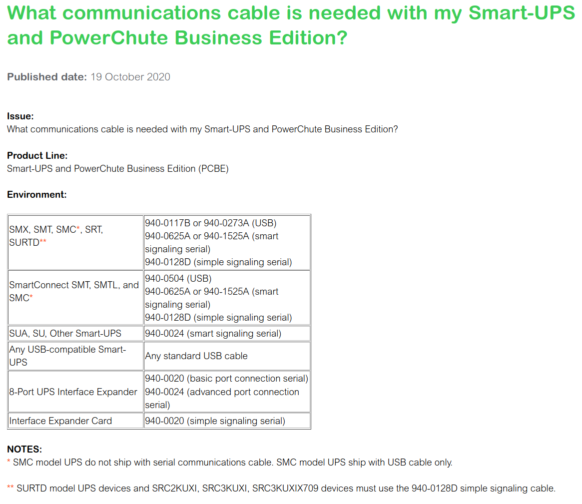

For the search engines . . .
Smart-UPS cables chart
  • SMX, SMT, SMC*, SRT, SURTD**
    • 940-0117B or 940-0273A (USB)
    • 940-0625A or 940-1525A (smart signaling serial)
    • 940-0128D (simple signaling serial)
  • SmartConnect SMT, SMTL, and SMC*
    • 940-0504 (USB)
    • 940-0625A or 940-1525A (smart signaling serial) (DB9F<->RJ50M)
  • SUA, SU, Other Smart-UPS
    • 940-0024 (smart signaling serial)
  • Any USB-compatible Smart-UPS
    • Any standard USB cable
NOTES:
* SMC model UPS do not ship with serial communications cable. SMC model UPS ship with USB cable only.
** SURTD model UPS devices and SRC2KUXI, SRC3KUXI, SRC3KUXIX709 devices must use the 940-0128D simple signaling cable.
