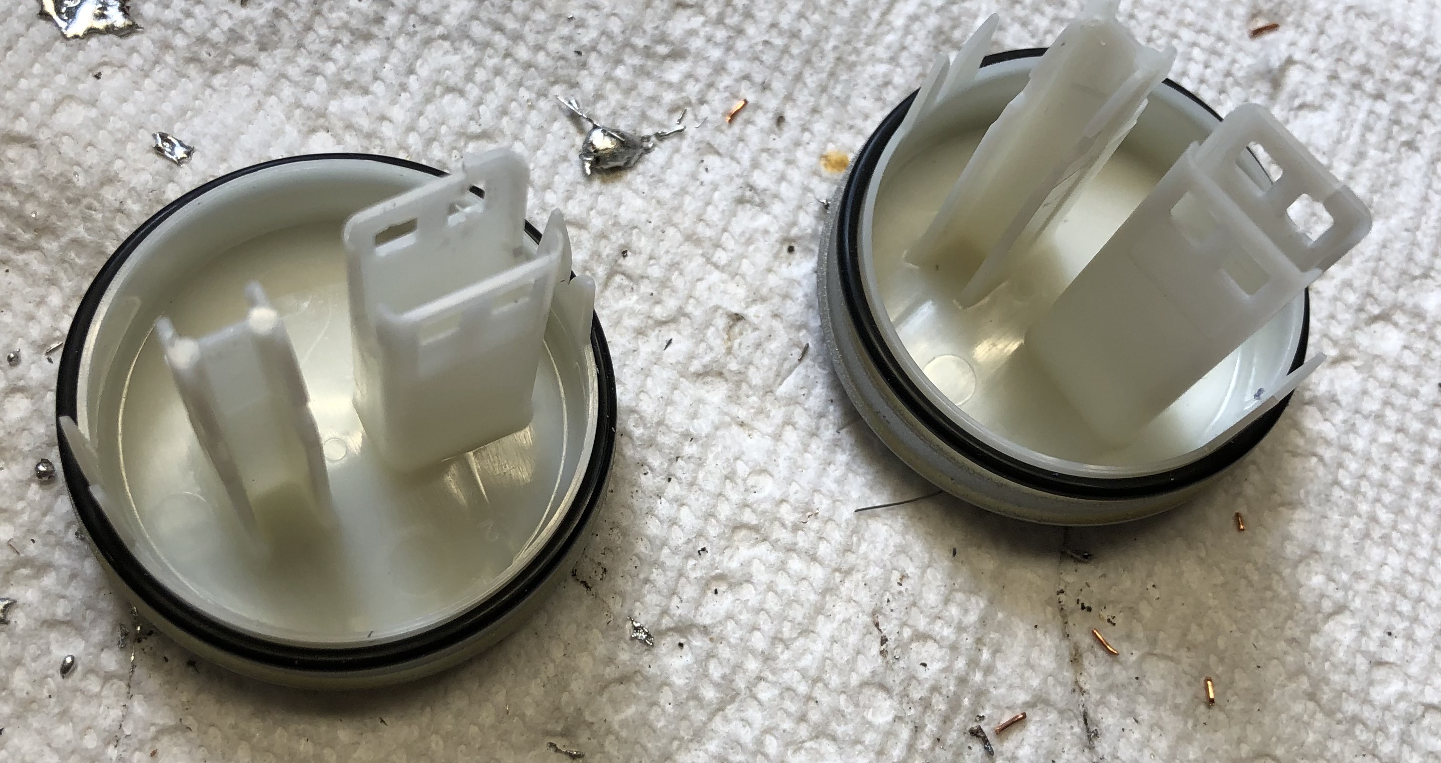

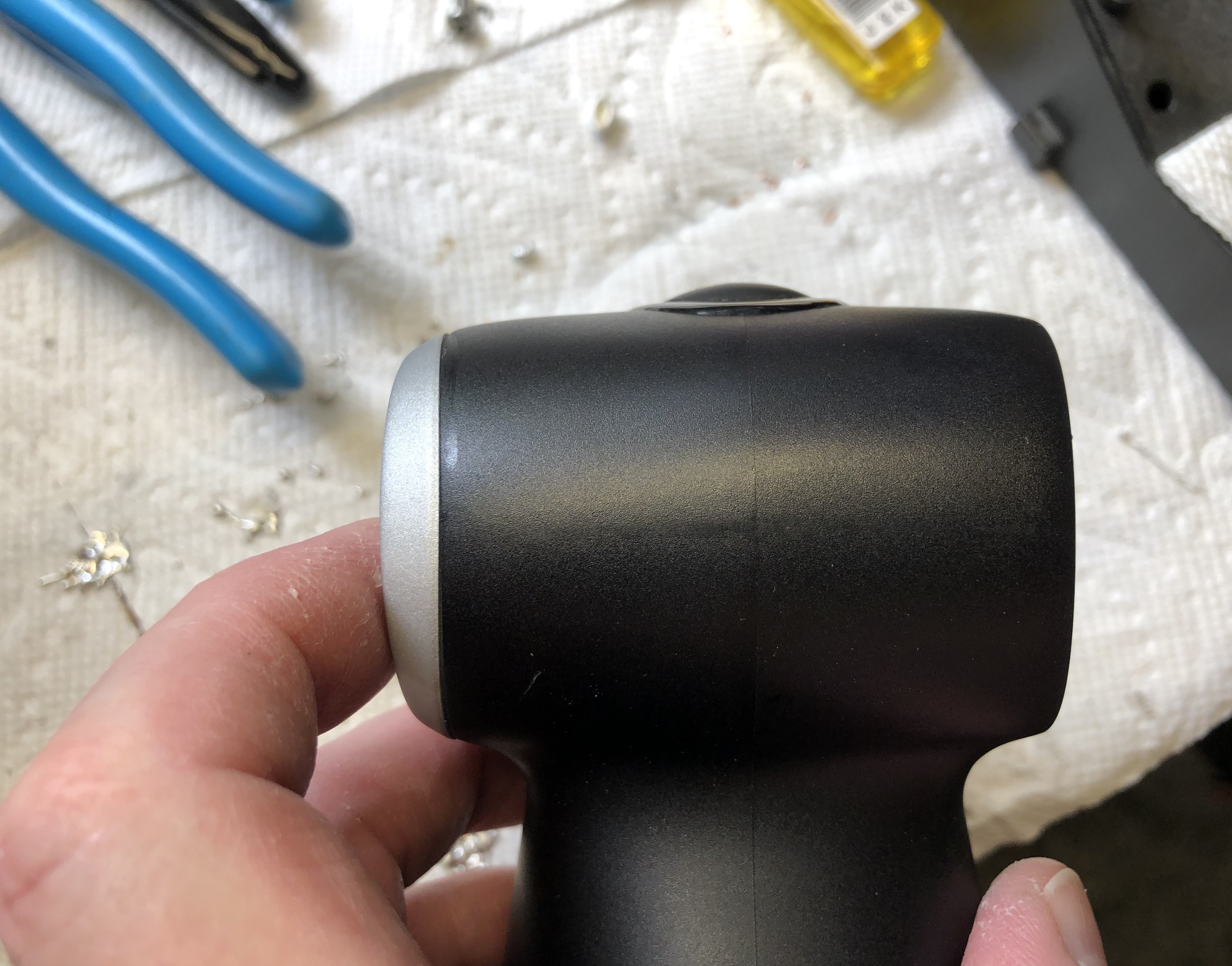

To replace the battery, you need to access the area under the silver end caps. The silver end caps incorporate o-rings for sealing, and lock into each other, not to the black housing. Here are the end caps removed, showing the dual-prong locking mechanism:
Cobra Libre: silver end caps, showing o-rings and dual-prong locking mechanism

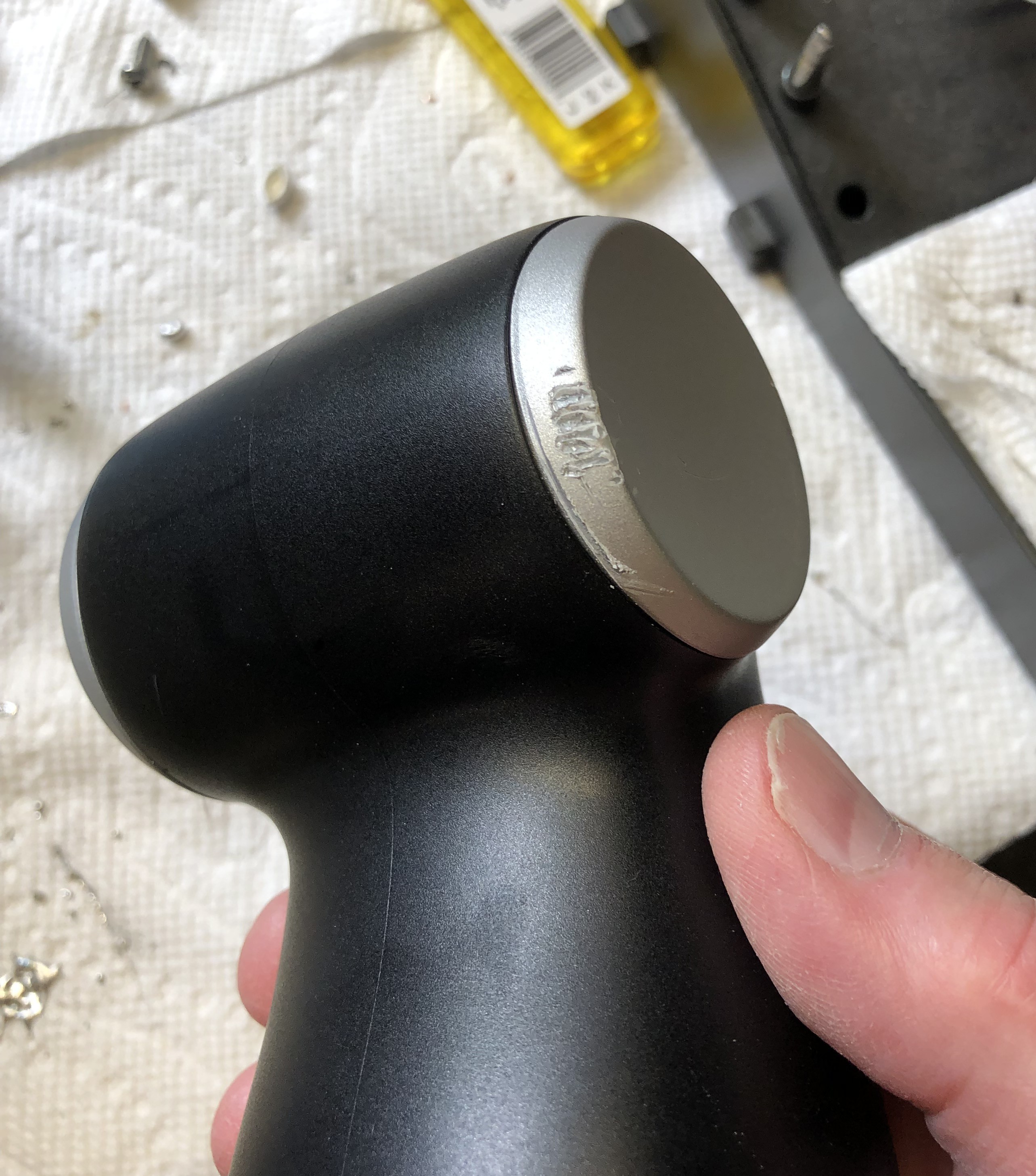

Here, you can see some of the damage I caused by prying first, before I twisted.
Cobra Libre: damage from trying to pry end cap off
To unlock one cap from the other, I used slip-joint pliers ("ChannelLocks") and twisted (rotated) one cap about 5°, then pulled out. You can't pry or pull out directly, because the prongs are locked until you rotate one or the other cap. This is the damage caused by the slip-joint pliers to twist the cap:
Cobra Libre: damage from twisting end cap to disengage locking prongs, prior to pulling it off
In retrospect, I would have tried some smooth jaw curved pliers instead of the toothed jaw, but due to the beveled surface it's quite difficult to get a grip on the silver caps, so it may be that some plastic damage is inevitable. But only to one cap, and the sealing surface for the o-ring is not compromised by this method.

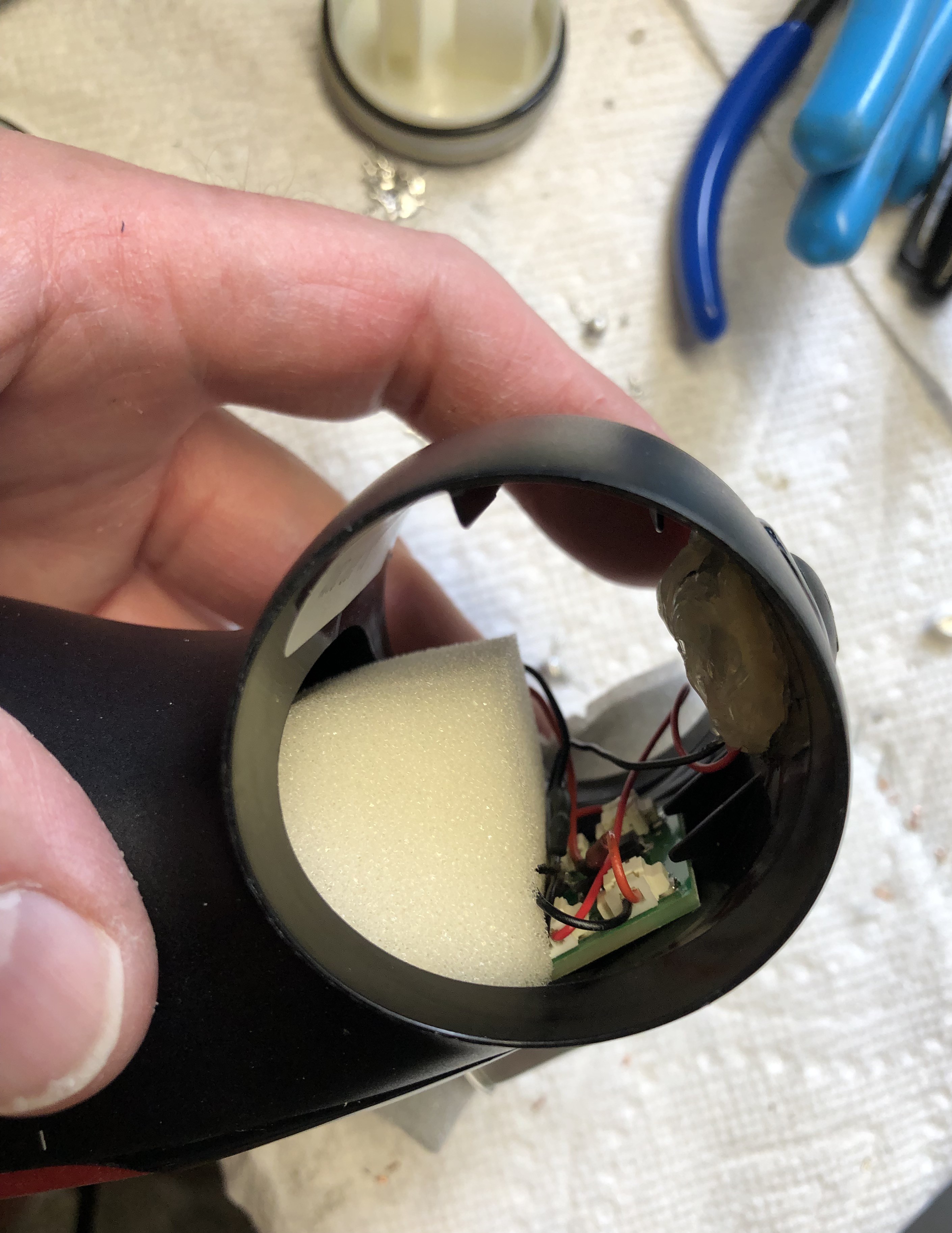

Once one end cap is removed, the other could be pushed out the other side. Neat.
Cobra Libre: end cap removed, showing packing
Cobra Libre: first silver end cap removed
Cobra Libre: end caps removed, battery slid out the bottom

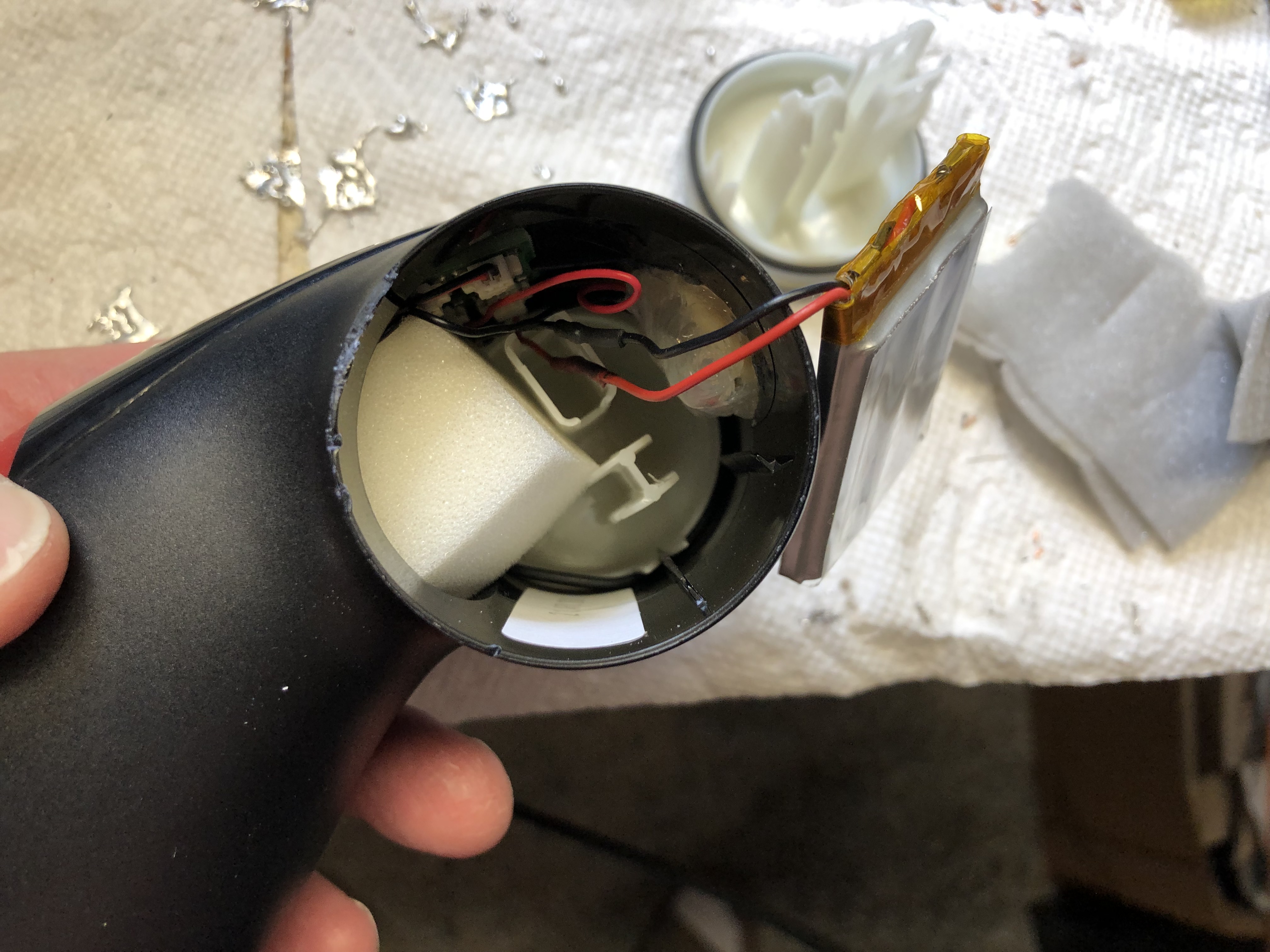

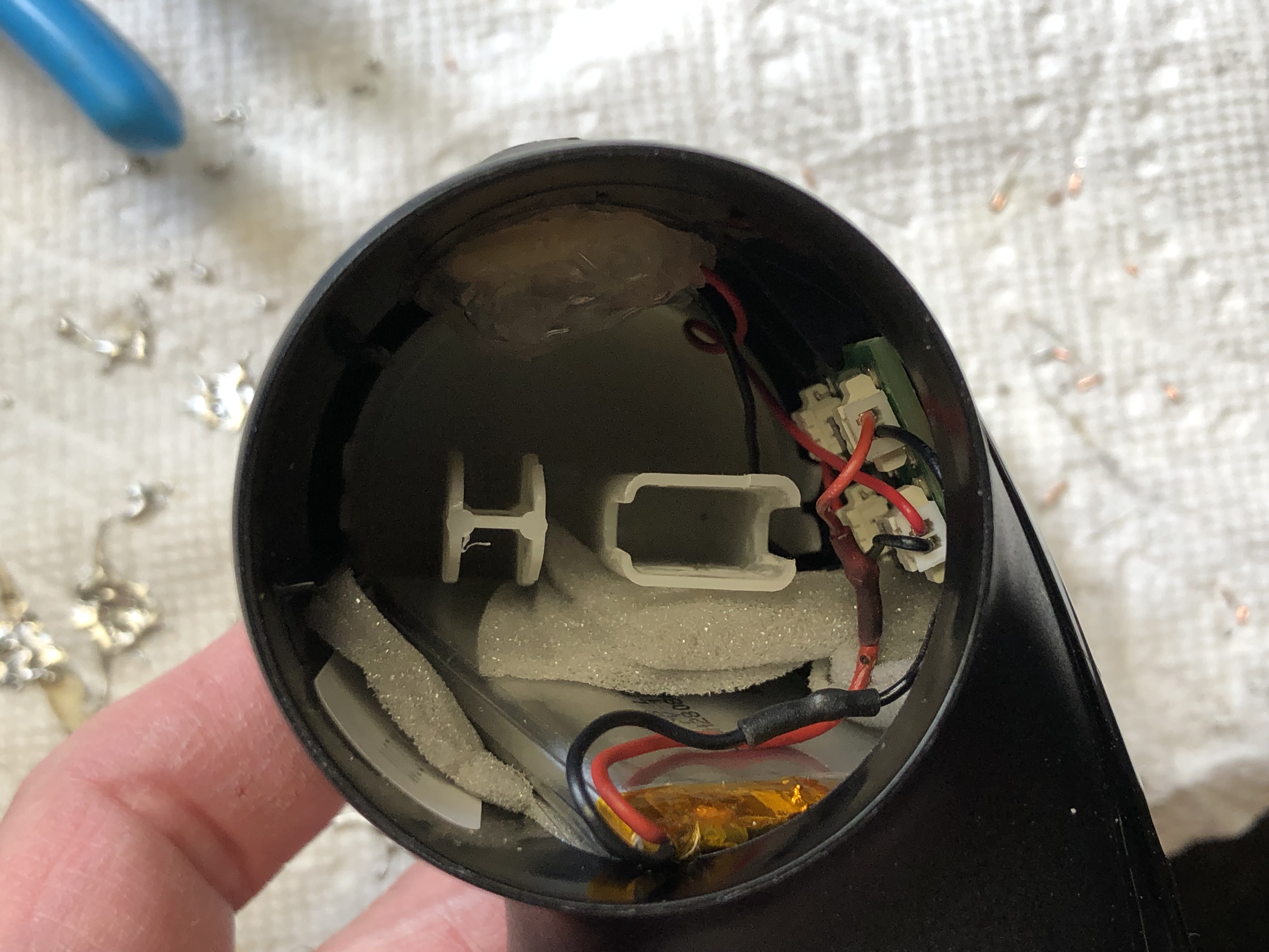

A couple of square sponges fill the cavity and prevent rattling, followed by the prismatic battery, which has thin grey foam glued to it. Its connector can be removed from an interconnect PCB via needle-nose pliers. The empty fourth connector shown below, on the PCB, is where the battery connects. The battery & sponges pull right out. The blob on the right of this pic is the external magnetic-coupled charging connector:
Cobra Libre: showing battery connector on interconnect PCB

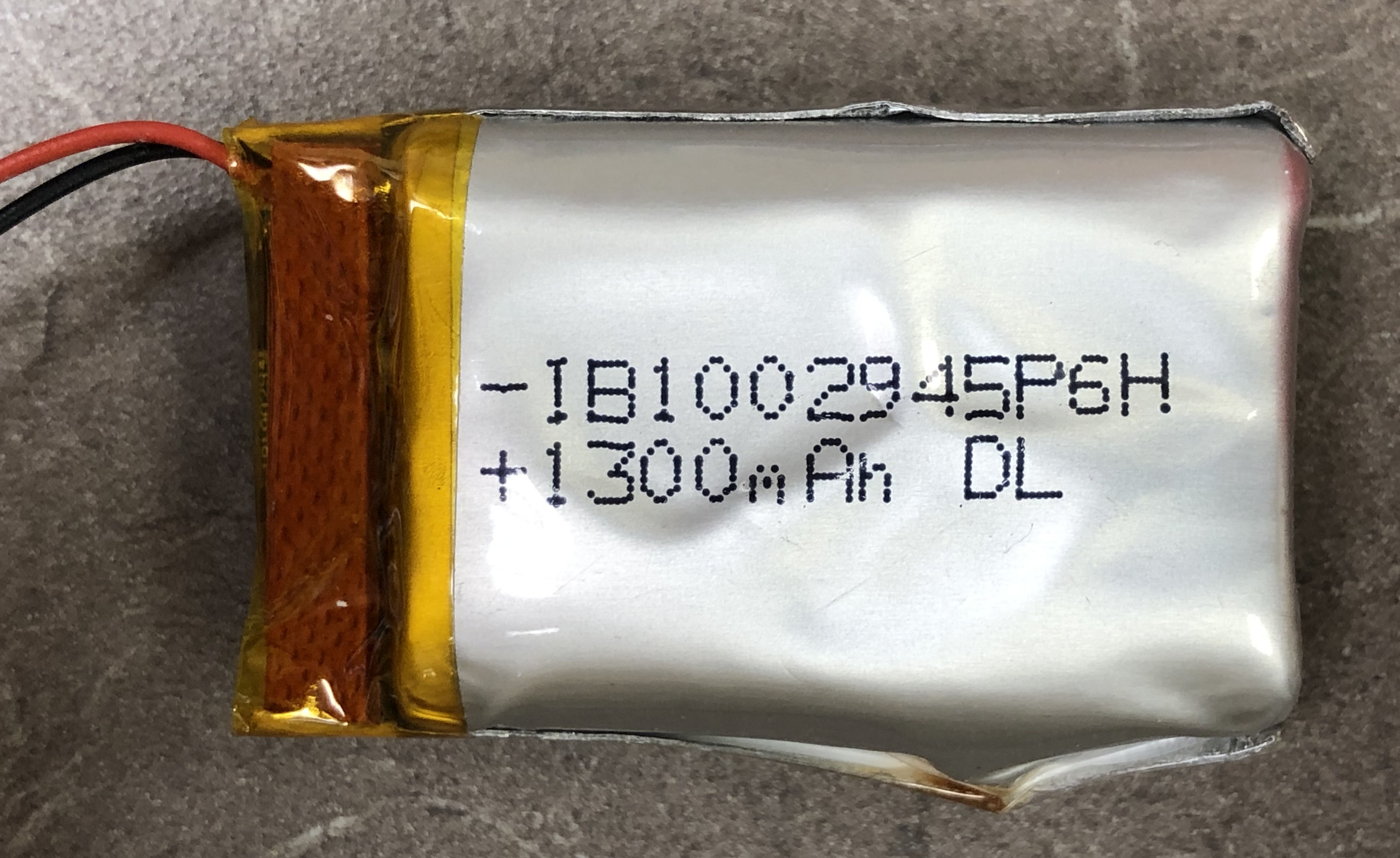

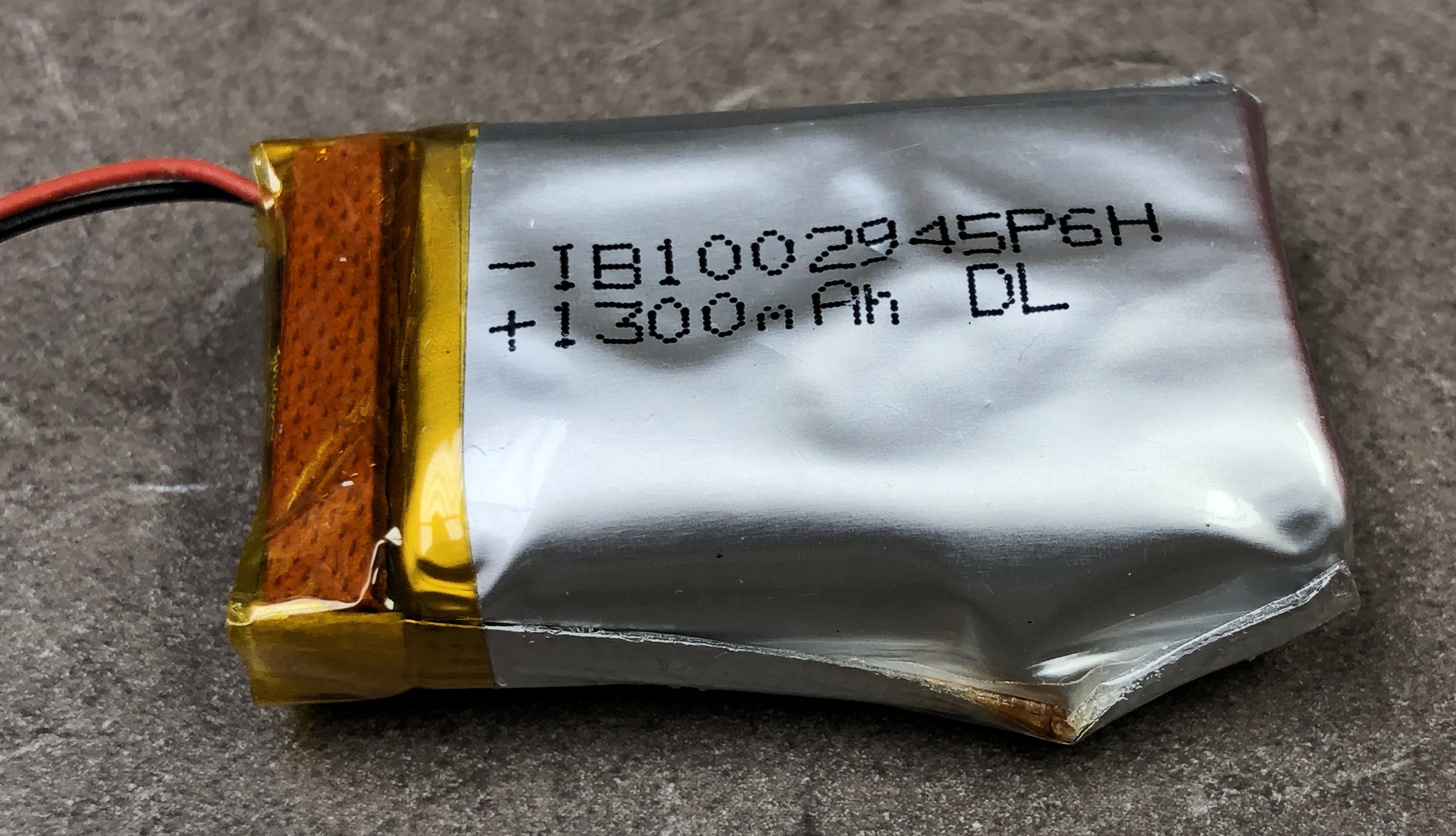

The old battery showed physical damage.
Cobra Libre: original battery, showing damage

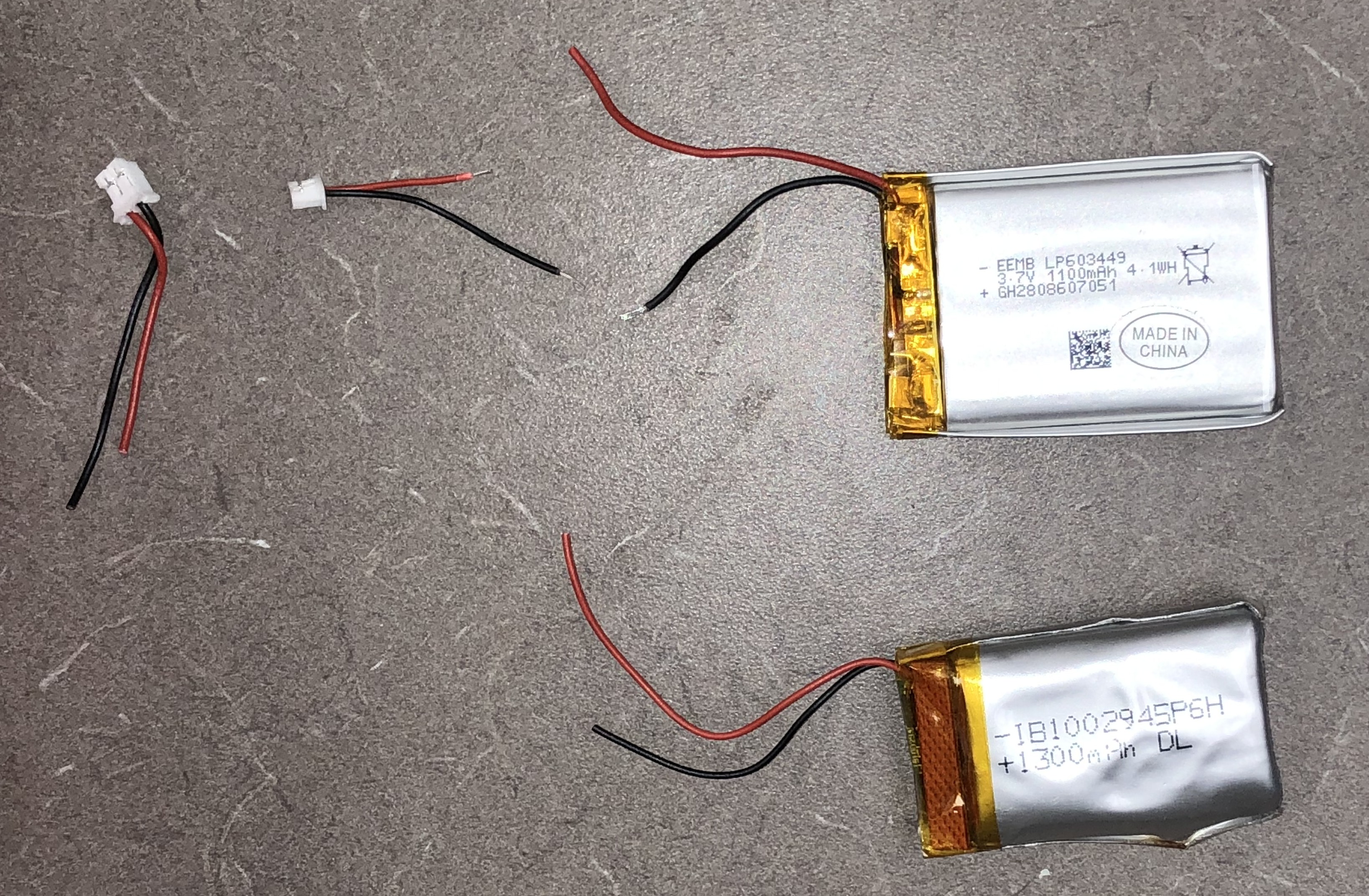

Unfortunately, running the numbers on it through a search engine yields nothing. The charger is rated for 7.5v, so initially I thought I'd be looking for a 7.4v Li-ion battery, but nothing I could find at 7.4v looked to be the correct form factor.

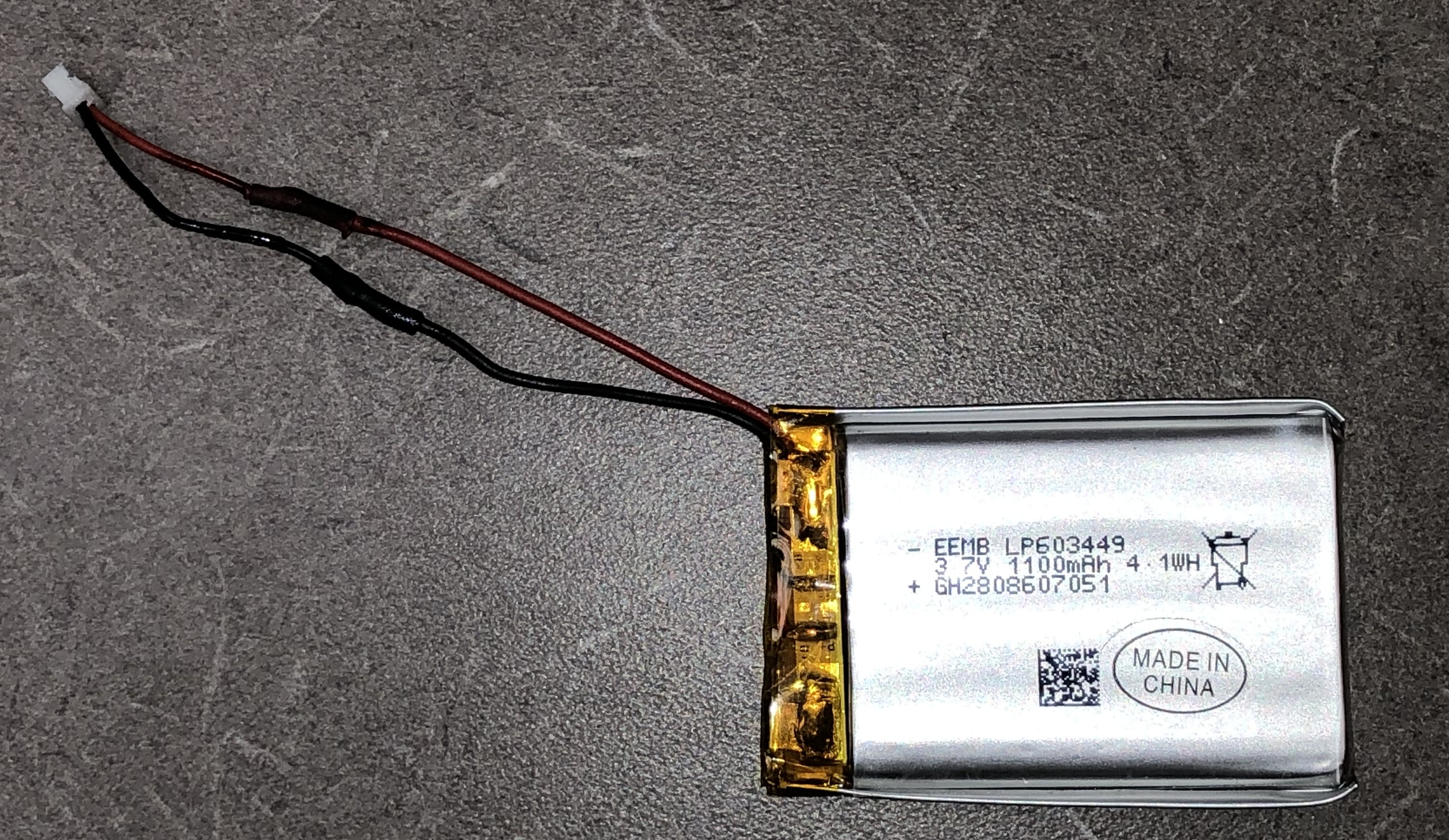

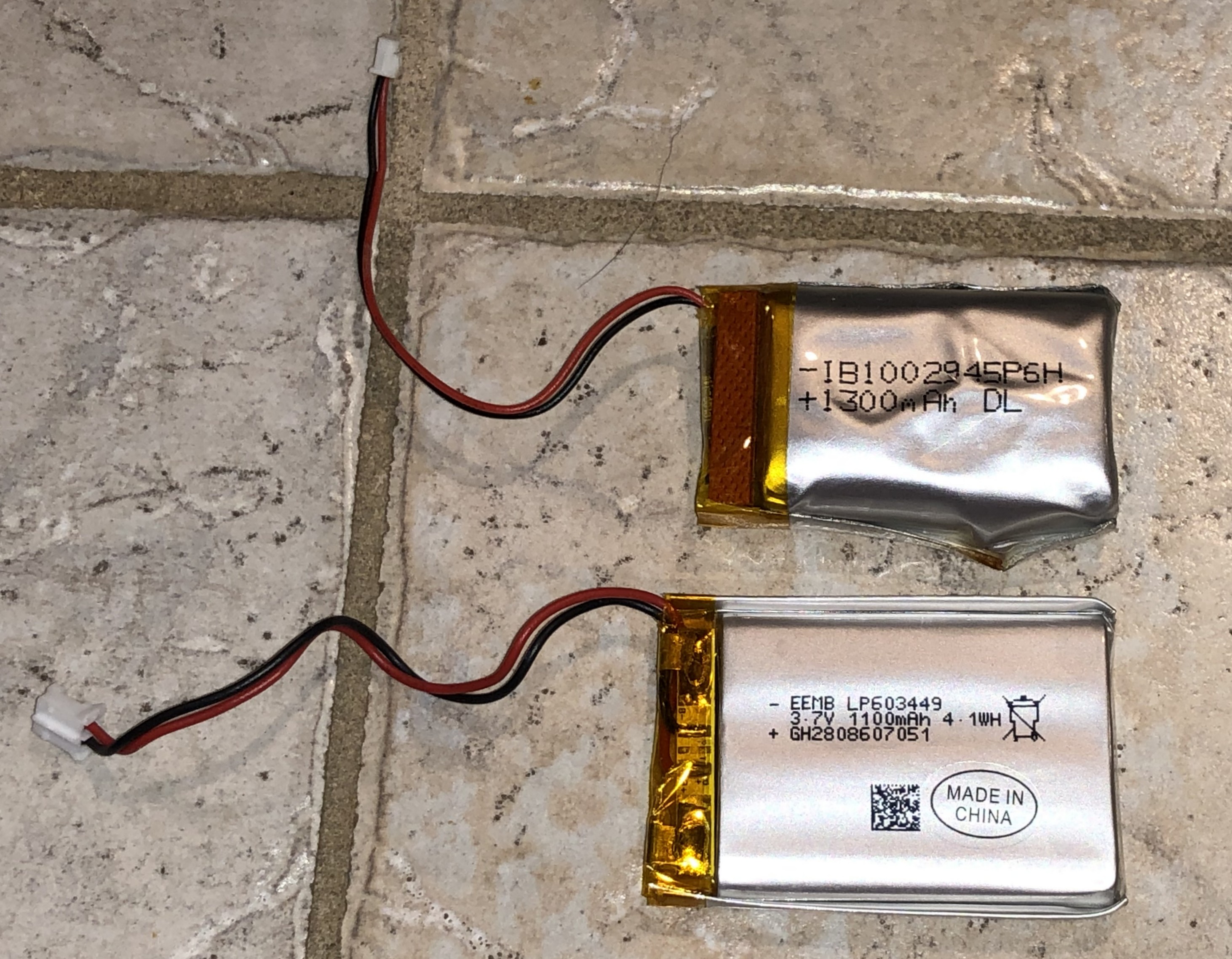

What did look right was a 3.7v battery. I decided to roll the dice and get one. I bought this one via Amazon for $11:
EEMB 3.7V 1100mAh 603449 Lipo Battery Rechargeable Lithium Polymer ion Battery Pack with JST Connector
Remember: a Li-ion battery with onboard BMS is required, which rules out a lot of the RC batteries available.

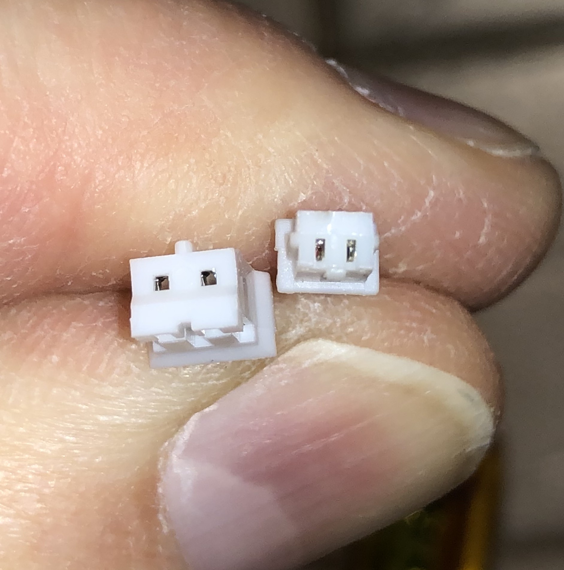

Other than the connector, the EEMB battery was perfect. It has a JST-PH (2.00 mm pitch) connector, which is too large; I cut off the original battery's smaller connector and soldered it to the new battery.
Cobra Libre: old & new batteries compared
Cobra Libre: battery connectors: JST 2mm on left, original on right
Cobra Libre: cutting off connectors, solder original small connector to new battery
Cobra Libre: connector swapped onto new battery

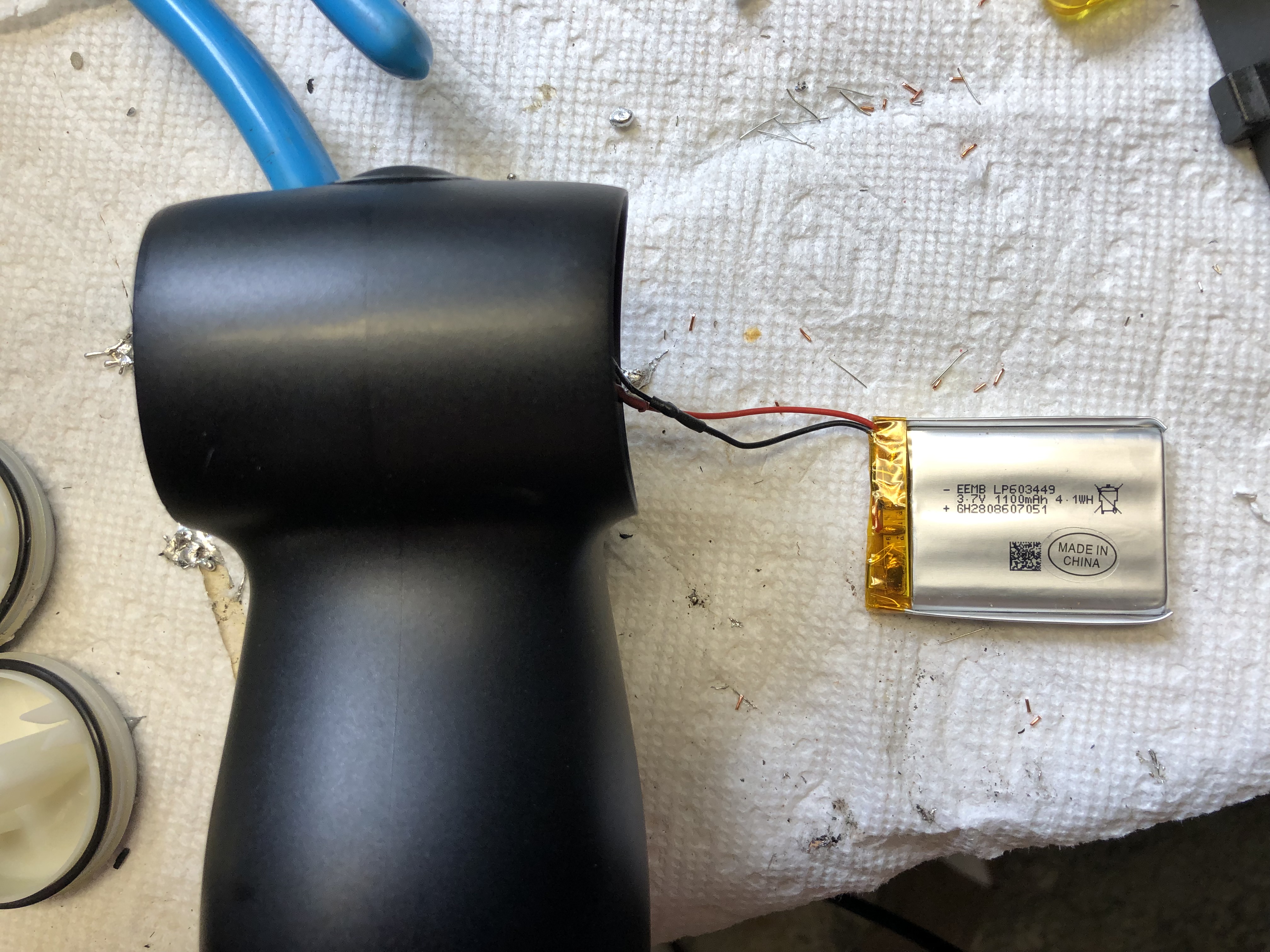

Reassembly is just reconnecting the battery to the PCB, stuffing the battery and foam squares back in, and snapping the end caps together.
Cobra Libre: New battery connected and ready to insert
Cobra Libre: installing new battery
It seems to work and charge fine. I did not measure the smaller connector (I wish I had), but I hope this helps someone else resurrect an old Cobra Libre with a failed battery. These things are just too expensive to throw away.
