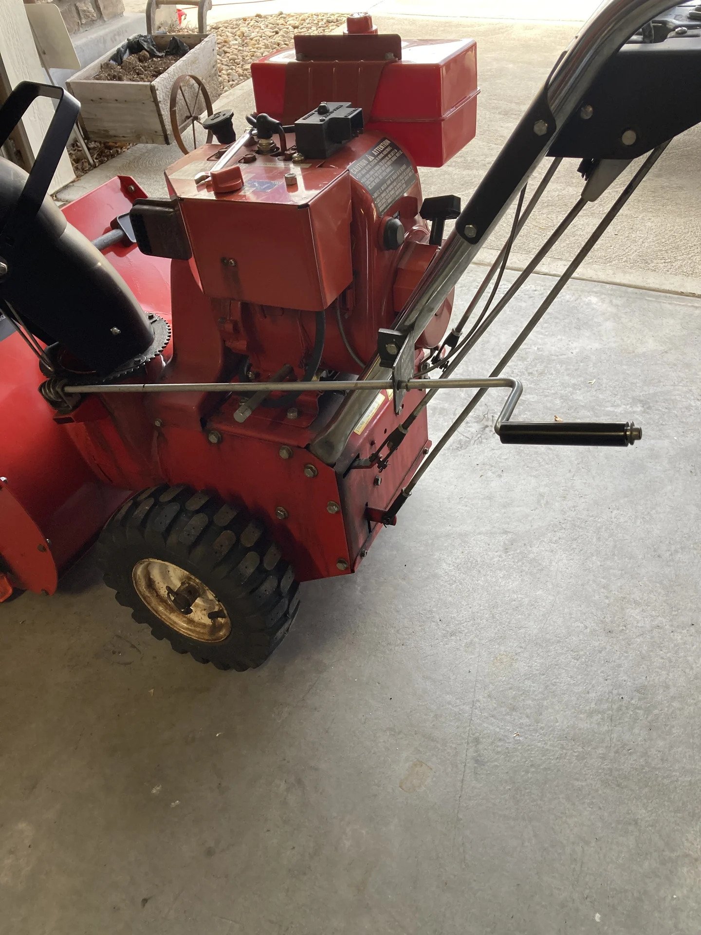

I picked up a snowblower. I don't know why. These things just happen sometimes. This model is from 1985, is two-stage, and features individual wheel jaw clutches, a friction disc ground speed control, and solid auger drums.
This is powered by a 8HP B&S 190402-272041, which has no electric starter nor charging coil, but has a toothed flywheel for an optional electric starter motor. Some models had electric starter upgrade kits available; I have to assume that the 120V (AC) starter kit was popular, so they furnished the toothed flywheel stock.

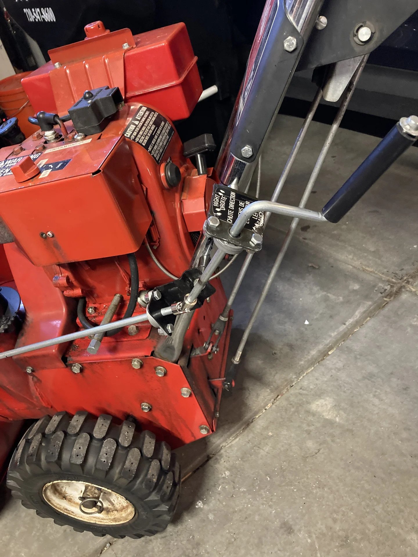

Modern snowblowers have various ways to quickly move the discharge chute left/right/forward etc., but this era used a crude worm gear setup that is hand-cranked to swivel the chute, and the crank is quite low, not very ergonomic, and if you're using a snowblower much you are constantly having to move where the blower moves the snow, so this hand-crank is a primary human-machine interface. People have moved the lever higher via cutting the shaft and inserting a u-joint etc, but you're still hand-cranking it. Here's how one person modified theirs:
[ref: https://www.snowblowerforum.com/threads ... st-1778653]
Toro 826 Chute Swivel hand-crank (original)
Toro 826 Chute Swivel hand-crank (modified via u-joint)

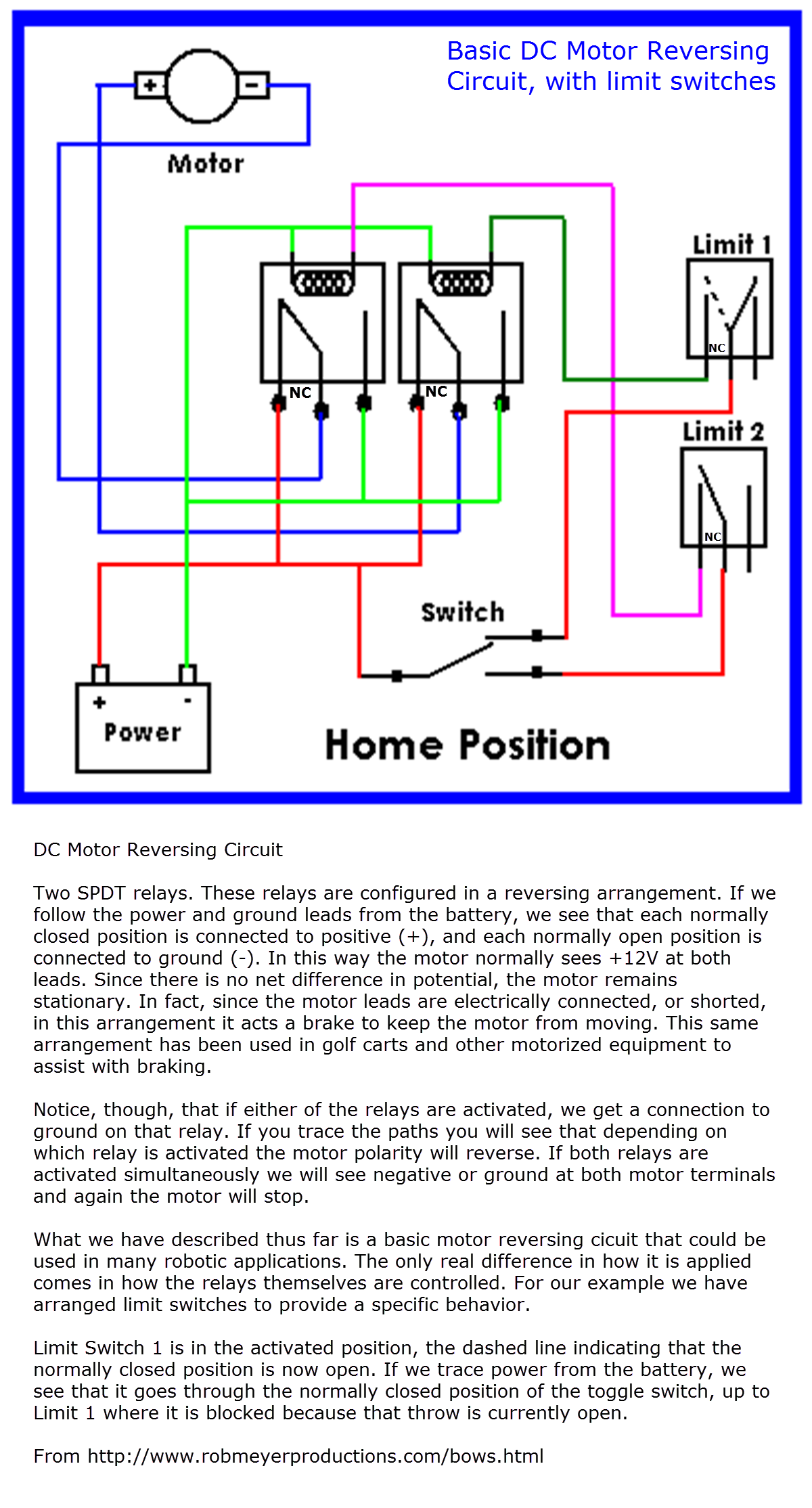

More modern approaches involve installing an electric motor and switchgear. Notes/ideas on doing something like this on mine follow.
The basic circuit:
[ref.: http://www.robmeyerproductions.com/bows.html]
Basic DC Motor Reversing Circuit with Relays and Limit Switches

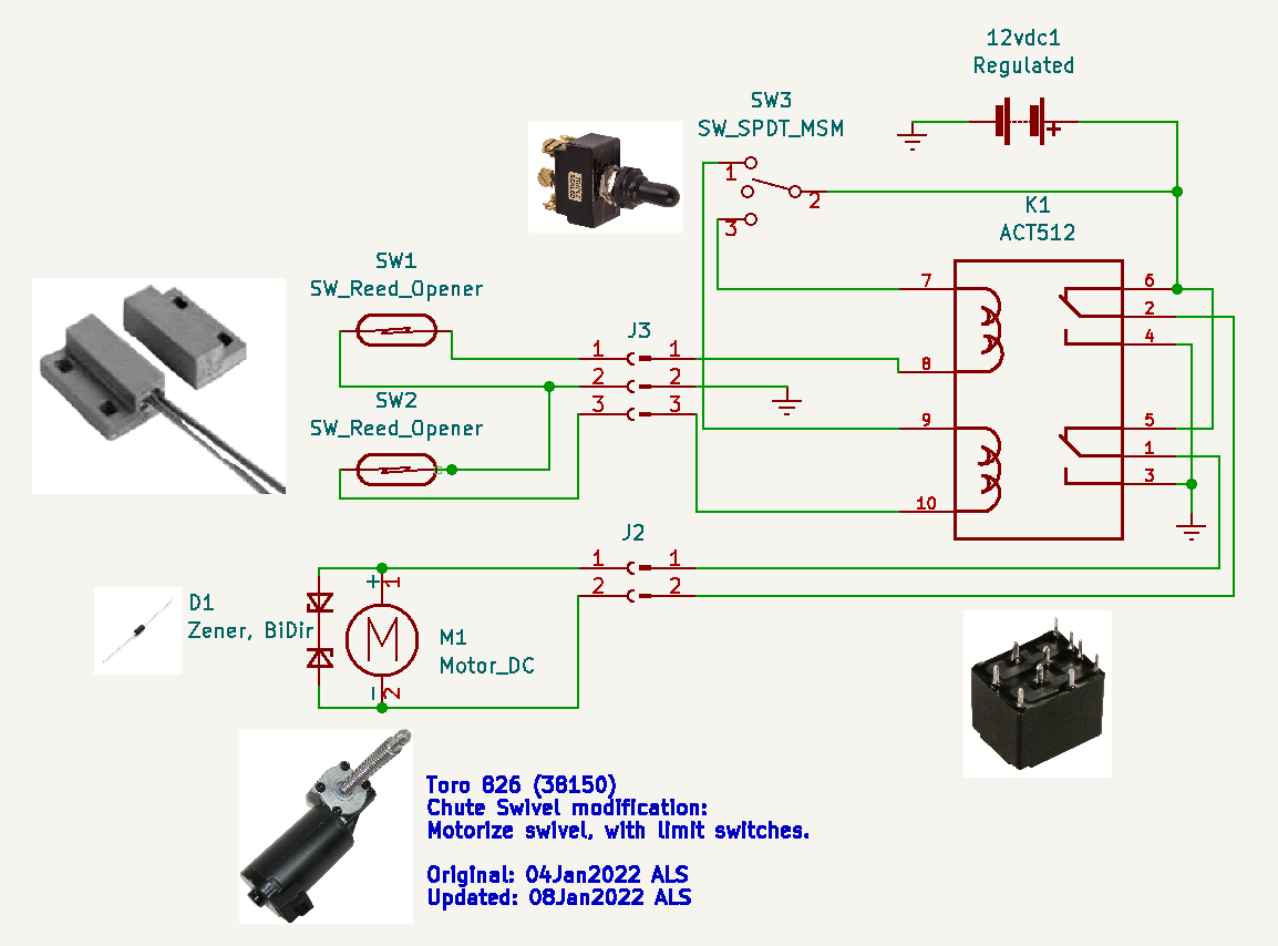

Modified circuit. Below, I've changed the above circuit slightly. The limit switches now ground the relays' coils, which eliminates one wire in the harness to the limit switches. And a Transient Voltage Suppressor is added (D1), because that motor is going to want to arc the relays' contacts without one.
Tweaked DC Motor Reversing Circuit with Relays, Limit Switches, and TVS.

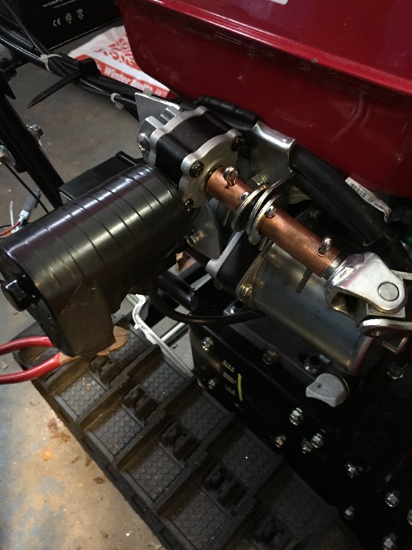

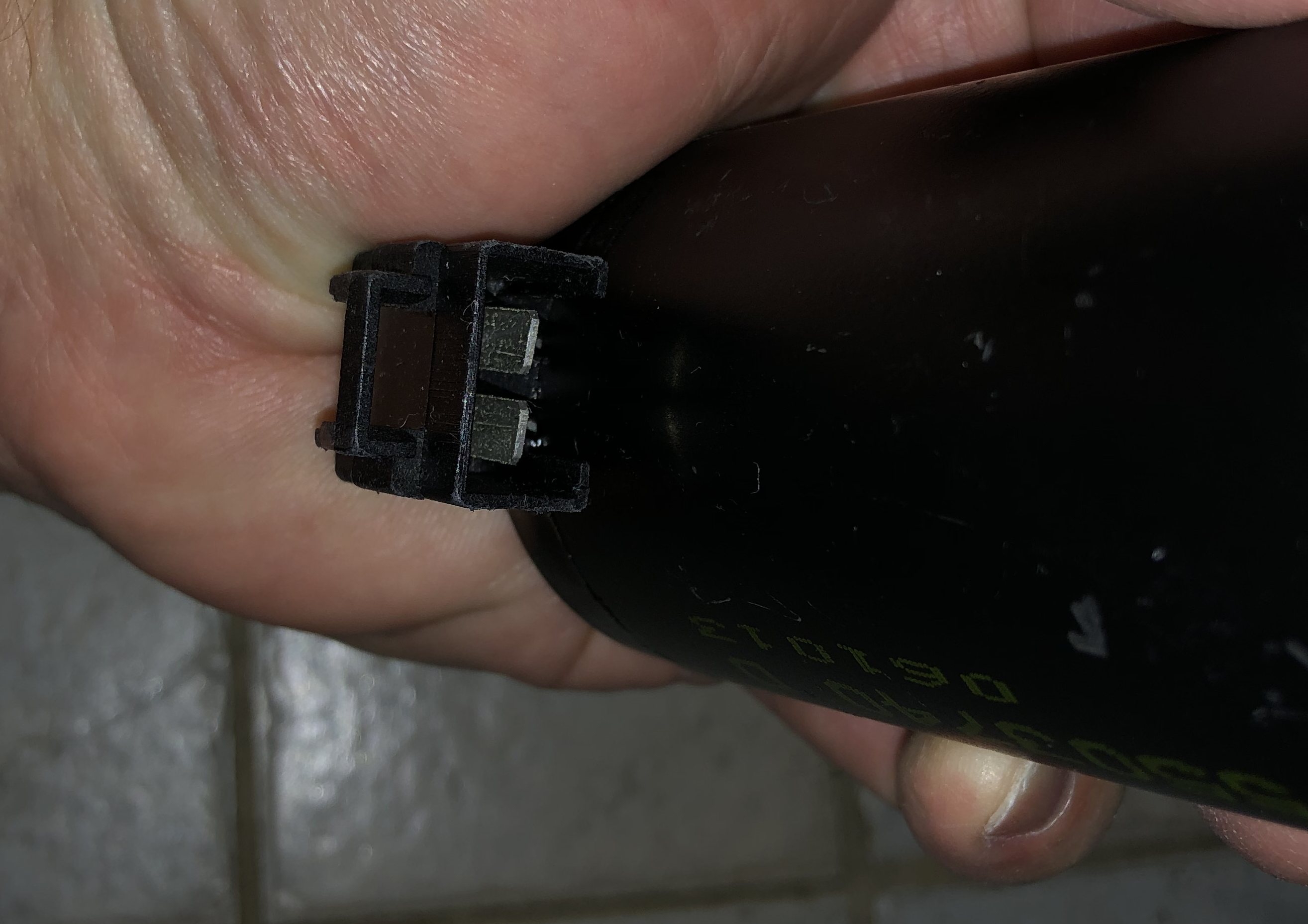

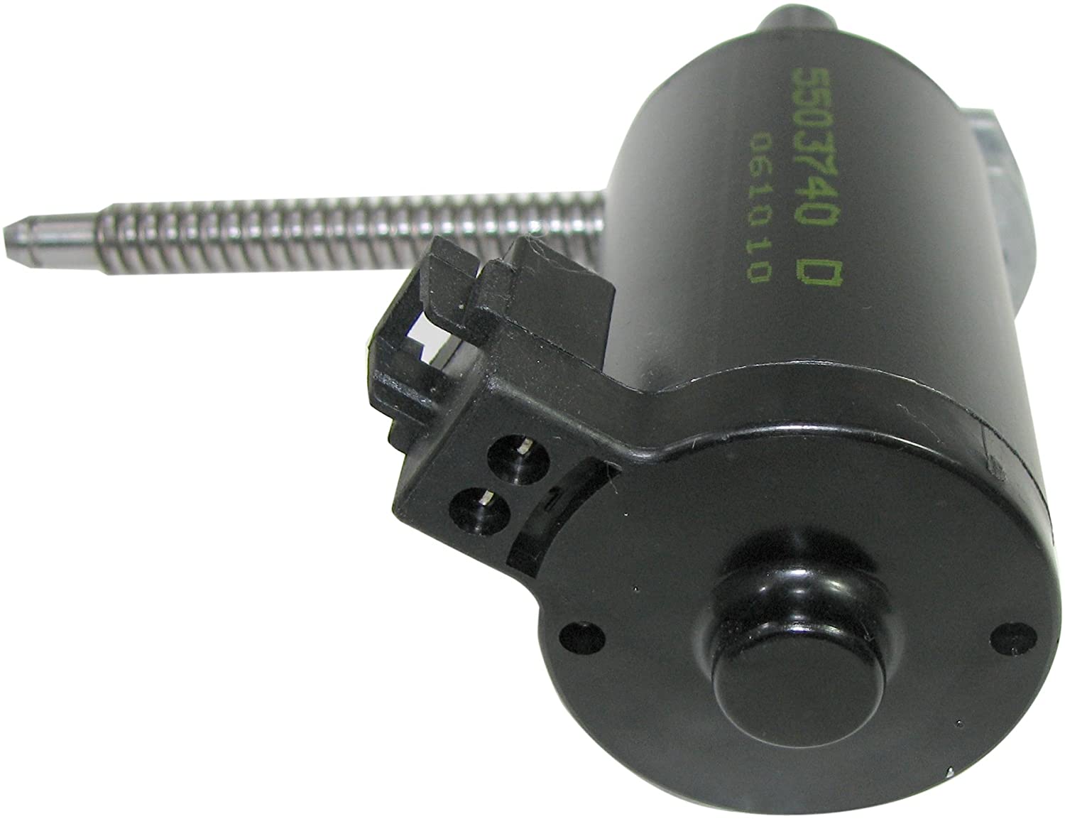

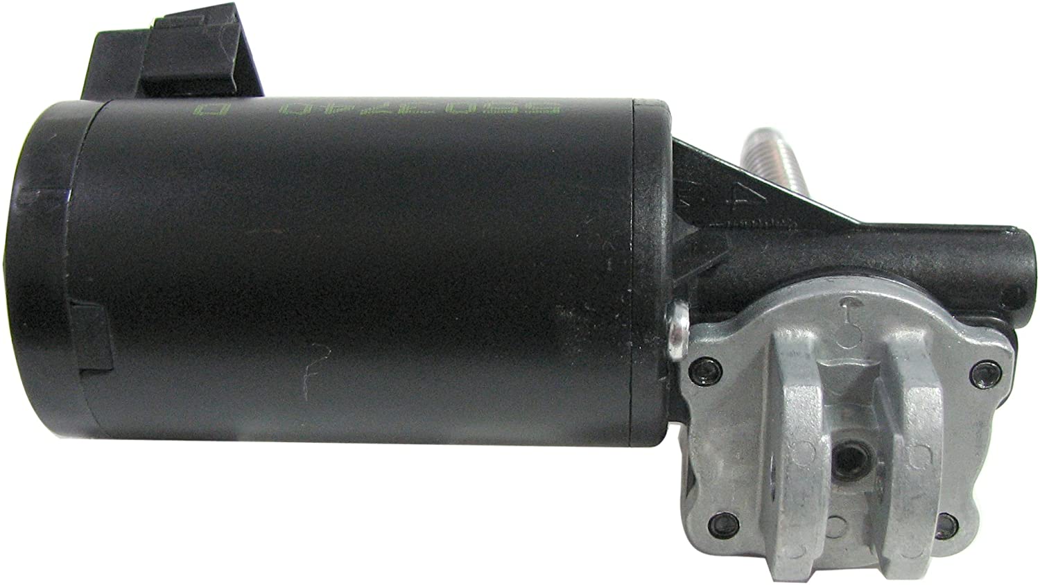

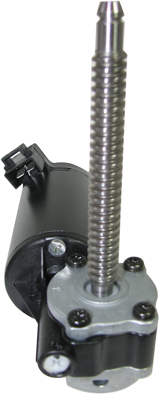

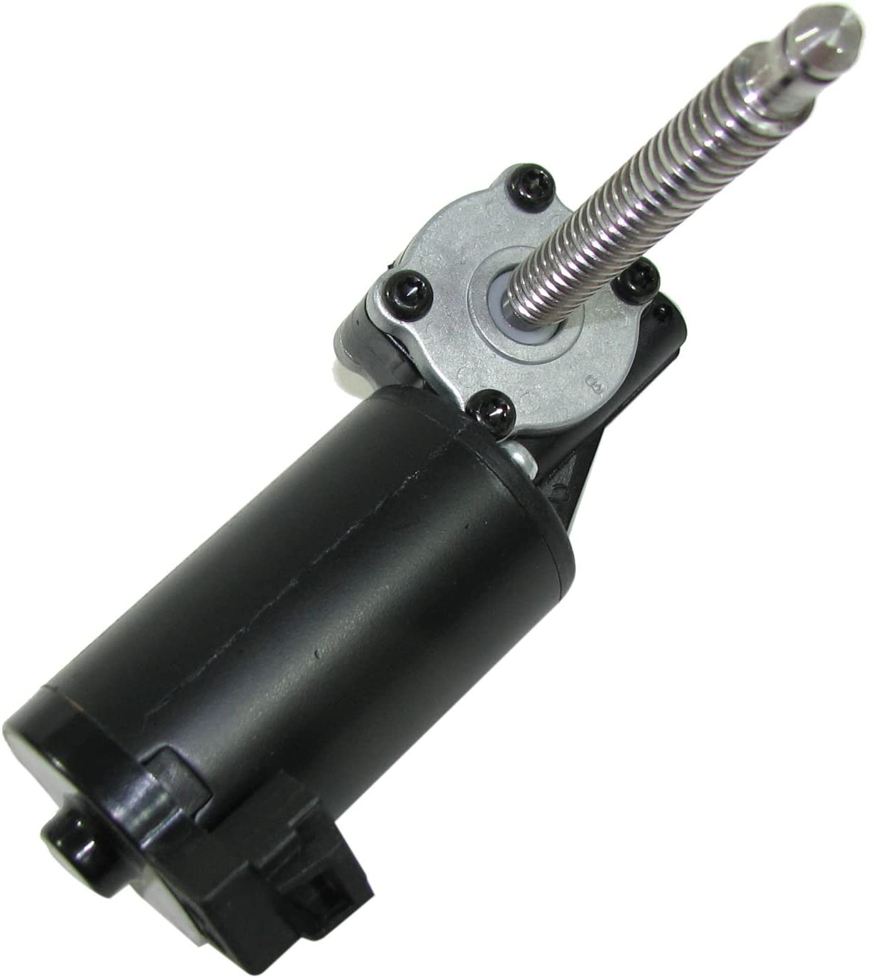

Gearmotor: Car seat motor (surplus, new), Amazon B005IR1NBA, $38, around 190 RPM with ~7/16" shaft that's actually a linear actuator shaft. About 1.5A with minimal load. Others have successfully used this gearmotor for powering their chute swivels on Honda HS928 etc.
[ref. https://www.snowblowerforum.com/threads ... els.80393/]
Gearmotor B005IR1NBA
Gearmotor B005IR1NBA, installed on a Honda HS928
Gearmotor B005IR1NBA, connector view.

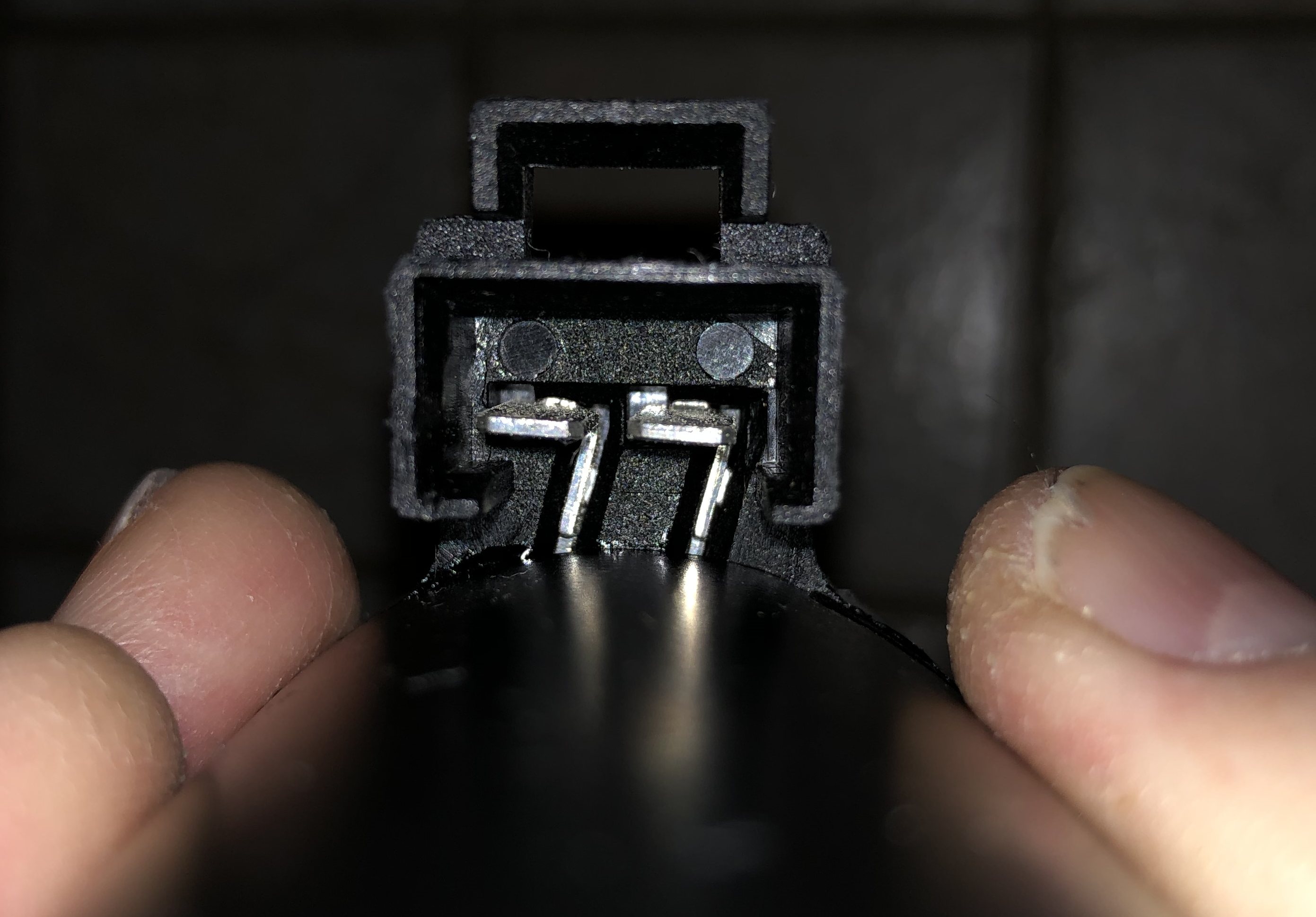

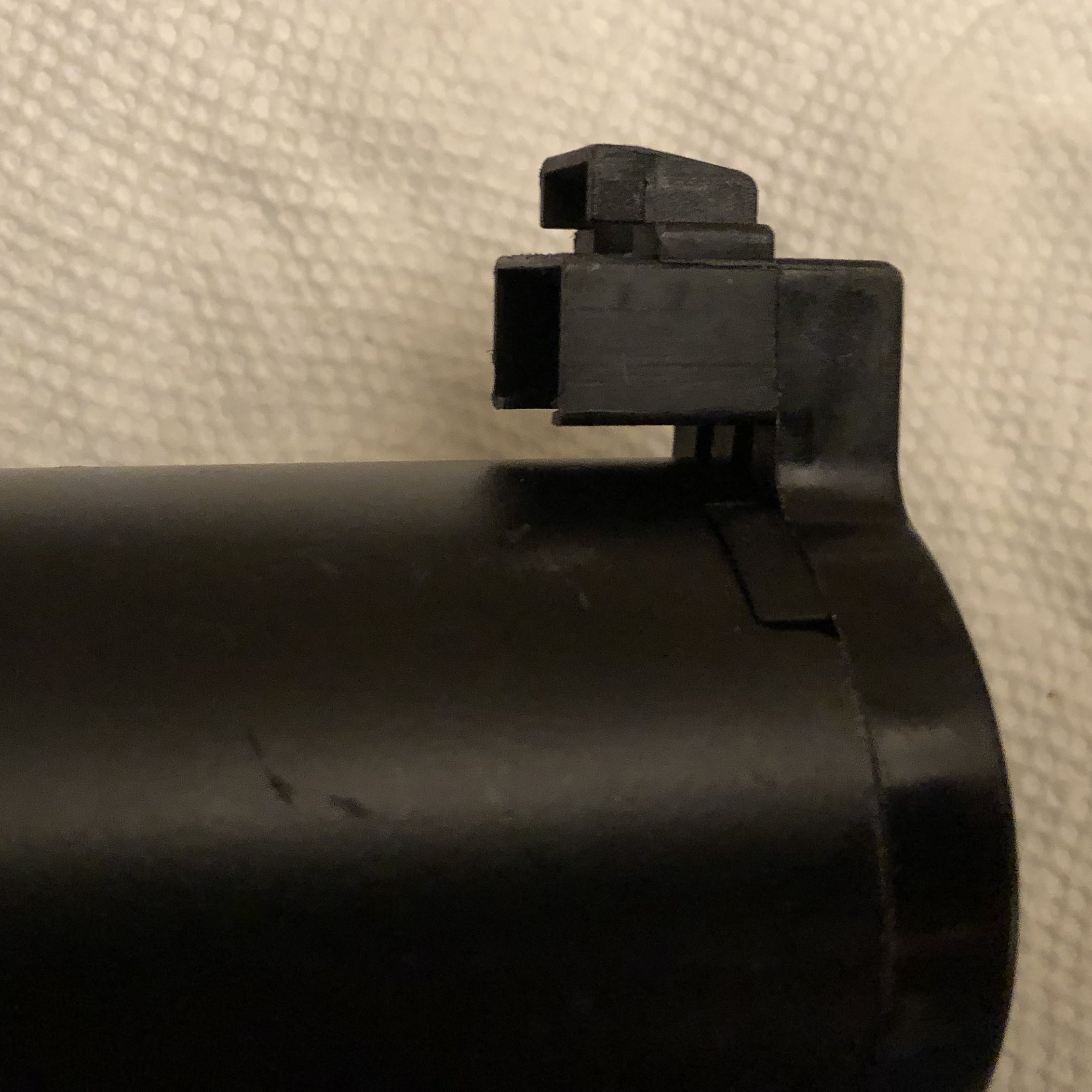

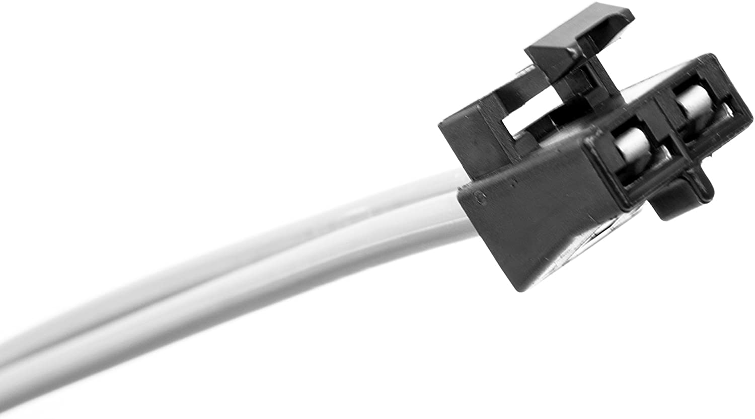

Connector/Pigtail for Gearmotor: AC Delco PT3156 (replaces PT159), $17. The gearmotor has 3/16" wide flat male quick-connector terminals. I assume one could obtain mating 3/16" female spade terminals, but I wanted better mechanical rigidity.
Connector/Pigtail, AC Delco PT3156 (replaces PT159).

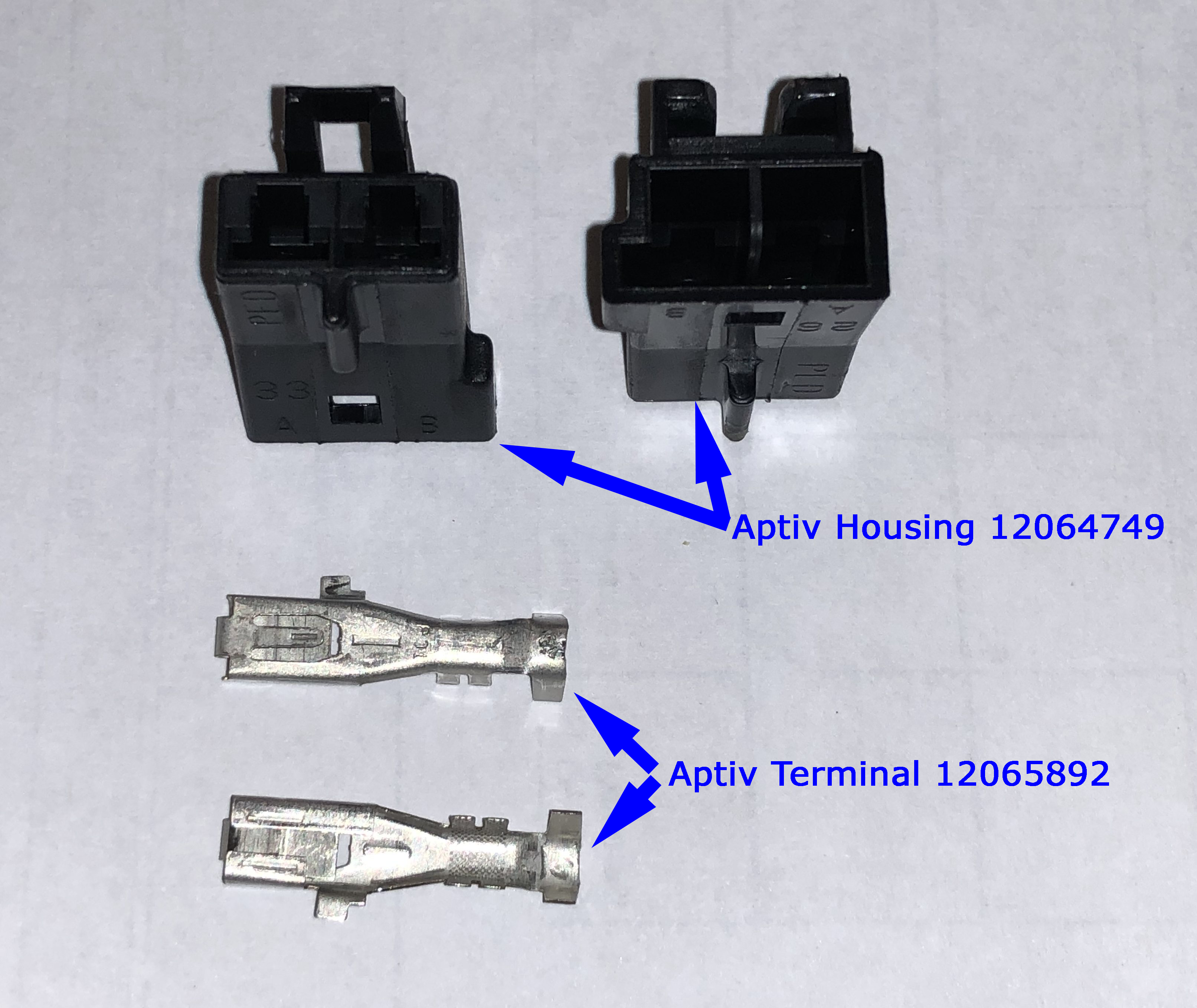

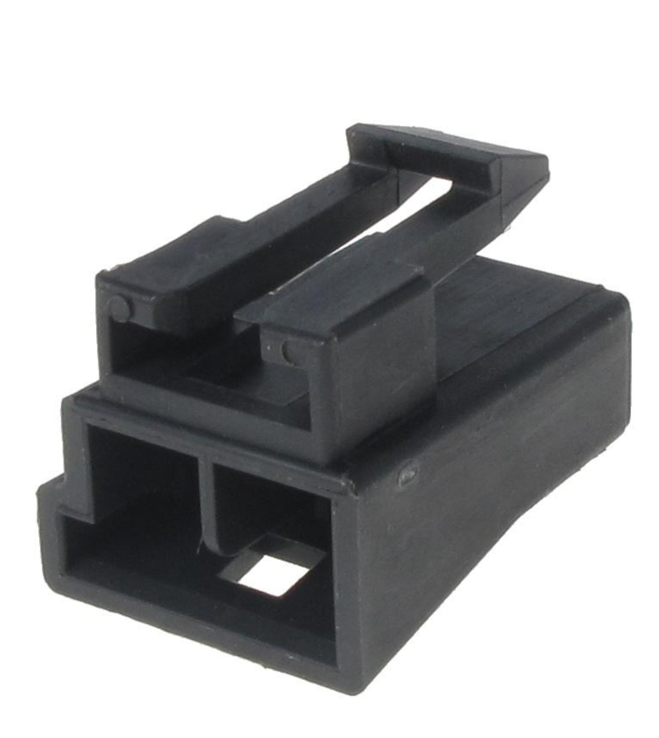

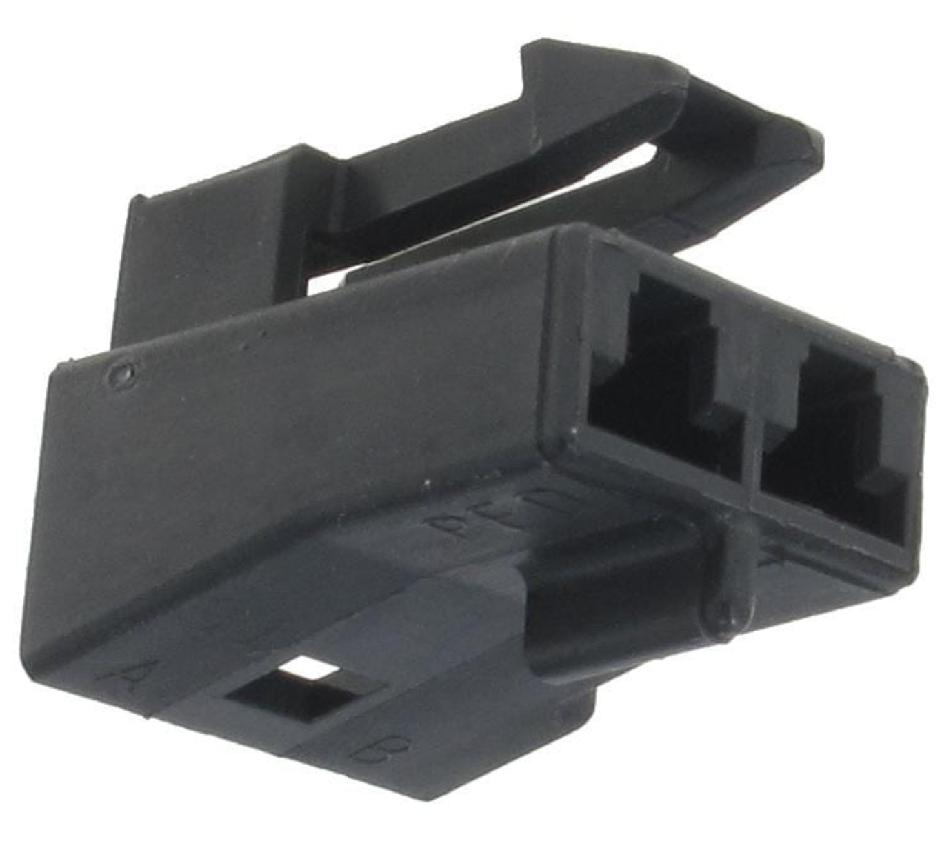

Packard->Delphi->Aptiv 12064749 mating connector is a Metri-Pack 480 Series (unsealed).
Housings:
Amazon (pack of (10)), $12 (shipped)
eBay (lot of (10)), $8 (shipped)
Mouser 829-12064749, $0.72 ea. (plus shipping)

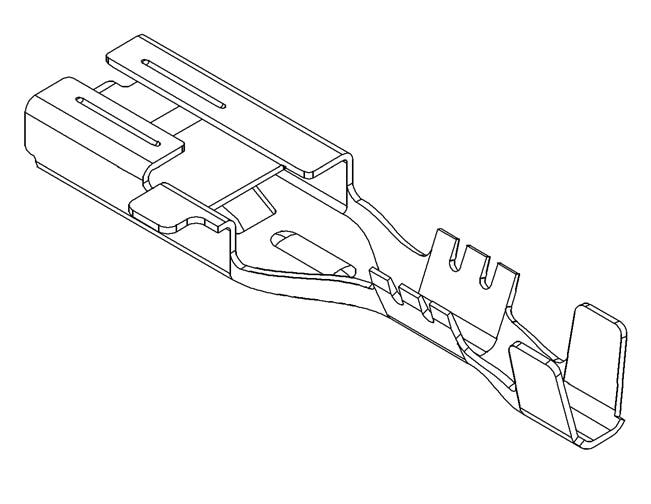

Terminals:
The terminals come in a variety of wire sizes; one of the part Nos. (for 12-14 AWG) is Aptiv 12065892-L, Mouser 829-12065892 , $0.35 ea. ((2) req'd.)
Connector Housing, Aptiv 12064749.  Male housing for female terminals.  Unsealed.
Connector_Aptiv_12064749 _01b.png (558.57 KiB) Viewed 54297 times
Connector_Aptiv_12064749 _02b.png (580.5 KiB) Viewed 54297 times
Connector Terminal, Aptiv 12065892.  Female terminal, 4.8mm (3/16") wide, 12-14 AWG.  Unsealed.
Connector Housing, Aptiv 12064749 & Terminal 12065892 .

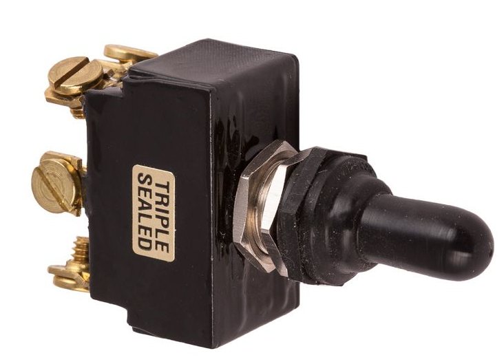

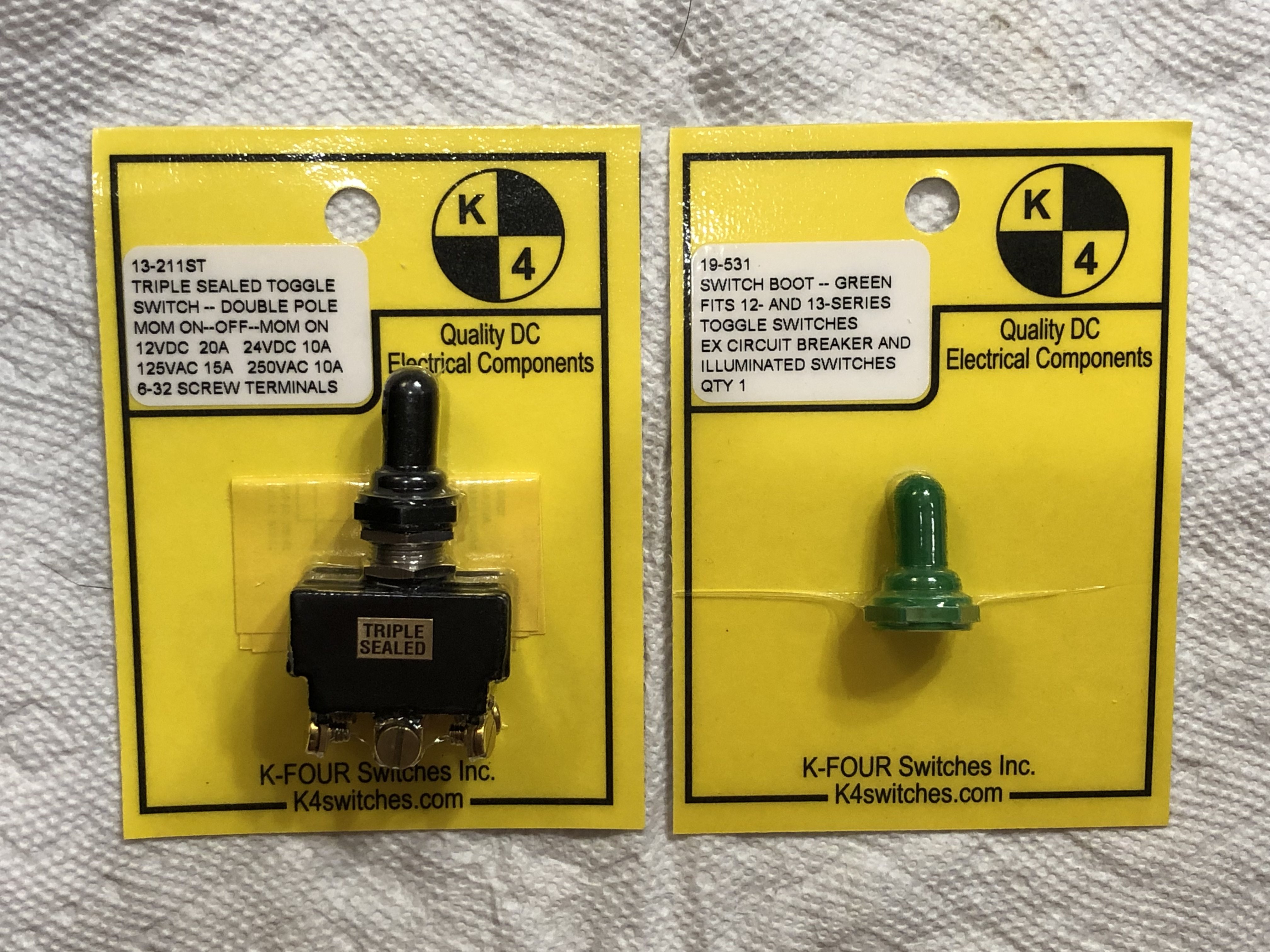

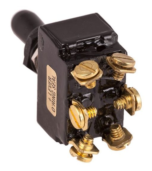

Switch, DPDT Momentary: K4 13-211ST "Triple Sealed" DPDT (ON)-OFF-(ON), 20A, screw terminals. While I don't need DPDT (SPDT would be fine), this is what I could order in a reasonable timeframe at a reasonable price.
Switch, "Triple Sealed" DPDT (ON)-OFF-(ON), 20A, screw terminals.  Front/side view.
Switch, "Triple Sealed" DPDT (ON)-OFF-(ON), 20A, screw terminals.  Terminals view.

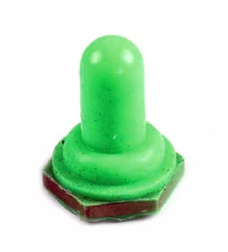

Bling for this switch: K4 Switch_Cover, K4_19-531. Switch lever cover for 04-1300 Series switches, hot green. Their stock photo looks kinda dirty, eh?
Switch lever cover for 04-1300 Series switches, hot green.  K4 19-531
Switch_Cover_K4_19-531_Switch_lever_cover_for_04-1300_Series_switches_hot_green_01b.jpg (11.65 KiB) Viewed 54342 times
Switch, "Triple Sealed" DPDT (ON)-OFF-(ON), 20A, screw terminals, and weather cover.  Packaging view.

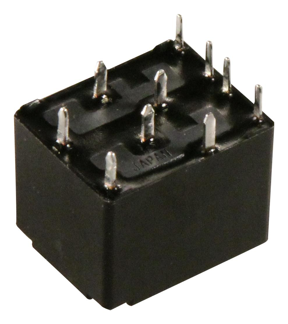

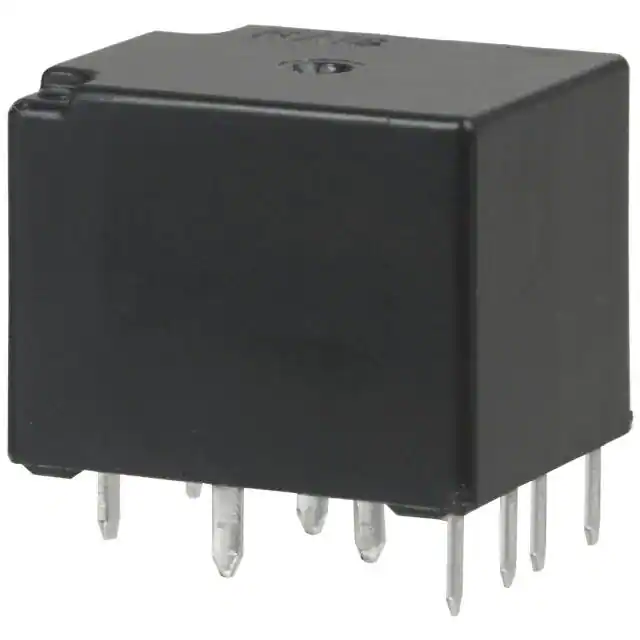

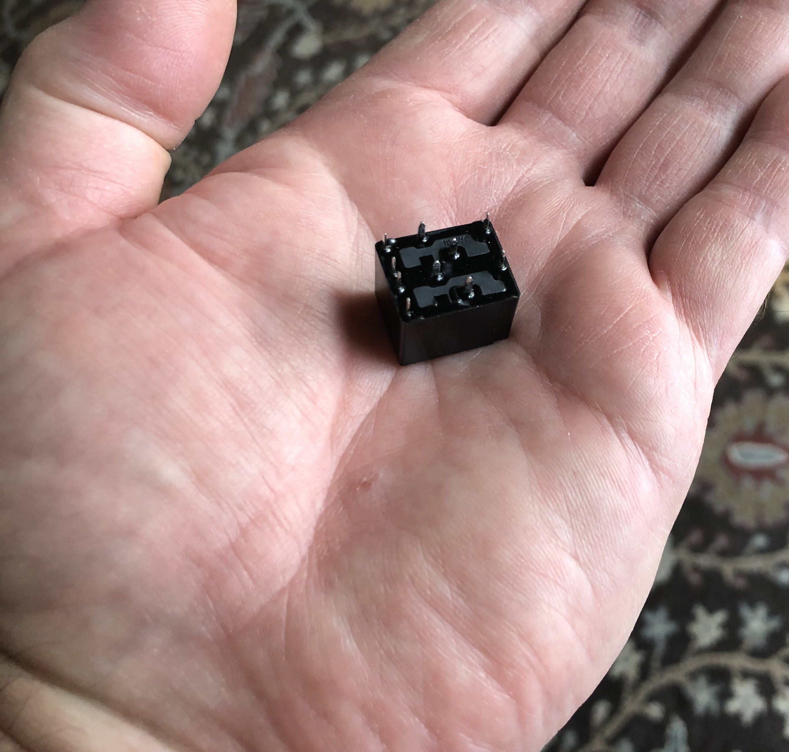

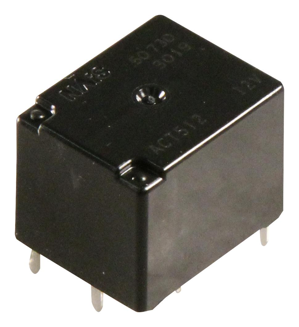

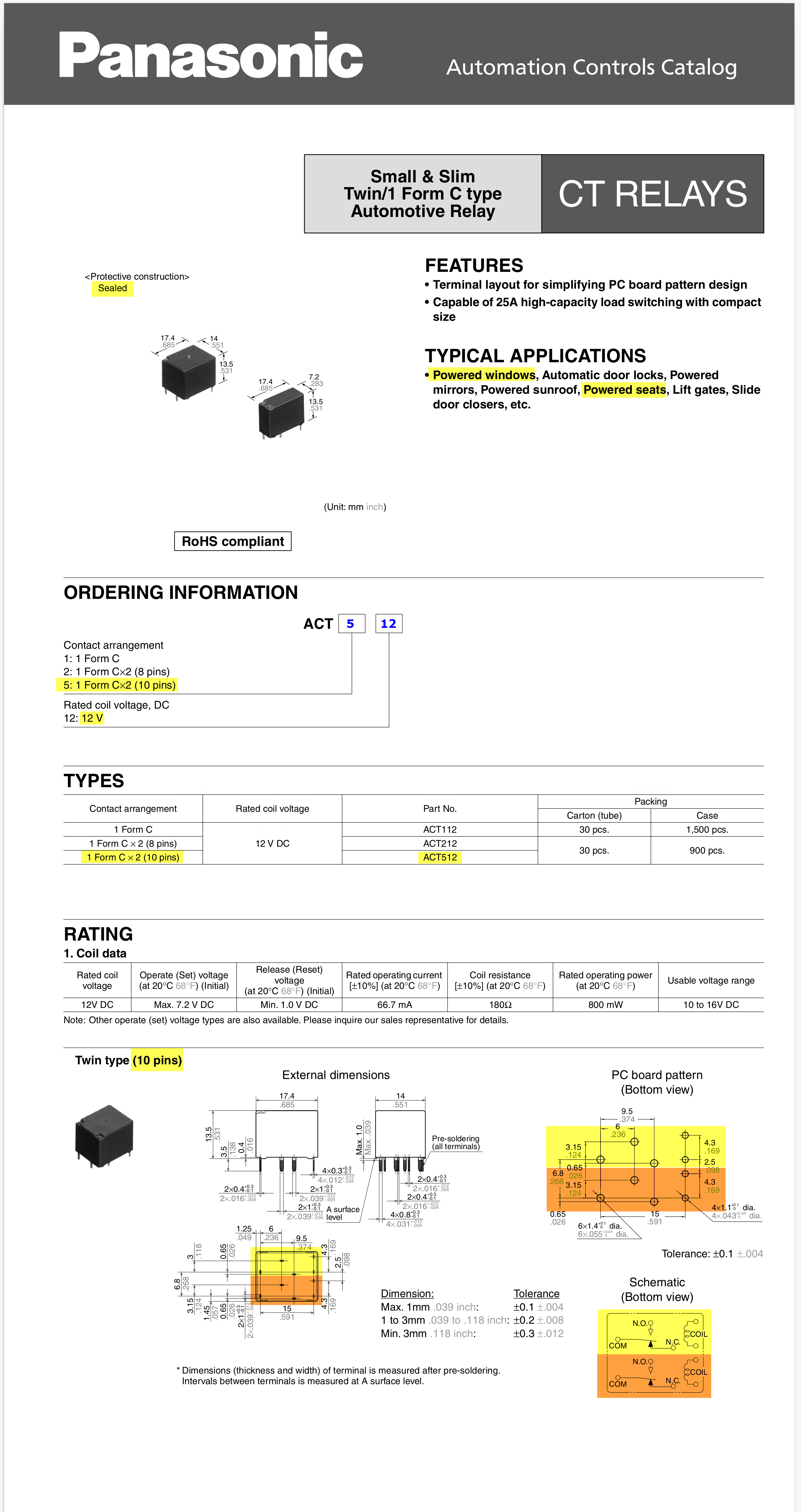

Relays:: Panasonic ACT512. This is an especially nice find, as it's TWO Form C relays in a single package. Two identical, discrete relays in a single module. Solder lugs, though. Datasheet
Panasonic ACT512 Relay pkg., Form C x2, top view 2
Panasonic ACT512 Relay pkg., Form C x2, top view 1
Panasonic ACT512 Relay pkg., Form C x2, bottom view
Panasonic ACT512 Relay pkg., Form C x2, datasheet markup
These ACT512 relays are tiny.
Panasonic ACT512 Relay pkg., Form C x2, "hand" view

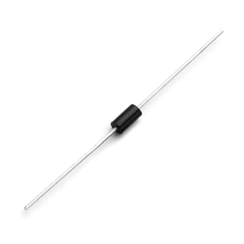

Transient Voltage Suppressor: LiittleFuse P6KE16CA TVS DIODE, 600W, 16V, DO-15 (10 pieces). This is a bidirectional zener diode (pair of zeners) in a single package. It damps the inductive voltage spike of the motor when the relays open, which in turn should extend the relays' contact life significantly. Good circuit design practice for mechanically switched DC inductive loads.
[ref. https://electronics.stackexchange.com/questions/318013/snubber-diodes-for-a-dc-motor-with-2-relays/318078#318078 , Fig. 3]
Transient Voltage Suppressor, LiittleFuse P6KE16CA TVS DIODE, 600W, 16V, DO-15
Transient_Voltage_Suppressor_LiittleFuse_P6KE16CA_TVS_DIODE_600W_16V_ DO-15_01b.png (13.73 KiB) Viewed 54336 times

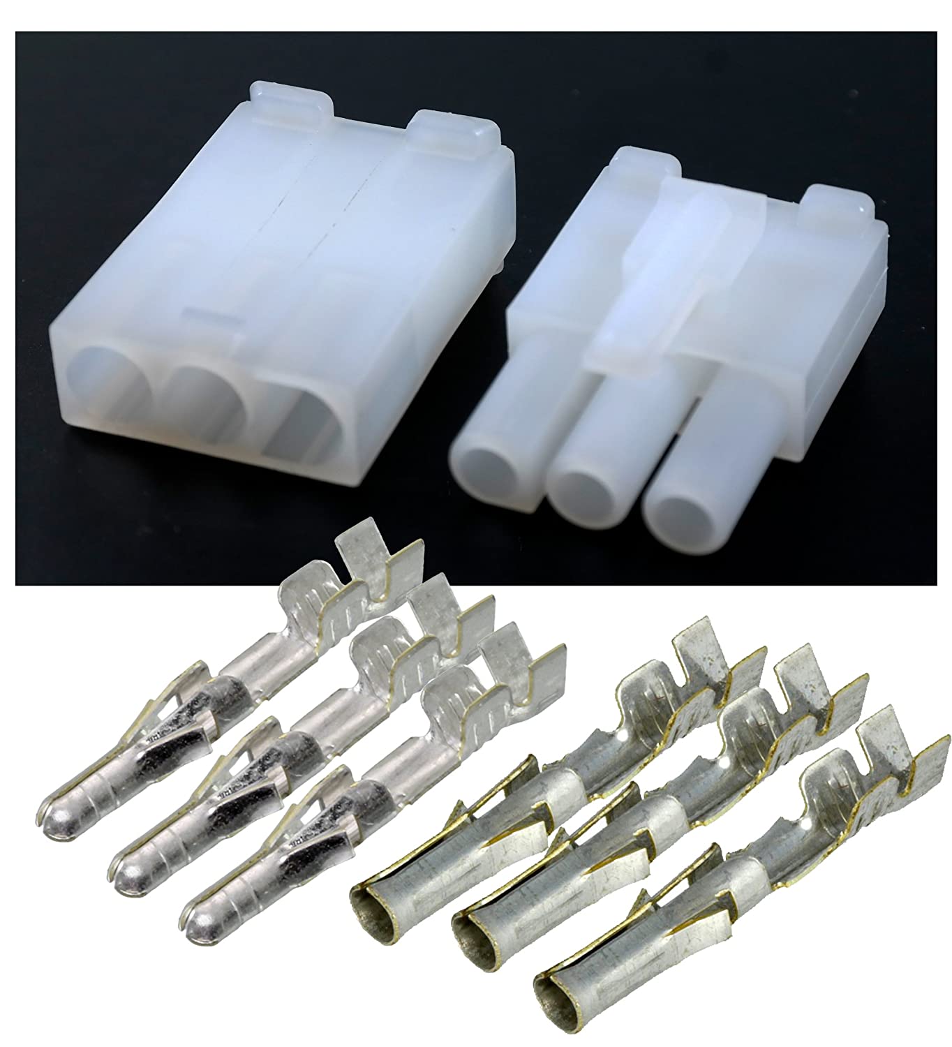

Connectors.

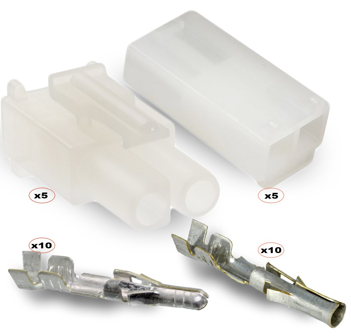

Molex Connector Lot (5), (2-circuit), 14-20 AWG, .093” w/lock
Molex Connector Lot (5), (2-circuit), 14-20 AWG, .093" w/lock
Molex Connector Lot (5), (2-circuit), 14-20 AWG, .093 with lock.jpg (86.45 KiB) Viewed 54367 times
Molex Connector Lot (3), (3-circuit), 14-20 AWG, .093" w/lock
Molex Connector Lot (3), (3-circuit), 14-20 AWG, .093 with lock.jpg (119.82 KiB) Viewed 54367 times
