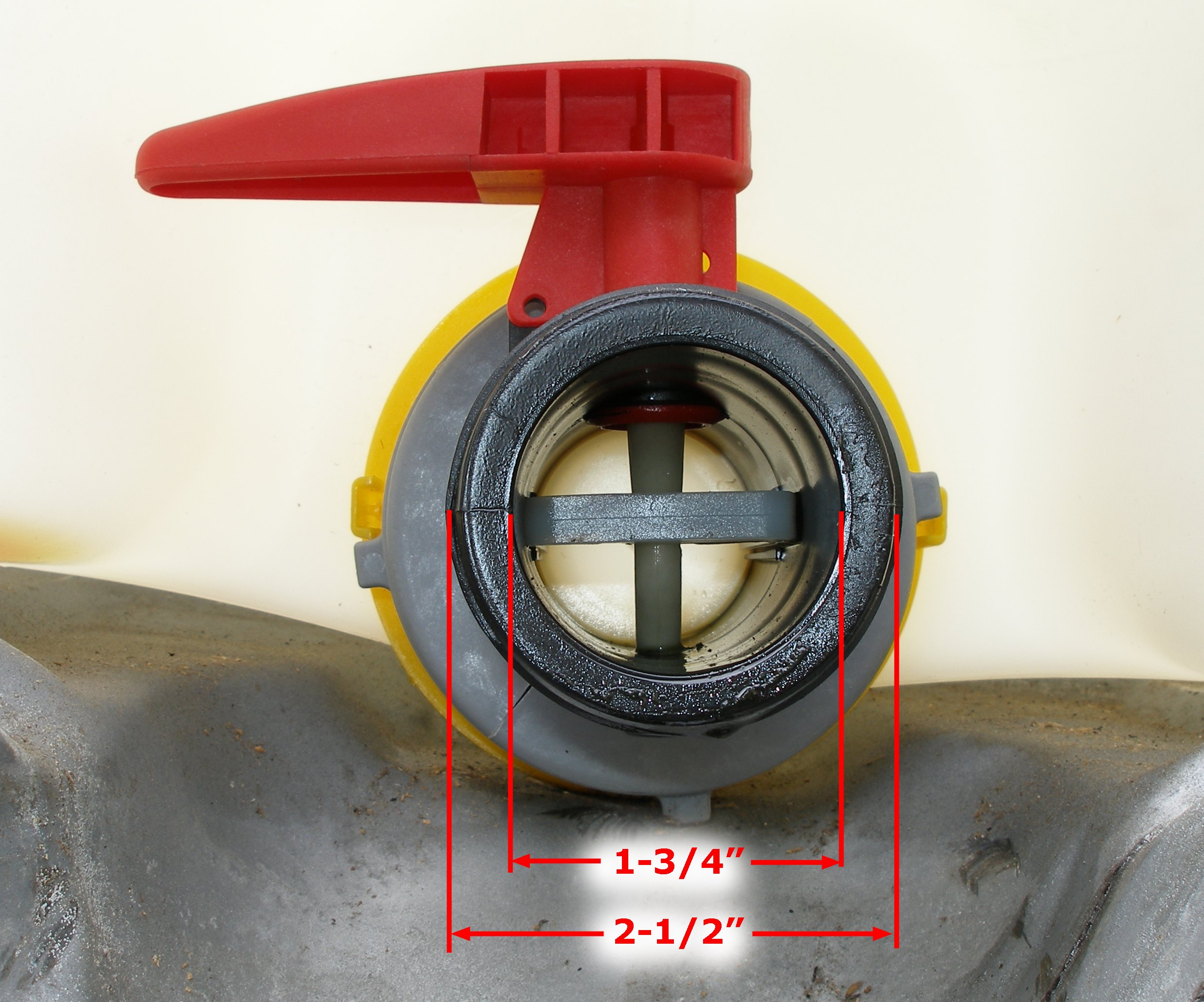

Plumbing is always a challenge for me, so many specialized ways of connecting the dots/lines/etc. I acquired (for $~60, Thanks, MarkH!) a clean, used IBC ("tote"), 275G I believe. It has a valve attached -- not a ball valve; despite what the pictures below may have you think, it's a cam-operated poppet valve.
I want to utilize what appears to be a quick-disconnect feature of the outflow portion of this valve, which also seems to be threaded.
Trouble is, I can't figure out what size it is, to order matching fittings. I am looking at quick-disconnect adapters like these (C, or D style) at JM Ellsworth
As you can see in their chart, listed sizes include 3/4", 1", 1-1/2", 2", 3". But what size do I need?
It seems, by measurement, that this is neither fish nor fowl?

Referencing the McMaster Carr catalog pages 282 through 289 for cam and groove couplings, I believe it to be 2 1/2". McMaster offers this size in metal but not plastic. Apparently, your vendor doesn't offer 2 1/2" in plastic either.
Later.
On second look, they do offer the plastic in 2 1/2". If the other side of the fitting is NPT, then it will be 2". This may be the system your vendor is using. Referring to the fittings by the applicable pipe size.
With your help, I agree this might be a 2" coupling. Looking at McMaster-Carr, page 288, 5237T26 is 2" and has a plug OD of 2-1/2", polypropylene and locking levers, $10.

I had to order a coupling for the tote, so I ordered two, as Mark H. has a tote also.
2" quick-disconnect to 2" NPTF:
http://www.jmesales.com/item/32356/2-Po ... lings.aspx
They come with EDPM gaskets, for which I do not know BD compatibility, so I ordered viton gaskets:
http://www.jmesales.com/item/23340/Dixon-2-Gaskets.aspx
Total for two couplings + two gasketsl, after $14 shipping, was $44. This was cheaper than McMaster-Carr, because M-Carr wants a lot more for their Viton gaskets.
