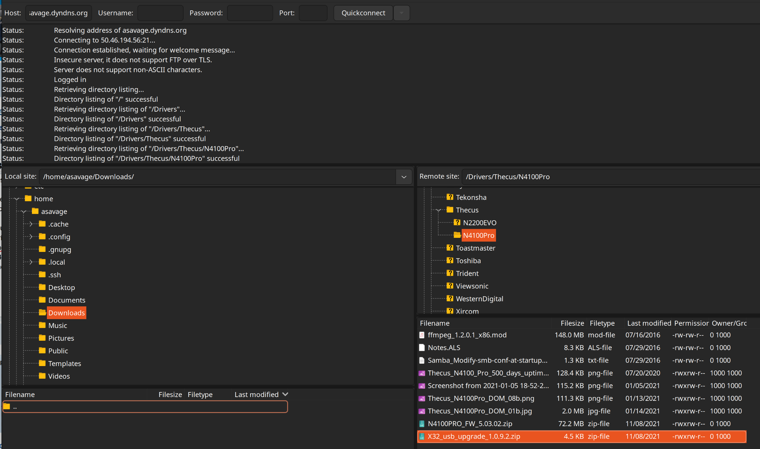

Re: Thecus NASs: N2200EVO, N4100Pro, and managing DOMs
Thanks Asavage! I am familiar with Filezilla, it's been years since I used it, though haha. The last time I did, my friends walked me through the setup, so I'll admit, I'm not sure exactly how it works. When I try to open the links above, it says the connection can't be made. Apologies for turning this into a noob help thread! Here's what I'm getting:
Code: Select all
Response: 234 Proceed with negotiation.
Status: Initializing TLS...
Status: TLS connection established.
Command: USER anonymous
Response: 530 Anonymous sessions may not use encryption.
Error: Could not connect to server- asavage
- Posts: 5469
- Has thanked: 5 times
Yes, I see that. I suppose that in setting the ftpd up for SSL I've locked out anonymous logins. You're the first to report this in . . . years.
I've spent a couple of hours and only gotten so far as to disable SSL, so you should be able to log in now with no credentials. I'm afraid you'll have to navigate to the file using the right pane in Filezilla, but disassembling the link I'd posted:
ftp://asavage.dyndns.org/Drivers/Thecus ... .0.9.2.zip
You'd navigate the right pane to
Drivers
Thecus
N4100Pro
and then select the file; it should download.
Mind where you have your right pane set to, as that's where the file will download. I have been caught by that in the distant past.
Asavage, you're a legend! Thank you so much! I'll be trying this out this weekend by following the instructions. I'll update here with how it goes!
