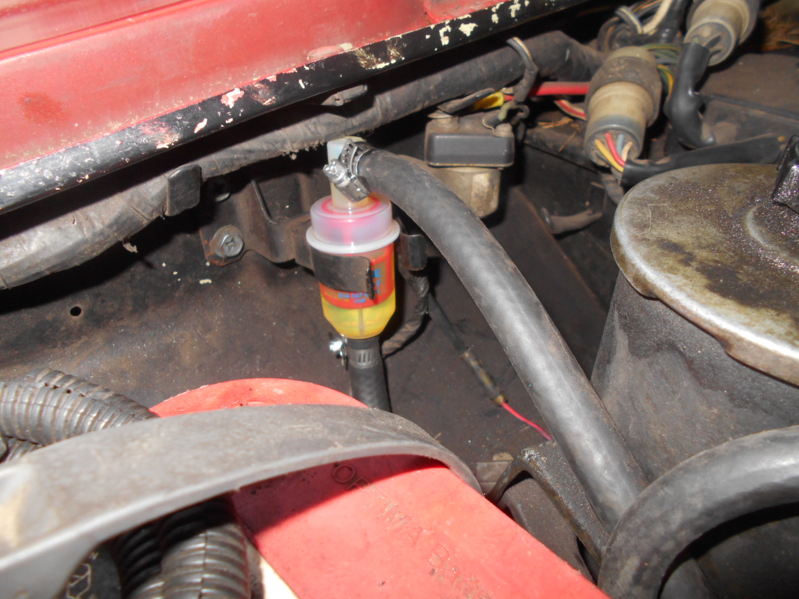

My glow plug relay is just right of my fuel screen, it is not a great photo, but it is all I have for a photo of it.
