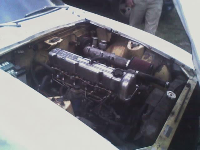

pics of the mods
Here are a couple pics of modified parts.
I just have to reiterate how badass the LD28 is. I think that the majority of you Maxima owners undersetimate the power and refinement of your LD28 engines. As a long time proponent of Z cars and L-series engines in general, all I have to say is that I should have done this swap ten years ago, and that I think the LD28 is the best and most refined of all the L's.
The sump tube
The pan...beware, the stubby nose of the welded "channel" actually needs a 45-degree slope on the front end...
The engine in the car.

I really appreciate your sharing these pictures and your experience so far.
Does the oil pickup tube have a brace? I don't see one, and it definitely needs one.
- Posts: 5463
- Has thanked: 5 times
That's a pretty long piece (the oil pickup) that's subject to a lot of vibration and supported on one end: a brace would be a good idea.
