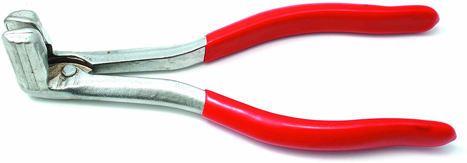

That positive battery terminal looks terrible. Ream it, and install it so it is flush or below-flush on the post. NEVER hit the terminal to make it fit -- that breaks the cell tie bars -- either use the correct terminal spreader tool . . .
Battery Terminal Spreader Pliers
. . . or take the pinch bolt out and use a No. 3 flat blade screwdriver and pry it apart.

Old Smokey wrote: Does the terminal look bad? I wouldn't have known. I'm not sure what you mean about spreaders. When are they used? I took both battery terminals off and sanded them lightly. They didn't put up much of a fight.
The spreaders are like reverse pliers that open the hole on the terminal a little bit so you can get the top of the post on the battery over the terminal. the same thing can be achieved with a flat bladed screwdriver acting like a pry bar.

Prying with a screwdriver is best effective with the pinch bolt removed. Otherwise, you end up doing cosmetic (and sometimes more than cosmetic) damage to the terminal.
I call it a "battery speculum".

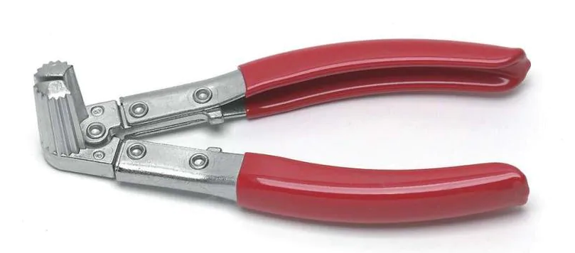

It's two-piece design with solid handles instead of the crappy four-piece folded sheet-metal-handles design everyone else has seemed to have migrated to. Don't buy one of those, with the riveted handles. KD sells one like that: garbage.
Battery Terminal Spreader Pliers with riveted handle: bad.

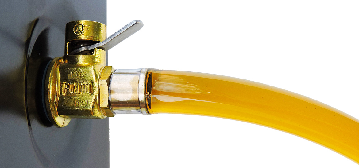

Last night, I had an opportunity to try a trick I'd heard about, utilizing a shop vac.
I had to replace an oil drain plug on a generator, on which I had just changed the oil. I'd heard that one can use a shop vac on the oil filler whilst removing the plug, and not lose any oil.
I wanted to replace the static drain plug with a fumoto ball valve & nipple, because of the eventual location of the generator won't allow graceful use of an oil pan.
[url=http://fumotousa.com/]
Fumoto engine oil drain valve
Fumoto animation
Fumoto animation
I enlisted the help of my boss, who manned the vac, and tried it. With only a partial vacuum via the hose to the filler hole, I was able to change the valve with no oil loss. Didn't even get my fingers oily.
