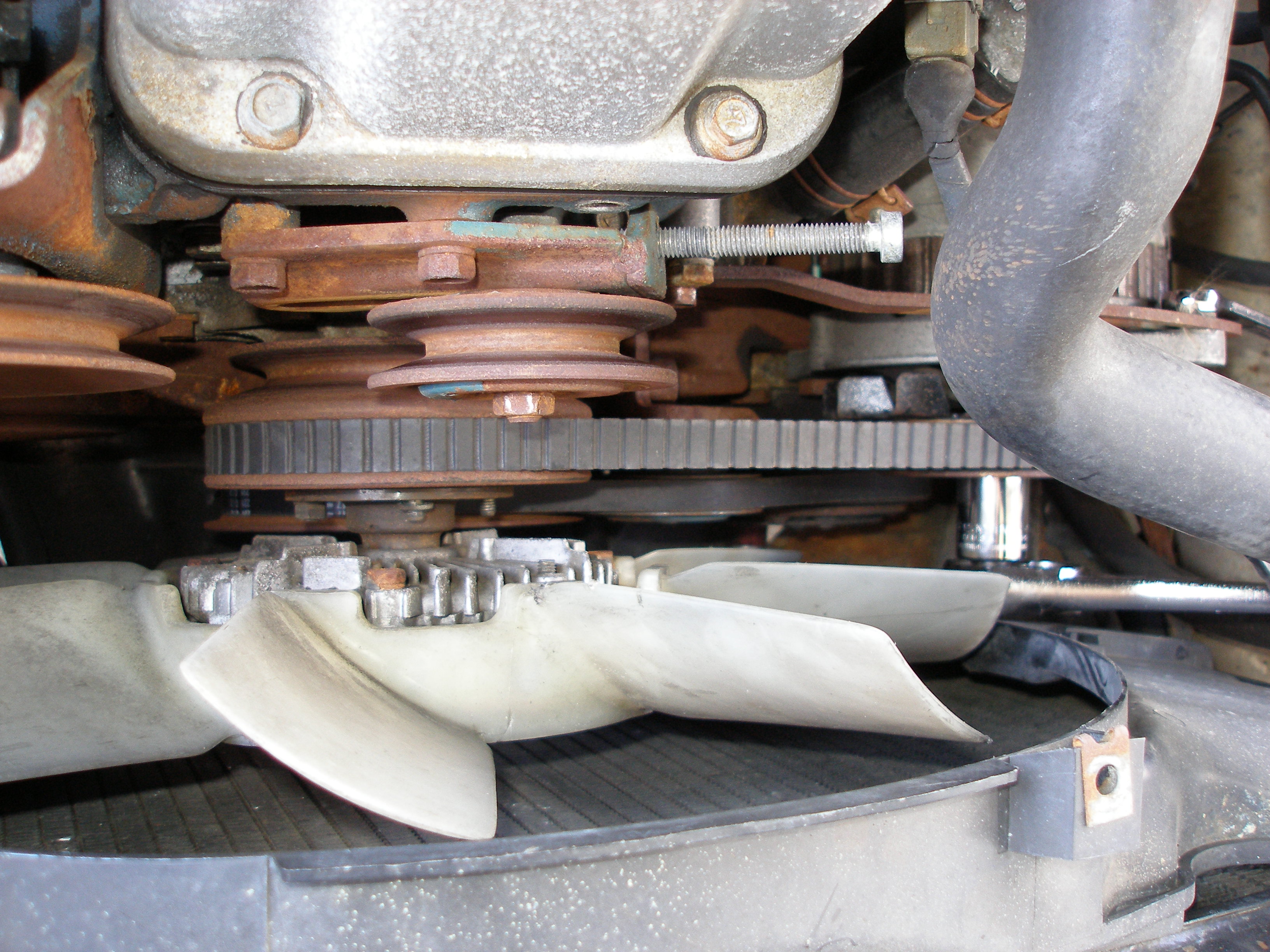

Walked back to the shop, pulled the fan clutch, sheave. Tip: leave alt. belt on to provide tension to aid in removing fan clutch nuts (10mm wrench). Use ratchet/22mm socket on alternator nut to turn engine over to get each nut to 12 o'clock.
Installed new PS belt, reinstalled sheave and alt. belt, put all four fan clutch nuts on one at a time, got distracted by a customer coming round to the back of our (closed) shop, and when I got back to the job I had forgotten that I hadn't tightened the fan clutch nuts. Yup, you know how this story ends you think, but it's worse than that even . . .

Drove away from the BD trailer, got about a mile, and the fan came off into the radiator. Tore up the fan shroud too, swiped a bunch of radiator fins but no leaks --I don't know why not. Eventually got it back to the shop, walked to the FLAPS again, picked up a studs kit to replace the four bent and mangled studs on the water pump (and one wiper blade, they only had one). An hour later, I had the studs replaced and the fan back on.
