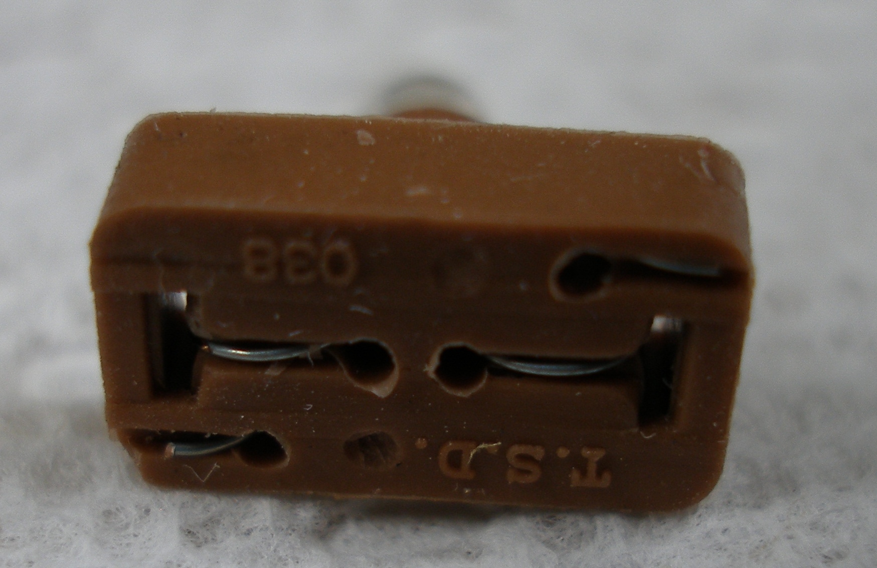

Just like in the cruise control indicator, the lamps are socketed in silicone sockets. However, this socket has rectangular slots for the spade-style posts, where the CC indicator uses round holes and round posts. So the sockets are not interchangeable.
Filament clearly missing.
Careful snip of the leads, lamp removed.
New lamp inserted.
Now to double feed the leads the way the originals were.
All back together and plugged in, it lights up fine. Unfortunately, it's lit all the time. It's supposed to only light when the trans is actually in OD. I'm guessing a bad OD switch.
