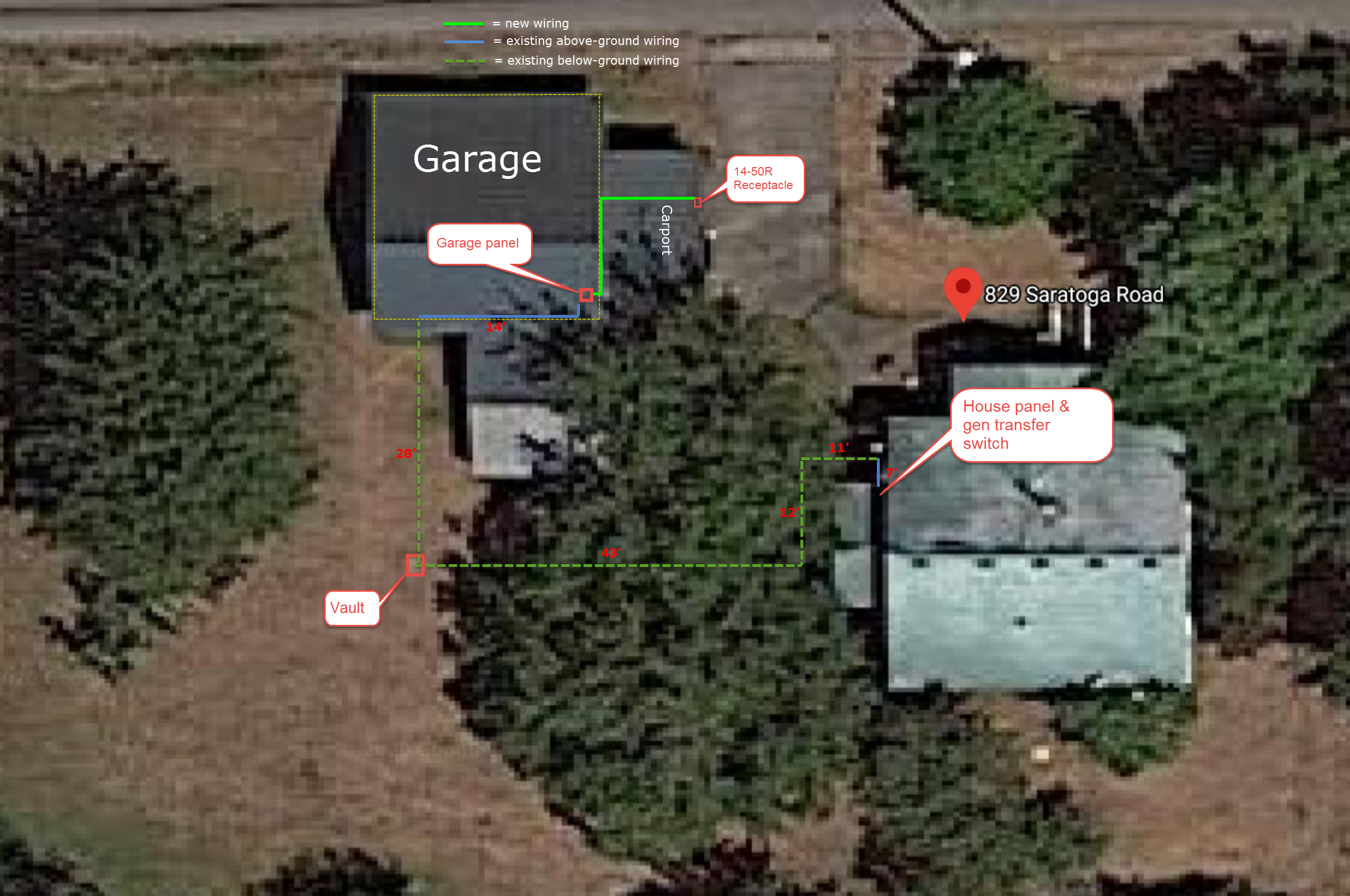

14-50R install in carport:
There are two conduits from the house to the garage. The run is approx. 115'
* One is the 30A generator feed from gen socket in garage to transfer panel in house. Wiring is 8 ga., conduit is 3/4"
* One is the 50A feed from the house panel -> garage panel. Wiring is 6 ga., conduit appears to be 1"
What I desire is a 50A 14-50R receptacle in the carport. The garage panel does not appear to have enough room for this.
Site plan for wiring

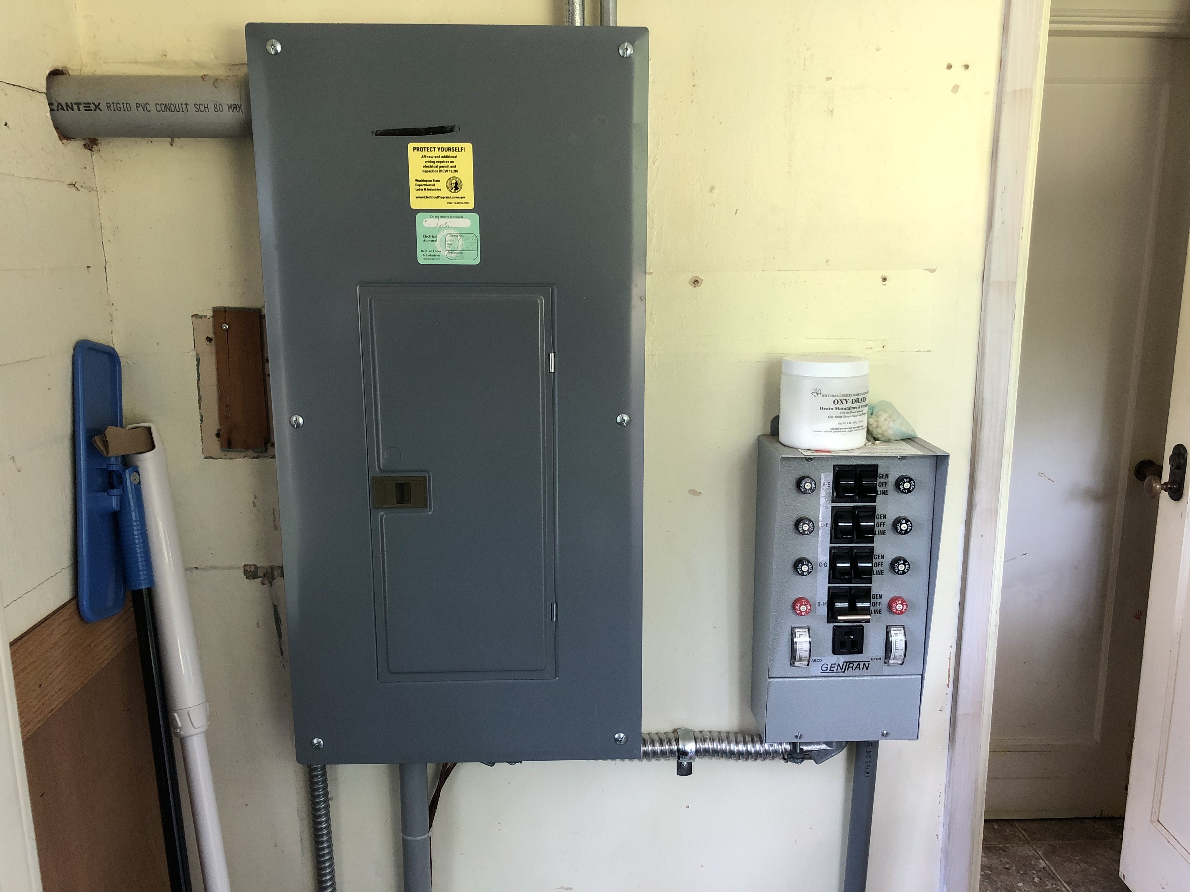

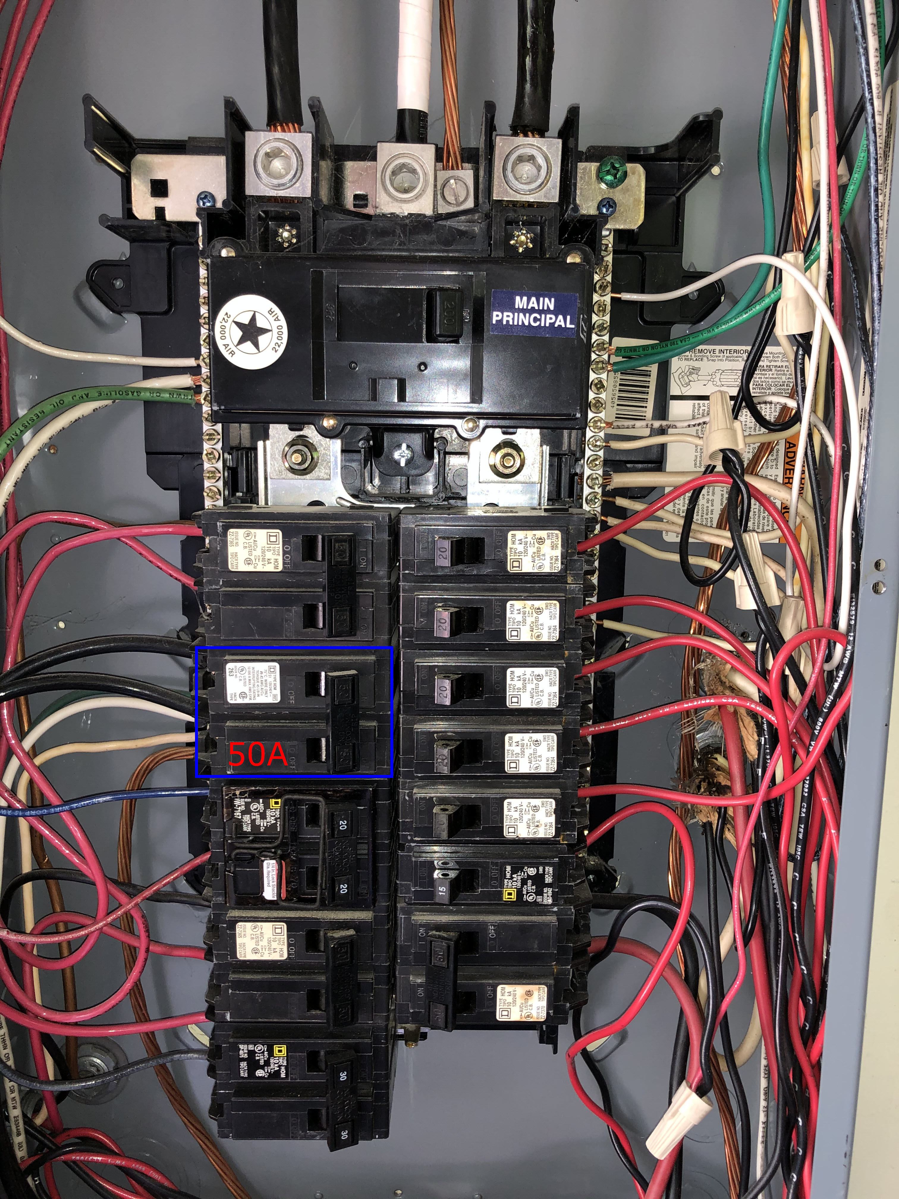

House breaker panel
House breaker panel
House breaker panel
House breaker panel

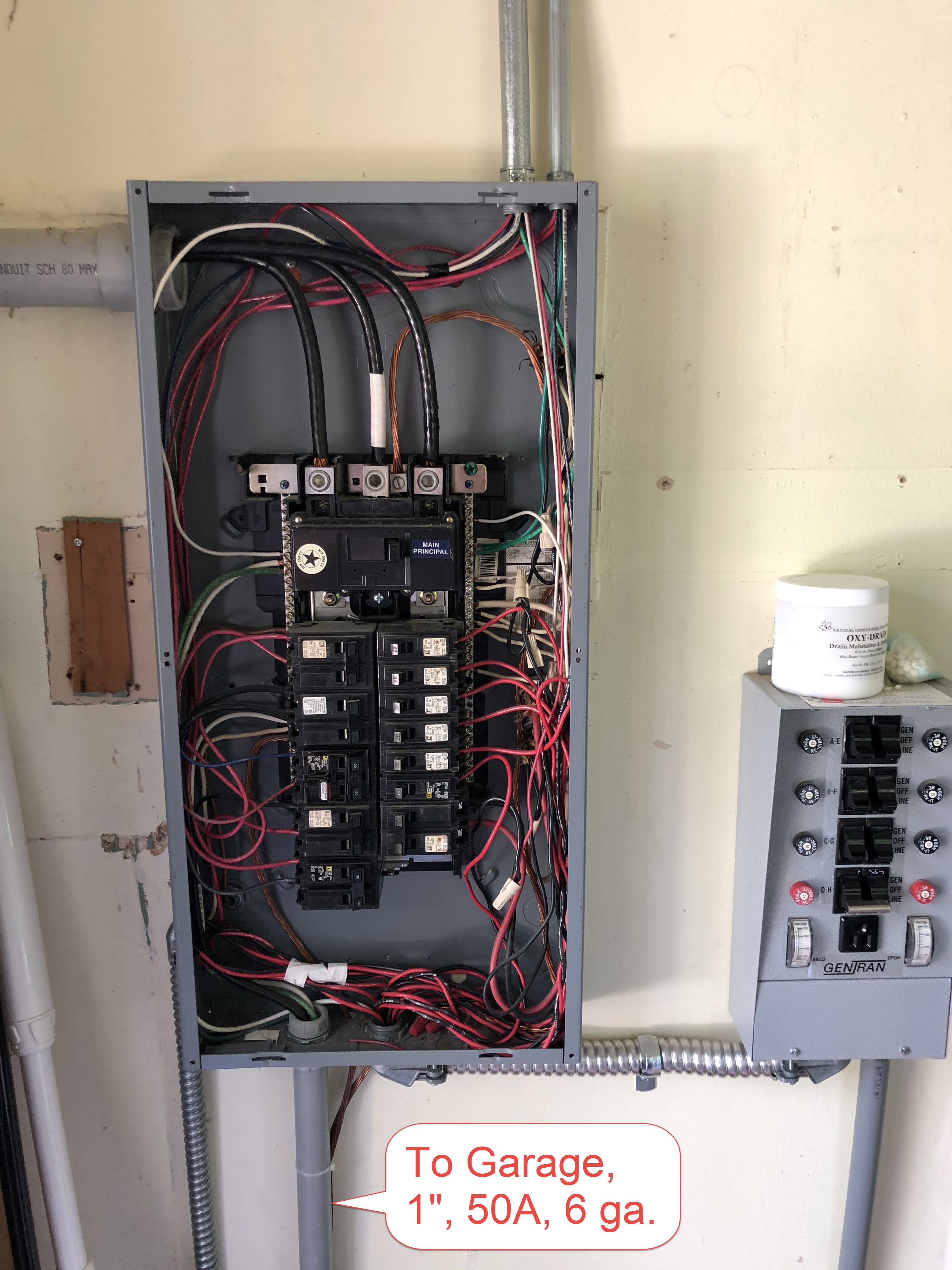

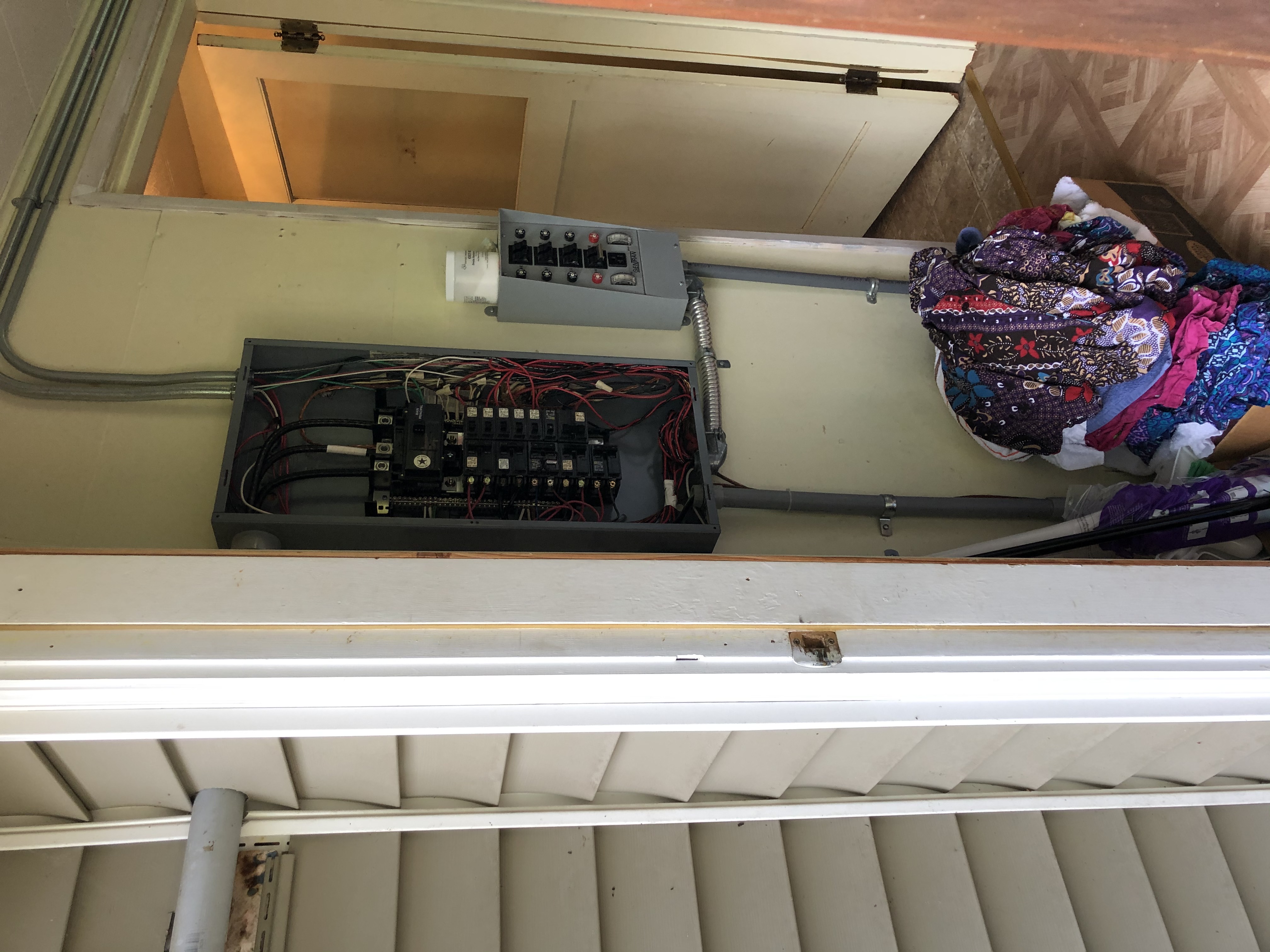

GenTran transfer switch
House breaker panel
House breaker panel
House breaker panel
House breaker panel
House breaker panel
House breaker panel

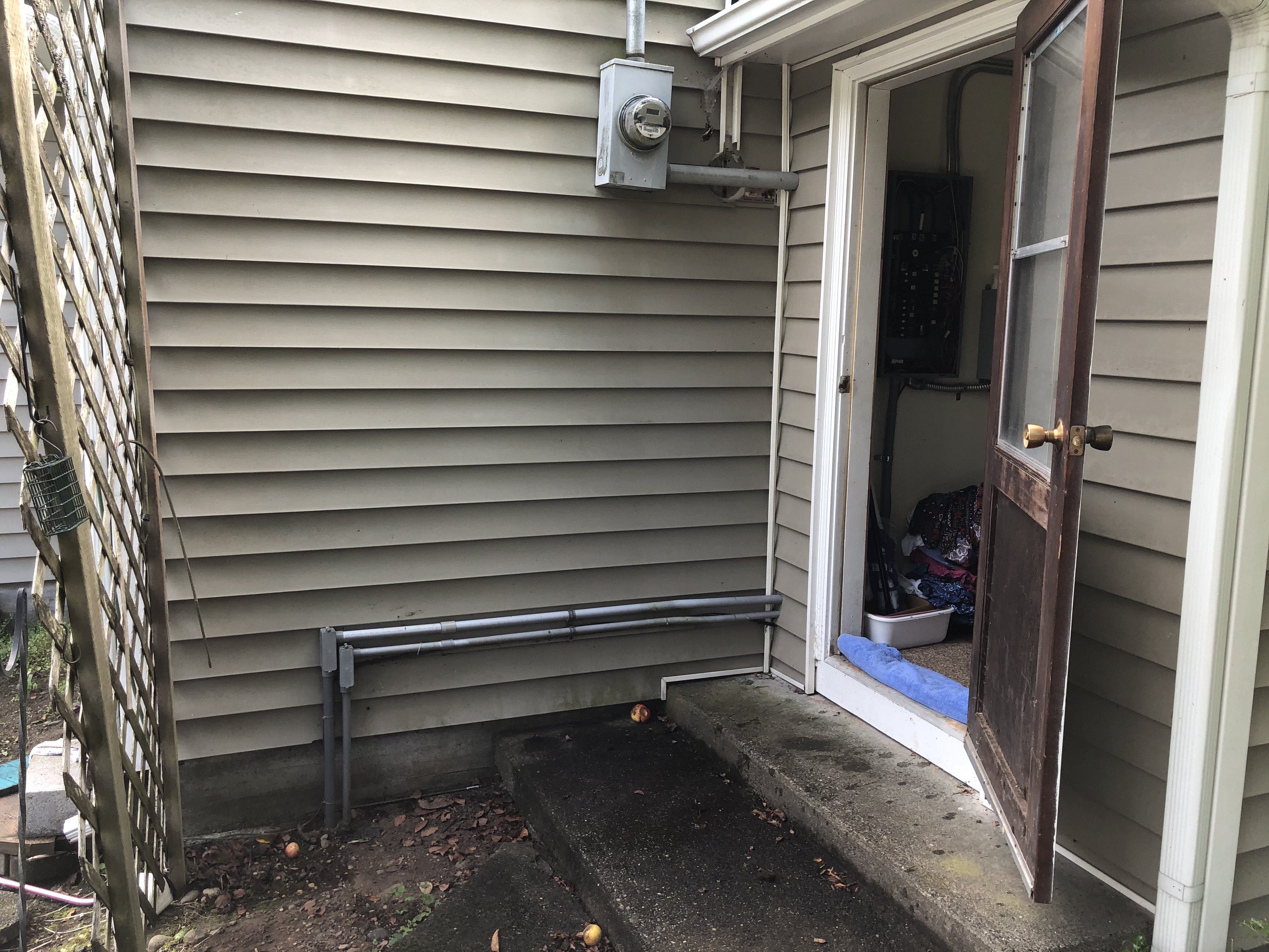

House breaker panel conduit to outside and into ground

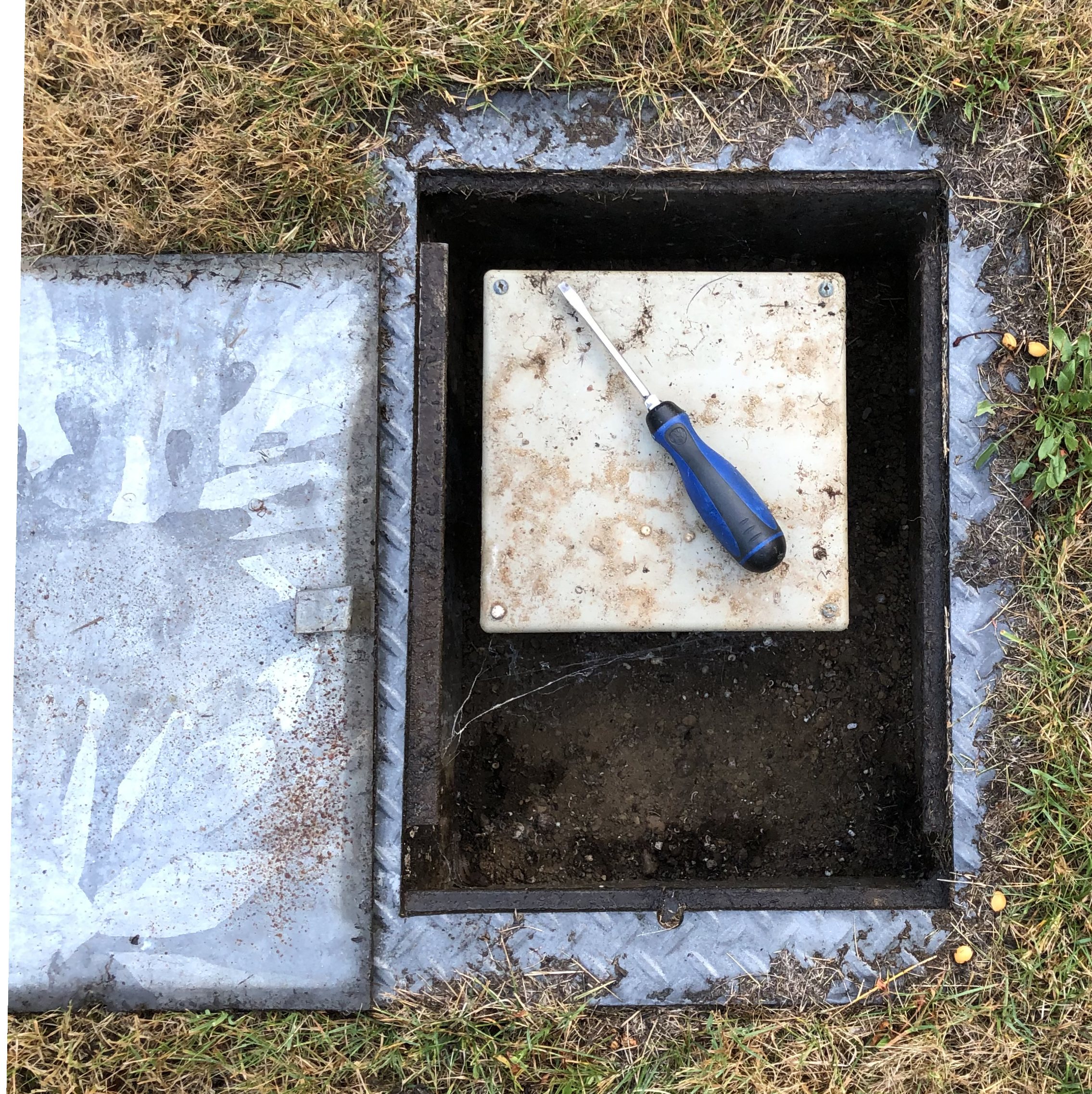

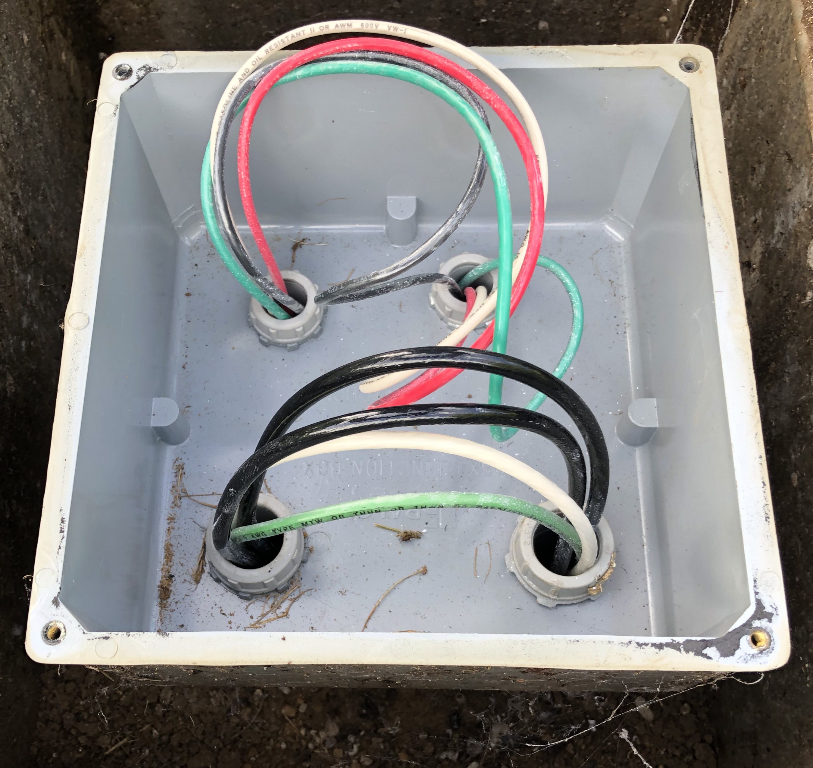

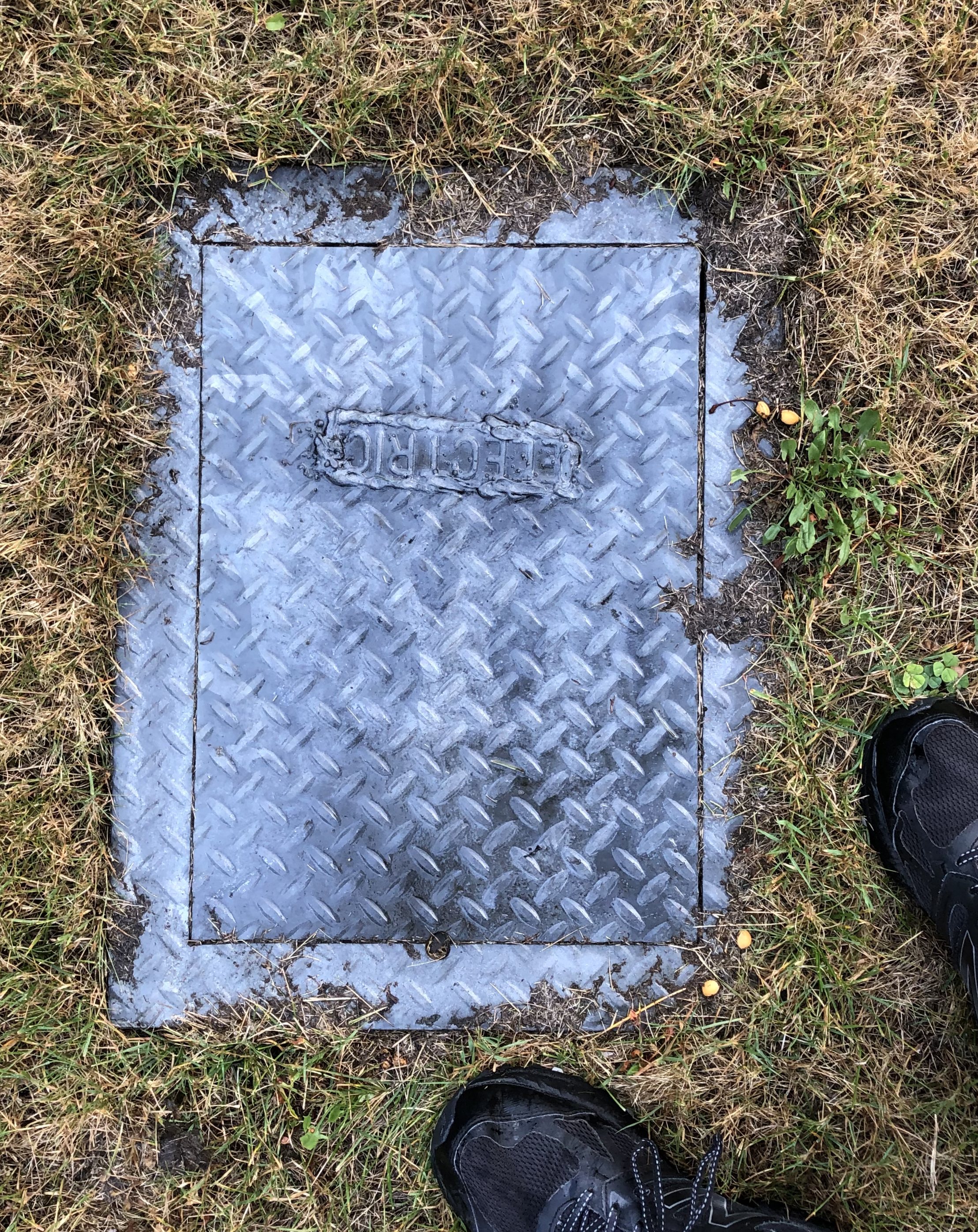

Yard vault
Yard vault
Yard vault
Yard vault
Yard vault
Yard vault
Yard vault
Yard vault
Yard vault
Yard vault

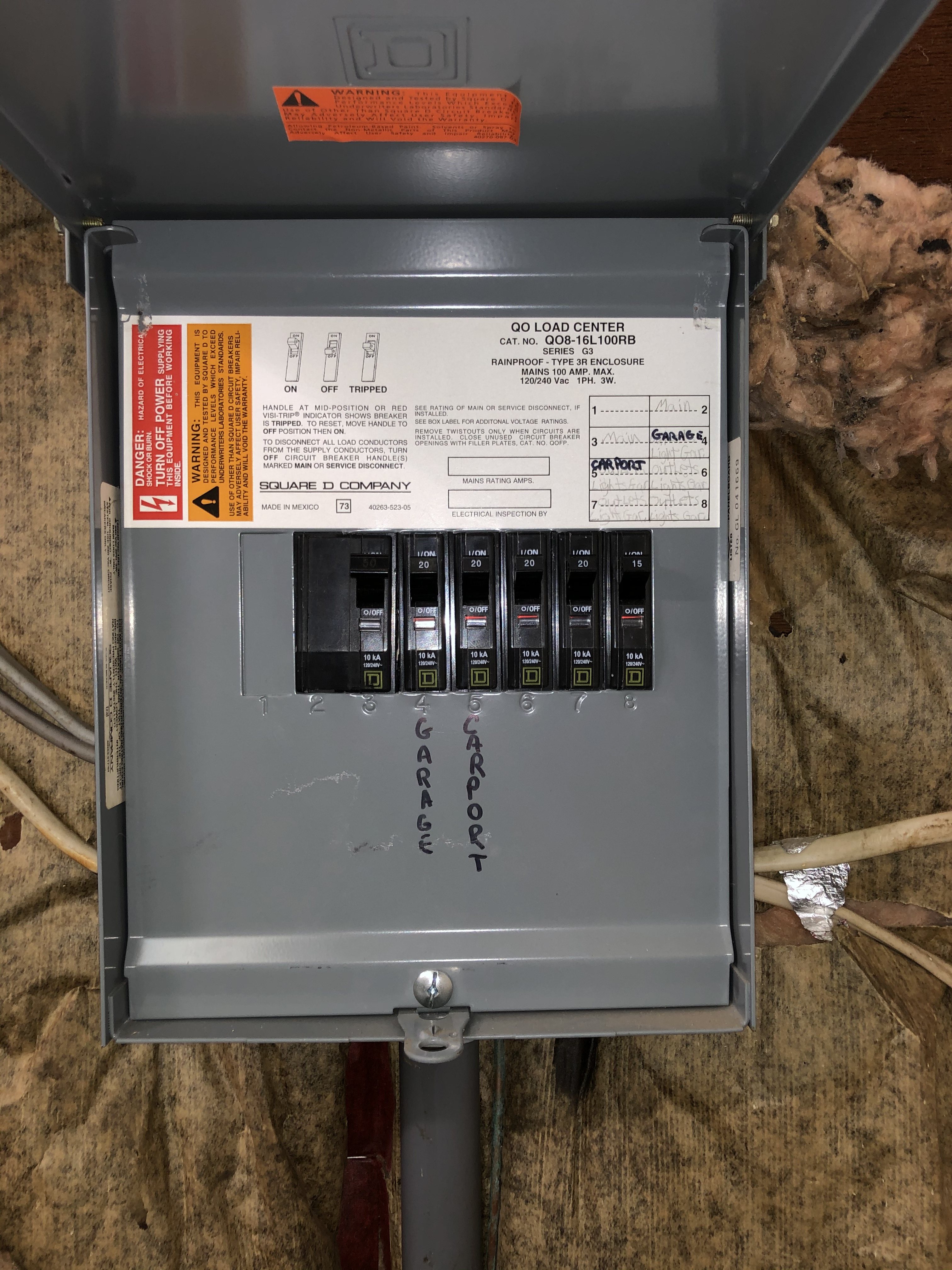

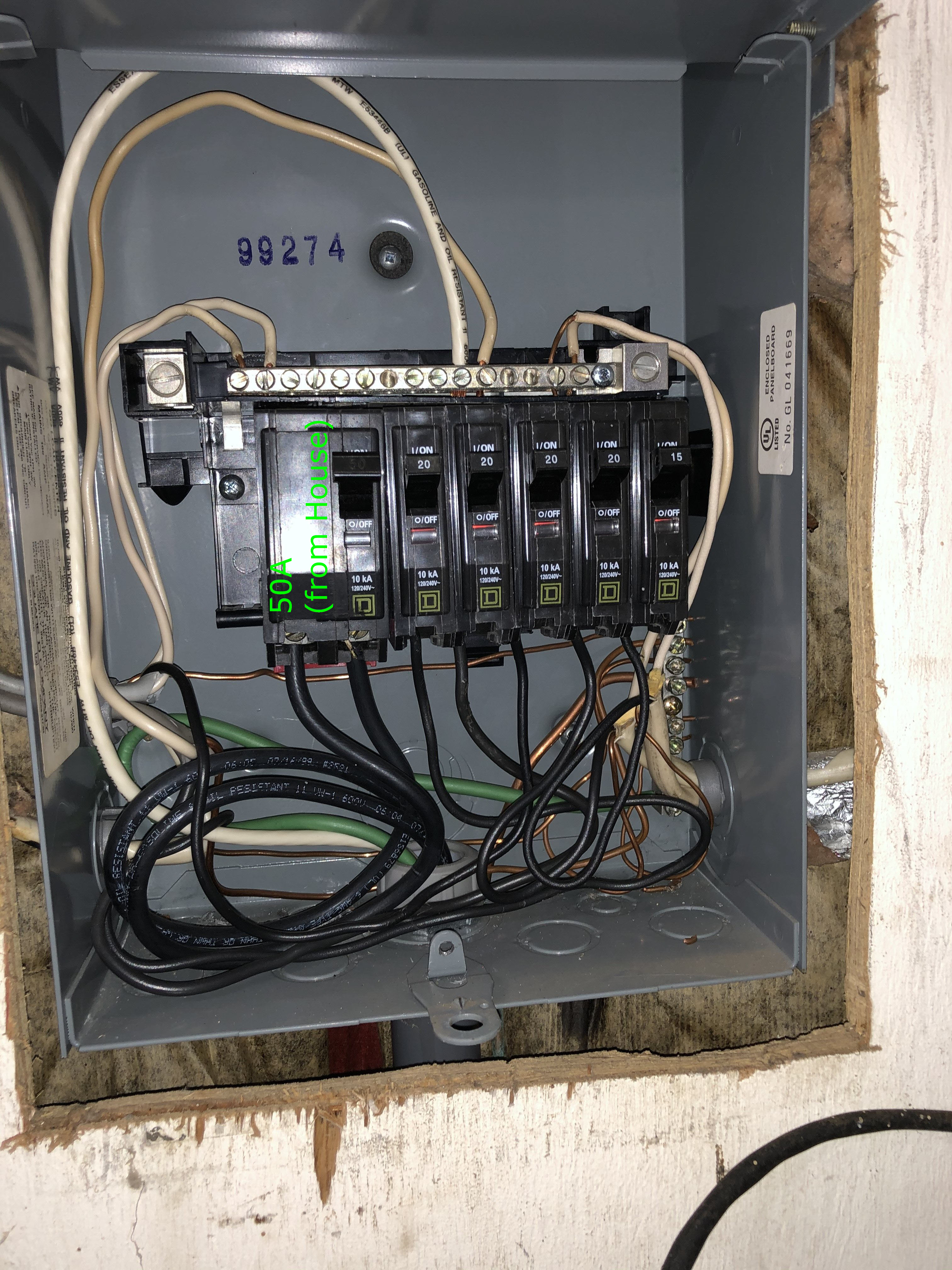

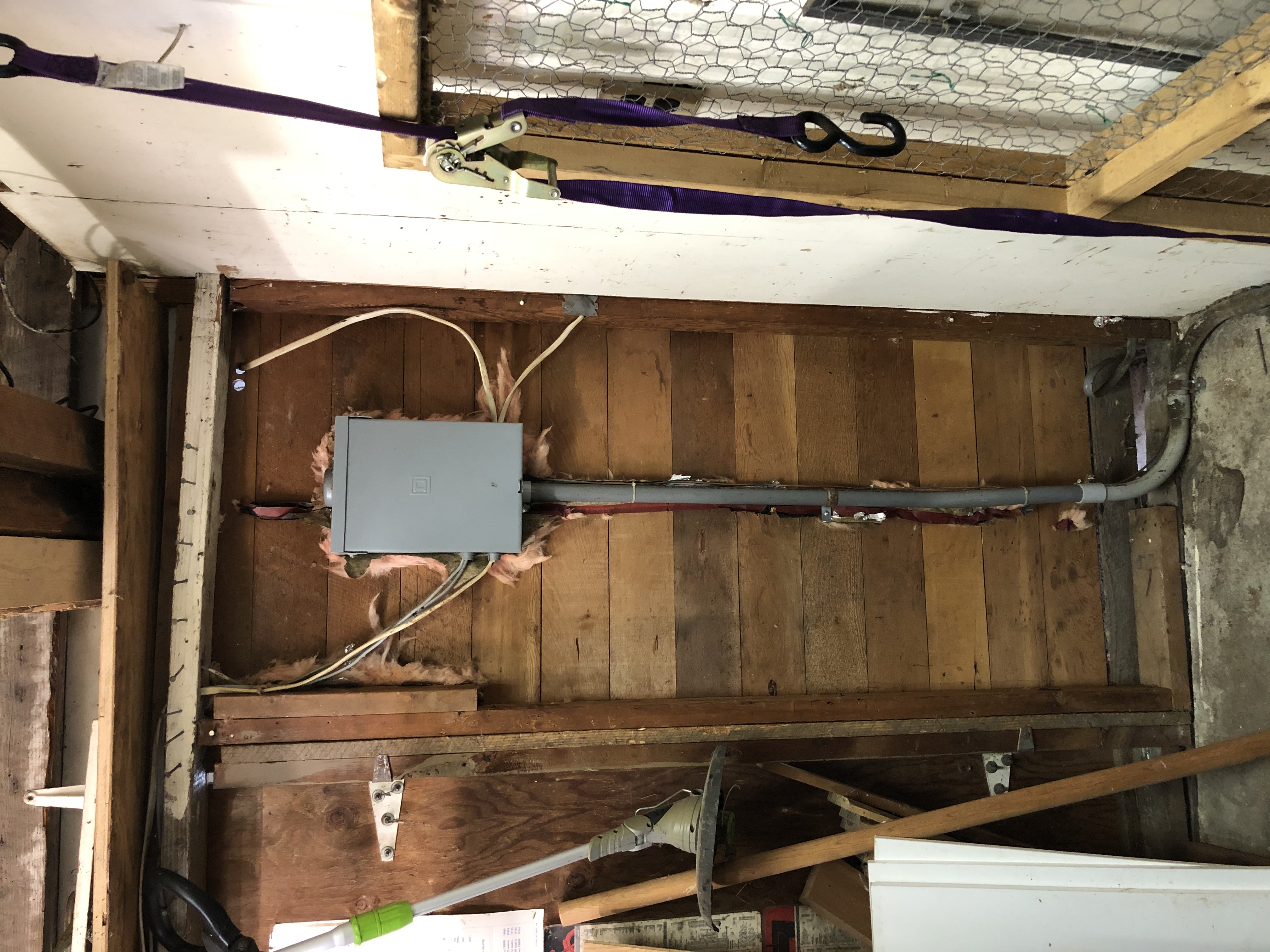

Garage breaker panel
