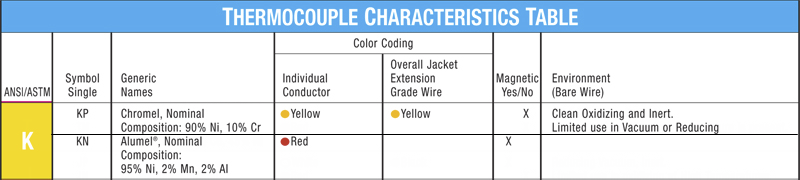

TYPE K THERMOCOUPLE (Chromel / Alumel)
(US) ■ YELLOW jacket: Positive leg, Chromel, is approximately 90% nickel, 10 chromium.
(US) ■ RED jacket: Negative leg, Alumel, is approximately 95% nickel, 2% aluminum, 2% manganese and 1% silicon. MAGNETIC due to the nickel content.
(US color coding is ANSI and is not universal across all geographies and industries)
Type K wiring color identification
Type K Thermocouple Characteristics

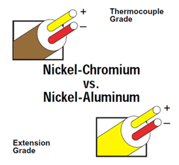

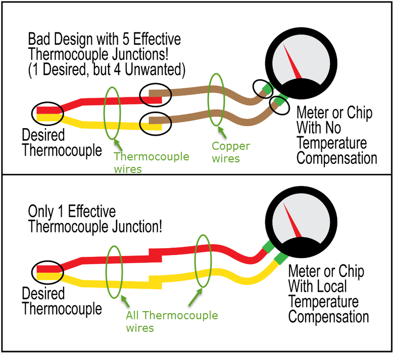

Thermocouple wire is not copper wire, and there is a matching type of thermocouple wire for each type of thermocouple. Type K thermocouple wire is two-conductor (for a single thermocouple) and the each of the two conductors is composed of different metallurgy, to match the thermocouple's native composition.
Thermocouple circuit with splice
Introducing extra cold junctions opens the potential for those junctions to introduce errors in the signal that cannot be compensated by calibration, especially if there is a temperature gradient across the pair of junctions.

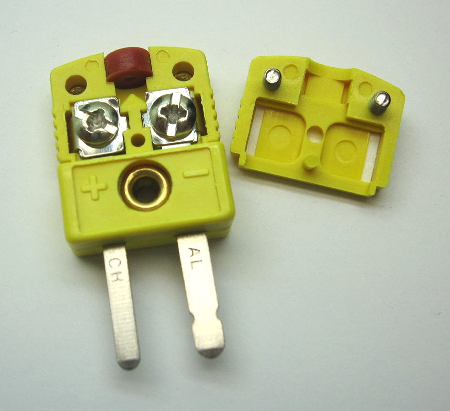

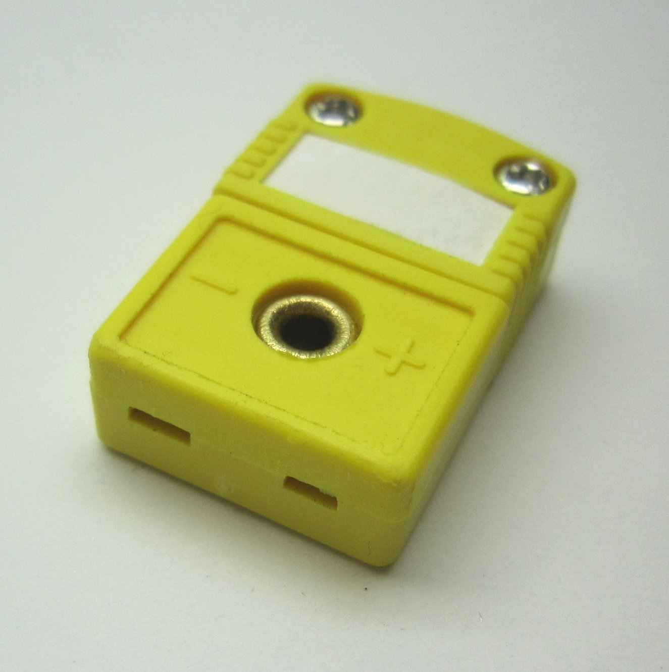

Besides using TC wire to extend a run, there can be other reasons that you may need to cut/splice/join TC wiring. Sometimes, you need a detachable point in the wiring for serviceability. In this case, quick-disconnects that feature Chomel/Alumel terminals and contacts are widely available.
Type K Thermocouple miniature male connector
Type K Thermocouple miniature female connector

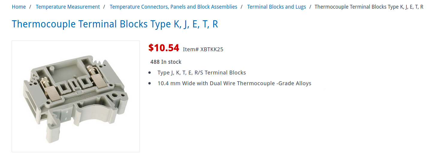

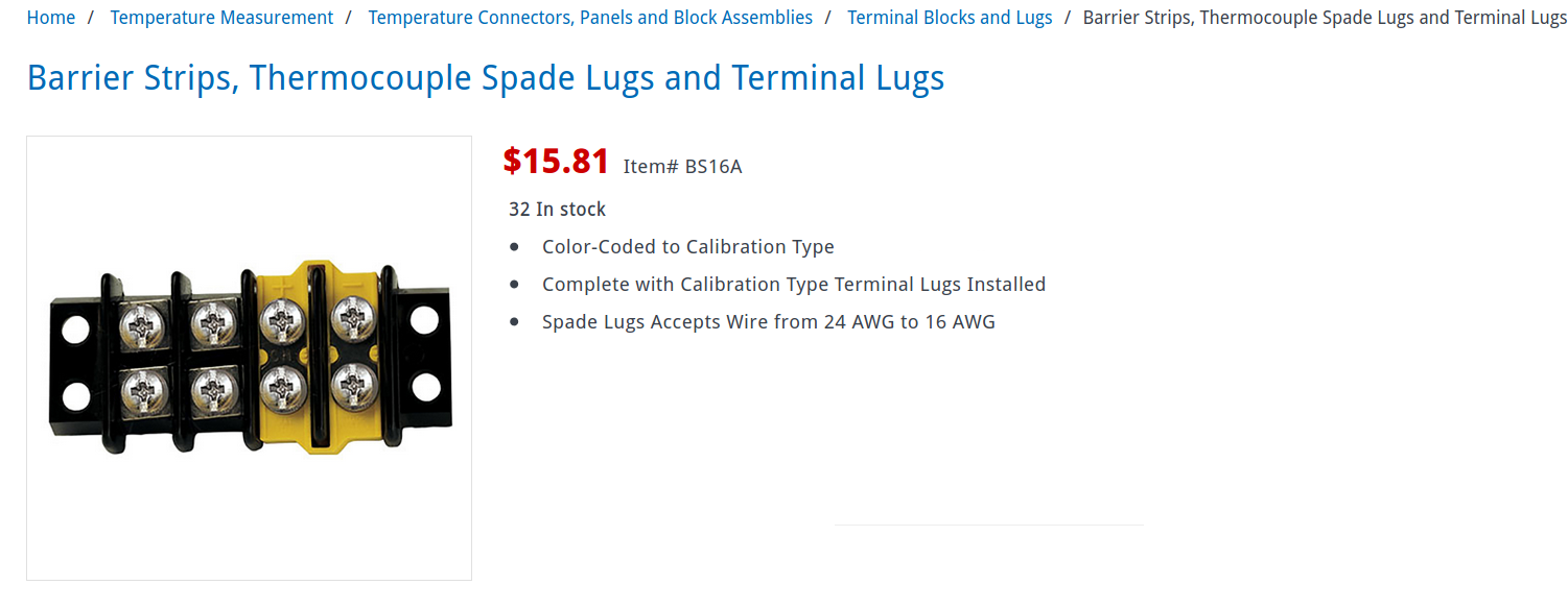

However, what if you don't want/desire to have a quick disconnect? Maybe you need to extend the TC wiring, cut & splice for repair. Another approach is to use a TC terminal block, either surface-mount or DIN rail mount.
Omega BS16A Thermocouple terminal strip
Omega XBTKK25 DIN rail terminal block
Thermocouple terminal DIN rail

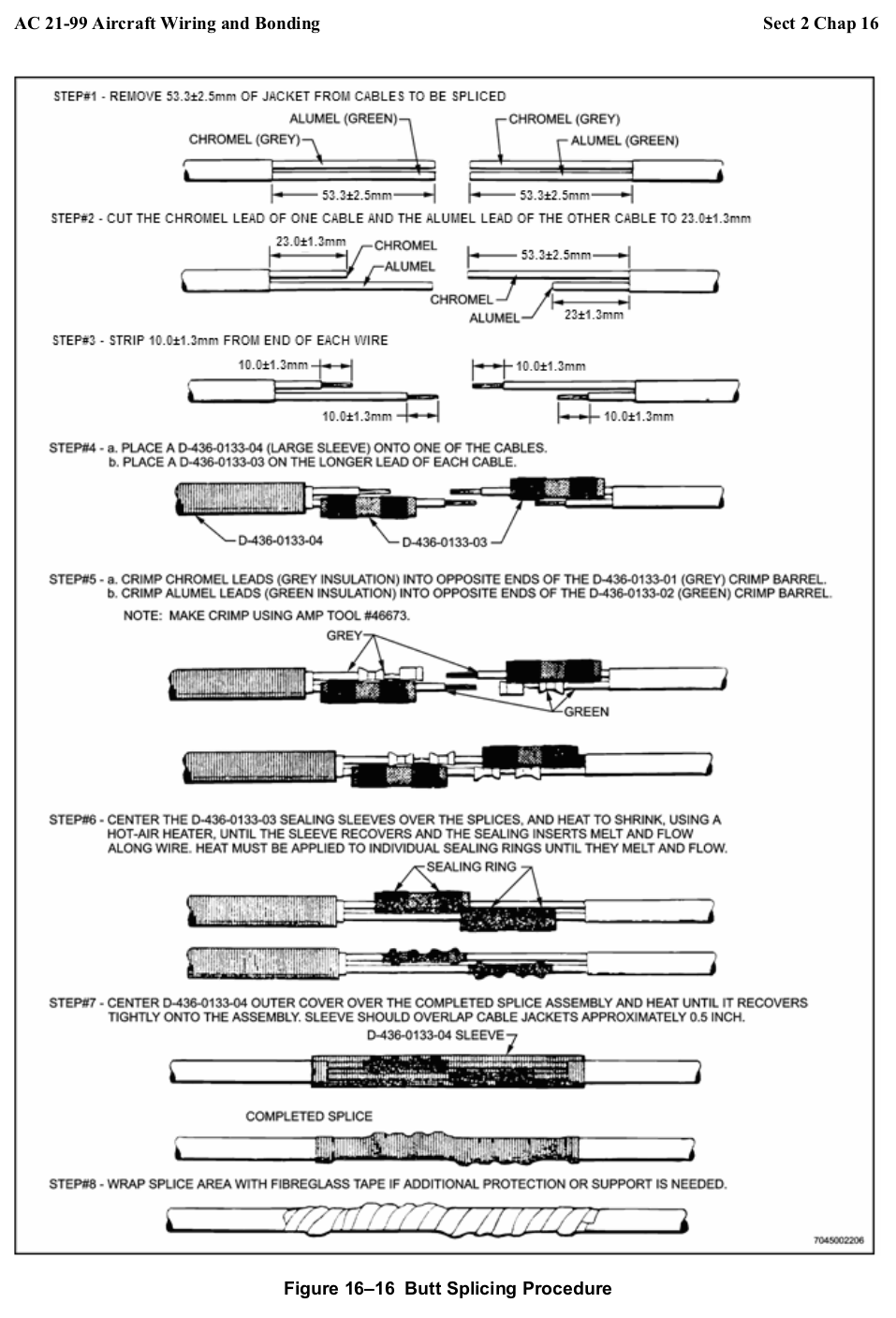

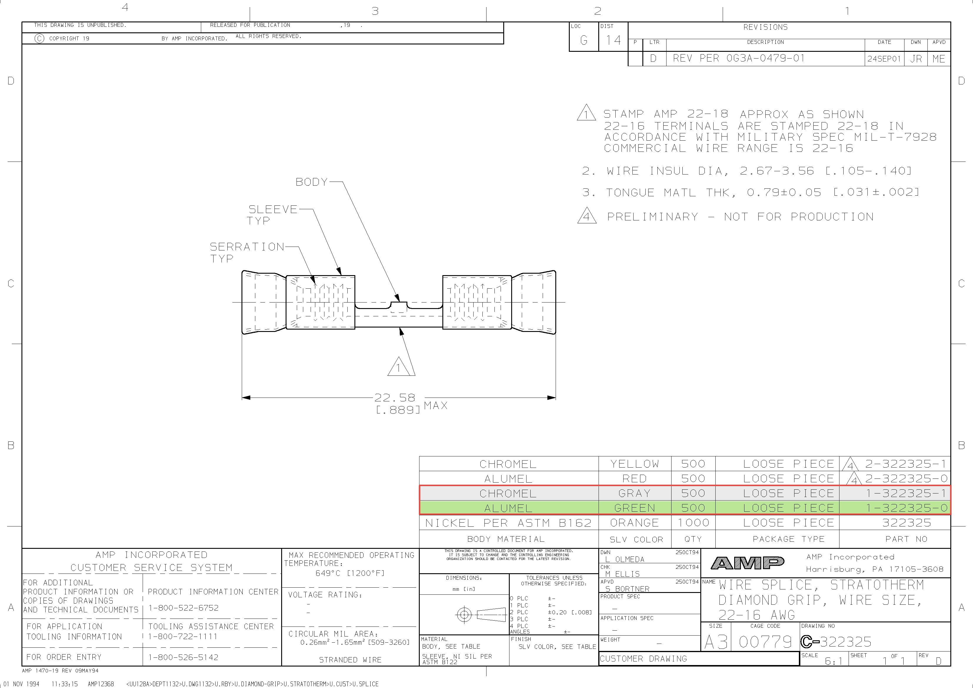

One topic is especially contentious: splicing thermocouple (TC) wires. It's difficult to find good information on a plain butt connector for inline splicing of TC wire, but it does exist. Military and aerospace people have this stuff down.
AC 21-99 Aircraft Wiring and Bonding ("THERMOCOUPLE WIRE SOLDERING AND INSTALLATION", Section 2, Chapter 16, begins at page 351)
Advisory-Circular-AC-021c99-AIRCRAFT-WIRING-BONDING-.pdf]AC 21-99 Aircraft Wiring and Bonding, Sect. 2 Chap. 16 Para. 31 Materials wrote:
Qty 1 D-436-133-01 Chromel Splice, Colour Coded Gray.
Qty 1 D-436-133-02 Alumel Splice, Colour Coded Green.
Qty 2 D-436-133-03 Splice Sealing Sleeves.
Thermocouple Wiring Butt Splicing Procedure
Those butt connectors sort of translate to TE Connectivity numbers.
Thermocouple Wiring Butt Connectors chart
AMP has been part of E Connectivity, since 1999, and this product line is their "Strato-Therm" terminals.
The Type K Positive/Chromel/Yellow (Gray) butt connector is AMP/TE Conn. 1-322325-1 (OnlineComponents.com, $4.26 ea, min. qty. (10))
The Type K Negative/Alumel/Red (Green) butt connector is AMP/TE Conn. 1-322325-0 (OnlineComponents.com, $2.32 ea, min. qty. (10))
I just ordered (10) of each for $80 after shipping and tax.
It seems very common for people to try to solder, use twist connectors, or standard (dissimilar metals) screw terminal blocks to splice thermocouple wiring. From what I have read, the most-correct method is to use TC wire butt connectors whose metallurgy matches the TC wires to be spliced. This method avoids creating extra cold junctions in the TC wiring circuit.
