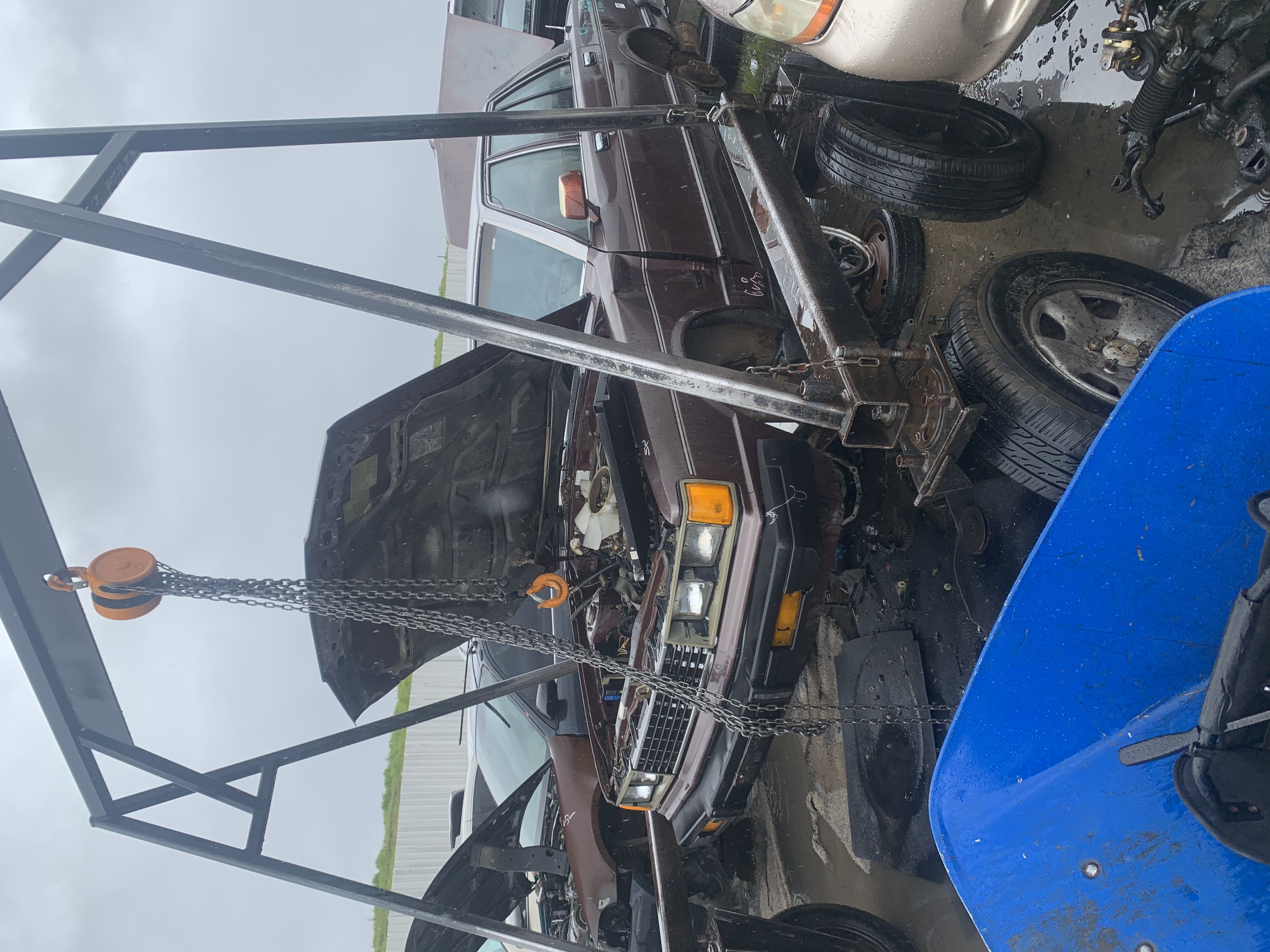

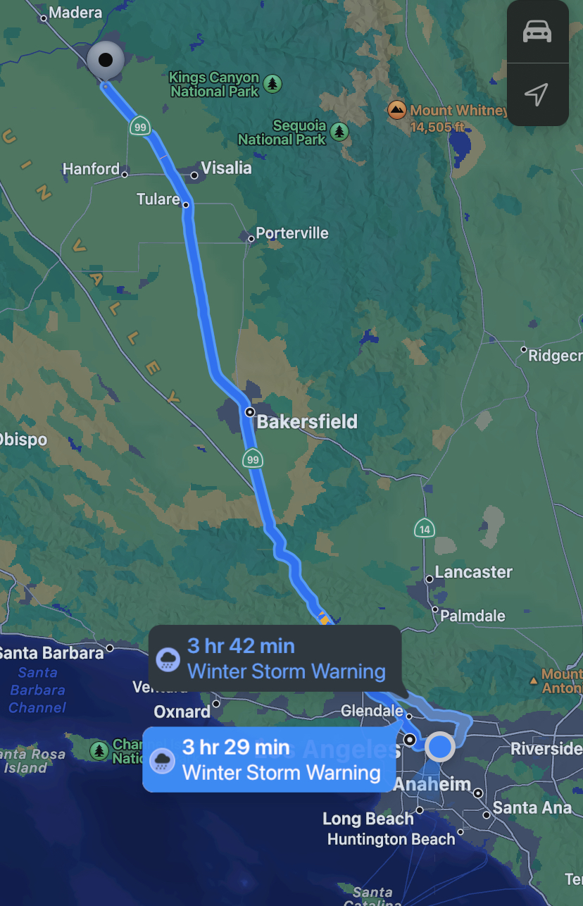

During my spare time I like to check junkyard websites (row52, LKQ, IpullUpull) to see if any cars pop up with parts I need. Struck gold when I saw a 82 Maxima Diesel listed on IPullUPull Fresno’s website! Couldn’t believe it. With these cars being 40 years old with many being killed for the crankshaft, I never would have thought I would find one somewhat close by. Fresno is a good 3 1/2 - 4 drive, which is very risky since you never know if the car you are after still has the parts you need. This was a risk I was willing to take.

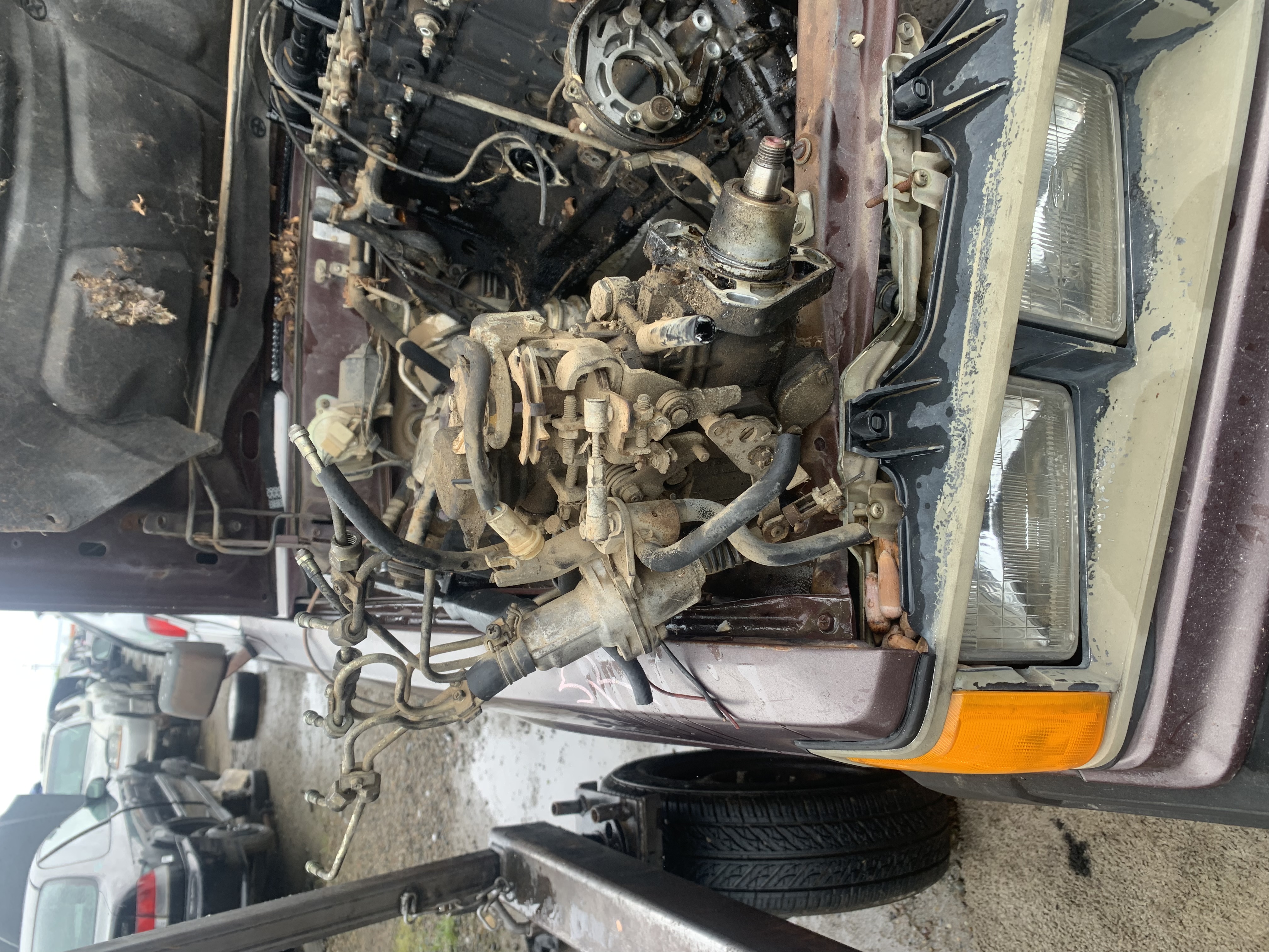

I hope these pictures work, but after a long drive I made it to the yard. Crank was gone, but the IP with most of the NLA diesel parts were still there! Pulled the IP with the lines, alternator w/ vacuum pump, glow computer, drop resistor, glow relays, diesel fender badges, IP belt tensioner with hardware, and all 6 injectors. Would have grabbed more but I was low on funds (broke college student). Didn’t help that it was pouring rain!
Wasn’t prepared for how much of a PITA this pump was to remove! Lots of stuff in the way, and I needed to lift the motor to remove the engine mount bracket. With it in place there isn’t enough room to get the pump far enough from the block especially with the lines in place. Those lines are TIGHT and in a terrible spot, do not even try believe me. Now the engine mount bracket is a absolute nightmare due to the location of the top 14mm bolt. Nearly zero room to remove/loosen it. Had to take the oil filter housing off to get more leverage. I’m definitely pulling the motor when it’s time to do my IP, not fun when it’s in the car.
