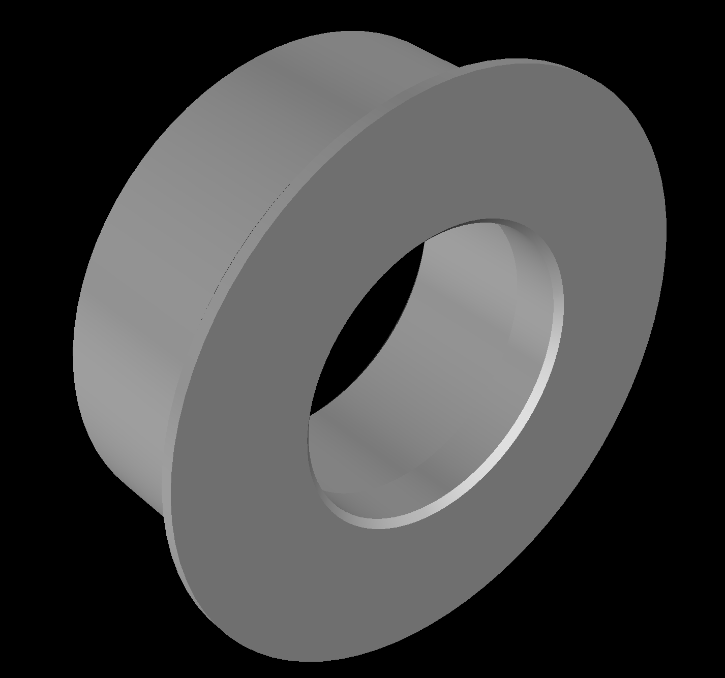

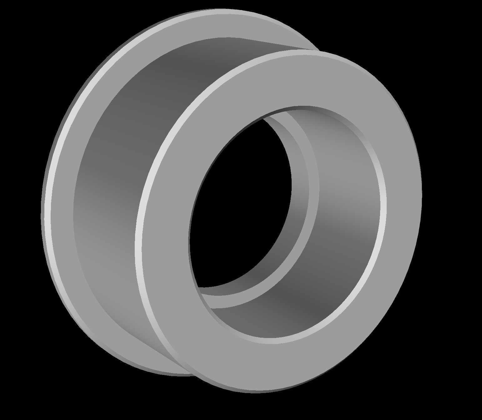

IP Belt Tensioner Pulley
I put in a few hours today, and I got a quote to have IP belt tensioner pulleys fabricated. These would be machined from T304SS and will accept the 40mm OD SKF bearings I've been using for rebuilds.
If I get (10) fabricated, I can sell them for US$110 ea. This is a pretty hefty investment for something I'm only selling once a year
