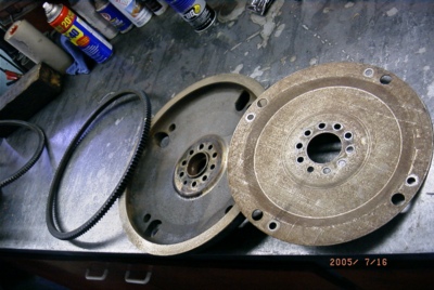

I got the parts today. Some lightweight flywheel. It is definitely from a Diesel engine. The tag says 1981 5 Door Maxima Diesel sedan. All the parts weigh only 12 LBS! That is less than from a gasser ( 280ZX). The flywheel itself is only 10.5" in diameter.
The clutch plate and disk I have (from a 280ZX) are bigger. Now I have to look for a new one.
[/URL]

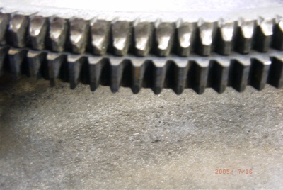

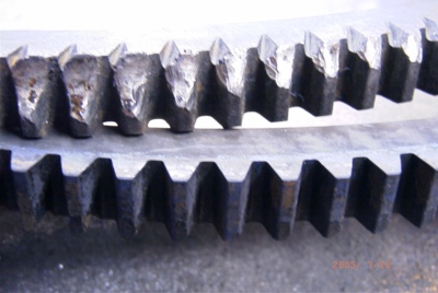

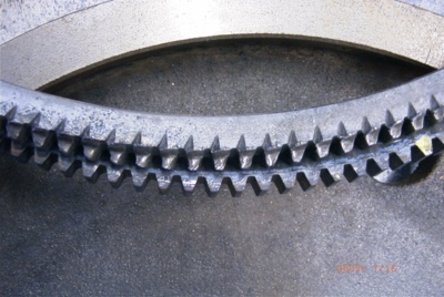

Ring gear: on many flywheels, the ring gear can be replaced. The usual reason is that someone didn't keep their engine in good condition, overused the starter, and wore out some teeth. Most engines tend to stop in exactly the same spot, so the same teeth take all the abuse of initial starter bendix gear engagement.dieseldorf wrote:Autozone.com is listing a ring gear PN: FRG-105G for $27.99 and has it in stock. What is a ring gear good for?
I've not heard of the LD28 flywheel teeth getting this bad yet, but I'm sure someone has worn theirs out.
I've replaced the flywheel ring gear a few times, most recently on my now-sold 1984 F250 diesel:
(click on any picture for larger)

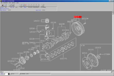

I am sorry to inform you that you have received the AT drive plate and flywheel, instead of the MT one. In the screenshot from Nissan FAST below, the AT parts are shown in the lower right corner ("ATM"):

Al, you're right. Those idiots sold me an AT plate instead. Another $60.00 waisted. I am really frustrated now. This flywheel-clutch issue is holding me back for a month already. I have that flywheel (and clutch set) from a 280ZX. The only difference is the ring gear and weight. Maybe I could shave off the old one and install that from the AT plate or from Autozone. What do you think Al?
