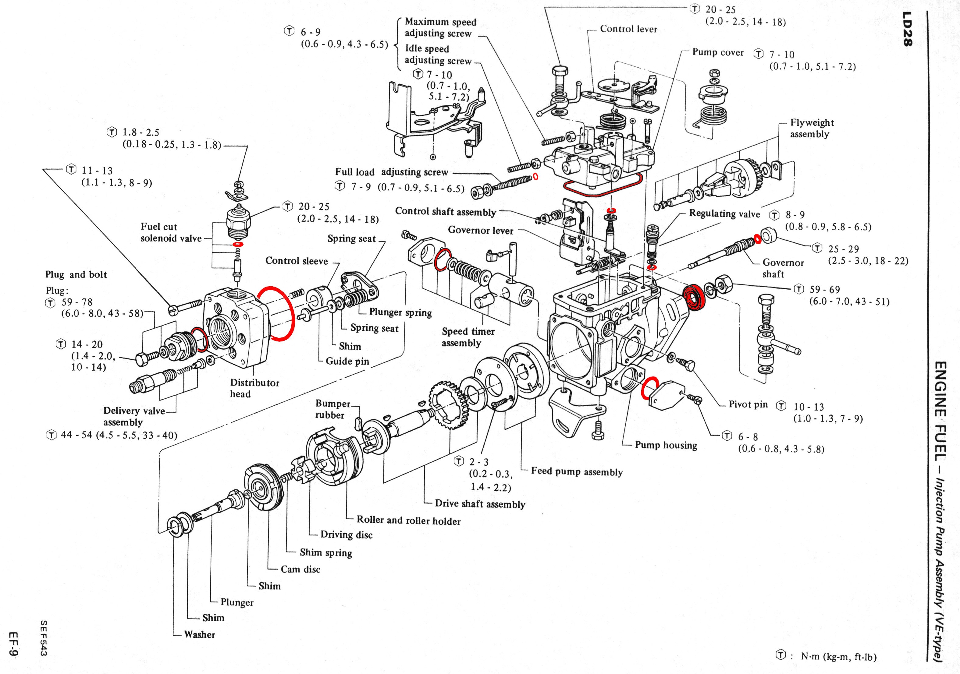

I've mentioned many, many times (and is pointed out in the FSM), you can only replace the PS belt by removing the WP sheave. It's even in the FAQ.
Bummer about the leak. If it's higher up than the shaft seal, next most likely is the governor cover (top cover). It uses a molded-o-ring kind of seal. Common leak point. As is the accel shaft seal, and the distributor housing o-ring at the back.

How accessible is that govenor cover? Is that seal replaceable? Or even available? or is it a generic o-ring or a flat gasket?

The cover "gasket" is roughly rectangular. It's the next-highest bit of Red in the drawing below.odie wrote:How accessible is that govenor cover? Is that seal replaceable? Or even available? or is it a generic o-ring or a flat gasket?
See this thread for a reseal kit's contents and part No.
