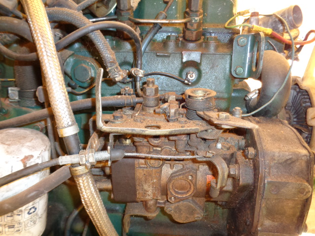

My engines have mechanical inline fuel pumps.

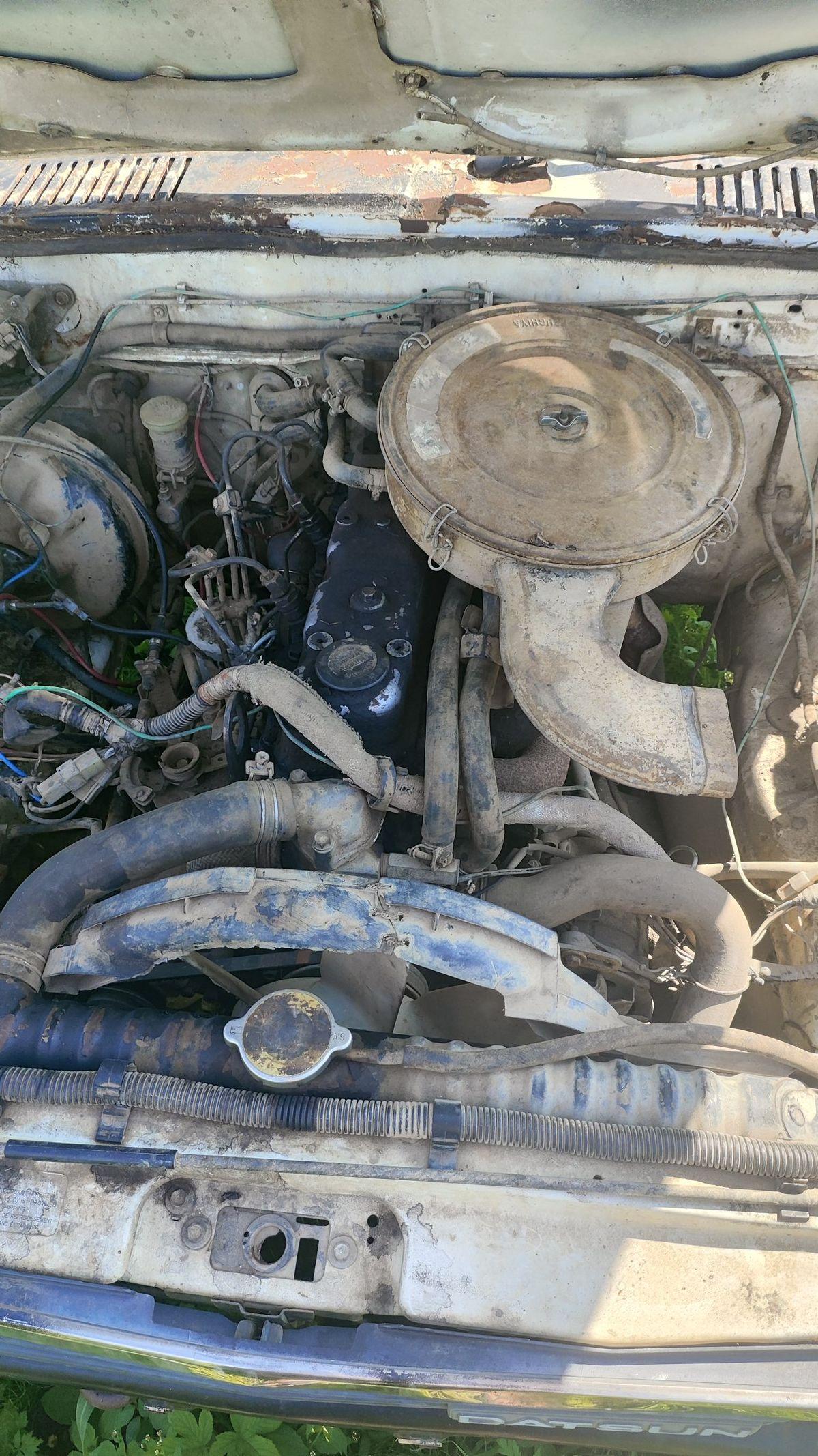

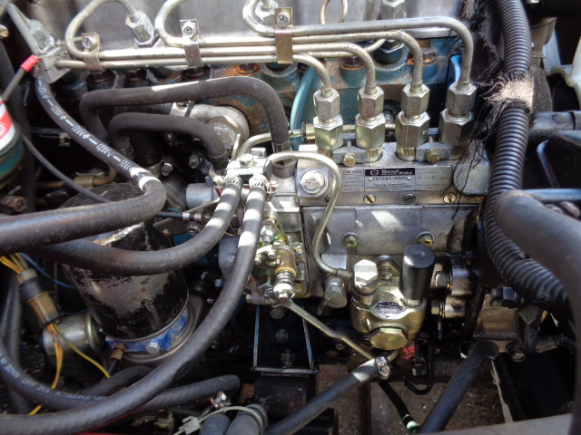

I found and bought an SD23 in the middle of nowhere. The previous owner used spare parts that were available at the time of repair. The engine starts and runs smoothly, but the original spark plug glow does not work. I am currently trying to restore it. I also have a donor engine, an SD23, and all the wiring from a Nissan Datsun ag 720, but I am unsure if it is functional. Please forgive my English.

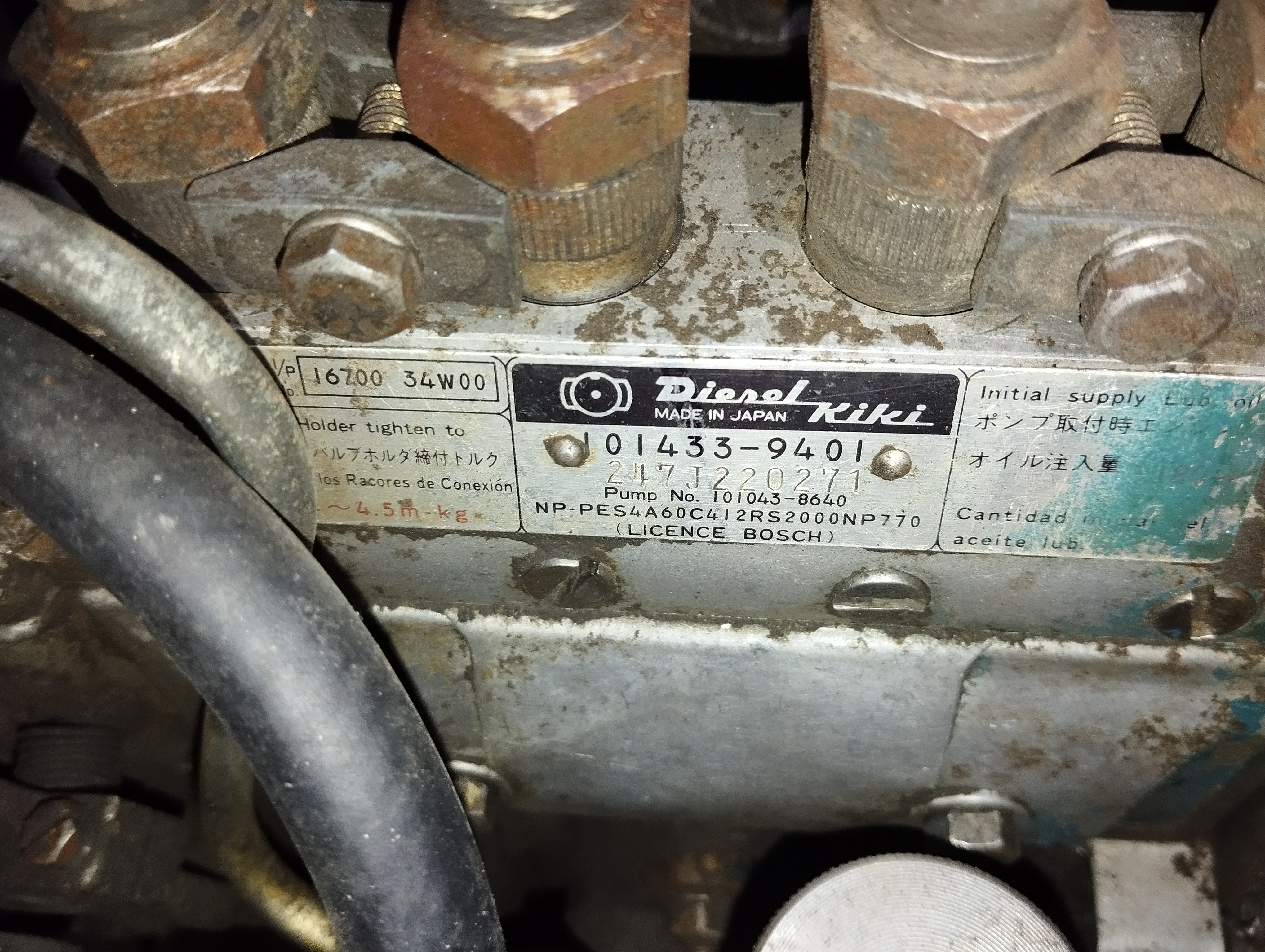

The first photo appears to have a VE type injection pump, the second photo appears to be an inline injection pump, the inline pump has 4 injection lines coming out of the top of the injection pump, while the VE has the 4 injection lines coming out of the back of the injection pump, I personally like the inline pumps because they last a lot longer(300,000+ miles) while the VE type do not last near as long.
The glow system is electrical controlled by a relay and glow plug timer, it is complicated, some people use a button on the dash and relay to warm the glow plugs(about a minute or less), most use a choke lever/cable to shut down the engine when things are not electrically working properly.
What is a "Nissan Datsun ag 720", not sure what "ag" is, is it a gas or diesel wiring harness?
This is a VE type injection pump.
This is an inline injection pump.

Thank you for your clarification. Now I understand the differences between these pumps. The VE-type pump is installed on my restyled version. I assume that before 1983 (pre-restyling), inline pumps were installed on diesel engines, and after 1983 (restyling), VE pumps were installed. This is my assumption, and if I am wrong, please correct me. I rely on the cars I have and the Japanese catalogs, which I have several of. I will try to upload them here.

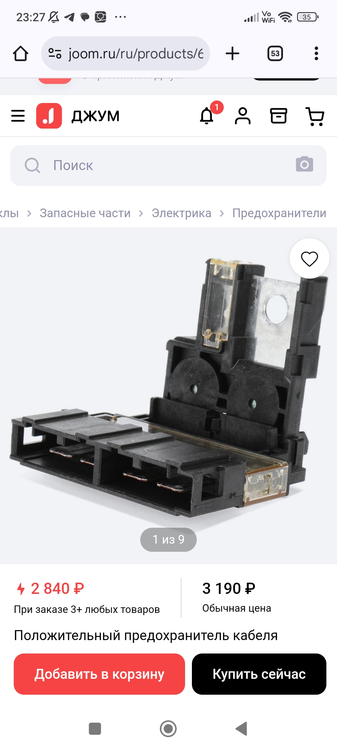

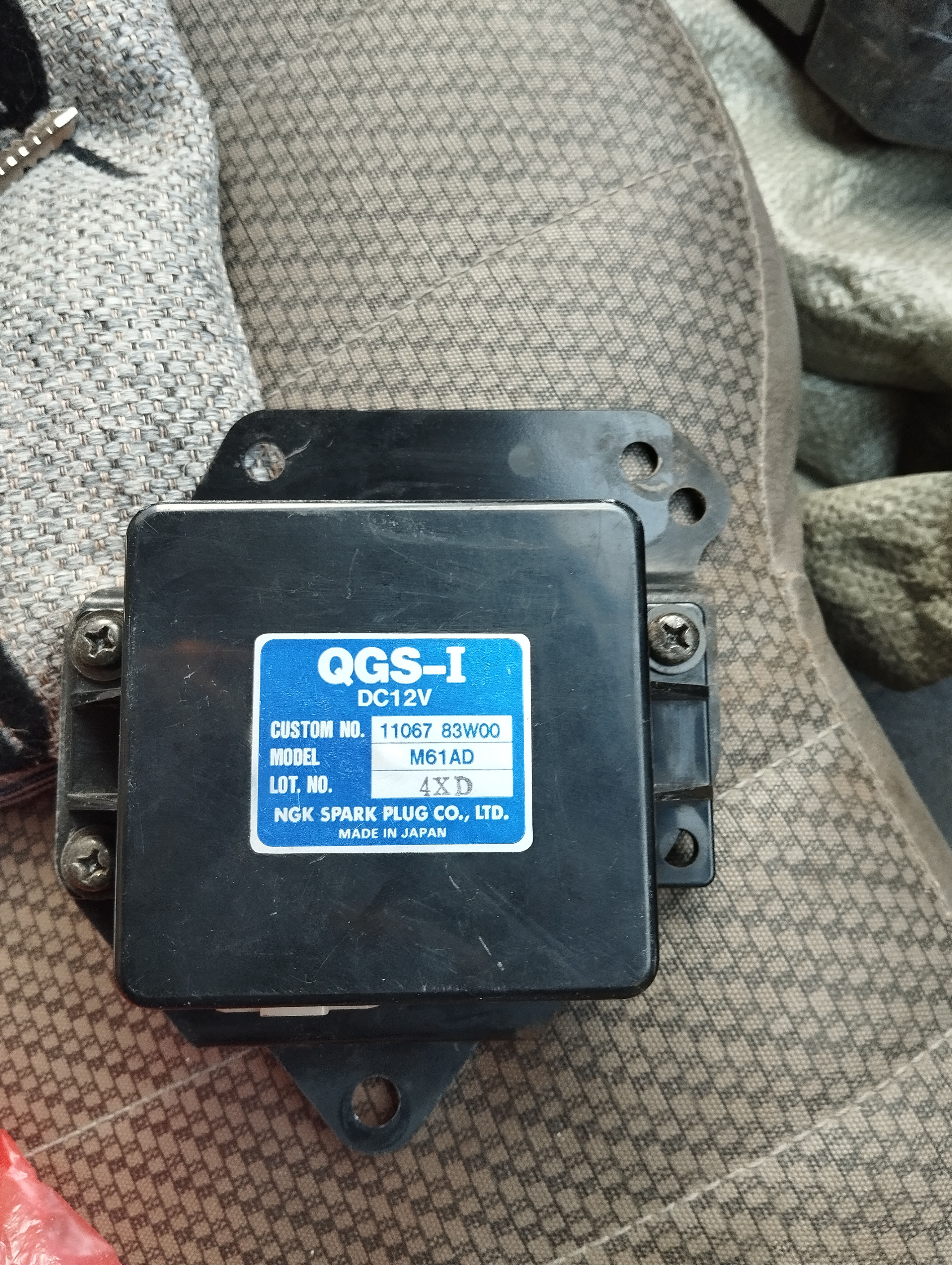

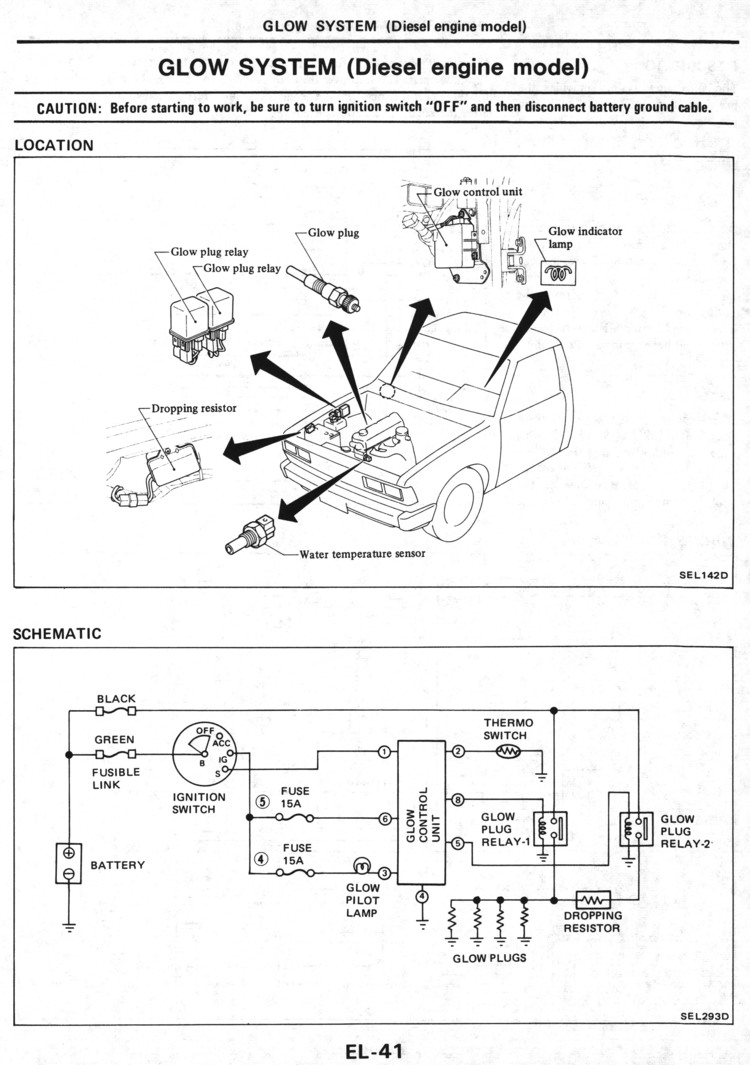

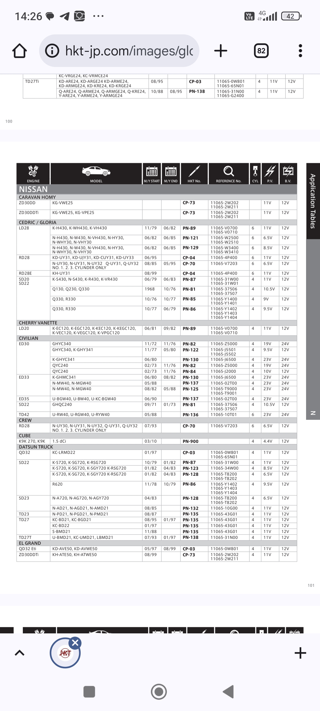

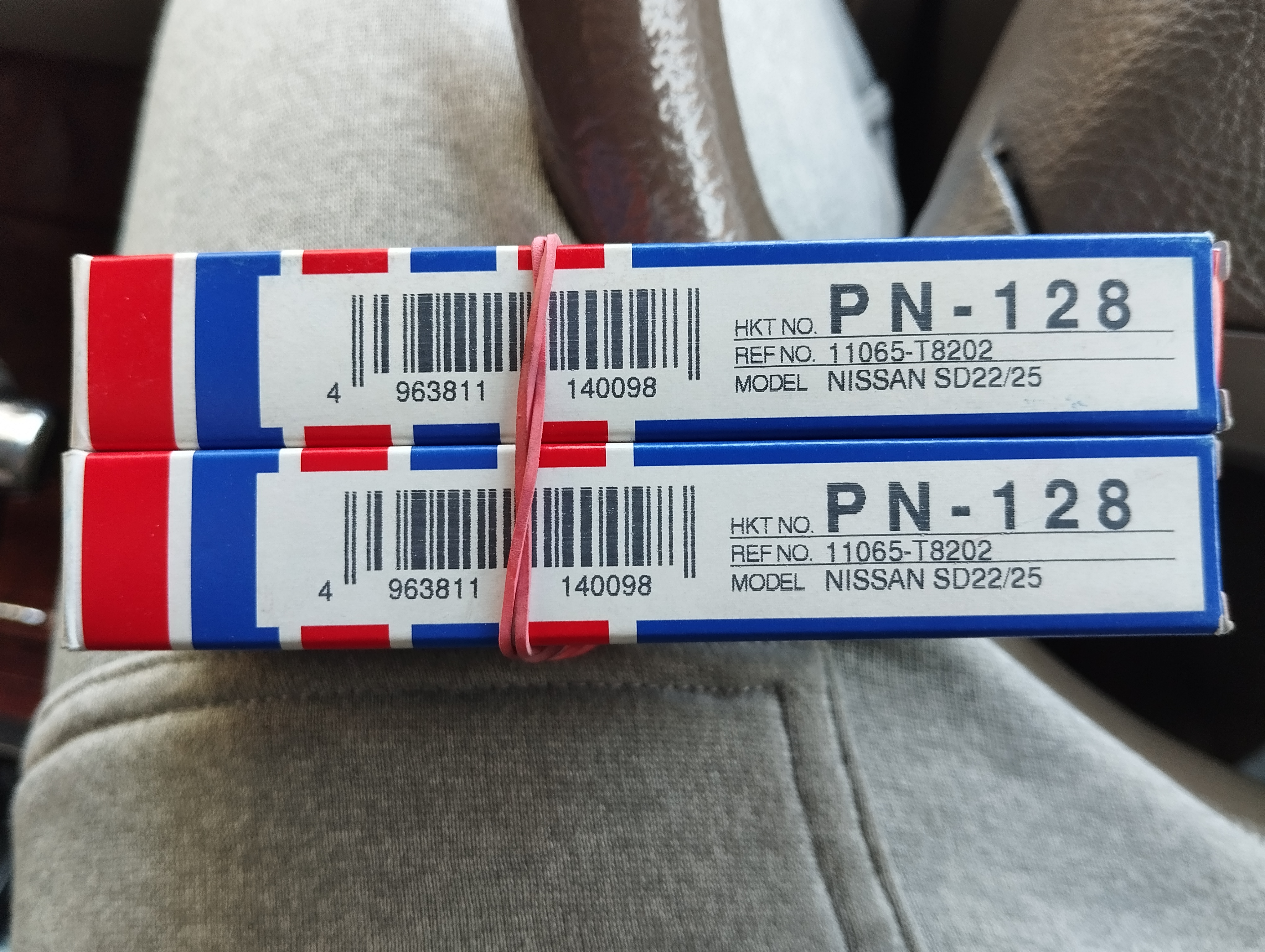

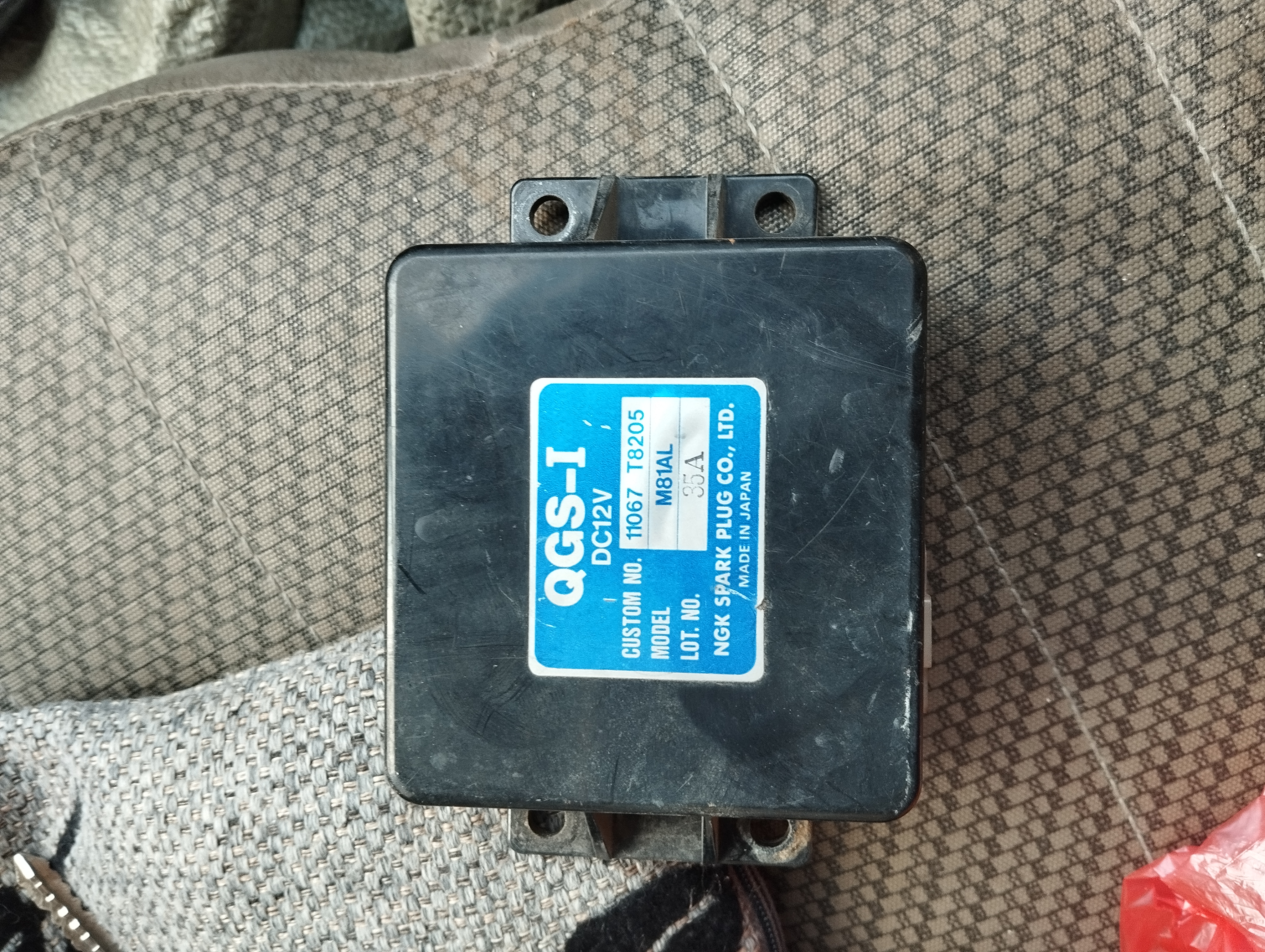

Good afternoon! I apologize for the long silence. There is good news! But first things first.
In your question, do you mean the dropping resistor timer or the glow control unit?
As I mentioned, I have two sets of all the glow system components, one from the donor car and the other from my car. At the moment, I am not sure about the proper functioning of each component.
To address this issue, I took my car to an electrician who previously worked at a local Nissan dealership. Additionally, I found pages from the repair manual for this system on this website. I also purchased a new set of Japanese glow plugs and two new glow relays, which I gave to the electrician.
After diagnosing the glow control unit, the electrician stated that one of the components was faulty, and the other was not providing a specific diagnostic signal. I did not delve into the details of the signal. The remaining components were functioning properly. As a result, the electrician replaced the glow plugs, relays, and created a new bus for the glow plugs. He also inspected the entire glow system wiring from the battery to the glow plugs. Now, the car starts, and the dashboard indicators are functioning correctly.
Additionally, the electrician repaired the heater, windshield wipers, and installed a relay regulator.
I will address the remaining electrical issues after completing the welding work on the cabin.
You also asked about the button in the cabin for warming the glow plugs from the previous owner. This button was present on both cars. The electrician removed it. Now, there are no unnecessary buttons in the cabin!

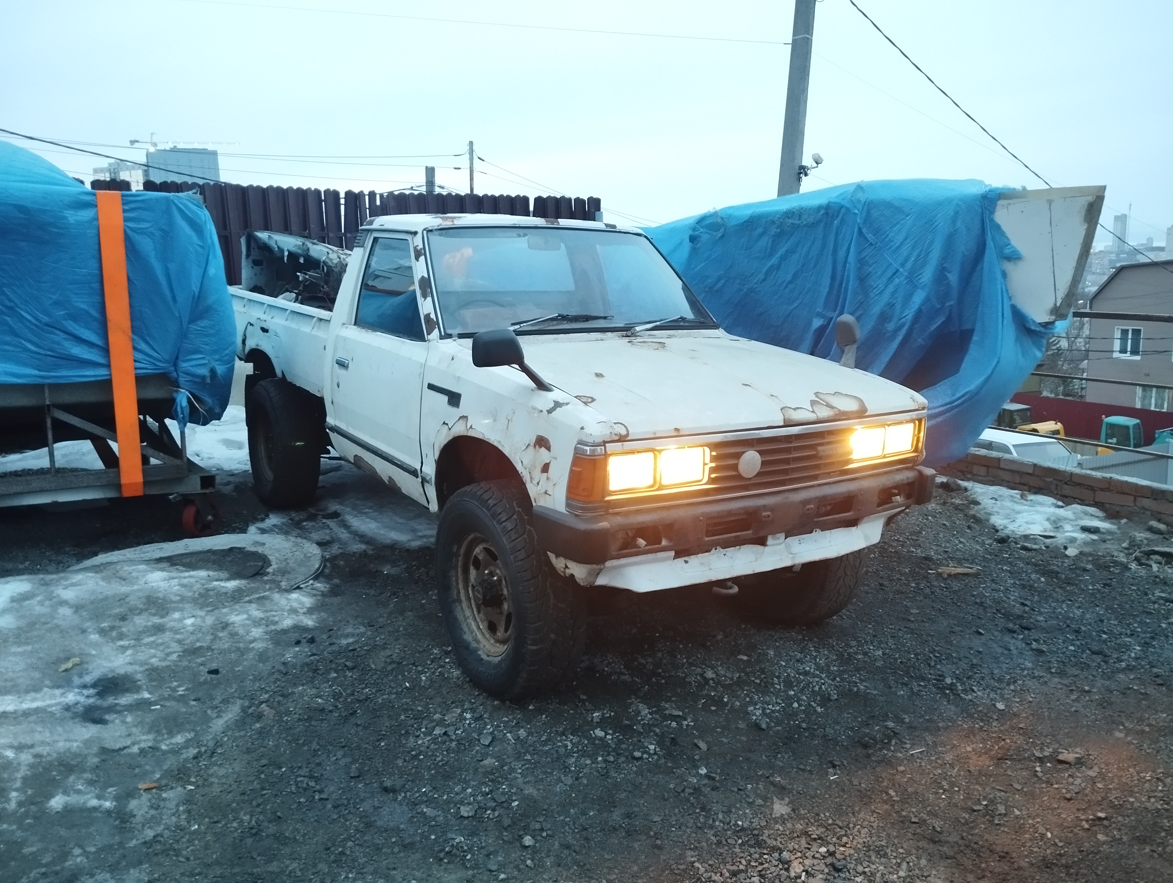

At the moment, the car looks like this. It's on a steady course, but there's still a lot of work to be done. I've started learning metal shaping.

Is that white 4wd RHD a diesel? SD23?

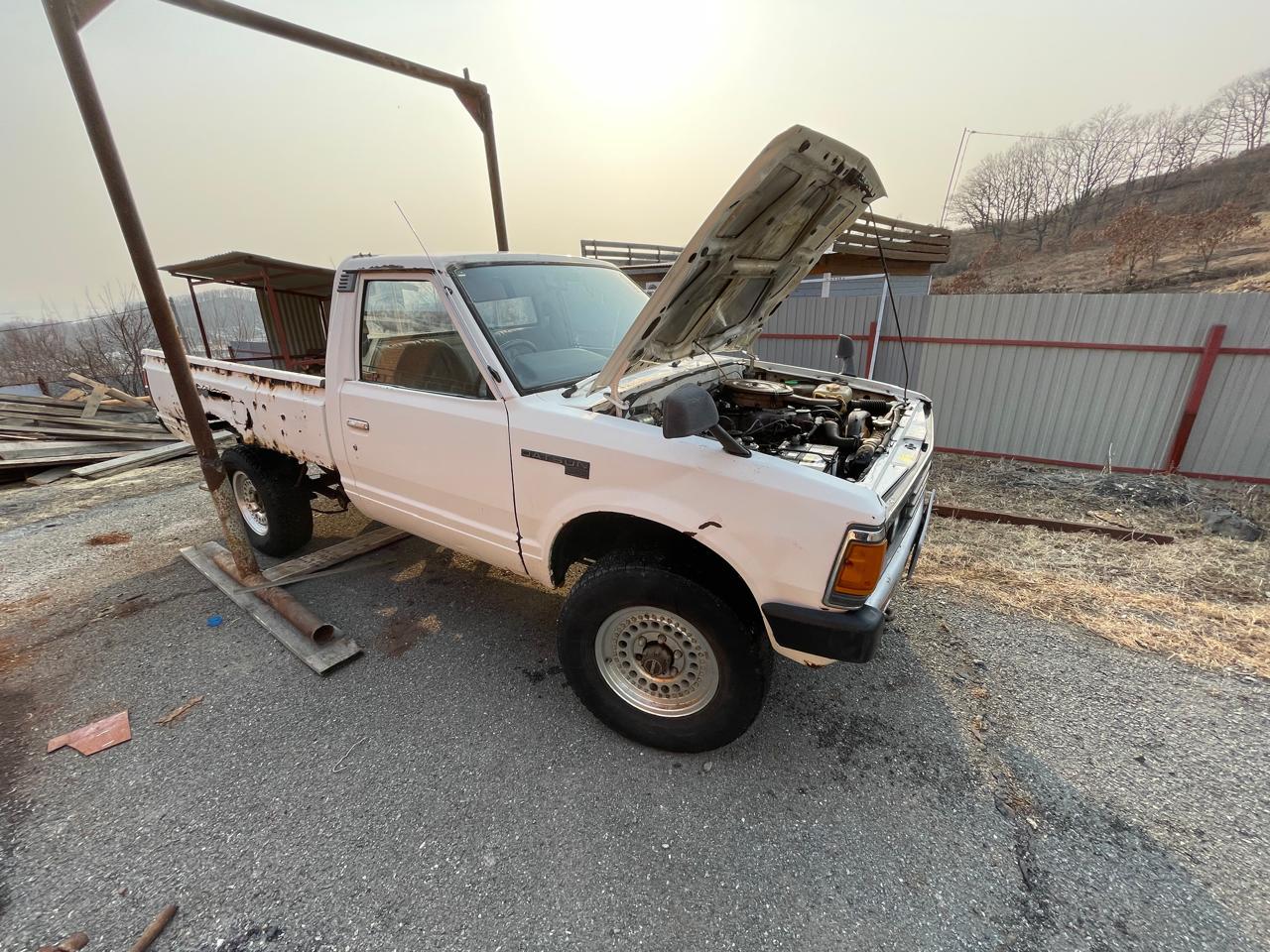

Good afternoon! Yes, that's right, it's an all-wheel drive car, the SD23.

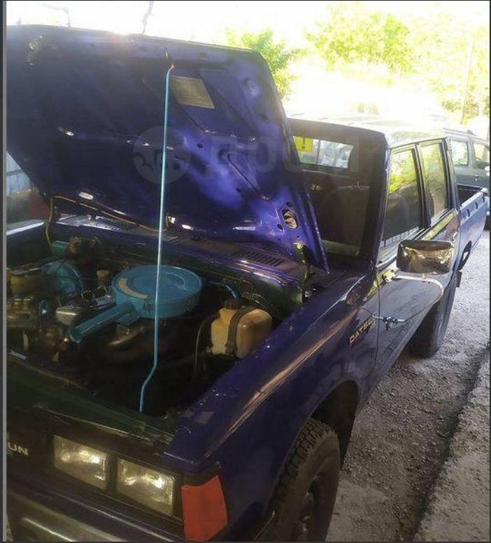

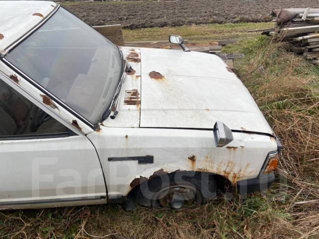

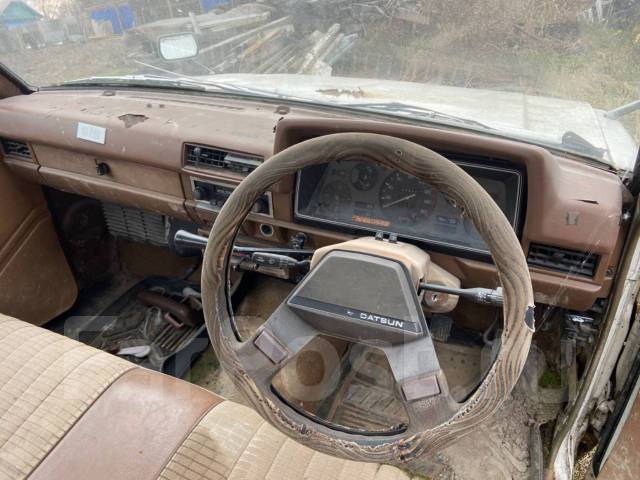

There are a lot of Japanese right-hand drive cars in the Far East. Most of the Japanese 4x4 cars (Nissan Datsun D21/D22, Nissan Patrol/Safari, Toyota Land Cruiser/Hilux, and others) have diesel engines. According to the information in the Japanese original catalogs that I have, the Nissan Datsun 720 had SD22 diesel engines until 1983, and after 1983, it had SD23 engines. This includes 4x4 cars. For example, I will attach some photos of 4х4 Diesel 720 cars from Russia. This applies specifically to Japanese cars. It is not uncommon for us, and it is even a common situation.
Previously, I had a bookmarked link to European Datsun 720 catalogs, but unfortunately, I cannot open it now. Most European websites are blocked in our country. There were various European versions of our cars. However, I do not remember specifically about the 4x4 diesel versions.
I can only speculate about other manufacturers. Wikipedia's Datsun 720 section provides information about production in countries other than Europe and Japan, such as the United States, New Zealand, Thailand, Canada, Greece, and Mexico.

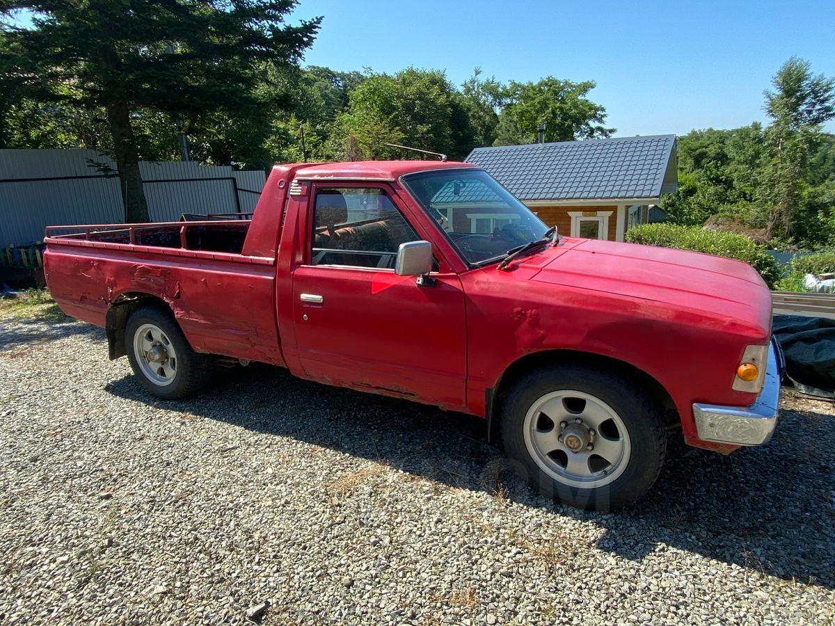

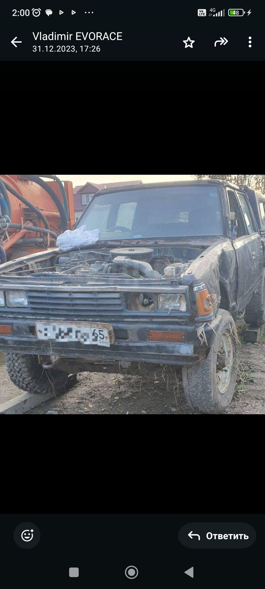

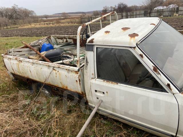

Your car is quite interesting! Did you enlarge the cabin yourself? Is it a custom KingCab project? We still have SD25 engines!

Yes I made my 1969 Datsun 521 into a kingcab, I needed more legroom, I bought a not running truck and made it into what it is today, I did another truck also, it took around 4 years to make that white one, it has a gas engine.
So is the white 4wd with a SD23 a drivable vehicle?
It appears to have functioning headlights and appears you might have backed it up to where it was parked when the photo was taken, I had a 1953 MGTD with fender mirrors, I did not like them, I put another mirror on the front windshield frame so I could see better.

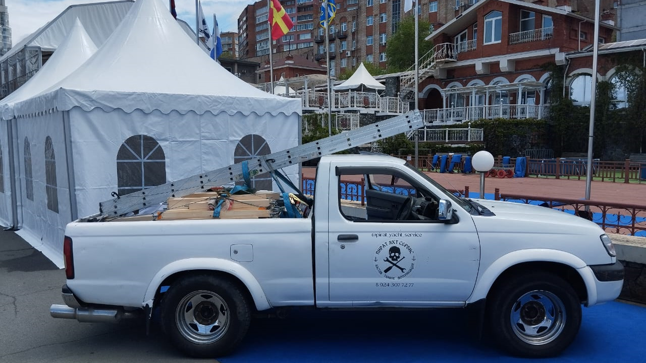

I also have a white Nissan Datsun D22 pickup truck with a KA20DE engine and rear-wheel drive. It's my daily driver! I've put a lot of work into it, including replacing the carburetor engine with an injection engine. I've also done a lot of work on the body and overall styling.

- My Nissan Datsun D22 today
