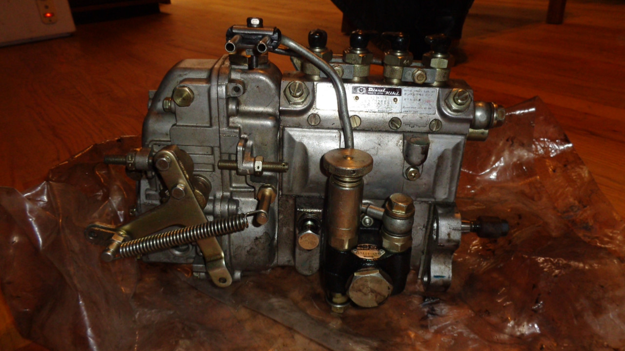

Every lift pump I have ever seen does not look like that, there is no glass involved, the only thing I have that has a clear housing is my pre-filter on my firewall with its own primer, the SD22 has a lift pump on the side of the injection pump itself that is run by a lobe on a cam, it also has a primer, it looks something like this in this photo, this injection pump is from a boat I think but i do not know for sure.
This is our SD22 lift pump.

I have seen your type of integral lift pump on that injector pump (Kiki?).
My SD22 has the Nihon-Cav injector pump and an outboard lift pump. And it seems the CN4-33 Chrysler variant also indicates marine usage. Not having much luck finding any parts yet but I do have a couple of leads.
