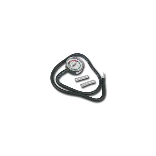

I'll bet $10 that you have a fuel supply restriction.Midnightz wrote:The interesting thing was that as I draw the fuel out from the return line, the fuel would recede back toward the IP...
You've already replaced the fuel filter. On the Maxima, there is only one (unlike the 720). Stop guessing and buy a tee and a vacuum/pressure gauge and tee it into the IP supply line:
Duct tape it to the windscreen. You should never see greater vacuum than about 2" maximum. I bet you'll see it go way below that.
See also this fuel supply story.
The lift pump on the Bosch VE IP is integrated into the IP -- it's a vane pump and cannot be serviced separately from the rest of the IP, and is actually harder to get to than the distributor head. It also hates dirty fuel. Its correct operation is absolutely critical to the timing advancing mechanism in the VE -- an external lift pump will not work to replace a failed VE internal lift pump, the timing will never advance correctly, forget it.
And don't even think about adding an external electric fuel pump until you diagnose the inlet side.
Once you determine that you have too much "suck" at the IP inlet, move the gauge to the inlet of the fuel filter and repeat test.
You might have something restricting fuel in the fuel tank, a crushed steel line, a plugged steel line, or a collapsing flexible line. I have seen ALL of these over the years, in addition to the punchline to the story linked above.
[I once had a friend's '70 Nova to diagnose. You could drive it around the block -- maybe -- but any faster and it was fuel starved. It had a pinhole rust-out on a steel line. Get this: it did not leak fuel. But it would pull air (sound familiar, ecomike? And fuel is much thinner than coolant.). Found it by pressurizing the steel line and tank to 2 PSI, and then it would leak -- do not try this at home! Talk about obscure!]
