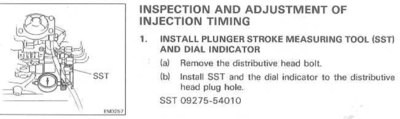

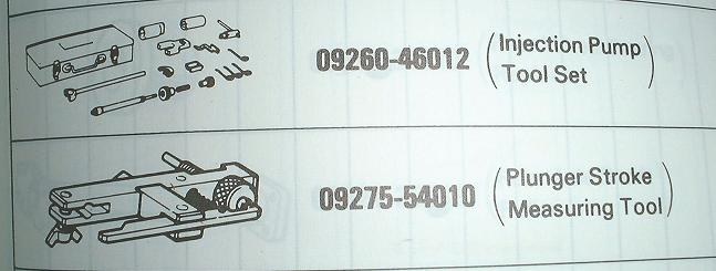

I think I've posted these before, but here are some Toyota/SPX/OTC pics of a similar tool:

Steve, thanks for that pic. Now I understand how the dial indicator is clamped. I've got several DIs, so one of them should fit.

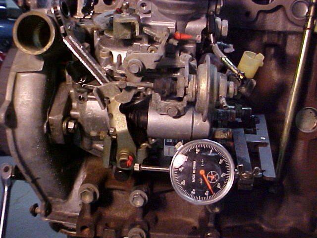

I received the Rotunda unit today. It's adapter is 8mm :)
Tomorrow I hope to try to fit it up to the Toyota 2L diesel and see if it will work in place of the OTC unit (that mounts the dial indicator in the opposite direction).

While the Rotunda adapter would fit the LD28 IP, the No. 5 injector line would have to be removed. With that line removed, the Rotunda adapter could come out the side, above the motor mount and below the CSD body.
The problem with that idea is that in order to remove the line nut, one has to backstop the delivery valve holder with a 14mm wrench -- I just tried this on the bench, and the delivery valve holder unscrews from the distributor head before the line nut breaks loose from the delivery valve holder.
Unfortunately, there is no way to get a wrench or similar on the delivery valve holder unless perhaps the CSD bracket is removed. To do that, you'd have to remove the AT modulator valve as well, the coolant hoses for the CSD, etc., then persuade three screws from the distributor head, one of which is one of the four main bolts that retain the distributor head to the IP main casting, which isn't a bolt I'd want to disturb unless I was prepared to replace the large o-ring that seals the two together.
It might be possible to fish a 14mm crowsfoot in the inside of the lines (ie where the plug is in the centre) and hold the deliver valve holder that way, but getting it in there would not be fun, and then the trick would be to get a 3/8" extension in-between the line to attach to the crowsfoot.
By the time you've done all that, the "Dr Jones" cut-up VW adapter looks a lot more appealing, I think. Except . . .
The factory method, outlined in the 1982 FSM, pages MA-25 & 26, states, "Remove fuel injection tubes. Use two wrenches," and shows an illustration of loosening a line from an injector. Next picture shows the dial indicator in the back of the IP, with all six lines removed.
"Dr Jones" must have removed some or all of the injector lines to use his cut-up adapter, though he doesn't mention it from what I just re-read of this thread. Looking at my IP on the bench (pictured above), there is not nearly enough room in the centre to get an adapter down through the six injector lines, though if Nos. 1 & 4 lines were removed, there would be.
This is the reason why I've put off using the mechanical method of timing this IP for twelve years: I don't think it can be done on my old car unless I remove a lot more than the FSM lets on.
