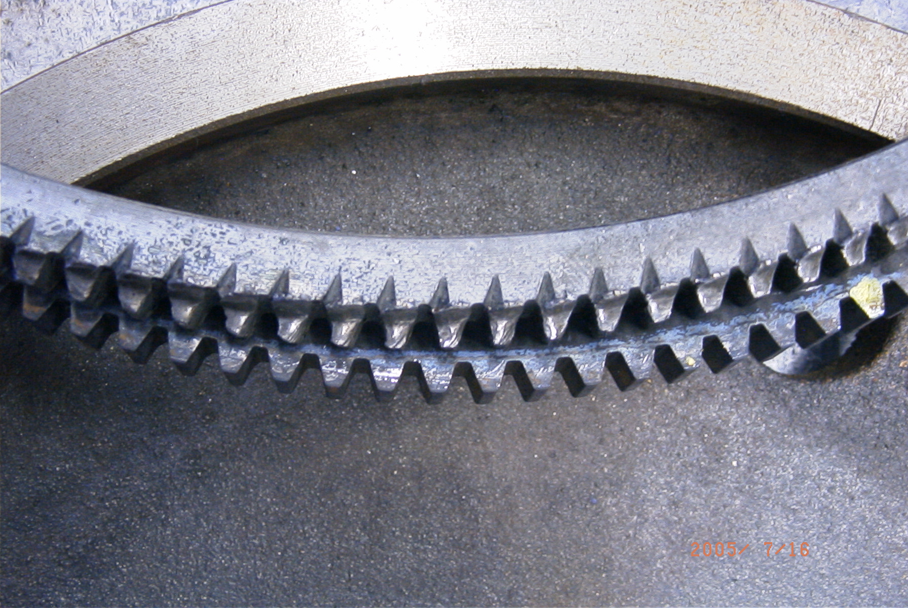

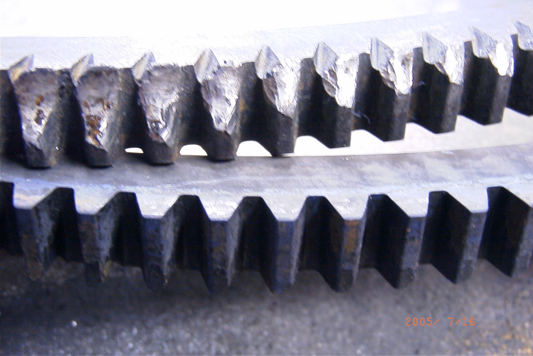

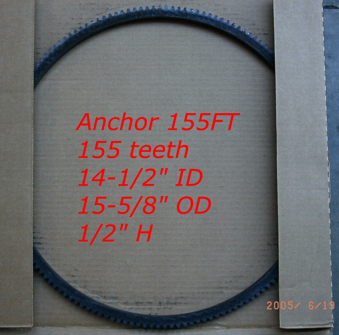

Ring gear: on many flywheels, the ring gear can be replaced. The usual reason is that someone didn't keep their engine in good condition, overused the starter, and wore out some teeth. Most engines tend to stop in exactly the same spot, so the same teeth take all the abuse of initial starter bendix gear engagement.dieseldorf wrote:Autozone.com is listing a ring gear PN: FRG-105G for $27.99 and has it in stock. What is a ring gear good for?
I've not heard of the LD28 flywheel teeth getting this bad yet, but I'm sure someone has worn theirs out.
I've replaced the flywheel ring gear a few times, most recently on my now-sold 1984 F250 diesel:
(click on any picture for larger)
Note that it's very uncommon to be able to replace the ring gear on AT-equipped parts, as the ring gear is almost always welded on (as in yours, in the picture you displayed above). The Ford 6.9l ring gear I show above is for a C6 AT, which is one of the exceptions: IH used the same ring gear for both AT and MT flywheels, and they can be pressed on in both cases. I do not know of another example where this is the case. The general rule for light-duty stuff is: ring gear replacement is possible only on MT flywheels.
