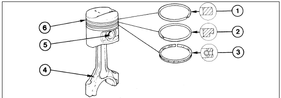

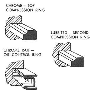

I was posed a question yesterday:
Juss Driftin' wrote:What do you mean by having poor oil control?
Only the topmost ring is designed to be a compression ring: gases under compression above the piston try to escape down alongside the piston, are vented to the piston's topmost ring groove and push the topmost ring outward to make the ring/piston/cylinder wall seal. The "springyness" of the ring has almost no part in the sealing. The ring must be free to move in the groove in order for it to seal to the cylinder wall.
OTOH, the lowest ring performs no compression duty at all: it is an oil scraper, designed to scrape oil off the cylinder wall and return it to the sump. Gases escaping from the combustion chamber toward the sump do not aid in the lowest ring's function.
The ring(s) in between the top ring and the bottom ring generally perform a combination of those functions, with the emphasis on sealing rather than scraping.
It is possible to have good compression and poor oil control when the oil scraping function of the lowest ring is poor. Rings wear and stick from various causes, but the compression ring must move in its groove every cycle in order to get good compression, so it is "exercised".
The lowest, oil control ring does not have any compression acting on it. It is entirely reliant upon "springyness" and if it is stuck in the groove, it is ineffective at controlling oil from migrating up the cylinder wall.
I have found that the SD engines will often have decent compression and poor oil control. One cause might be long oil change intervals that allow crud to build up around the oil scraper ring, but that is only a guess.
All the above applies to four-cycle engines. Two-cycle engines of the non-diesel variety don't need to control oil from the sump. Diesel two-cycle engines do still need oil control rings, but that's another topic entirely.

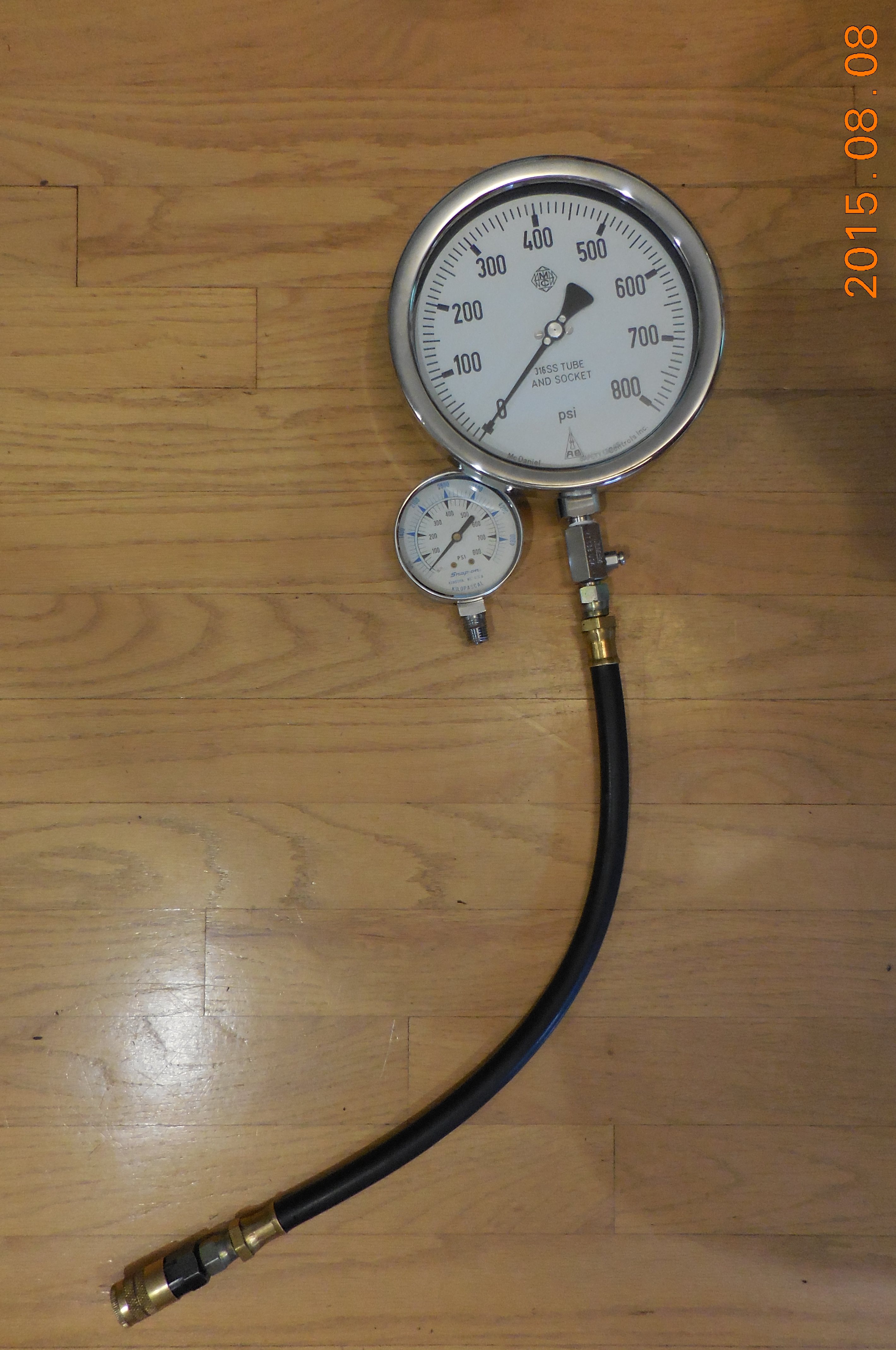

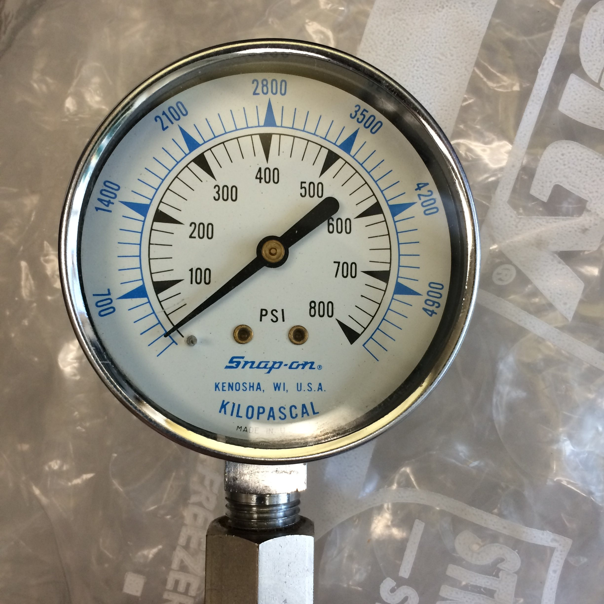

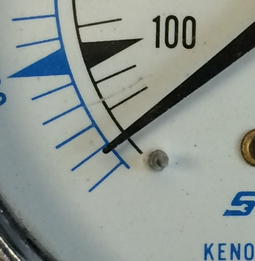

I have two of these Snap-On compression gauge setups, and one of them has developed a gauge problem. Notice the needle:

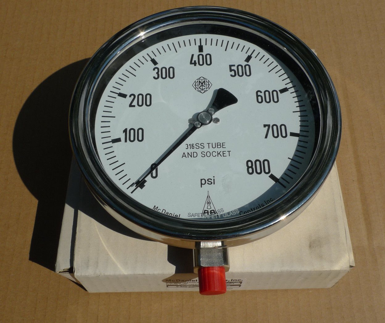

I don't trust this, and I don't have a simple 400 PSI pressure source so that I can compare one gauge to the other. I just bought this 6" replacement, generic gauge from eBay ($28 shipped):
This 6" gauge head will be nice, compared to the Snap-On's 2.5" head, though it doesn't have the kilopascal ranges (which I've never needed).
Meanwhile, I still have the other Snap-On gauge set, though I seem to have misplaced the second low-profile custom adapter I'd had made :(
Re: Testing Compression
Hmmm. I didn't really think about what a 6" dial would look like on this setup. It's, um, huge.
