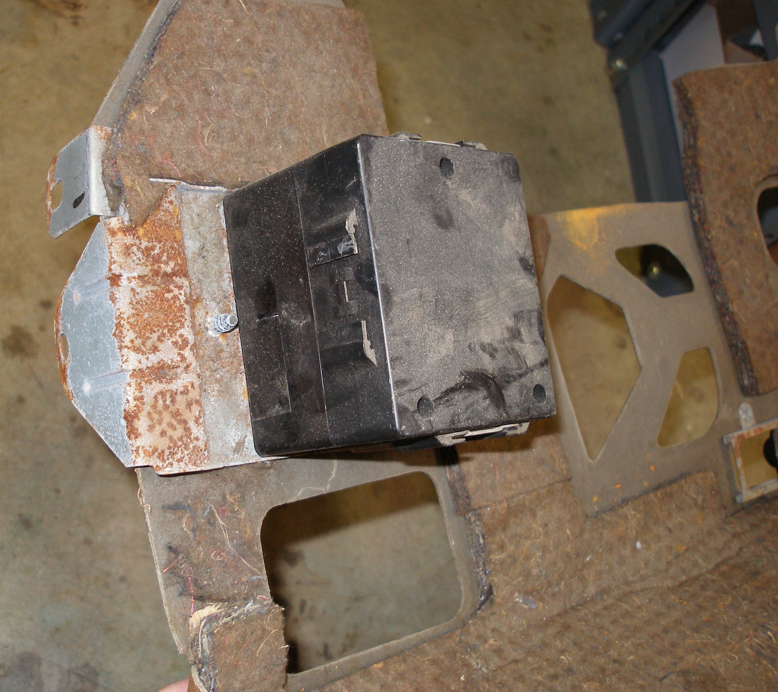

The Maxima GPC is on the driver's side footwell (1981 only) or under the passenger seat ('82-83). It looks like this.dieseldorf wrote:I've salvaged two black modules from my junked Maxima. One is a flat black box, about 4.25" x 4.25" x 1.25" and it says DEC MODULE on top. It has a 13 pin connector, whereas the wiring diagram for the GP control unit shows only a 10 pin connector.

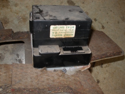

That is The Talking Lady ("Bitchin' Betty"). It bolts to the driver's side knee bolster.The other module is about 4.0" x 3.5" x 3.0". There is a 20 pin connector on it. Inside is a circuit board and a small electric motor.

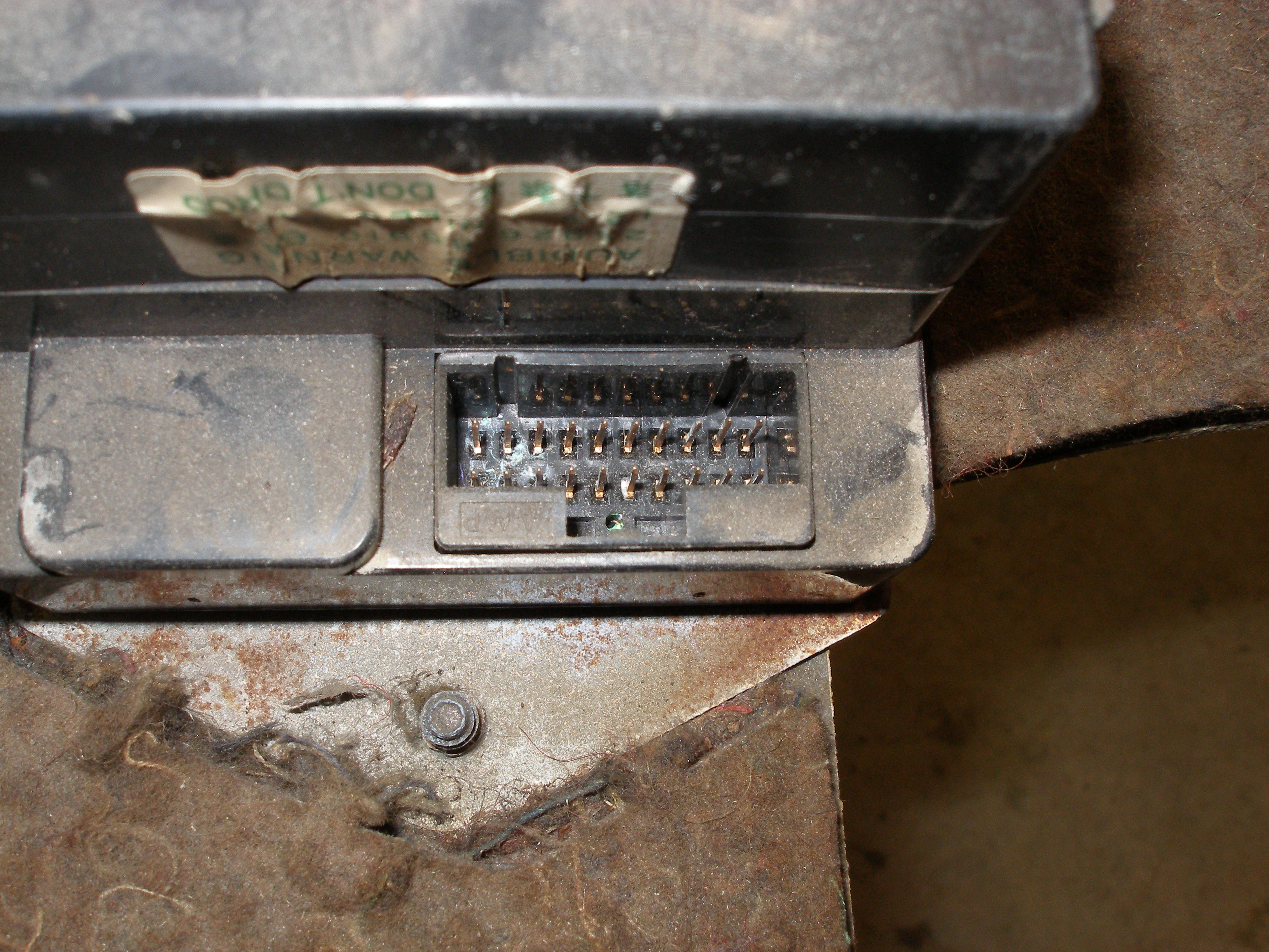

Here are the pics of that module I am talking about
Well, if this is not the GP module than I do not have one. In that case I will build my own GP module based on a micro-controller. It will include radiator fan control, overheat alarm and more. I am going to need some input on that.

Your picture shows a 13-pin connector: that is the EGR controller, not the GPC (see my post above).
