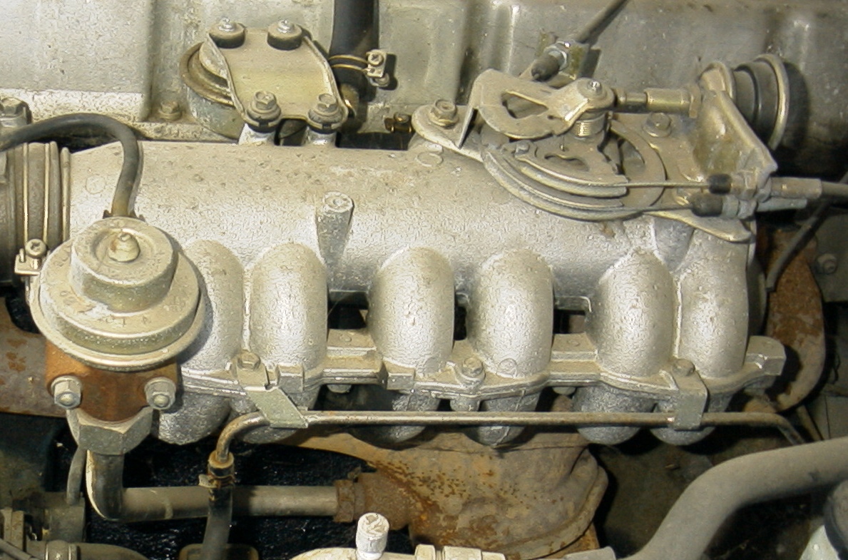

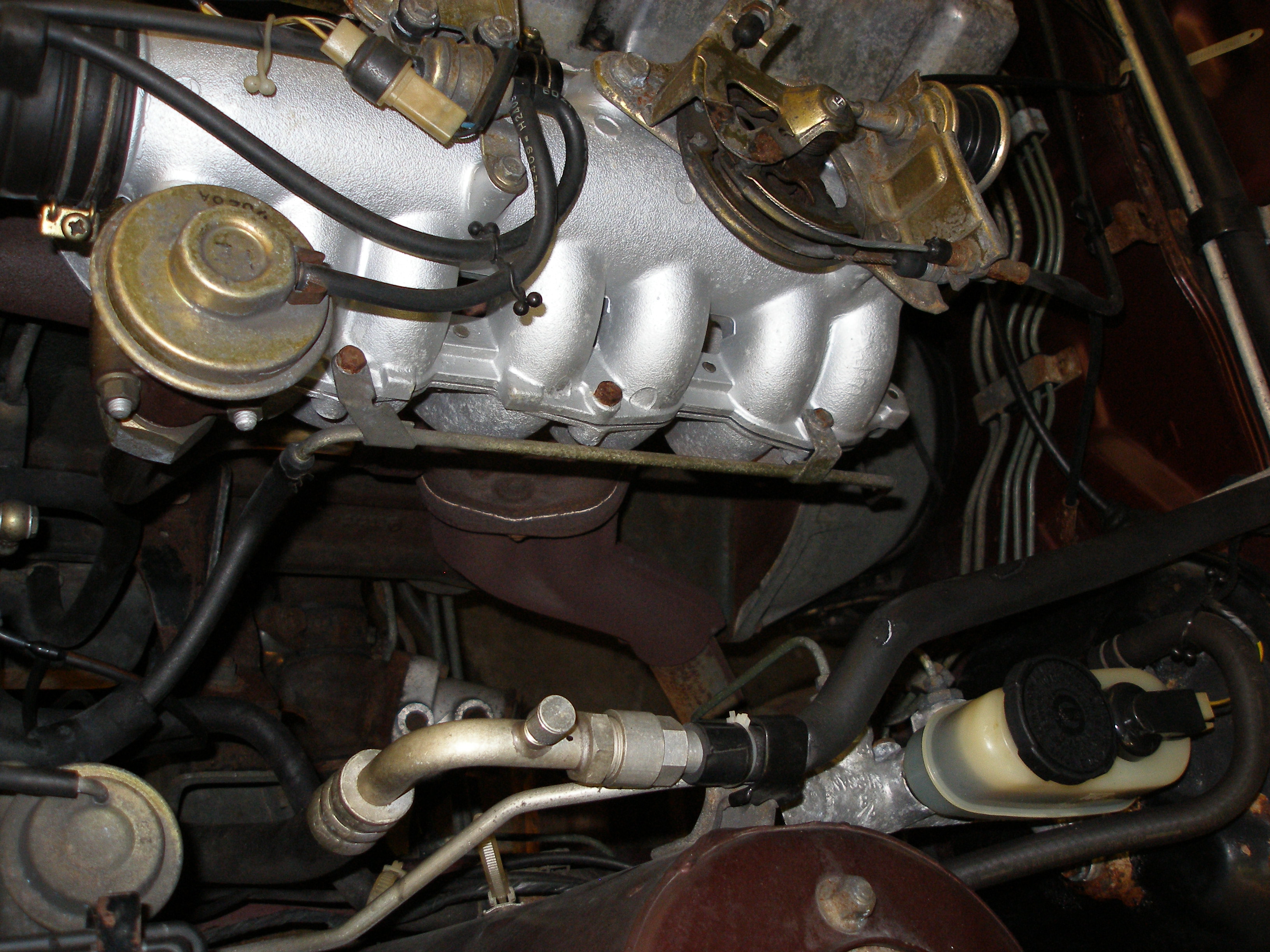

I did find a pic of the intake
http://datsunmotorsports.selfip.com/pic ... %20097.jpg
very clean looking.
Notice the lack of an EGR? Also there is no suport for the extra TB choke thing that I have yet to figure out that came on the Maximas. Im going to polish it up and install it on my LD if I ever get a good bottom end together.

The EGR system used in the US requires the vacuum-controlled throttle body to obtain enough delta pressure between the exhaust and intake. The throttle is actuated to encourage more exhaust flow into the intake. The '81-81 Maxima has three states (no flow, low flow, high flow); the '83 system goes to four-stages and more plumbing to suit.
It's interesting to to see the upper plenum without the mounting bosses, but it's also lacking a way of mounting Maxima the throttle cable sheave.
