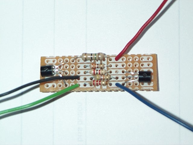

despite the fact, that the IC1 output has about 650 Ohms output impedance and would drive a tach directly, I added a simple two transistor buffer circuit for safety reasons. This buffer will not affect (load) the rest of the EGR circuitry and is short-circuit protected.If anything goes wrong with the tach connection, it will not damage anything. With close to 100mA@12V output, it will drive ANY tach.
The pics above shows the diagram and layout. To build it, I used a proto board from Radio Shack. Cut off a piece from it so the final size was 1-7/8" x 5/8". That small PCB fits inside the EGR controller plastic case. As shown in the diagram, there are 3 connections to the main module. The power connections were made directly at the main connector. Pin1 is the B+ and pin10 is GND. Pulse pick-up wire is soldered to one leg of the R11 resistor, where it connects also to R14 and pin1/IC1. The tach output wire is fed through a small hole drilled in the plastic case, next to the connector. I insulated the bottom of the PCB with insulating tape and inserted it in a small plastic bag.

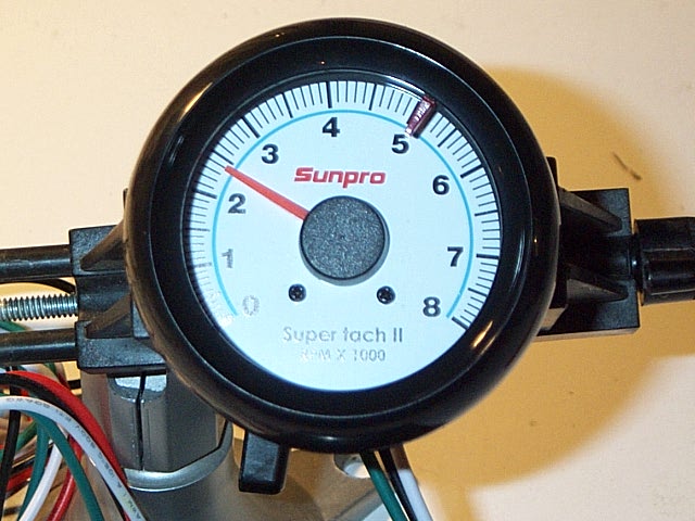

I used a SUN-PRO super tach II ($27.64 @ Amazon.com) to test the set-up. A 120Hz 200mV sine wave from a generator was providing the speed-sensor signal. As seen in the pic, the tach shows 2400 RPM, exactly as it suppose to be.
Buffer-Amp Diagram
PCB with connection wires
PCB bottom side
Buffer output signal 12Vpp
Tach connected to EGR unit
Tach displays the correct engine speed, success!
